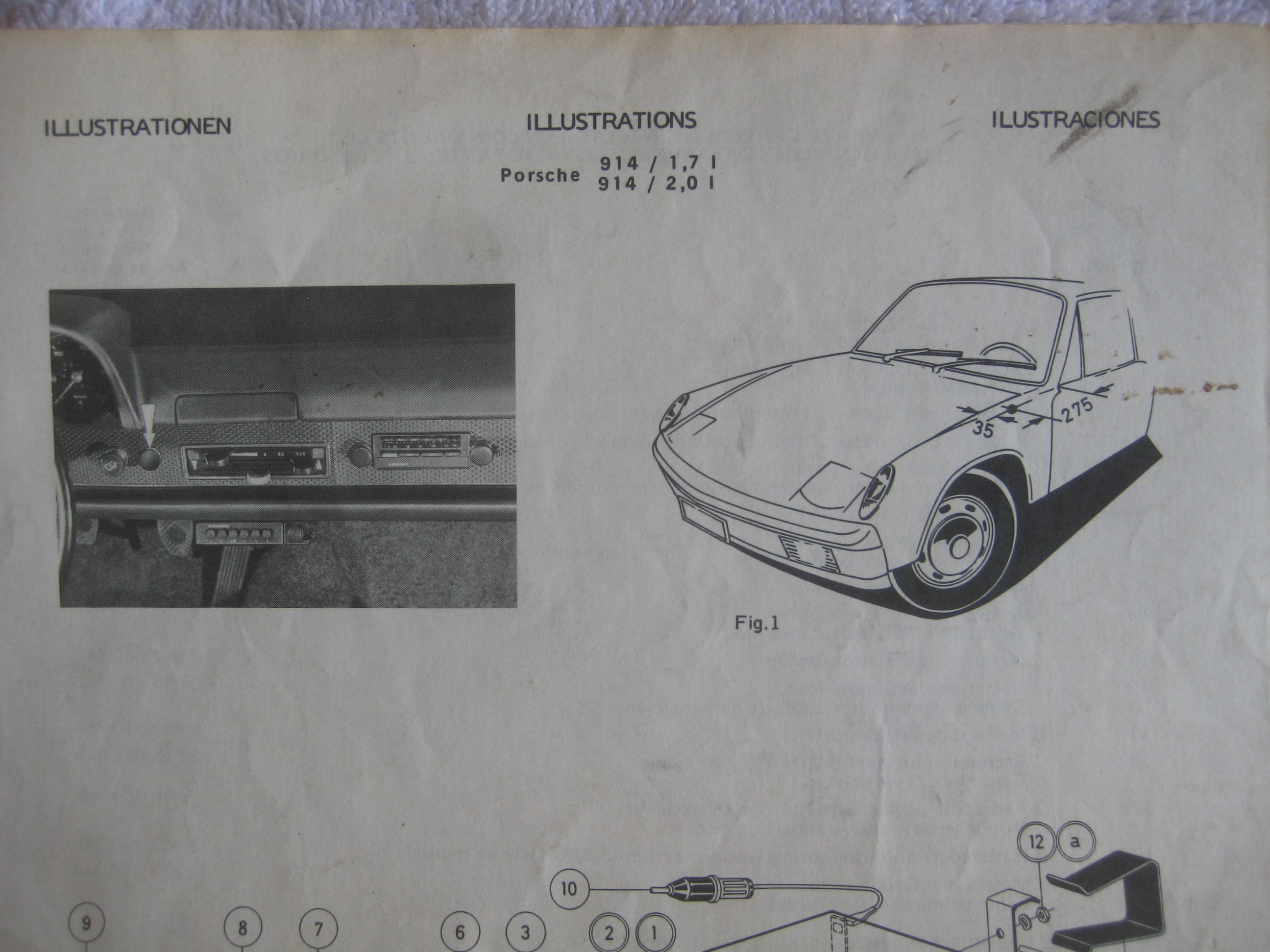

The pattern I had was in a box that was in storage for 35 years before I got it. It is full size and will fit on a single printer page. Pattern is for the drivers side but could be reversed for passenger side for auto antenna.

My 75 1.8 has the antenna on the passenger side. Did they change the location over the years?
Brett

Antennas were put where ever the installer decided. Most dealerships used this pattern. Stereo shops were another matter. Not sure of the source but passenger side mount was for the electric antenna . Something to do with the length of the wire harness of the antenna.

From original Blaupunkt radio / antenna install kit.
