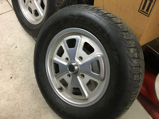

These Michelins on my 74 seem to have a pretty decent ride, handle well, and there dosent appear to be any speedo error.Attached Image Attached Image Attached Image

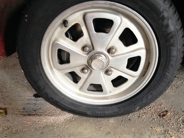

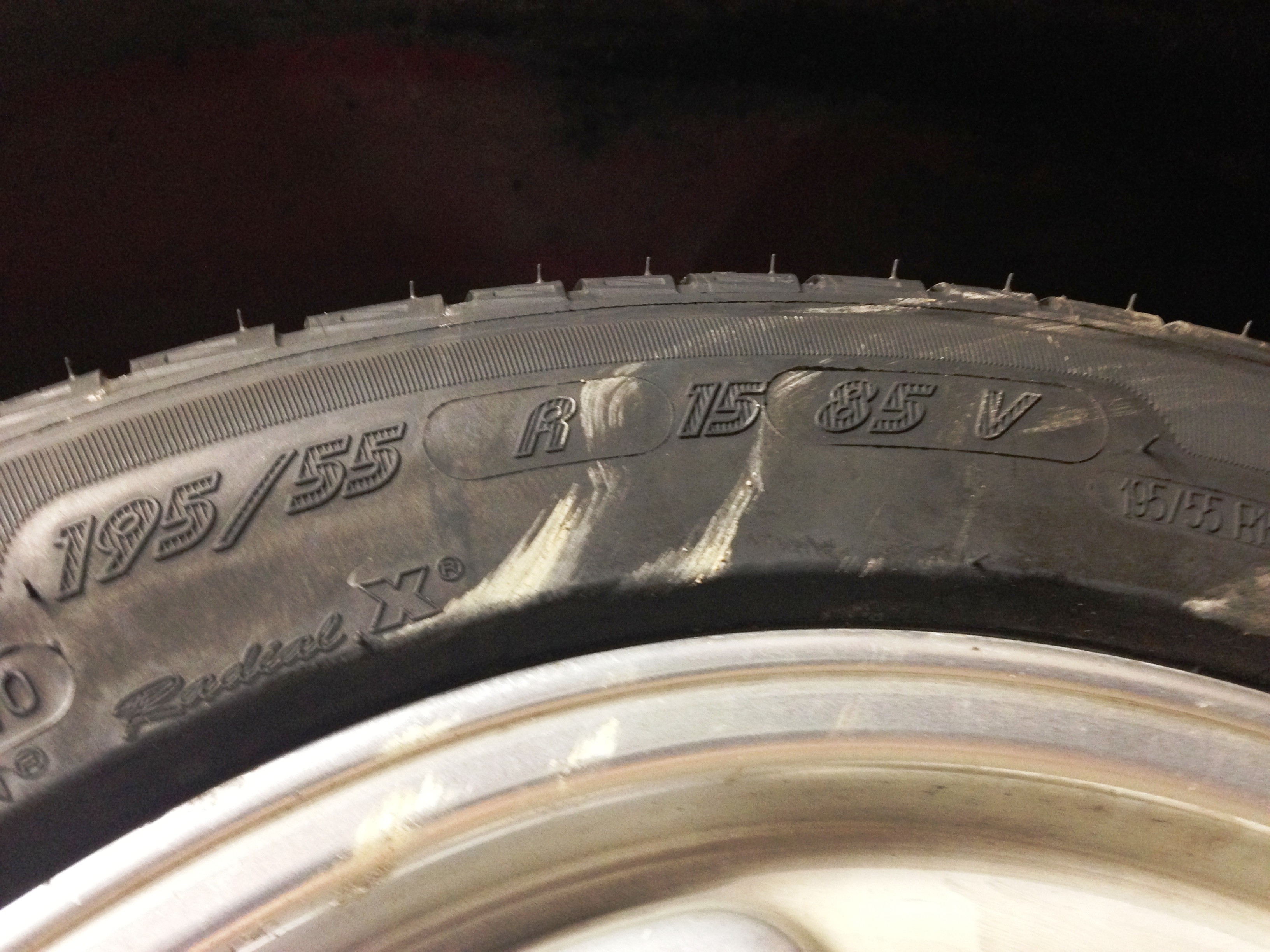

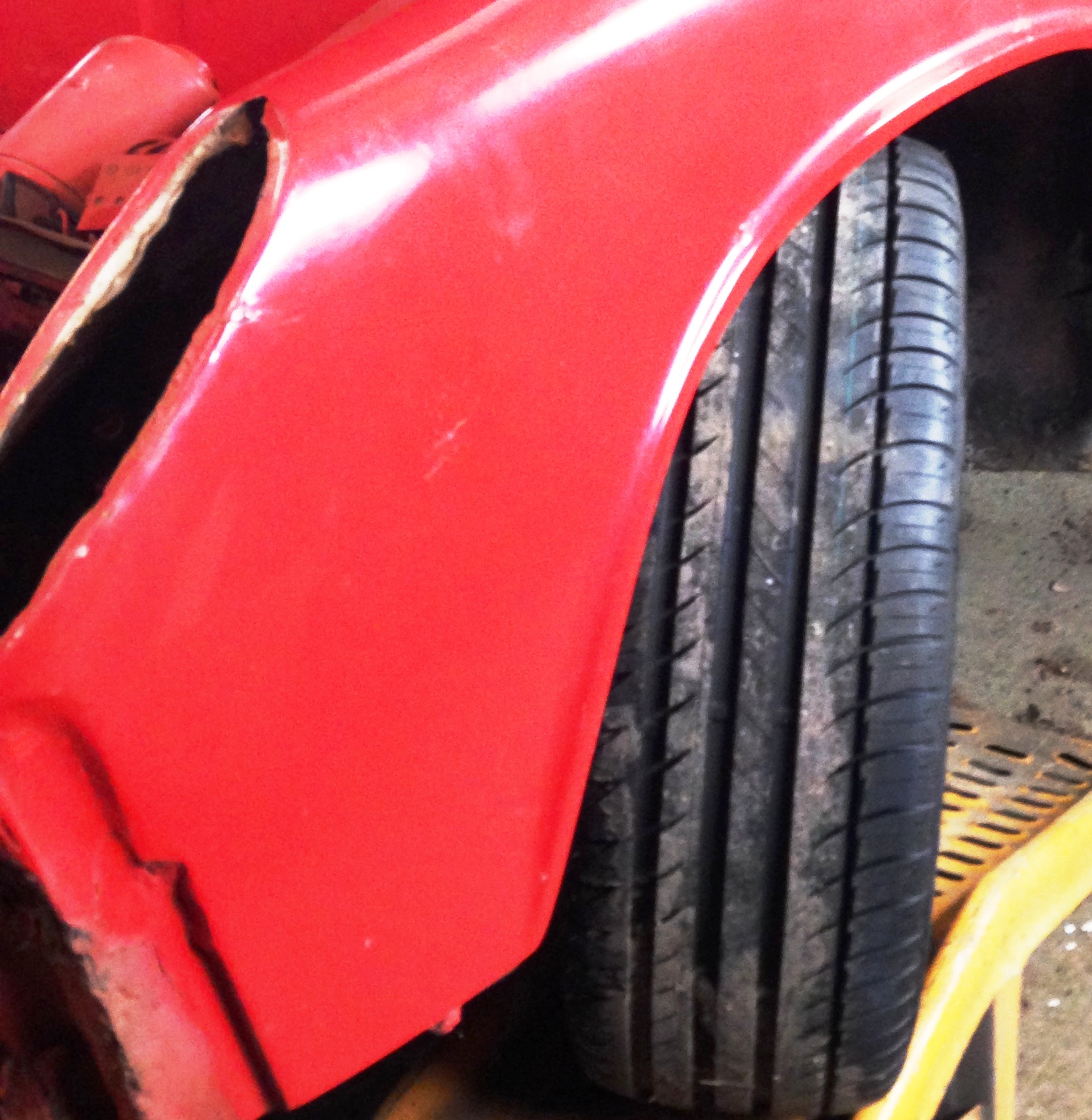

I have issues with 7x15 195s on the rear
They dont rub. They touch the fenders permanently and the car is undrivable
Wheels are cookie cutters.
How did you guys fit these. I cant drive it now

See your other post.
Something has to be modified, the wheels changed or the fenders pulled out. I'm running 205s on 7s but have a custom offset which is larger than the 23mm you have.
