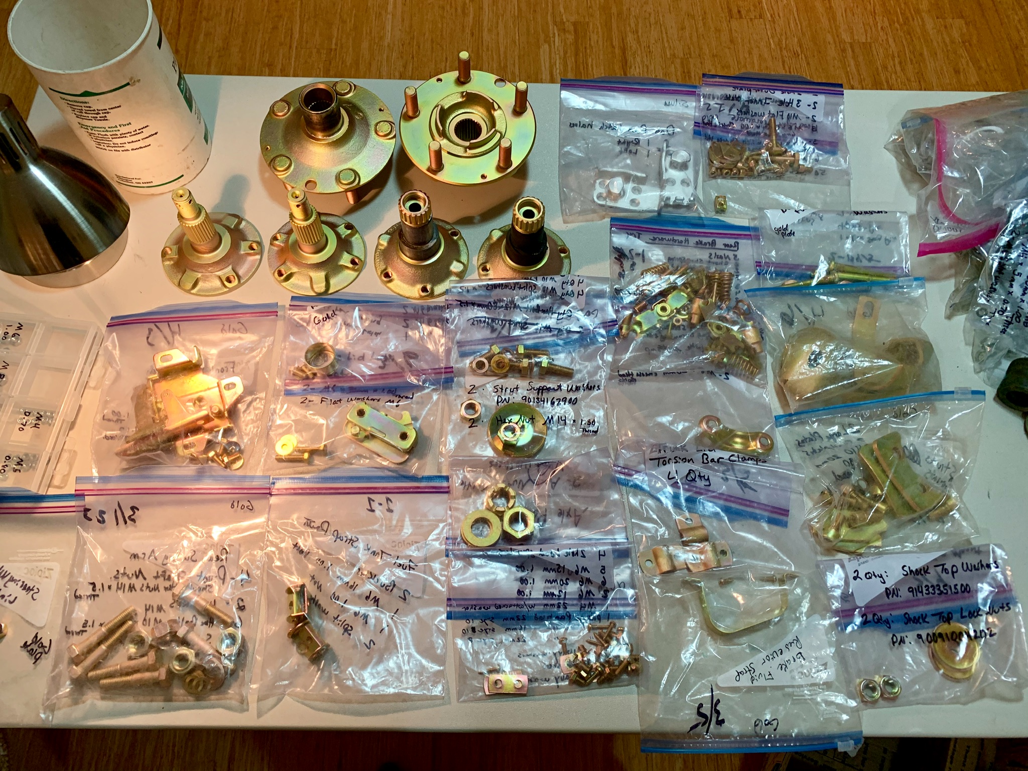

Also had an exciting morning. I drove to Winston Salem to pick up a load of parts I had cad plated. Beautiful gold piece-parts!
Looks good! Who in Winston did you use for plating?

Frank at Stratford Metal Finishing took car of me. He rebagged everything, and didn’t lose anything.

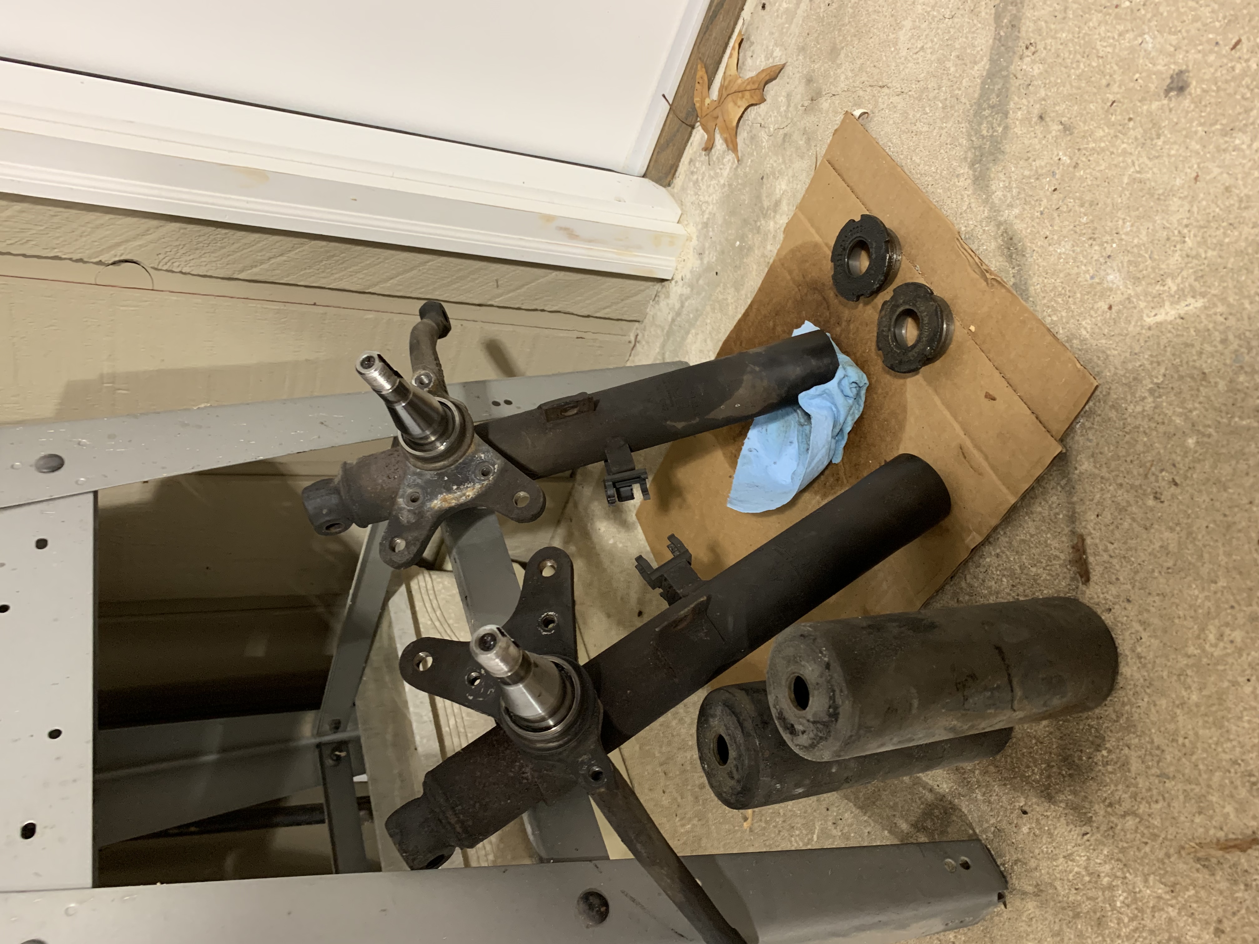

I’ve started stripping done the Carrera front end I bought, and am considering sending a few parts out.
I have Boge struts, and I’m thinking about sending them to Elephant to have the spindles raised 19mm (the max they can raise them).
Still can’t decide between Bilstein and Koni inserts.

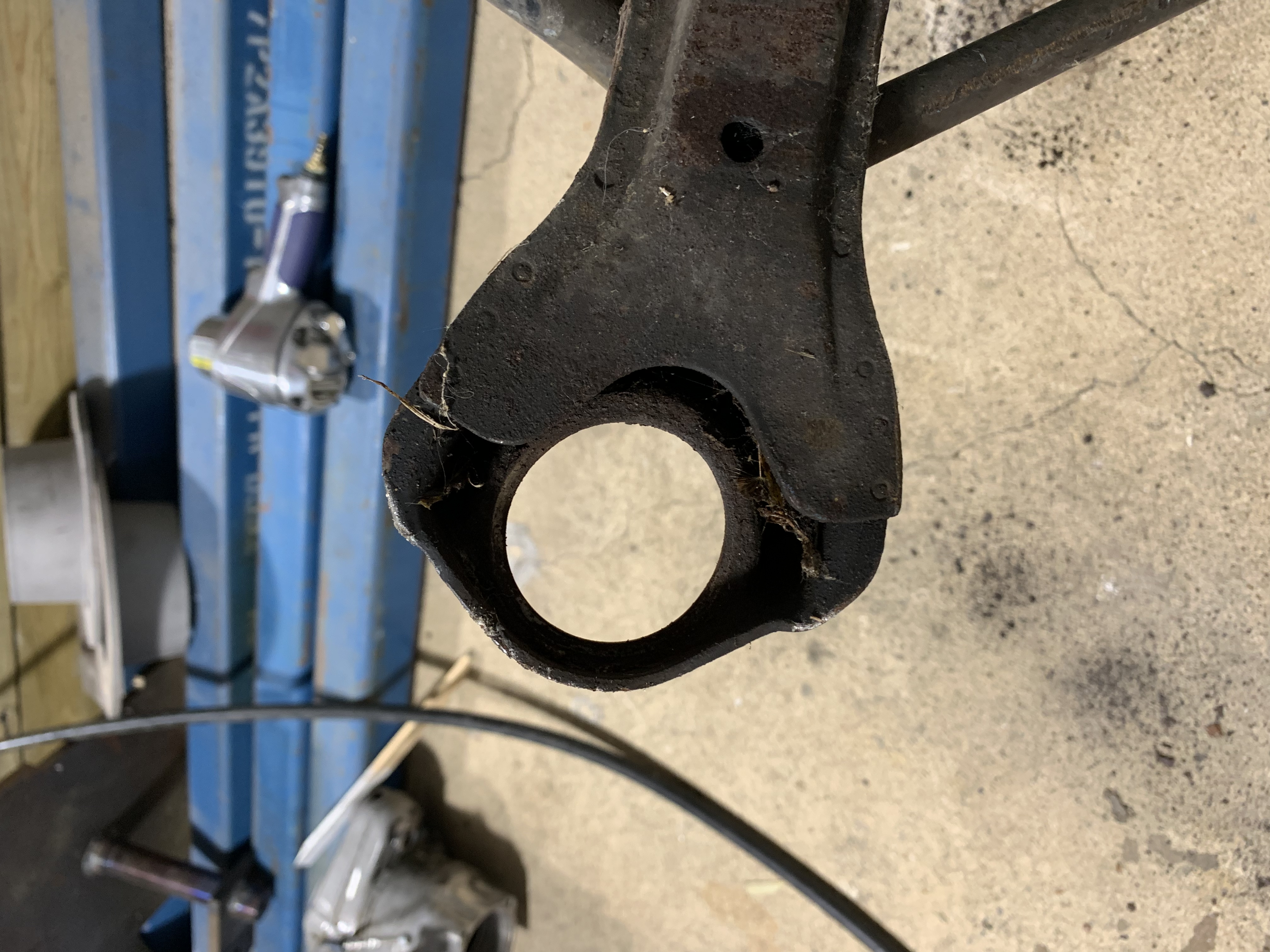

When I finally got the ball joints out, I found some damage on the drivers side control arm. It looks like the end has been shoved back a little off centering the ball joint location and ovaling the whole. Seems odd, no damage noticeable any where else.

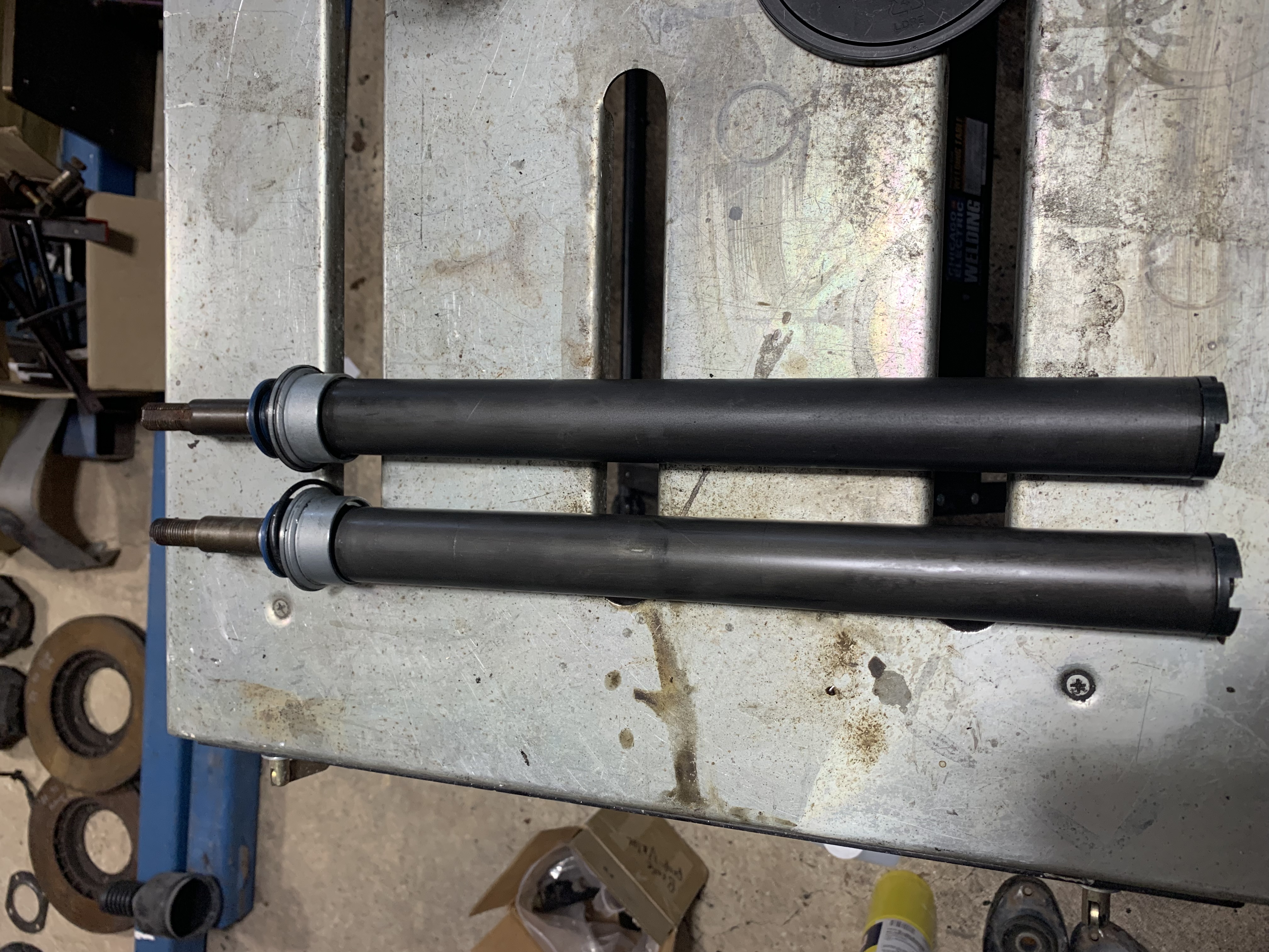

Cleaning up the garage this evening to see what I can get rid of. I have these Boge inserts from my struts; they came from an ‘84 that was wrecked a few weeks before I bought the front end.
Do they go in the scrap pile, or are they usable by someone - anyone?

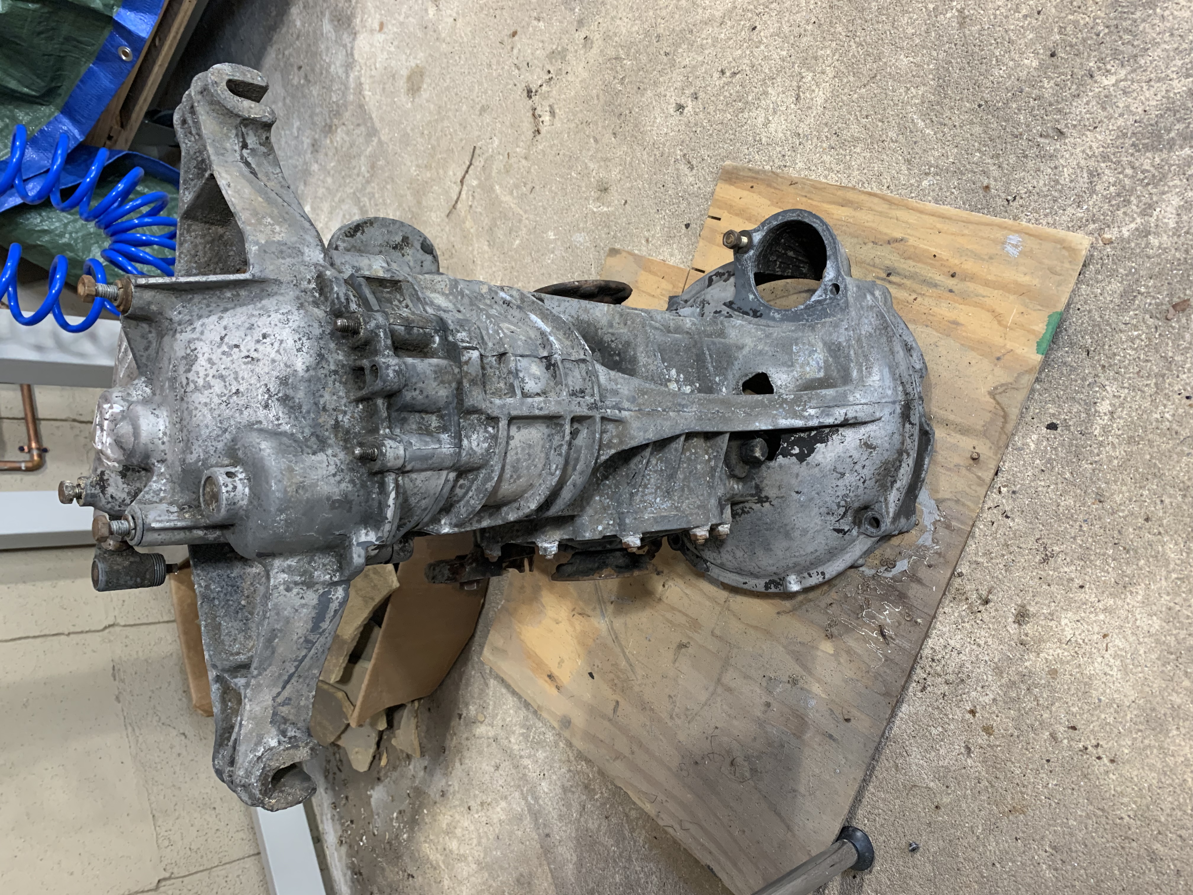

Transmission plans:
Step 1: half way cleaned, but there’s a crusty grease/oil still there

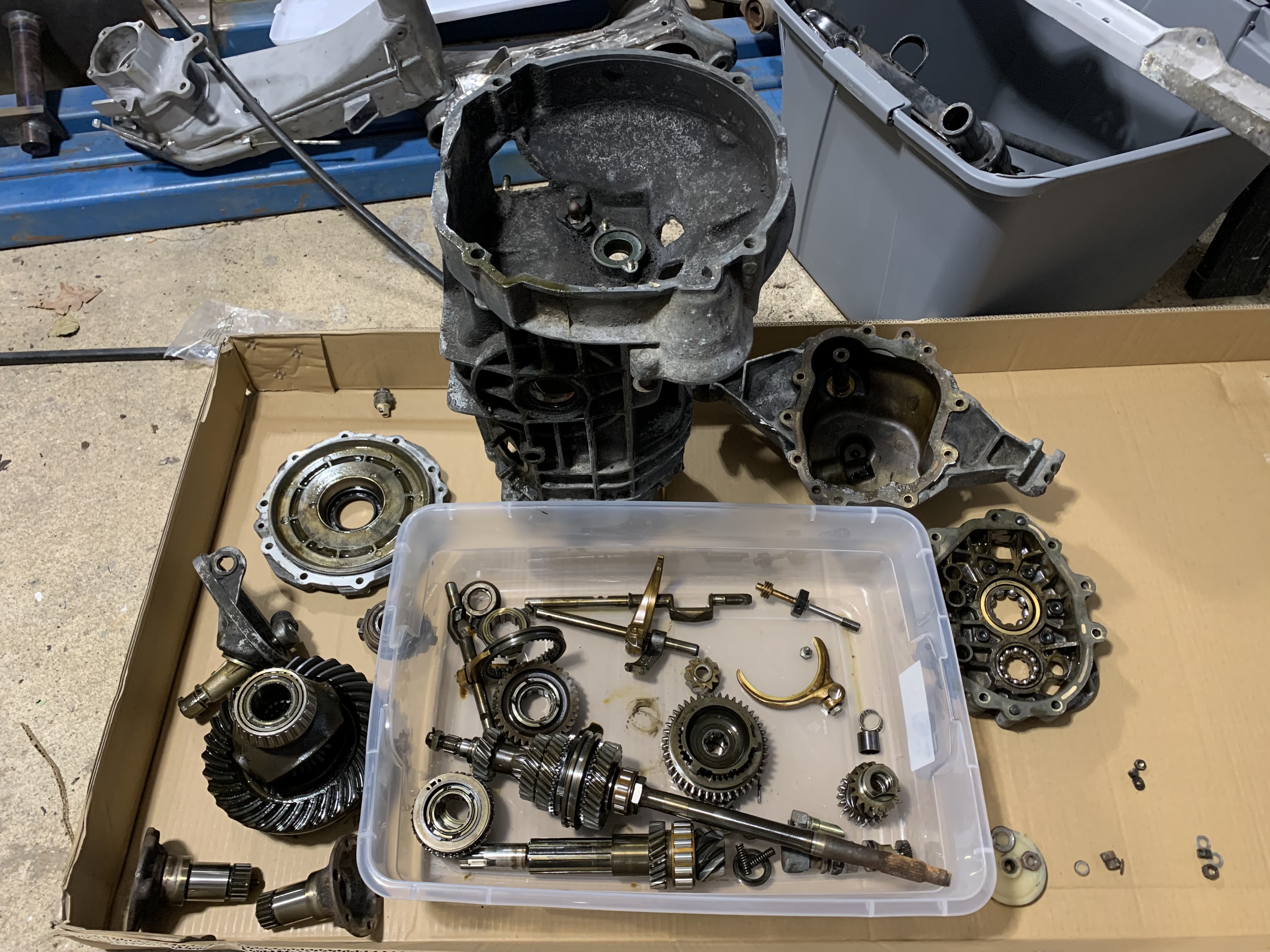

Transmission plans:
Step 2: Tear down - my first time ever. Good thing Dr. Evil knows how it all goes back together.
Before I bring it to Evilwerks the case needs a serious cleaning; not sure of the best method for that yet. Then, after it’s clean, it gets a coating of cerakote; thinking about Satin Nickel C-124

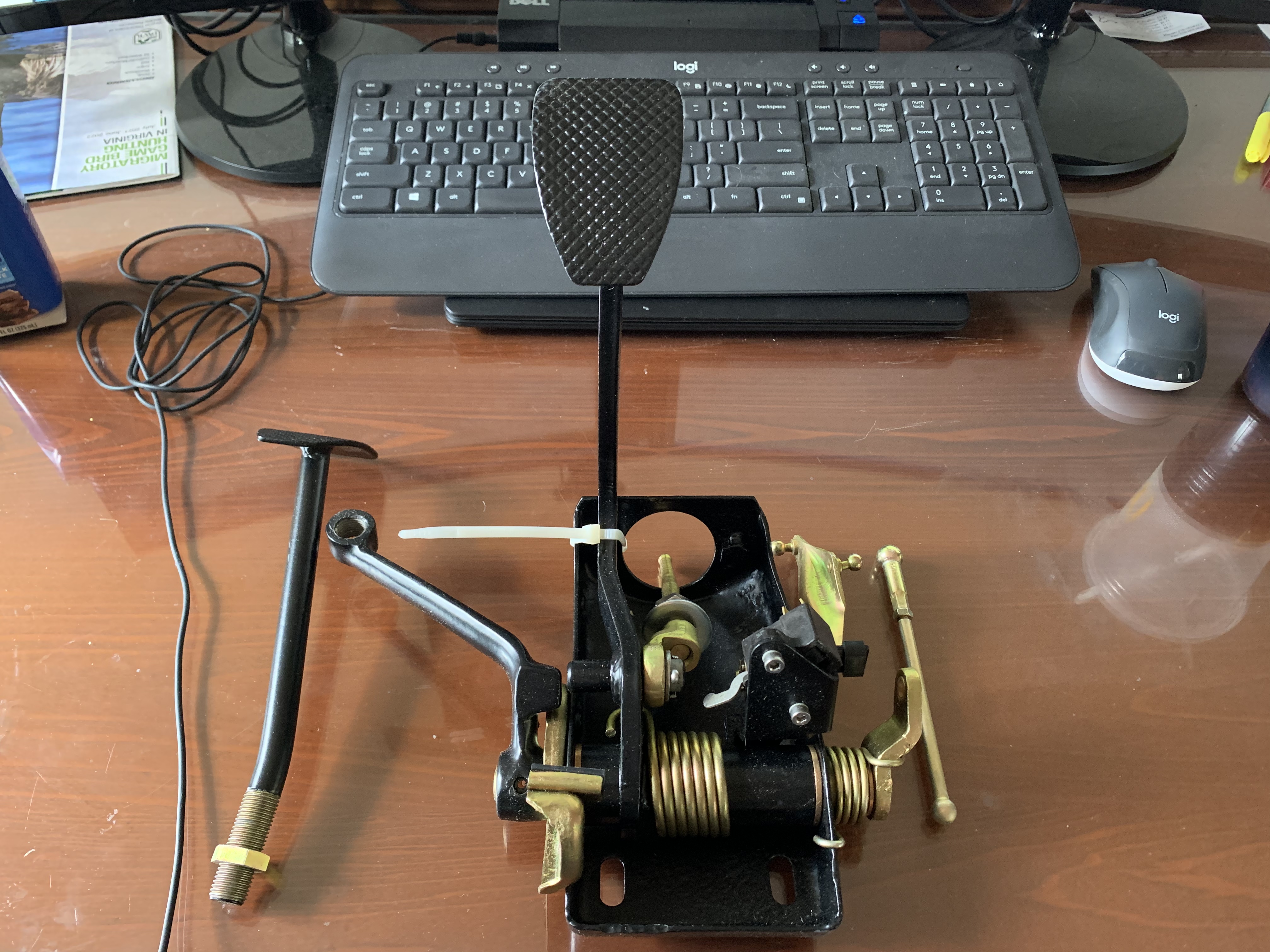

It’s beautiful; just received my pedal cluster after a full rebuild by Bruce.
Awesome work!

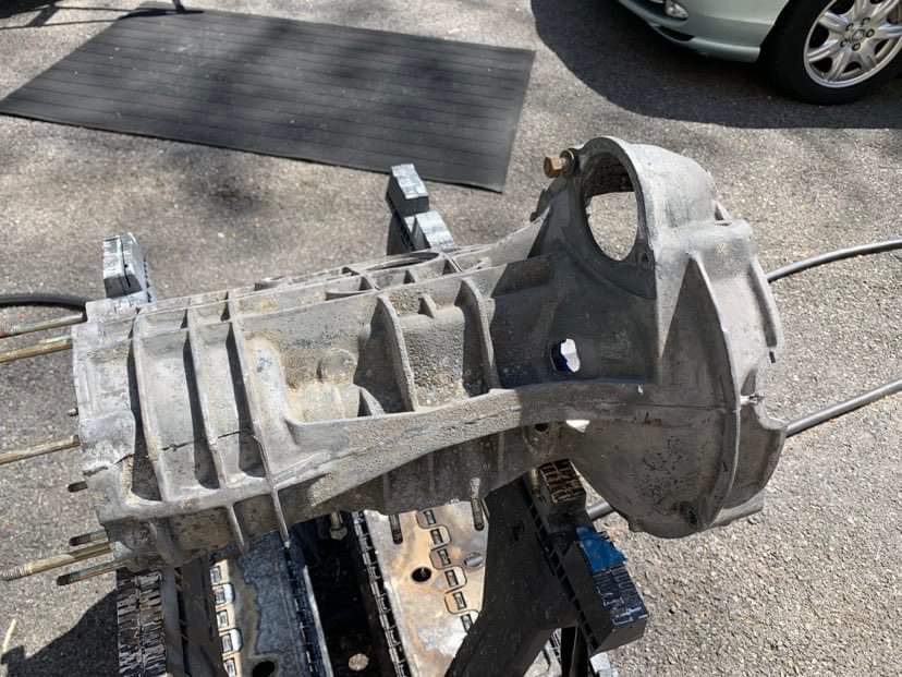

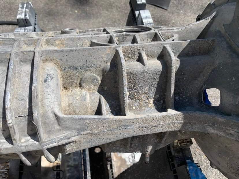

Used the weekend to clean the transmission case more. Here’s a couple pics after two cleanings, each one soaking in oven cleaner overnight
Still need to remove the crusty oxidation - looks like blasting may be the way to go.

I have seen I think it is called Vapor Hone blasting, (if memory serves) and it leaves the case like the day it was made. No damage to anything and beautiful results. (IMG:style_emoticons/default/beerchug.gif)

QUOTE(Cairo94507 @ Apr 25 2022, 10:37 AM) *
I tried glass beads on a small area yesterday; it cleaned up well, but leaves the pits from the corrosion. I’d like to find someone to vaporblast it, but so far the closest place I can find is 5 hours away. There are a few disadvantages to living in the SW Virginia mountains - but not many.
