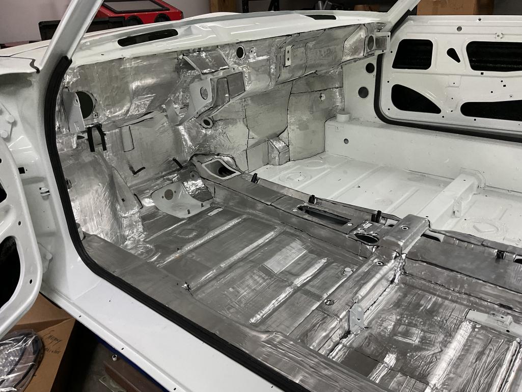

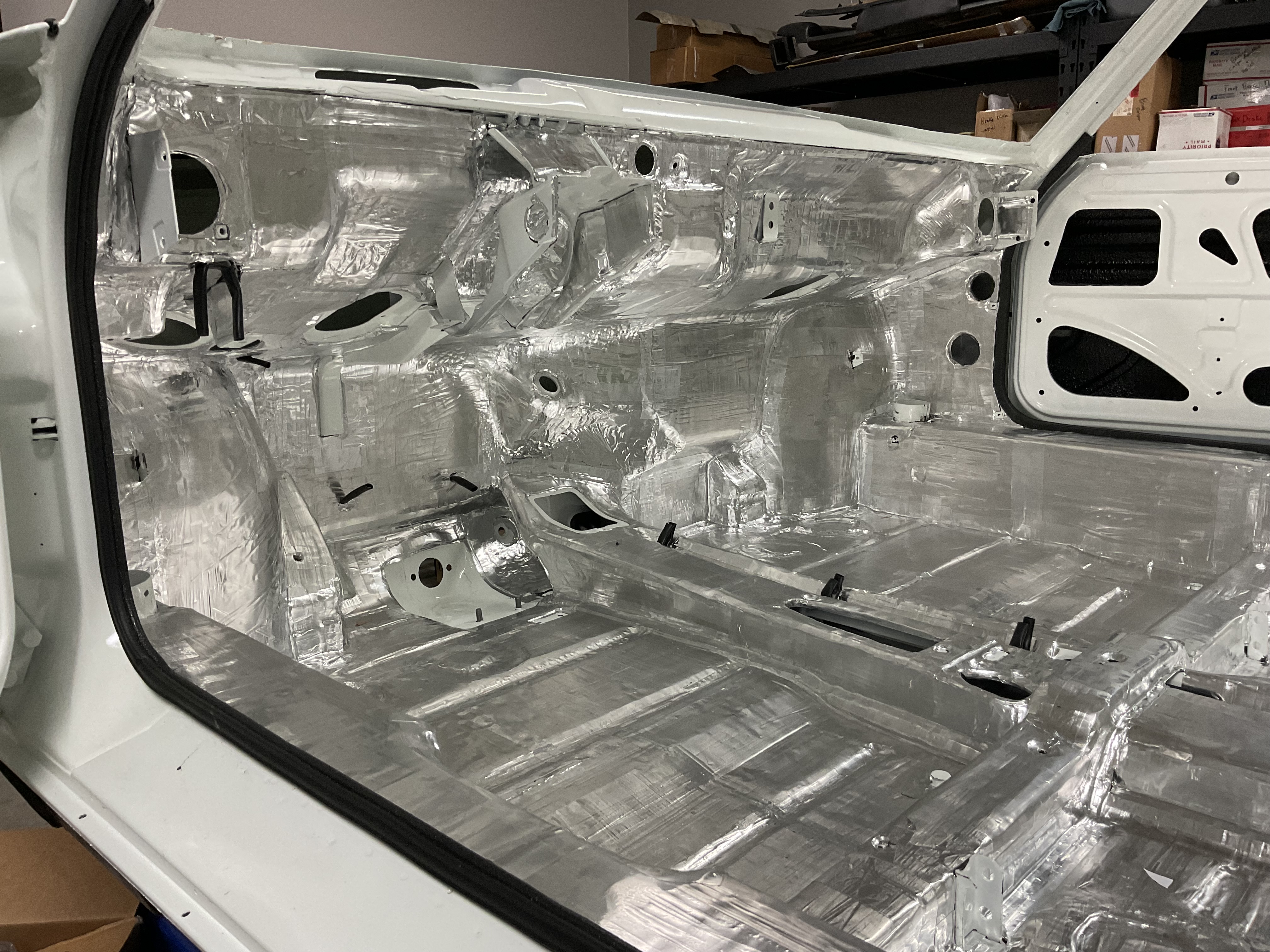

So, I now have much more time to work on the project. Decided to retire - so I can play with the 914 more of course.

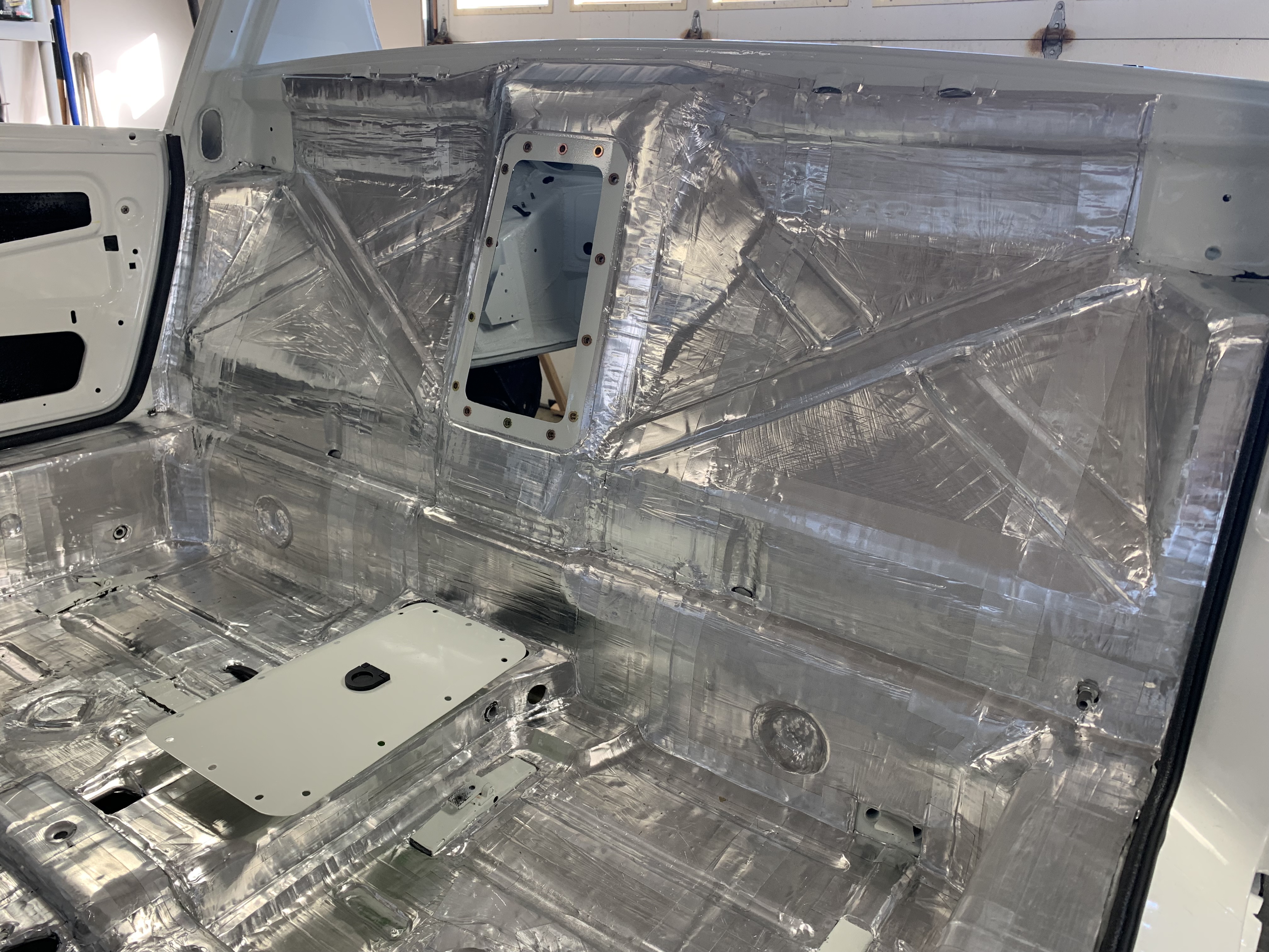

Anyway, I’m installing the Resonix Mega sound deadening on the interior. Should be complete in a couple more days.

Everything except for the firewall is complete; I need to order a few more sound damping panels. This stuff works really well.
Time to install the access panel.

QUOTE(Mitox @ Feb 13 2025, 09:17 PM) *
I have loved reading your build thread. It's quite an inspiration for me. You did a great job on everything. I wish I had access to your restoration/fabrication guy. What an artist.
Quick question: how many ResoNix panels did you end up using in total.

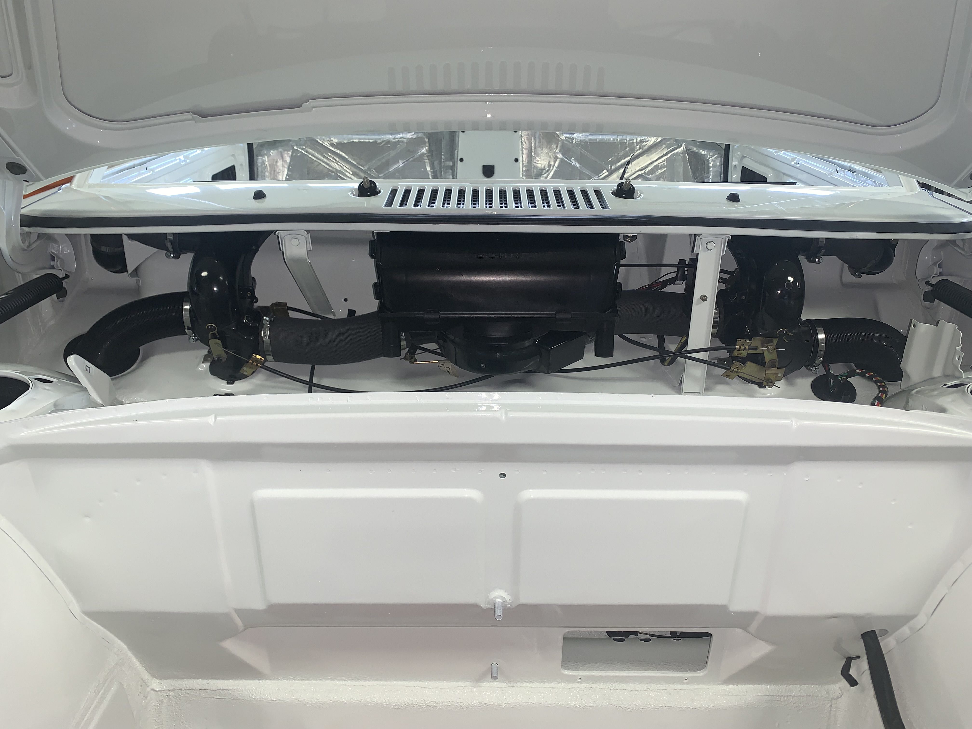

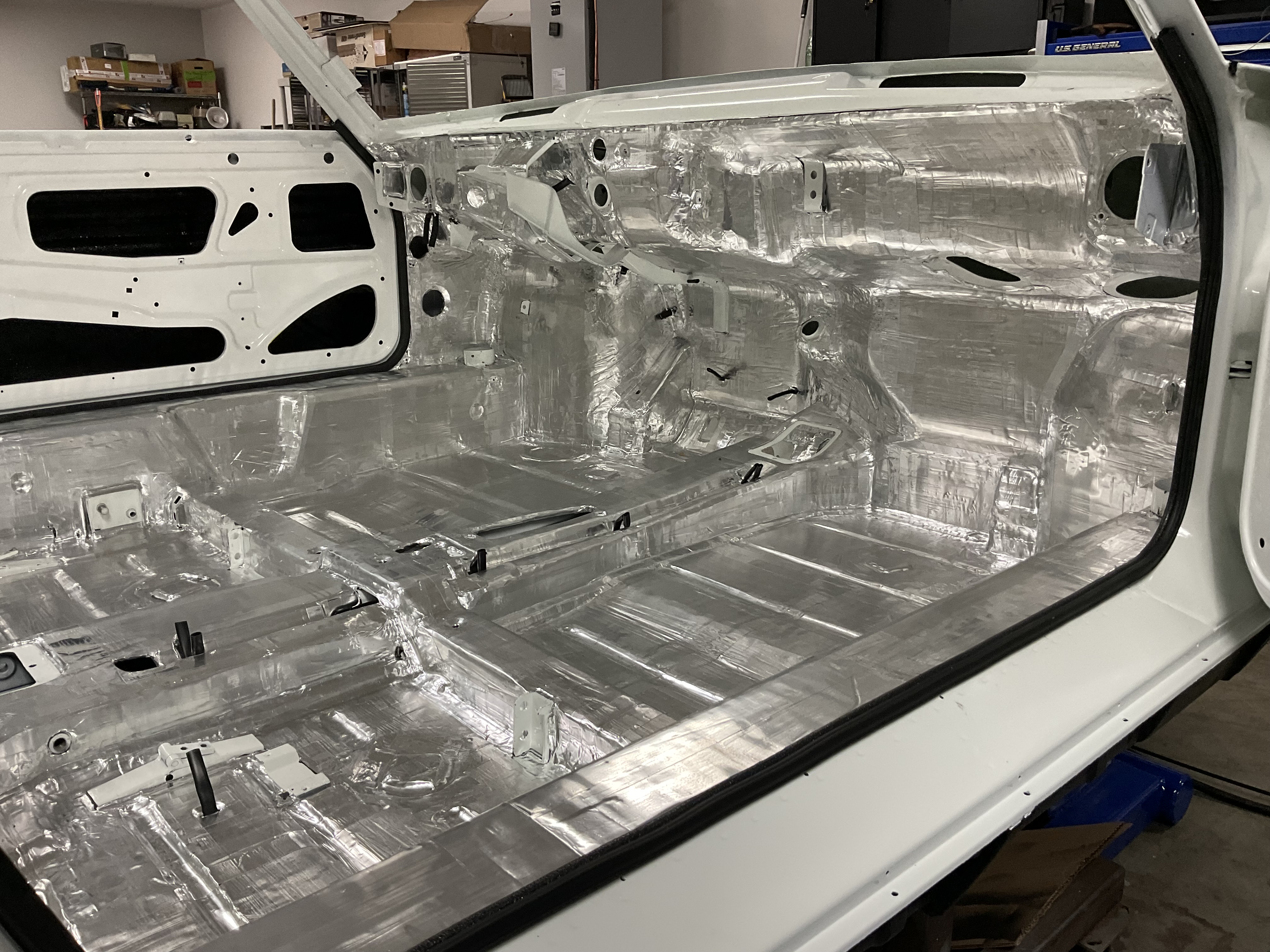

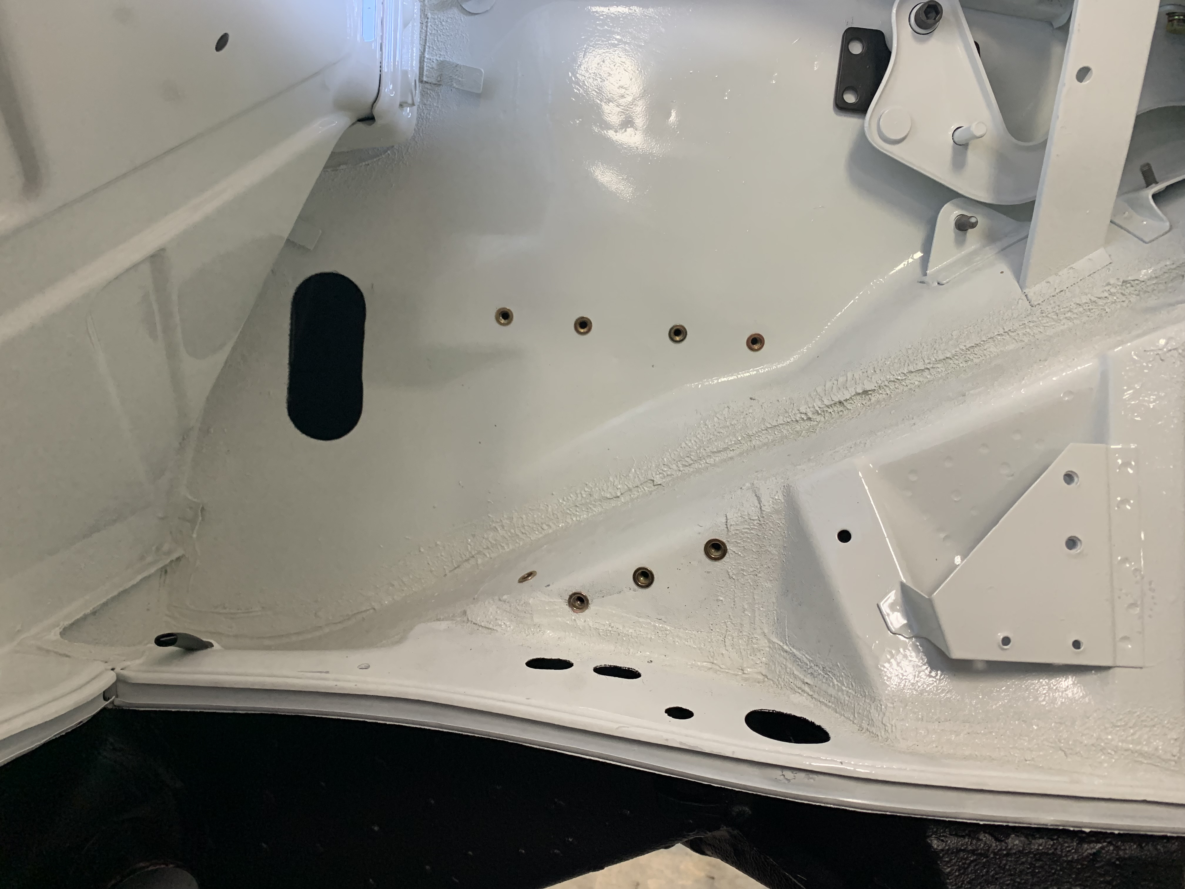

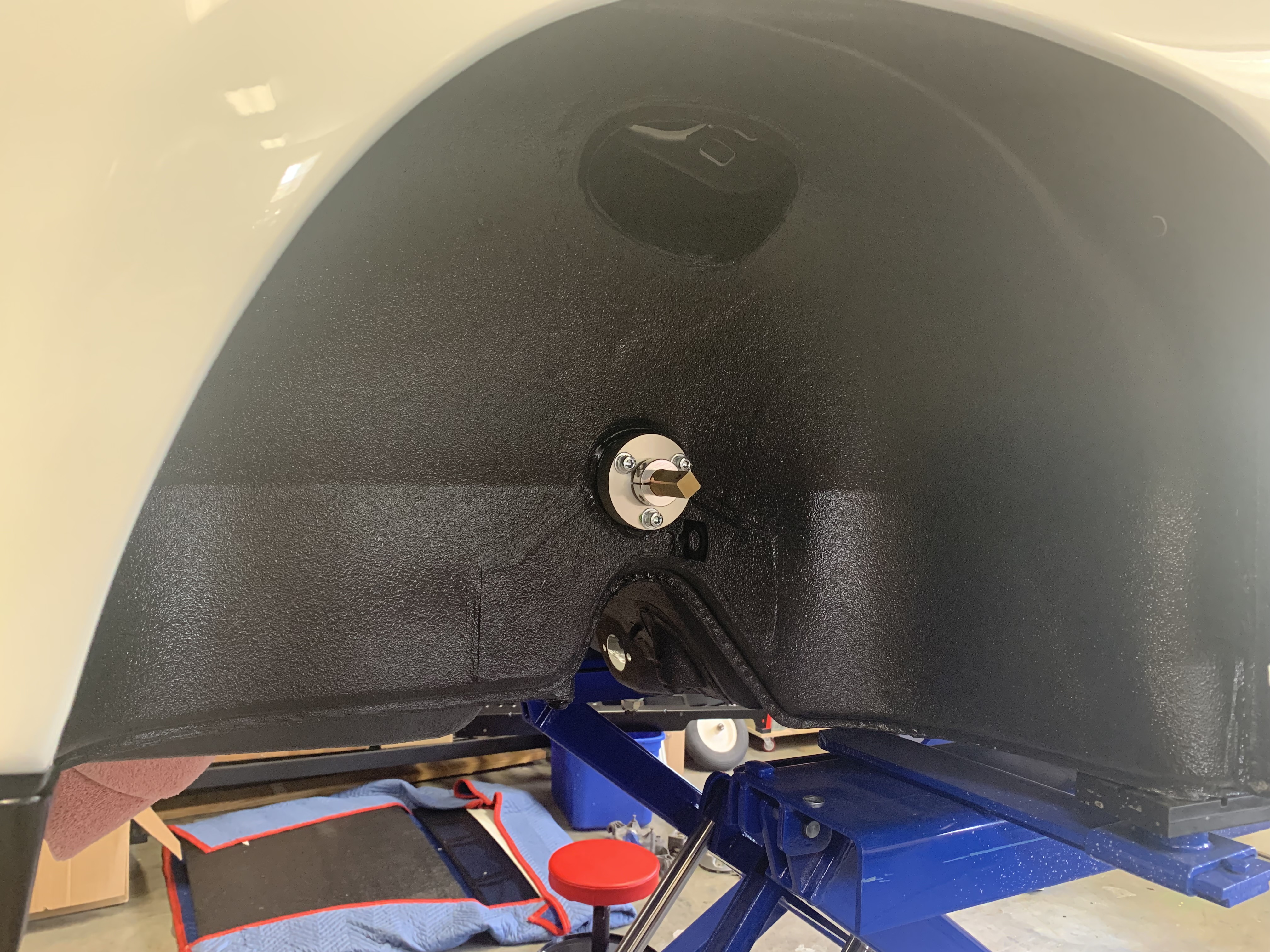

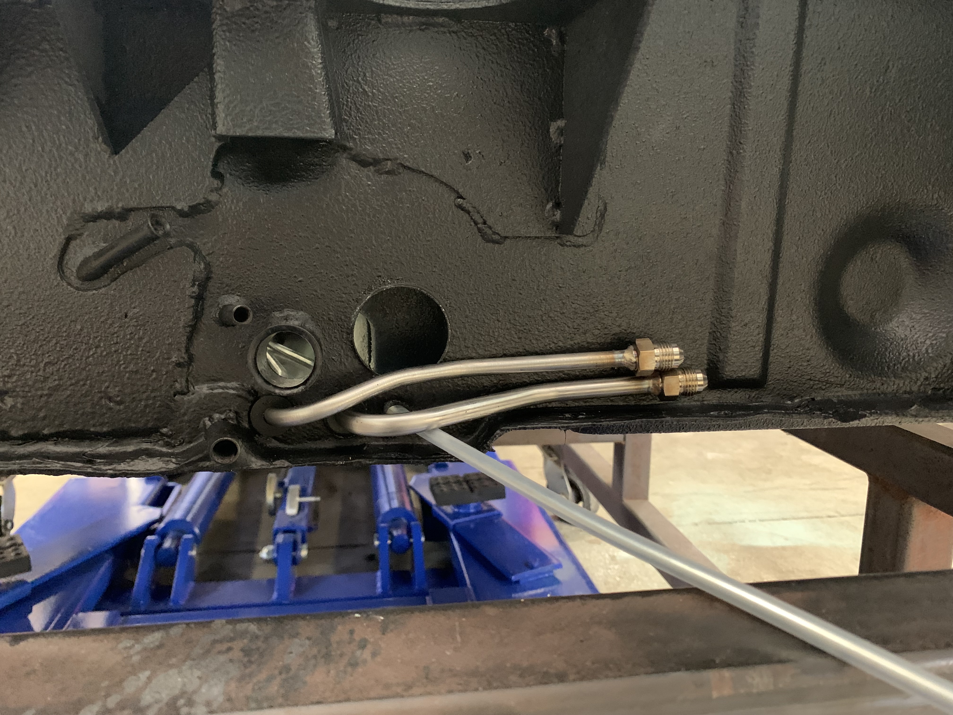

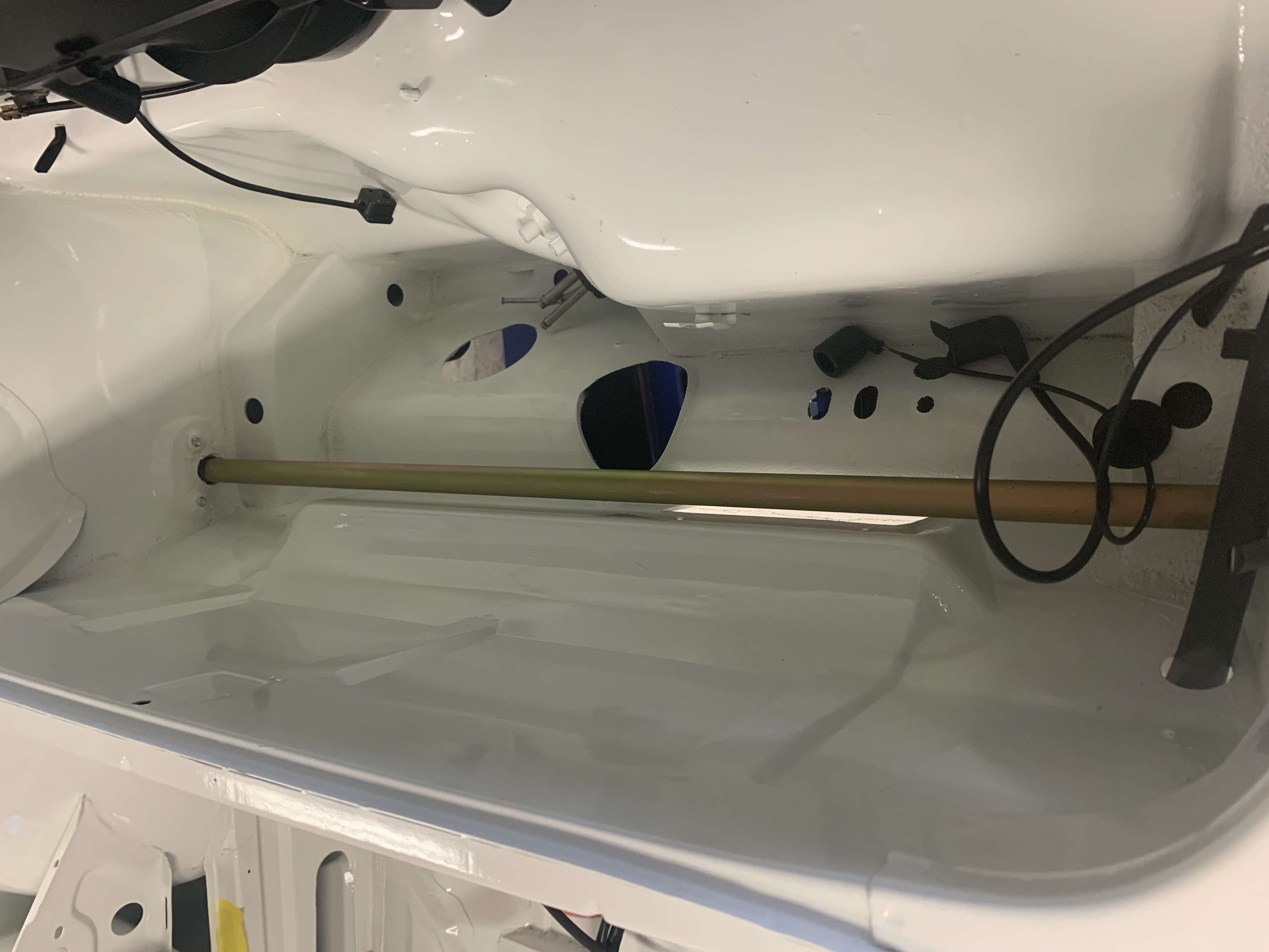

I’ve missed a few days in the shop, but have now finished the firewall sound deadening and the access panel.
The second picture is of the battery location; I decided to make the battery mount removable - for whatever reason.
Also, installed the stainless fuel lines and the evaporation line that still needs to be terminated.

QUOTE(Nein For Teens @ Feb 17 2025, 06:36 PM) *
I finished the firewall today, so in total, I used 54 panels.. Three panels worth are scrap trimmings, so 51 in the car.

QUOTE(colingreene @ Feb 28 2025, 01:00 PM) *
whats all that weigh?
Each tile is one pound, I think. So, about 51 lb., I’m not sure how that would compare to the original stuff I removed ( the asphalt and rubber pad behind the seat).

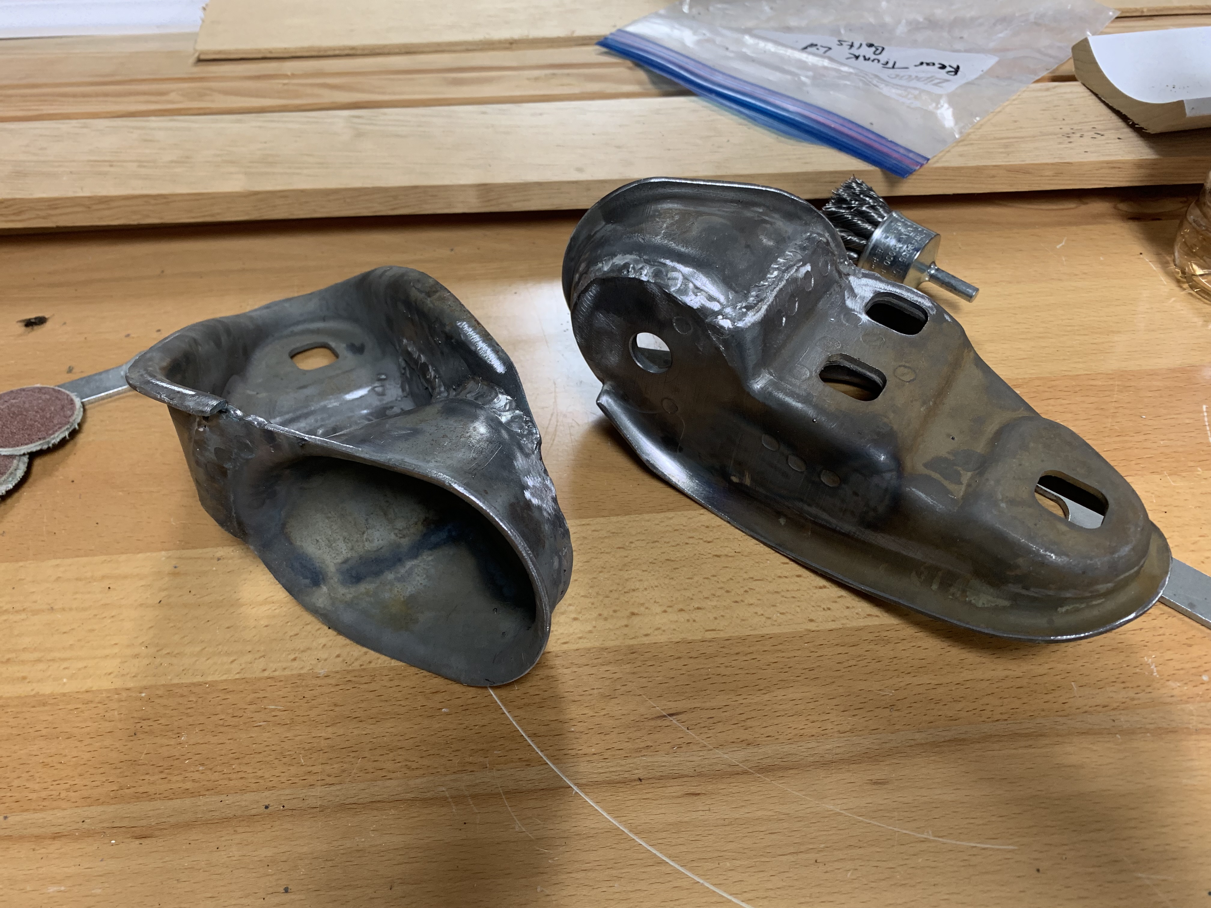

Few more updates. I should have taken more in-process pics.

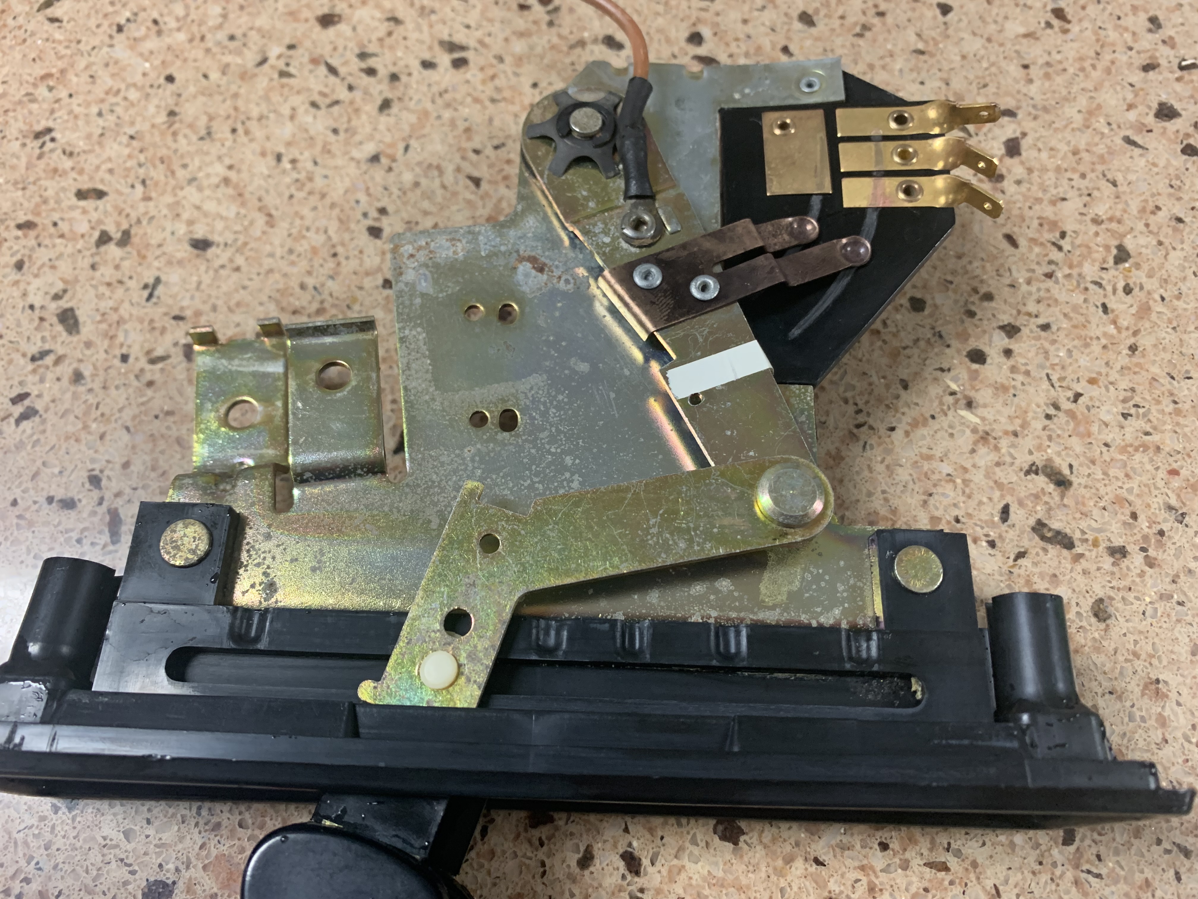

The Airbox was covered in paint from past repaints; cleaning it was torture, but it looks good now.
Cleaned the air control also. Sounds crazy, but since vinegar cleans copper oxidation well, I used catsup on the electrical connections - it works.

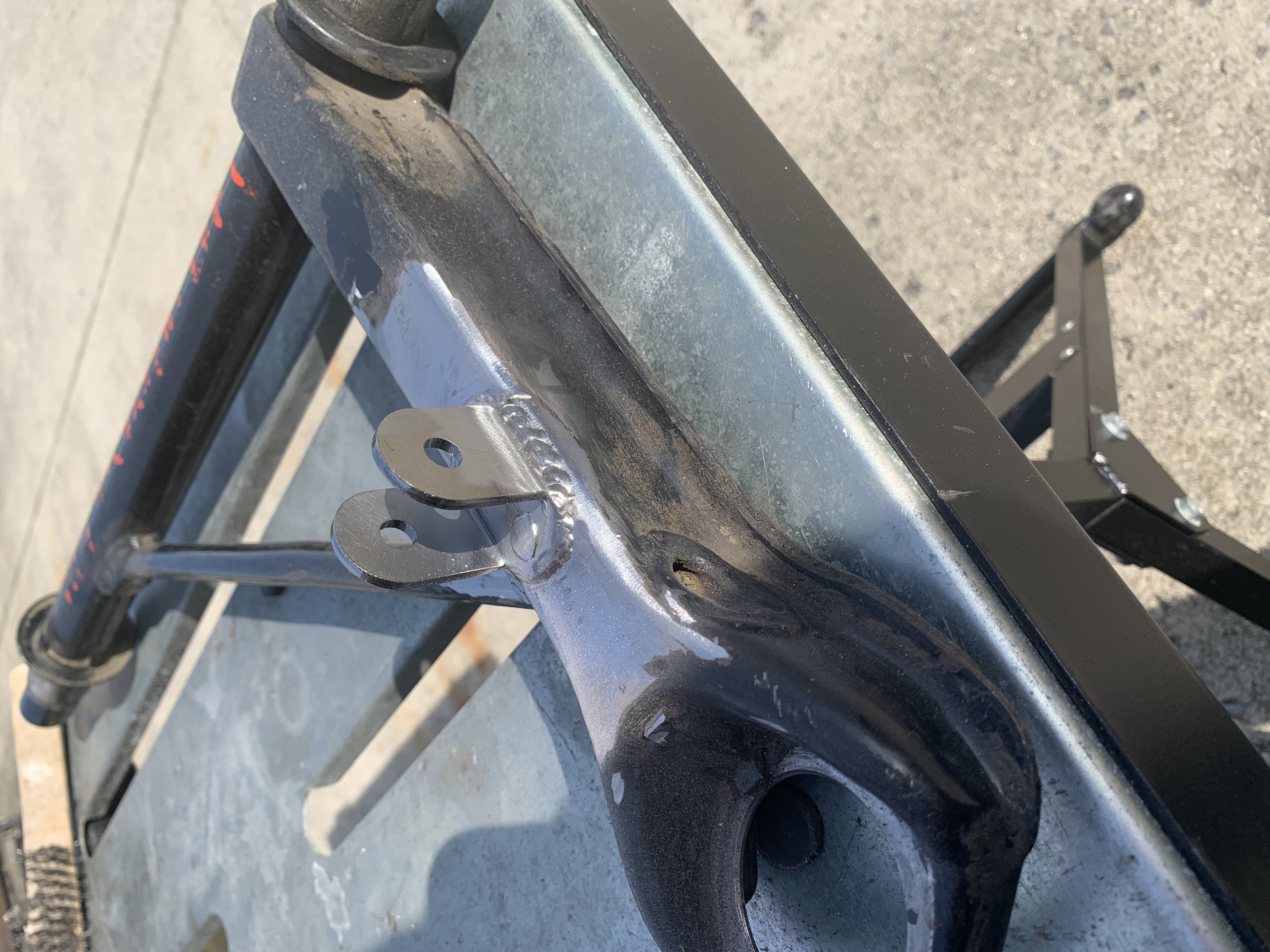

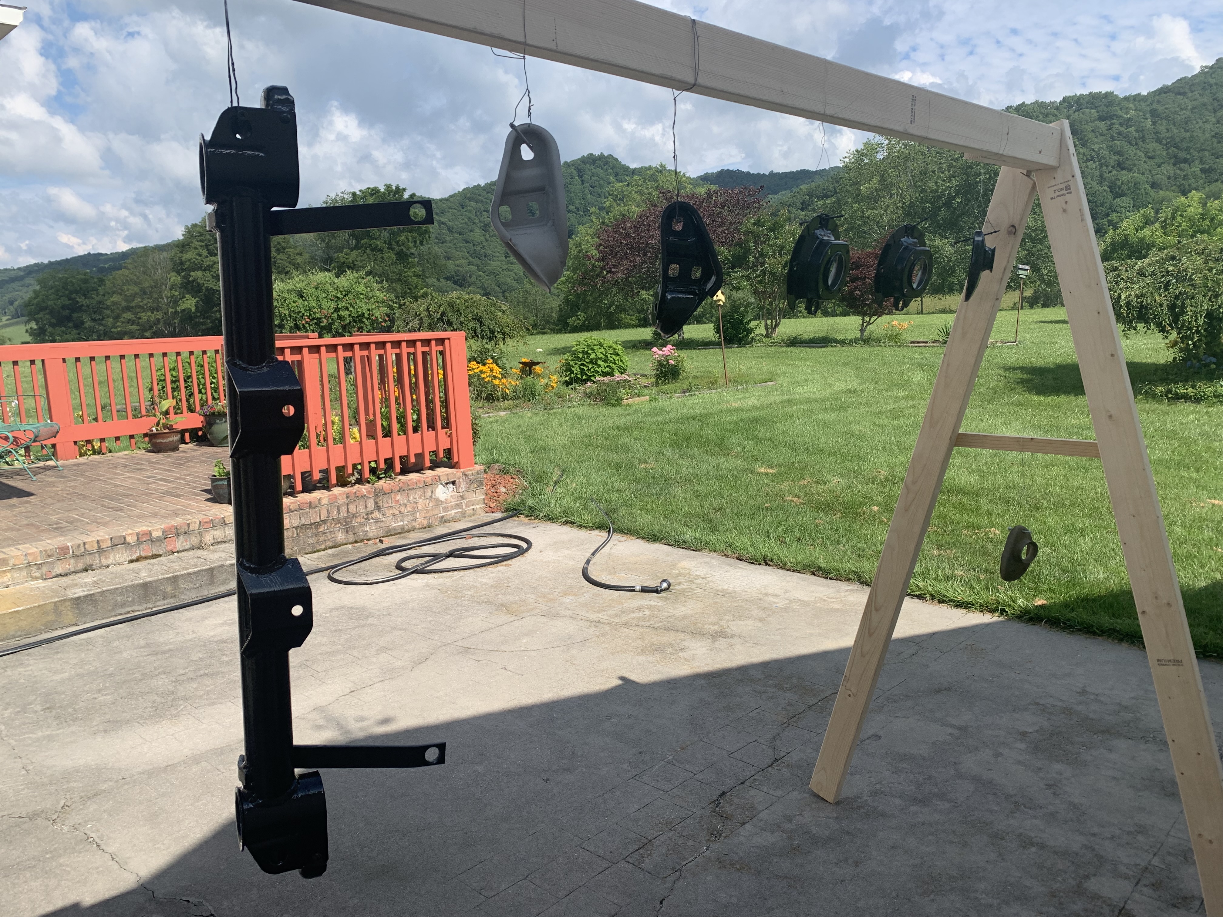

Been busy working on the suspension and brake bits also.
Just welded the sway bar brackets on, and welded up the seams on the rear trailing arm mounts. Blasting and painting in work now.

A few parts blasted, epoxy primed, and in paint
