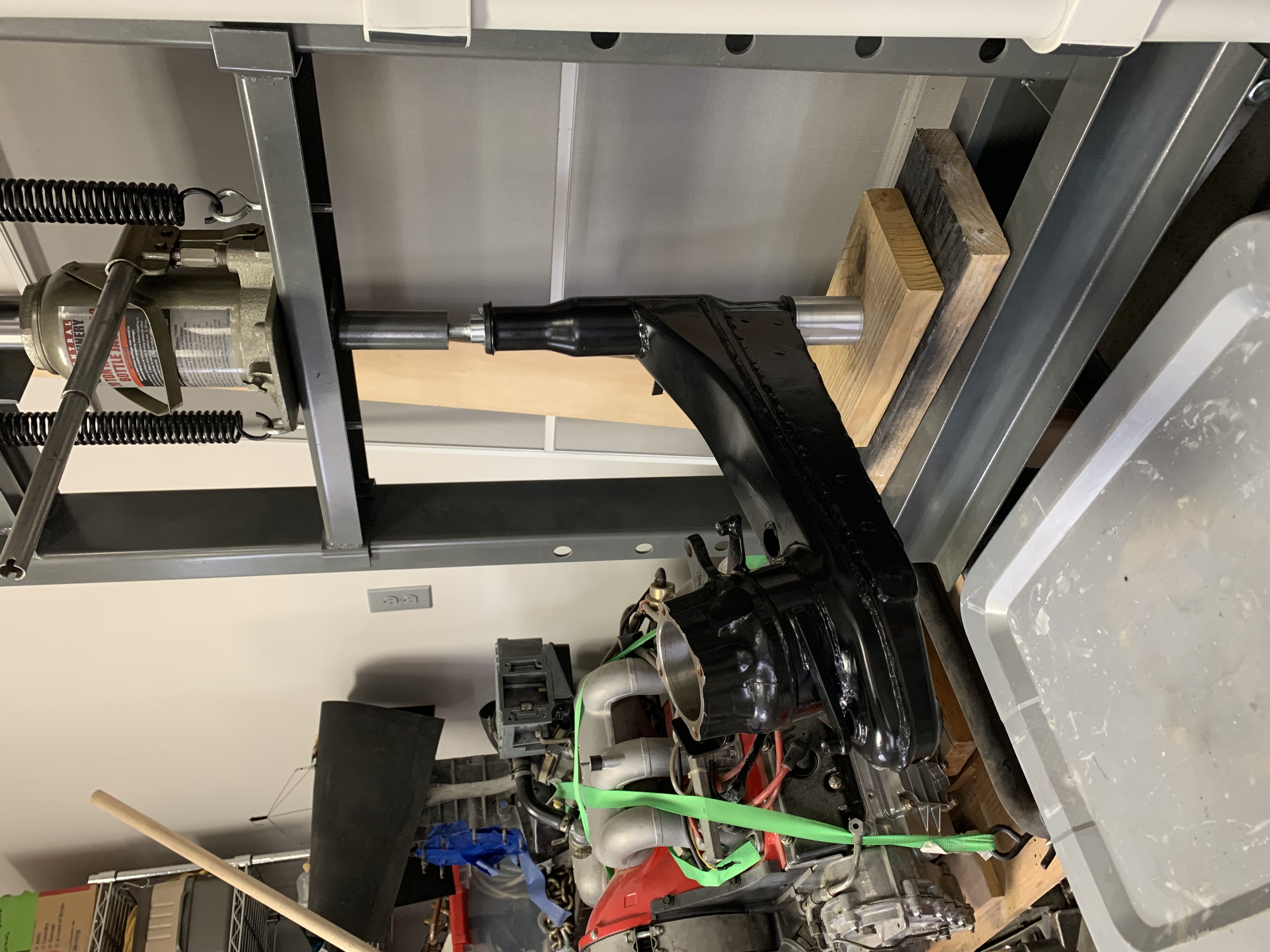

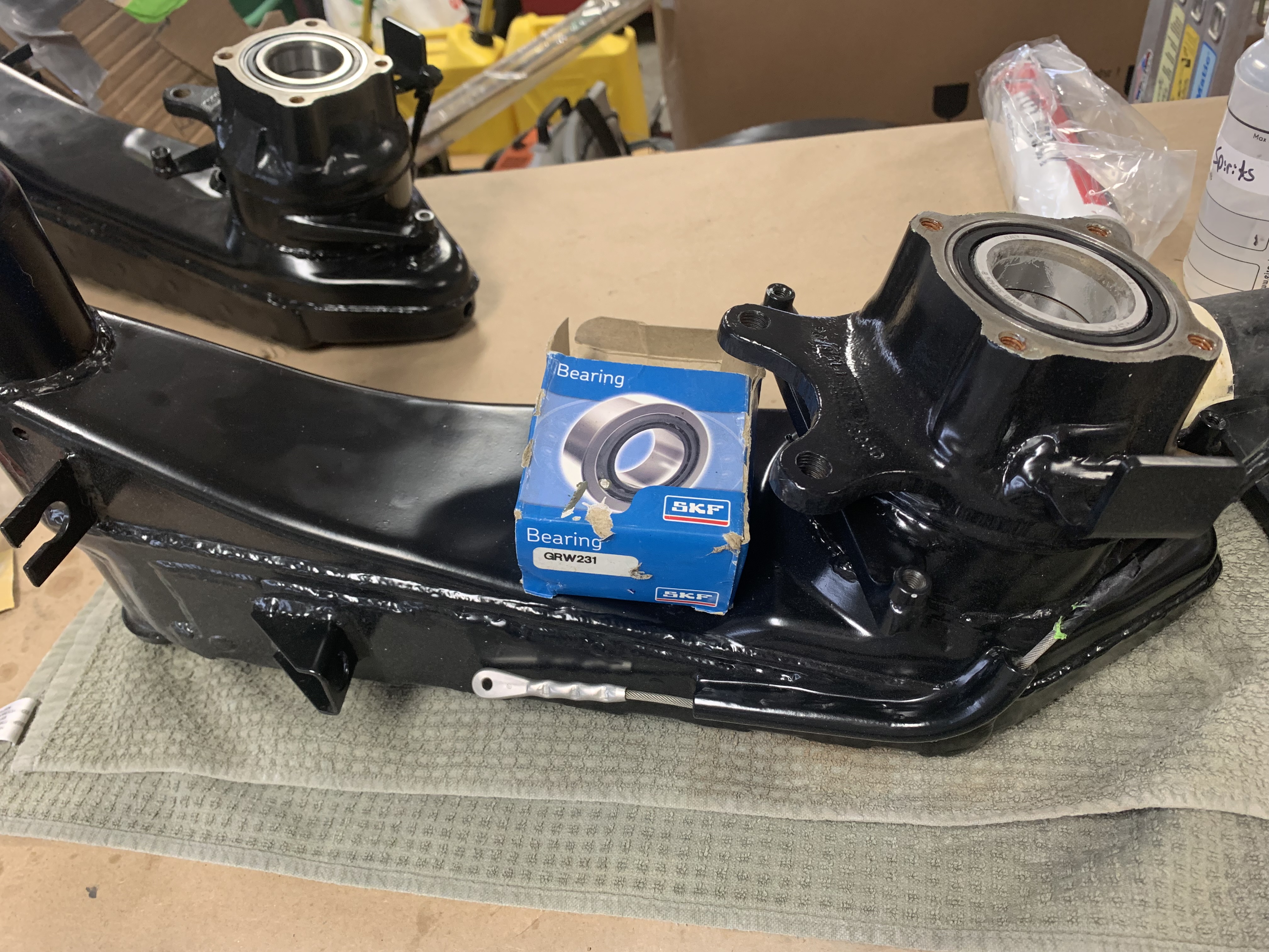

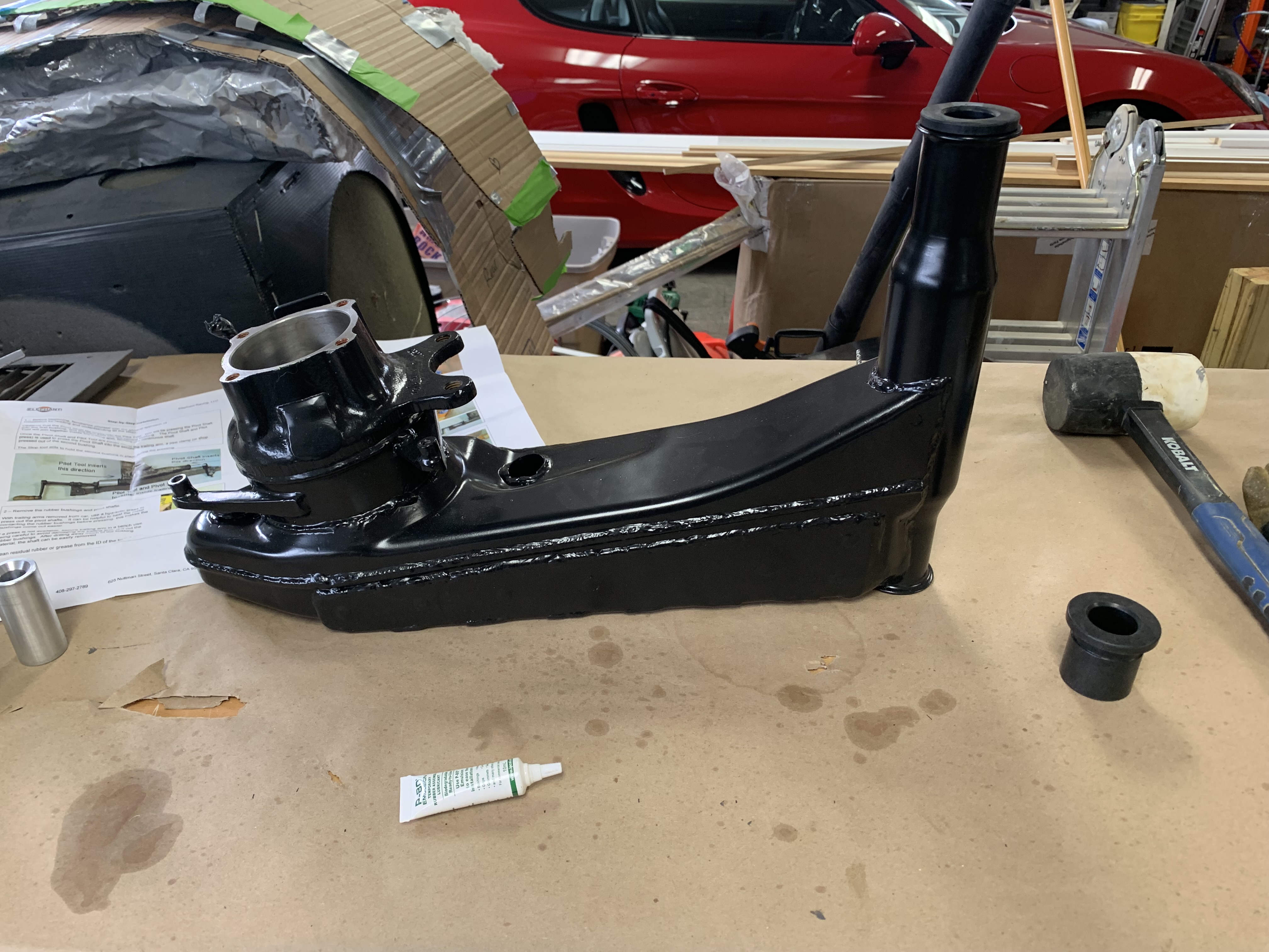

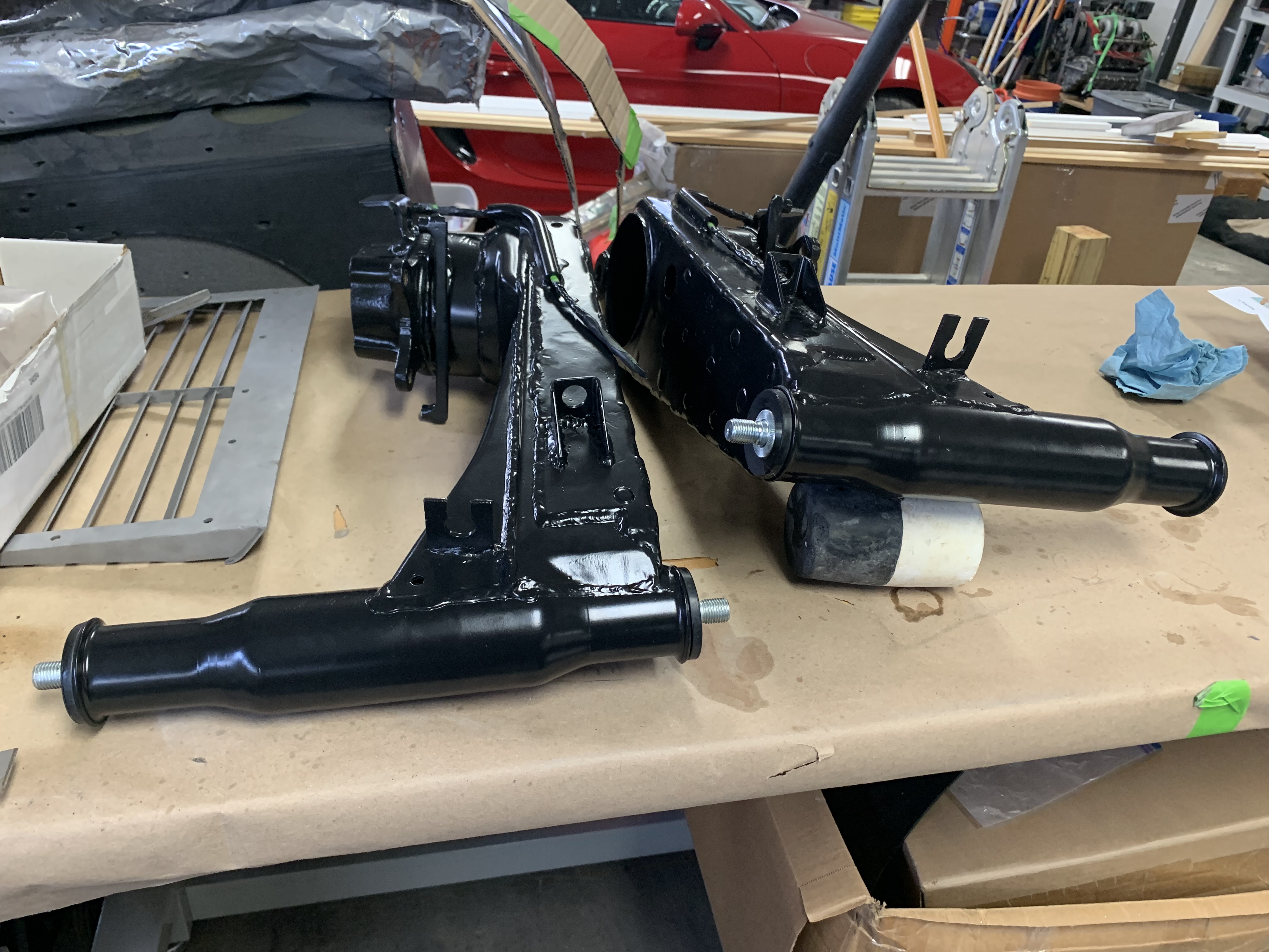

As always, I’m waiting on parts. So, I decided to assemble the trailing arms. First, the new Elephant pivot shafts and bushings purchased a long time ago are in place.

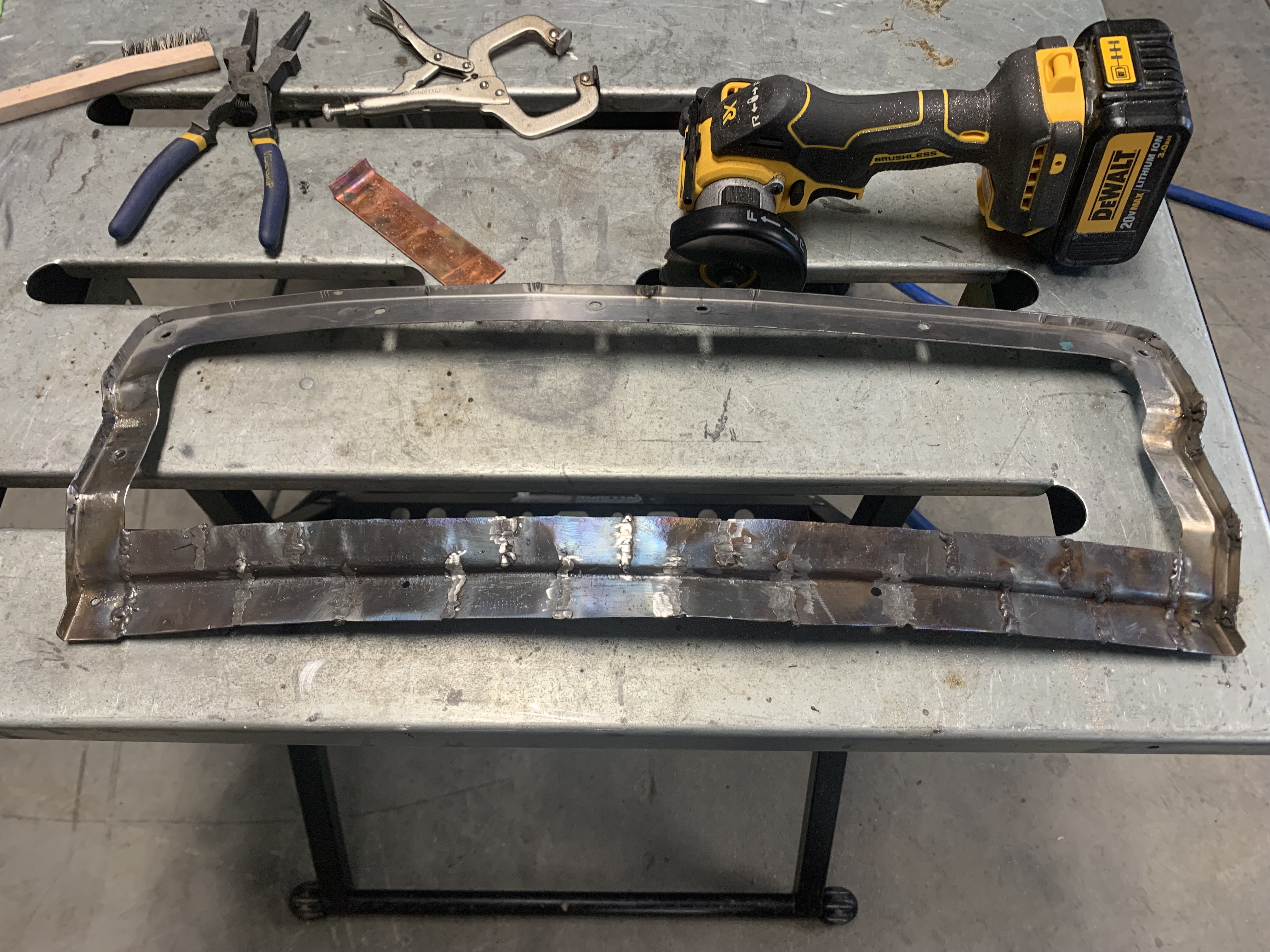

The bottom section of the grill is getting close. Needs welding and the final trim.

Welded done. Need to clean it up and trim it to the final shape.

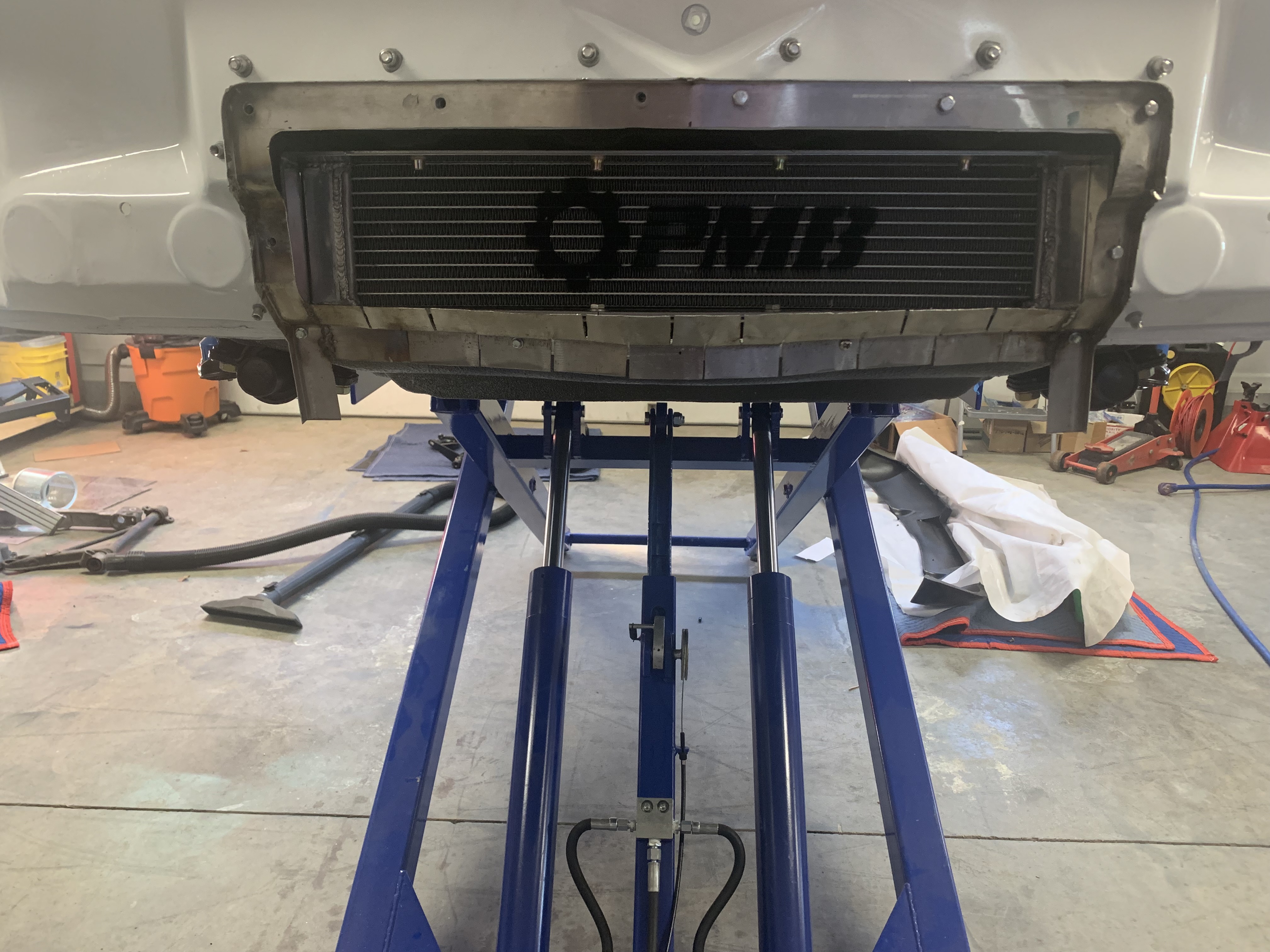

How's the oil cooler install going?

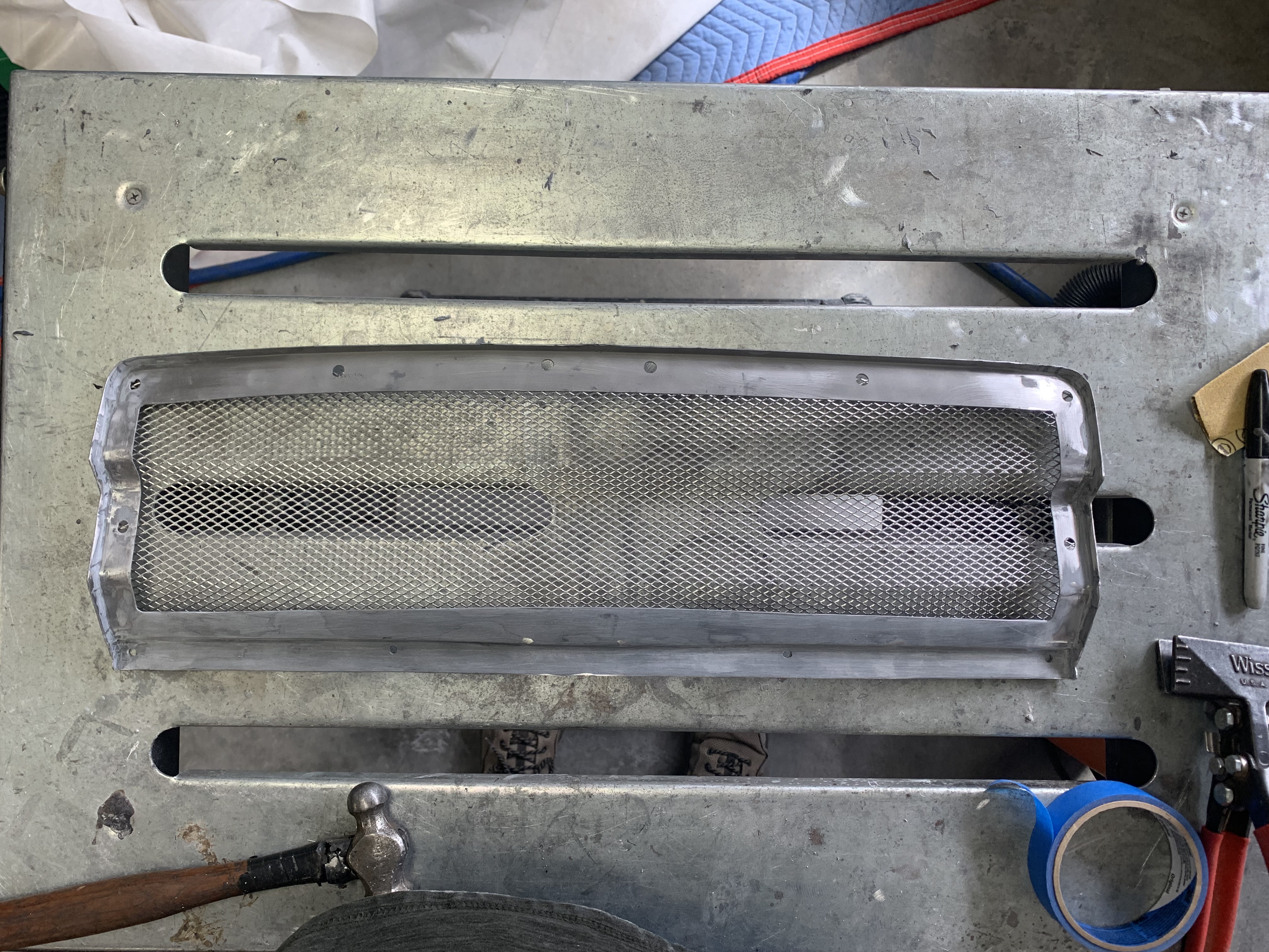

Warm weather pushed me outdoors for several days - had to trim trees and plant a few more.
Anyway, here’s a pic of the grill. Just need to attach the mesh to the frame and paint it.
Also, I’m still waiting on Elephant Racing to send me some hose to complete the fit up of the oil lines to cooler connections. After I get the hose, I’ll cut them to length and orient the connections correctly before sending them back to elephant for crimping ( I can’t find anyone near me to crimp them).

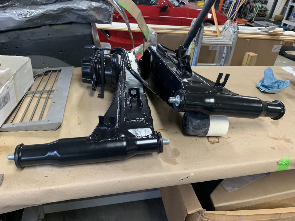

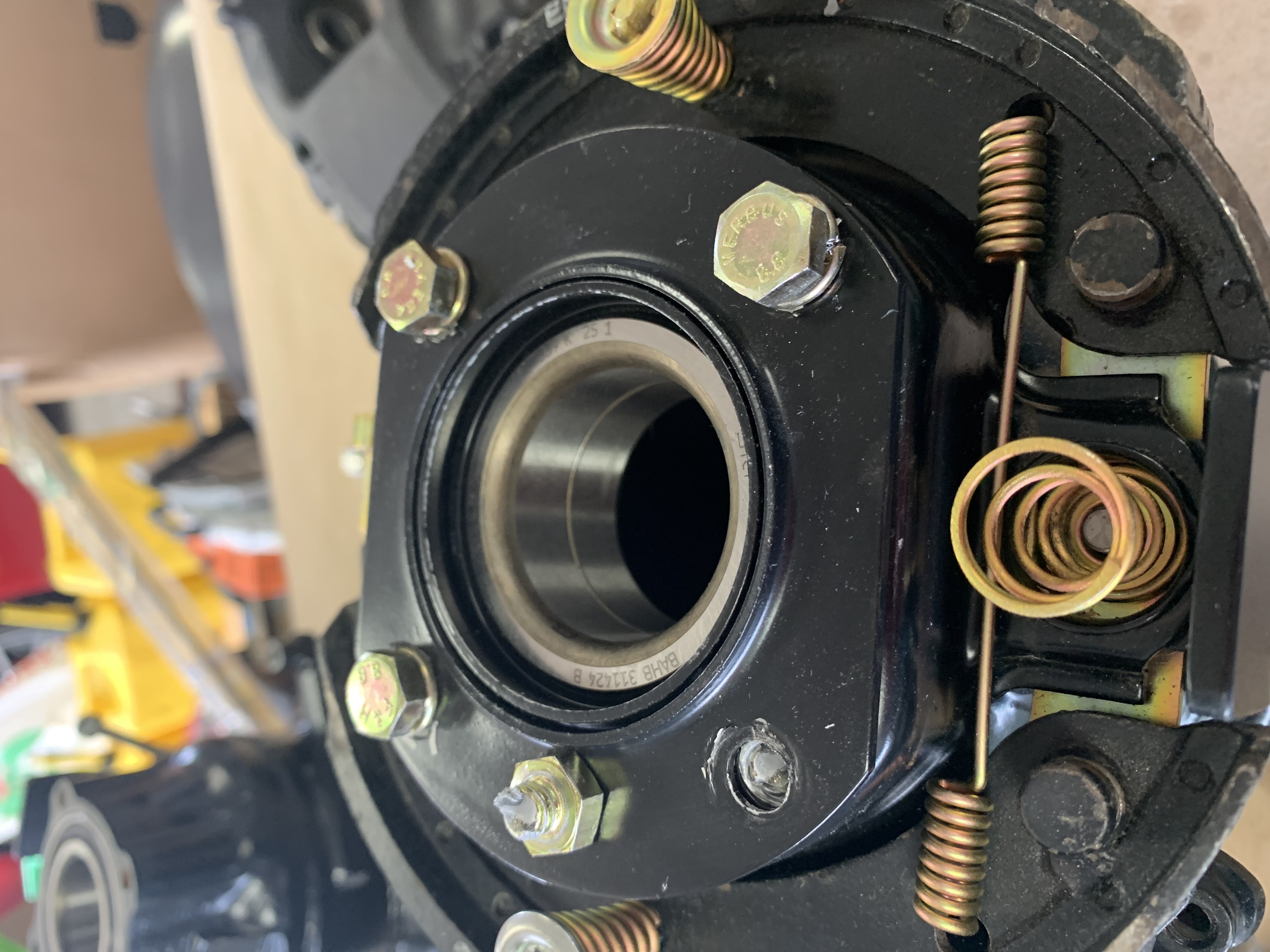

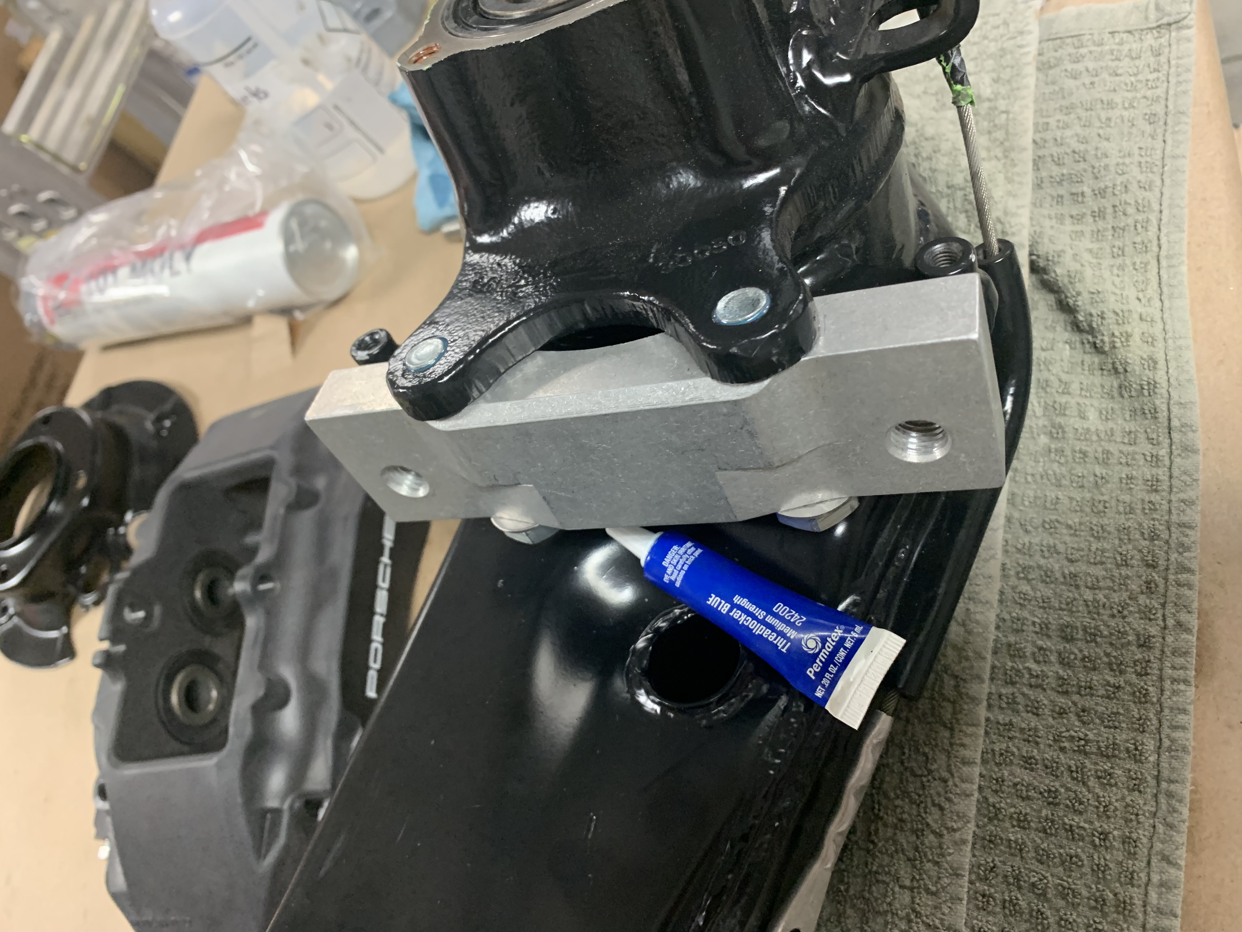

Worked on the trailing arms a little last evening. Frozen bearings made the install super easy. Also, mounted the adapters for Boxster calipers.

Hopefully there isn’t anyone as stupid as me out there - but - FYI
I had hardware replated for my restoration, but I’ve been very careful to use new bolts on everything so far; until today.
I was assembling the 911 e-brakes on the trailing arms, and realized I had used all of the new bolts I had. So, I started thinking about using the replated bolts - first mistake. Then I used them on the bearing retainer plate - second mistake. Then, upon torquing them one broke at very low torque - Clear sign of my stupidity.
Anyway, as you know, the replated parts can become brittle due to hydrogen embrittlement resulting from the plating process if not properly post treated.
So, to anyone considering using replated bolts on anything that needs to hold, don’t think about it - no, stop thinking - just get new bolts.

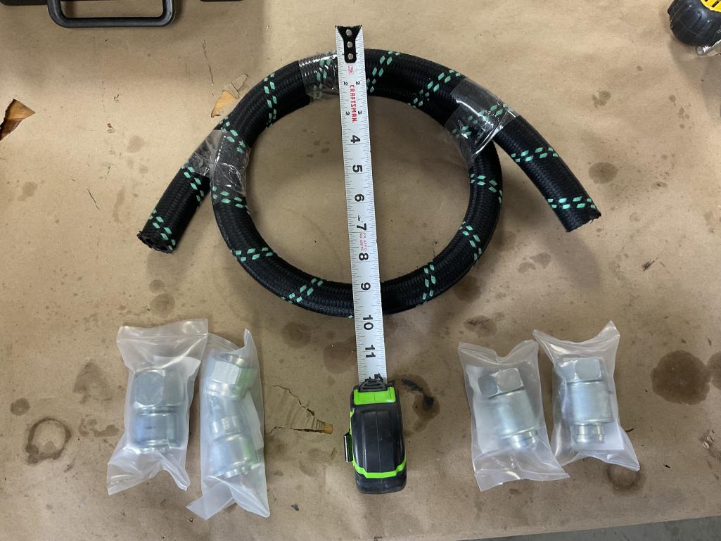

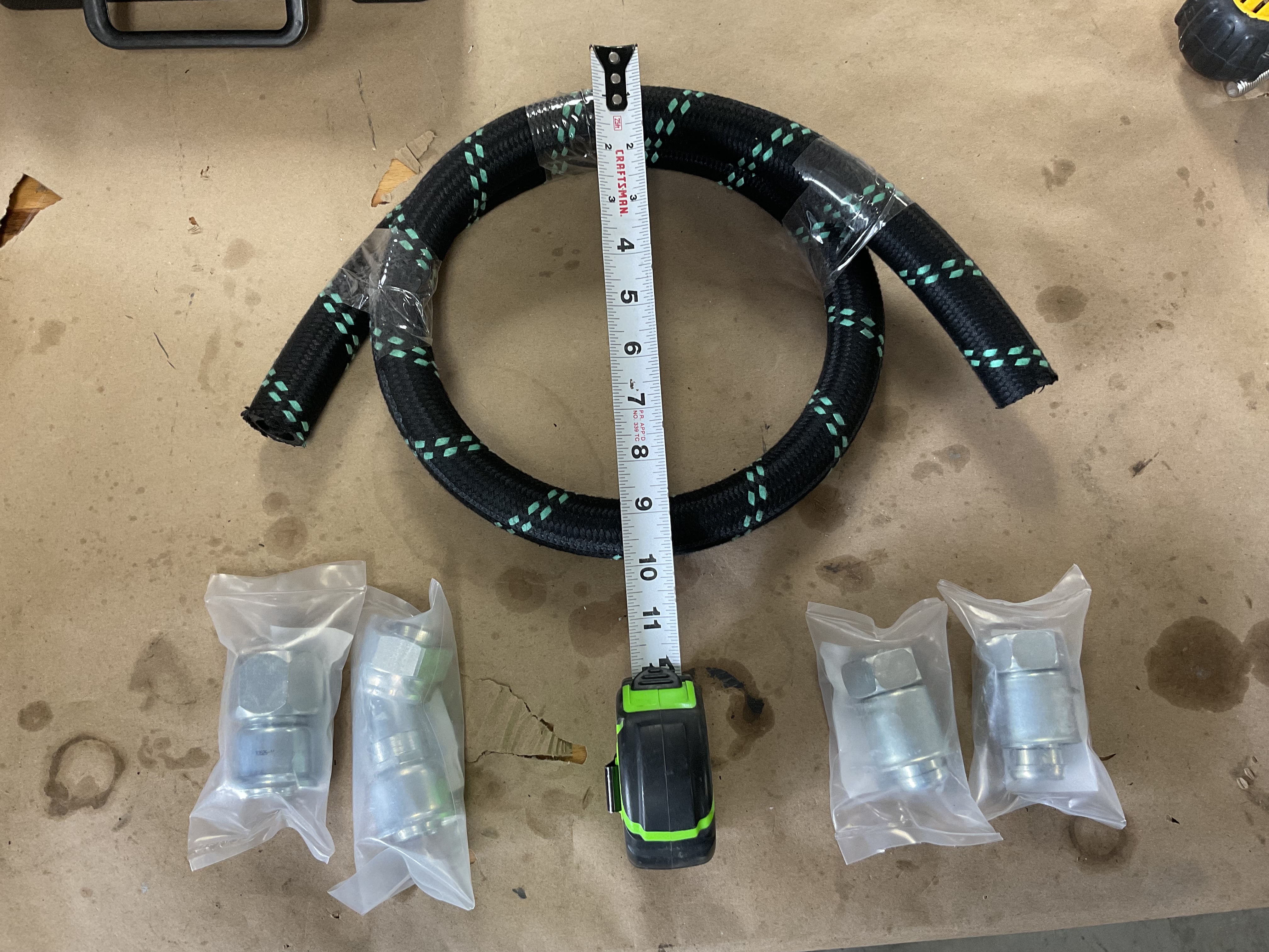

The oil hose and fittings from Elephant Racing arrived this morning. I’m using 30mm to connect the hard lines, and AN16 at the cooler connection.
One note that may be of interest to some: the green stripe hose can be bent to about a 5” radius - measured at the OD.

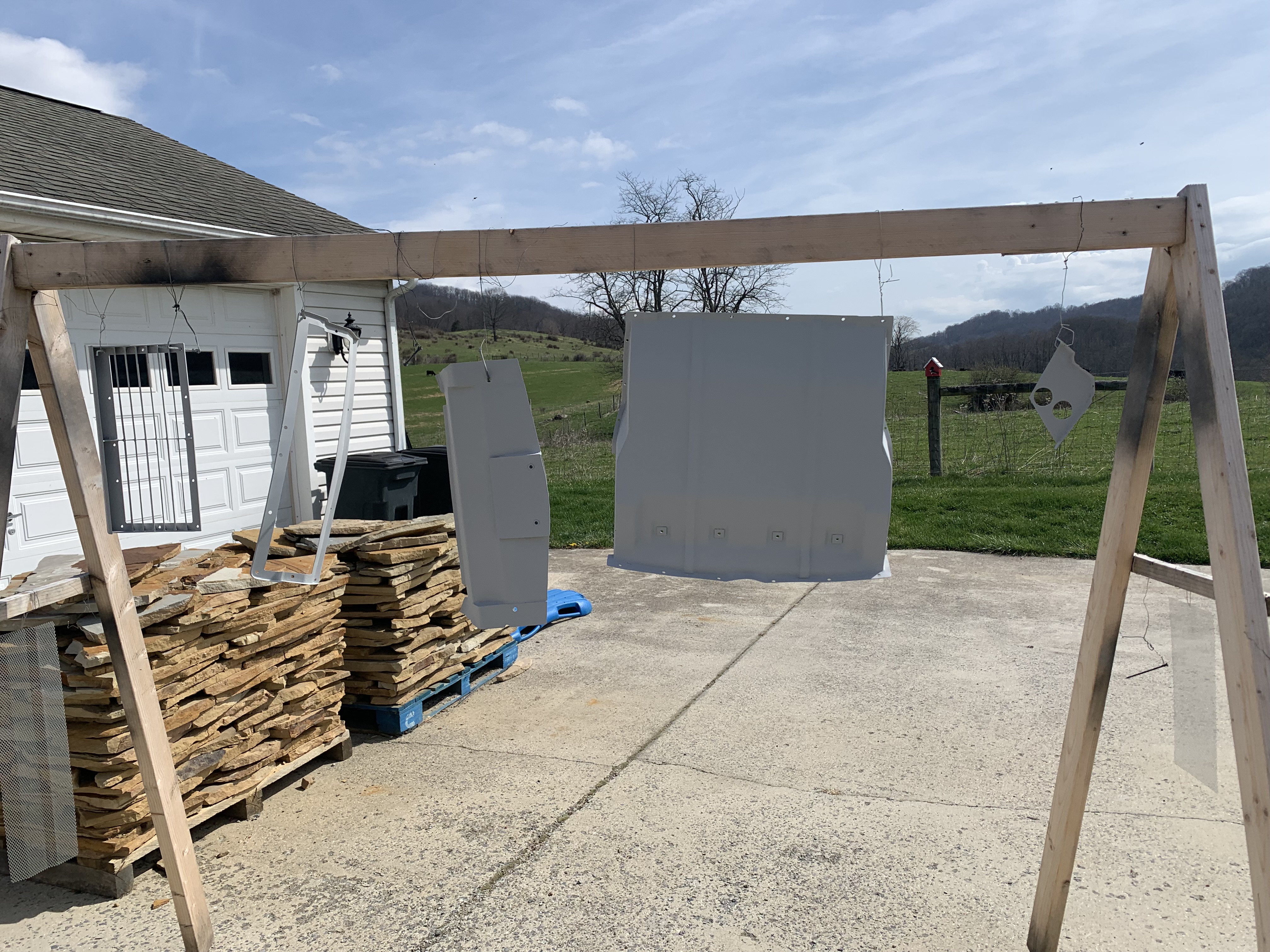

Warm day today - parts are now in primer

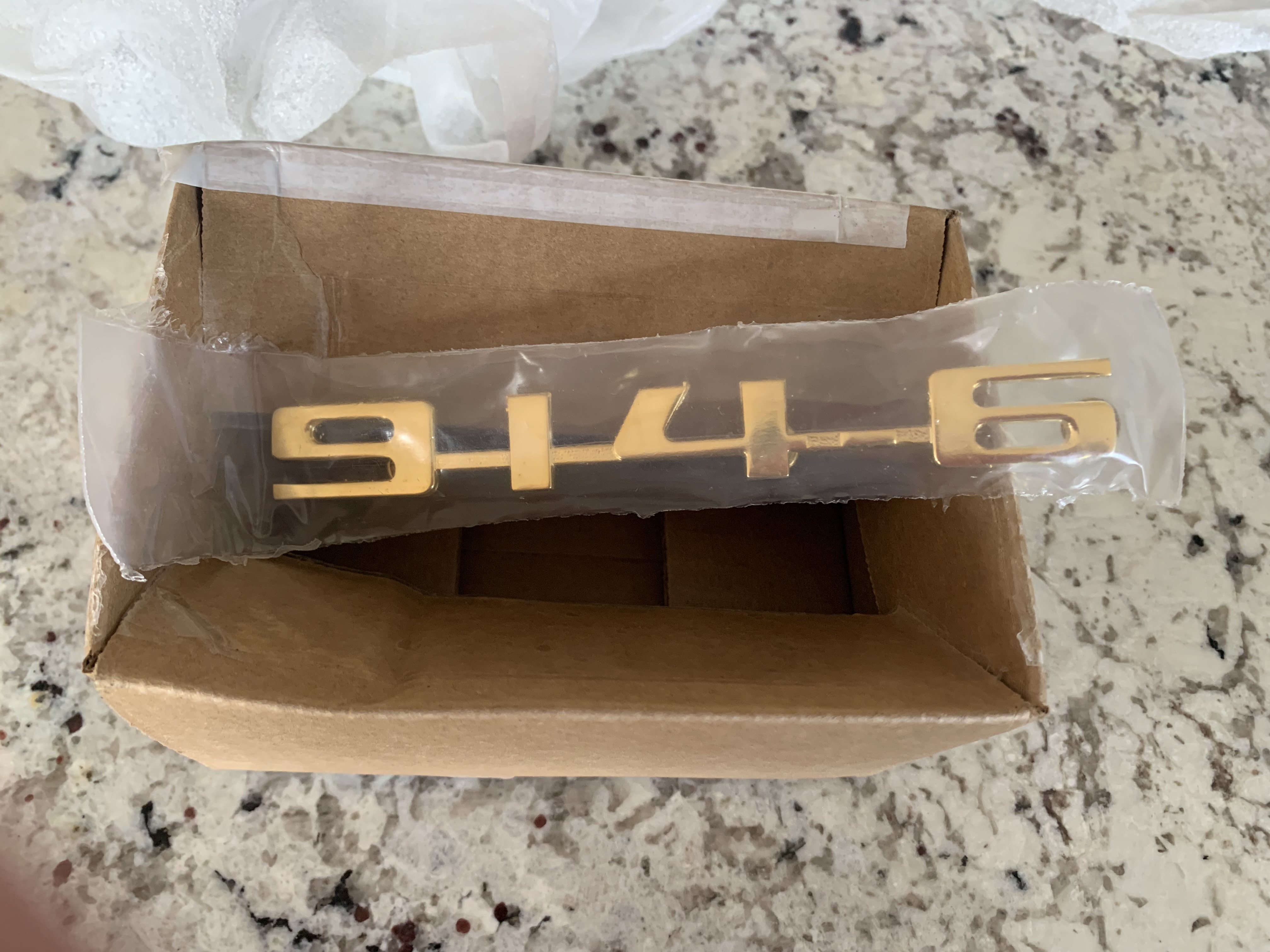

The 914-6 emblem arrived today. Not perfect, but it’s a good reproduction.
