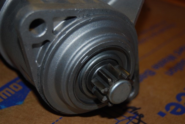

Finally got time to remove the starter to see if the scraping was perhaps due to the brass bushing coming loose as reported by the CabinetMaker (Curt?). Nothing amiss that I can see. This is a relatively new SR17X. Am I missing something?Attached Image. Oh, and engine bar is tight in the mounts.

Maybe I'm getting old , well ok...I am. That starter looks wrong to me
TheCabinetmaker
post Aug 15 2016, 06:23 PM
I drive my car everyday
Posts: 8,375
Joined: 8-May 03
From: Tulsa, Ok.
Member No.: 666
I'm old too, but starter looks right to me. What do you see wrong Rich?
