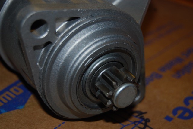

TX914
Finally got time to remove the starter to see if the scraping was perhaps due to the brass bushing coming loose as reported by the CabinetMaker (Curt?). Nothing amiss that I can see. This is a relatively new SR17X. Am I missing something?Click to view attachment. Oh, and engine bar is tight in the mounts.
r_towle
Maybe I'm getting old , well ok...I am. That starter looks wrong to me
TheCabinetmaker
I'm old too, but starter looks right to me. What do you see wrong Rich?
