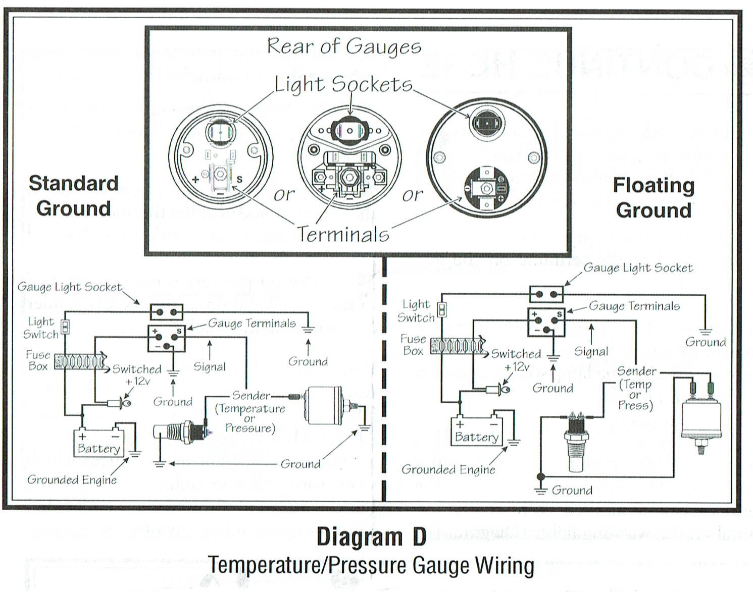

I got oil pressure and oil temp gauges. The instructions are generic and I'd like some specifics about how to install them on my 1.7L '72. Sorry if these seem obvious; I've never done this before.
1. Standard ground or floating ground? I'm leaning toward floating because it looks obvious how to attach the ground. On the standard ground, how do I attach the gnd wires?
2. What do I attach the wire from the gauge light socket to the light switch to? The headlight switch? Which connector?
3. Which fuse do I use for power? #9?
4. I figure I will just attach grounds to a screw on the body, either an existing one or a new one.
5. What is the "switched +12v" light shown in the instructions? The dummy light?

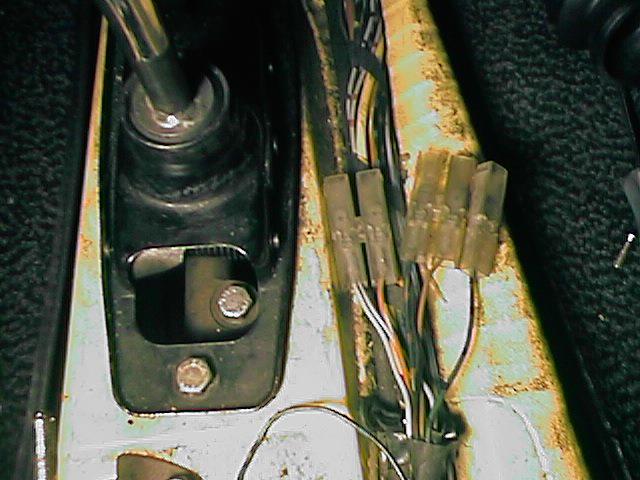

where are you mounting the gauges?
if your mounting them in a center console there is already wires for power, ground, switched power, oil temp, and the blk/blu wire for gauge illumination.
for the oil pressure sender, the sender will not fit in the existing hole you have to remove the oil pressure switch next to the dizzy and use hose to mount the sender on the fan housing or wherever you decide.

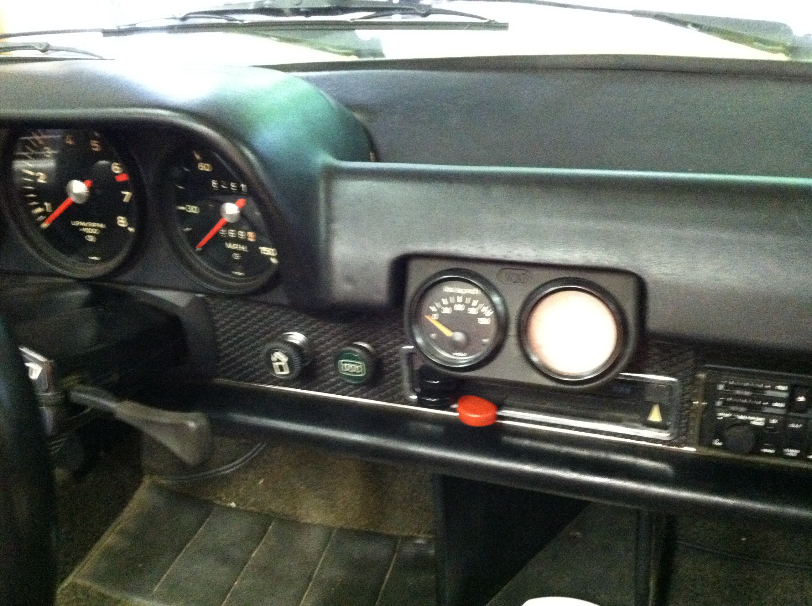

I'm mounting the gauges under the dash with a 2 gauge bracket. There is no center console. Looks like I'll be adding wiring, but someone confirm this.

Unless you use the ashtray, this makes a convenient mount using the VDO rubber bracket. Just cut off the angled top and then use the ashtray mounting holes to attach the bracket.Attached Image

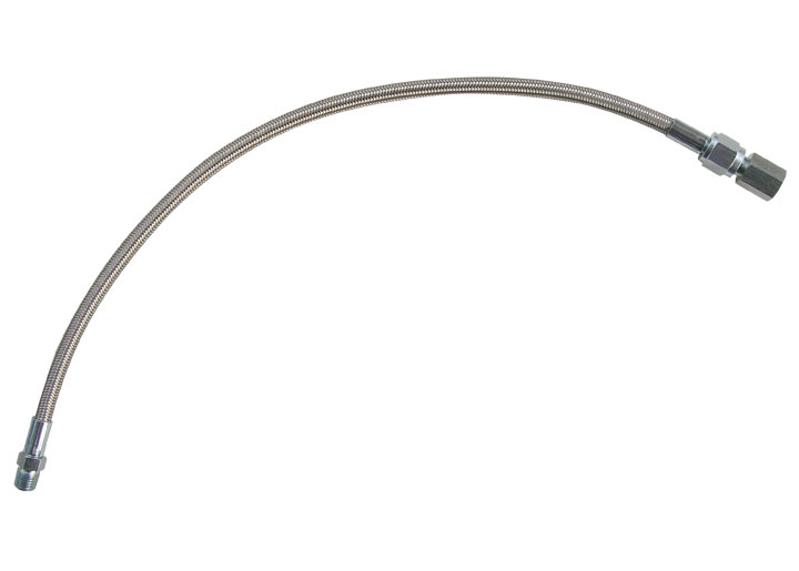

4. I need an extension for the pressure gauge. I went to get one like the one shown in one of the images in this thread (metal coated rubber hose with threaded fittings on either end). The thread on the sender appears to be a M10 x 1.0. but it is tapered. The FLAPS had fittings that were close, but not quite. Apparently there is a non-metric pipe size that fits, but I was not comfortable with this; I don't want to strip the threads or screw (pun intended) them up.
[color=#FF0000]
Where can I get metric fittings for this?[/color]
That is an interesting idea! Thanks. I was going to get one of those cup holder ashtrays one of these days.

You can get the hose from Auto Atlanta and the wiring ( on the sender WK goes to factory light, G goes to your gauge) if you use a rubber extension you will need to ground the sensor if you use the steel braided hose it will ground through the hose to the engine.

Is there any other source for the adapter fittings? The hose I can get at my FLAPS, but the fittings are metric and tapered (like pipe thread). I've called around and can't find a source.
Has anyone used regular (non-tapered) metric fittings? The FLAPS (and some other sources-the Samba, etc.) all say using the closest English size will work, since the threads are so close, but I'm hesitant. Won't using a non-tapered male thread in a tapered female hole screw something up? Will it be tight enough?

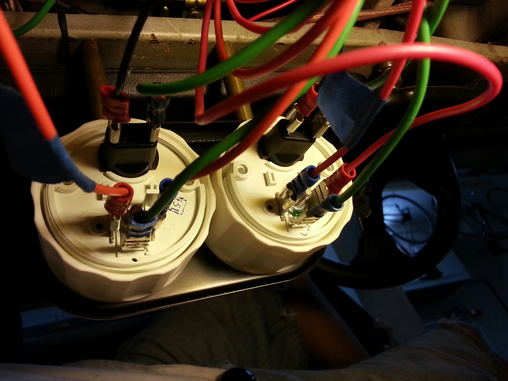

So I got the gauges installed. I think the oil temp one works; I haven't got the car hot enough to register. The gauge starts at 120F and I only drove around the block, let the car cool, then fixed a connection. When I started the car a little while later (about 15 minutes) the gauge twitched a bit.
The oil pressure gauge maxes out immediately. I'm thinking this is an electrical grounding issue? I've got it grounded to the fan housing in the engine compartment.
Also, the gauge lights don't come on when I turn on the headlights. I tapped into 2 (one wire per gauge) of the black and purple wires that are for the gauge lights. Went from there to the gauge light. From the gauge light to ground on metal by knee board.
How do I remove the lights from the sockets? I pulled and they don't come out. They don't seem to twist either. I have VDO gauges.
I tapped into the same fuse (#9) as the radio for power to the gauges. Used a piggy back connector and put 2 wires on one spade, then into the fuse connection.
I'll try and post pictures later.
I'll also post what I found to use for a hose for the oil pressure sender.

It seems the oil temp gauge works. I drove the car for 20 minutes and it went to almost 180. The sensor is under the car and not covered, so the air probably cooled it. I'm just going to assume the oil is hotter than that. Probably should get a temp gauge and try to measure it somehow. Any thoughts on how to do this?
The oil pressure still pegs to the right. I'm pretty sure I hooked it up right, but clearly something is wrong. Any ideas? (IMG:style_emoticons/default/headbang.gif)
The lights on the gauges don't work either. I tapped into the lighting wires for the other instruments. Does it matter which wire or wires I use?
Here are some pics:
