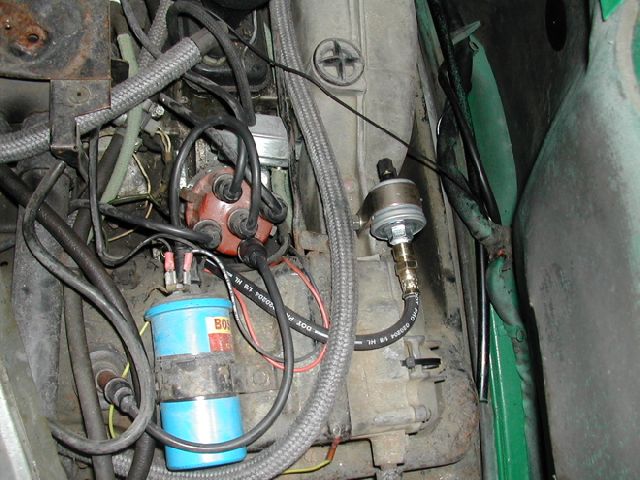

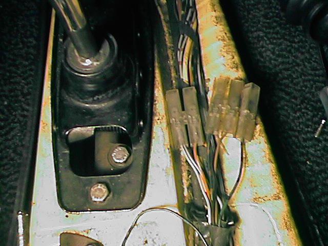

where are you mounting the gauges?
if your mounting them in a center console there is already wires for power, ground, switched power, oil temp, and the blk/blu wire for gauge illumination.
for the oil pressure sender, the sender will not fit in the existing hole you have to remove the oil pressure switch next to the dizzy and use hose to mount the sender on the fan housing or wherever you decide.
Click to view attachmentClick to view attachmentClick to view attachment

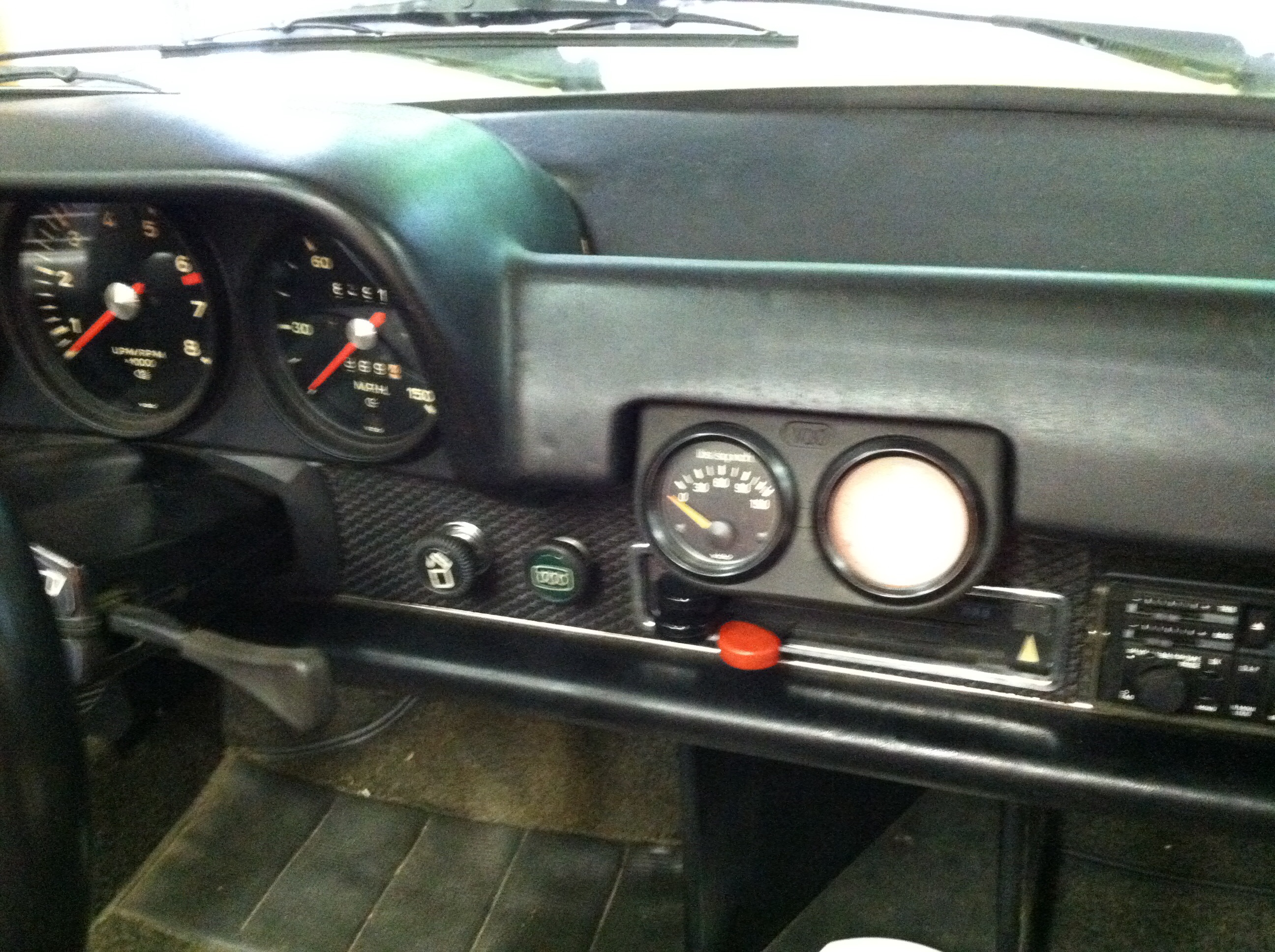

914 RZ-1
Jul 31 2016, 04:09 PM
I'm mounting the gauges under the dash with a 2 gauge bracket. There is no center console. Looks like I'll be adding wiring, but someone confirm this.
What do you mean by "next to the dizzy"?
What kind of hose should I use?
Thanks for the pictures.
I'll try to get to this the next few days and see if I can answer my own questions.

Unless you use the ashtray, this makes a convenient mount using the VDO rubber bracket. Just cut off the angled top and then use the ashtray mounting holes to attach the bracket.

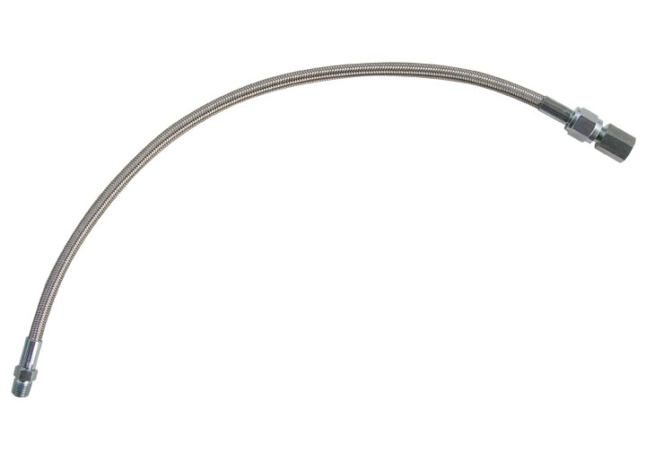

4. I need an extension for the pressure gauge. I went to get one like the one shown in one of the images in this thread (metal coated rubber hose with threaded fittings on either end). The thread on the sender appears to be a M10 x 1.0. but it is tapered. The FLAPS had fittings that were close, but not quite. Apparently there is a non-metric pipe size that fits, but I was not comfortable with this; I don't want to strip the threads or screw (pun intended) them up.
[color=#FF0000]
Where can I get metric fittings for this?[/color]

QUOTE(GeorgeRud @ Jul 31 2016, 06:39 PM)
Click to view attachmentThat is an interesting idea! Thanks. I was going to get one of those cup holder ashtrays one of these days.

QUOTE(TeenerTech @ Jul 16 2016, 09:55 AM)
Click to view attachmentClick to view attachmentClick to view attachmentI just figured out that "dizzy" is distributor! Duh.
Where did you get the fittings for the hose? The fittings on the sensor are tapered and metric. My FLAPS didn't have anything that fit properly (they had some pipe threaded ones that were close, but...)
Where are the wires on the sender, by the way? I can't see them in the picture.
TeenerTech
Aug 6 2016, 06:34 PM
You can get the hose from Auto Atlanta and the wiring ( on the sender WK goes to factory light, G goes to your gauge) if you use a rubber extension you will need to ground the sensor if you use the steel braided hose it will ground through the hose to the engine.

Is there any other source for the adapter fittings? The hose I can get at my FLAPS, but the fittings are metric and tapered (like pipe thread). I've called around and can't find a source.
Has anyone used regular (non-tapered) metric fittings? The FLAPS (and some other sources-the Samba, etc.) all say using the closest English size will work, since the threads are so close, but I'm hesitant. Won't using a non-tapered male thread in a tapered female hole screw something up? Will it be tight enough?

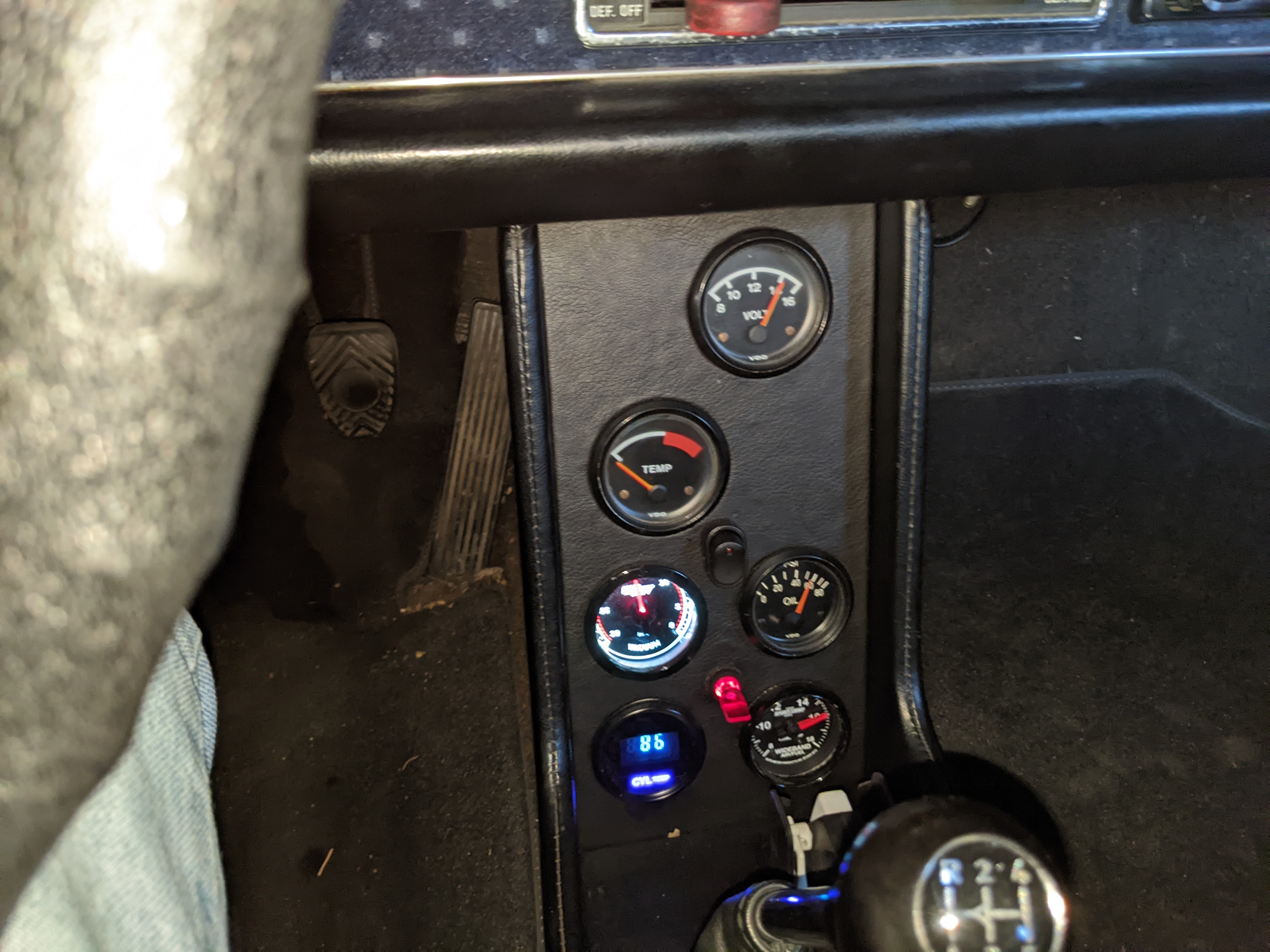

So I got the gauges installed. I think the oil temp one works; I haven't got the car hot enough to register. The gauge starts at 120F and I only drove around the block, let the car cool, then fixed a connection. When I started the car a little while later (about 15 minutes) the gauge twitched a bit.
The oil pressure gauge maxes out immediately. I'm thinking this is an electrical grounding issue? I've got it grounded to the fan housing in the engine compartment.
Also, the gauge lights don't come on when I turn on the headlights. I tapped into 2 (one wire per gauge) of the black and purple wires that are for the gauge lights. Went from there to the gauge light. From the gauge light to ground on metal by knee board.
How do I remove the lights from the sockets? I pulled and they don't come out. They don't seem to twist either. I have VDO gauges.
I tapped into the same fuse (#9) as the radio for power to the gauges. Used a piggy back connector and put 2 wires on one spade, then into the fuse connection.
I'll try and post pictures later.
I'll also post what I found to use for a hose for the oil pressure sender.

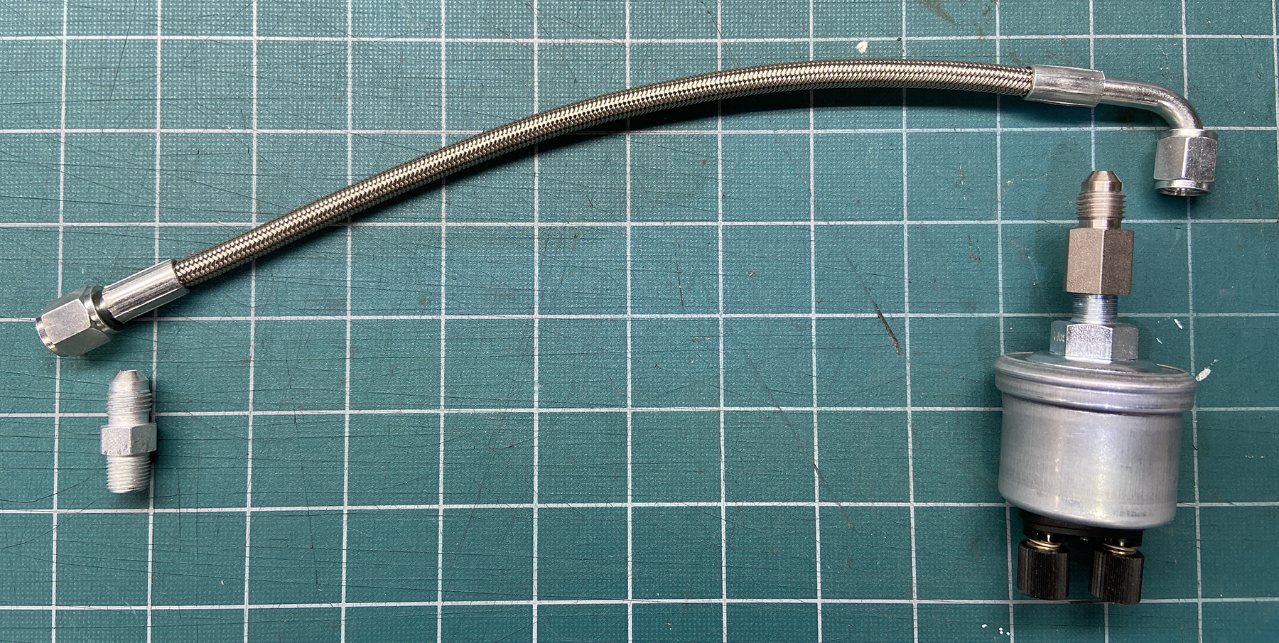

I'm starting my own gauge journey today.
Here is the hose. The fittings I picked up local at ChicagoConnection.
So far, have it everything snugged in there and will be starting the wiring, installing the temp sensor, etc.
(BTW--Those bulbs do just pull out...just need to apply a little leverage when your pulling).

I have everything operating..except the pressure gauge pegs to the right every time. I've tried several grounds:
1-gauge grounded under the dash (to the bolt holding the climate control unit).
2-I've tried several scenerios to ground the sender:
it's mounted to the location on the fan housing using a metal capacitor bracket....that should do it!
I've tried running a wire to the primary ground next to the battery to the sender housing (and tried the oil line bolt.
The other night on one of my shake down laps, when the car was warmed up, when I would come to a stop-the OIL light came on. As soon as I started rolling, it went off. Was slightly dimmed at one point.
Checked the oil...she's full.
I didn't need to run a ground wire from the sender to the gauge, did I?
Stumped!
