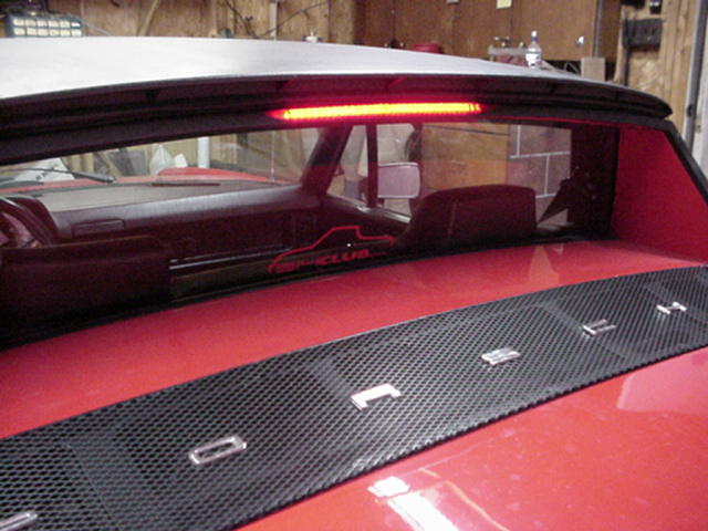

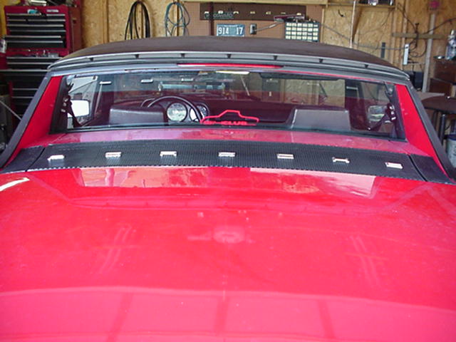

Well can you see it?

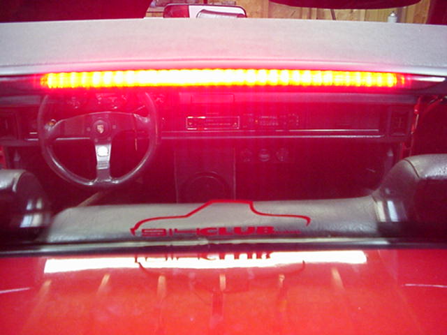

Ask, and you will see more!

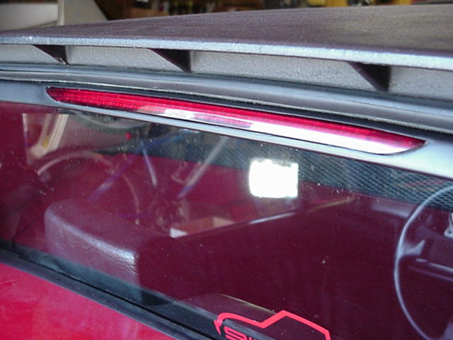

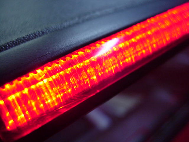

A little closer look.

Cut the hole in the trim to fit the face of the lamp housing. Almost flush.

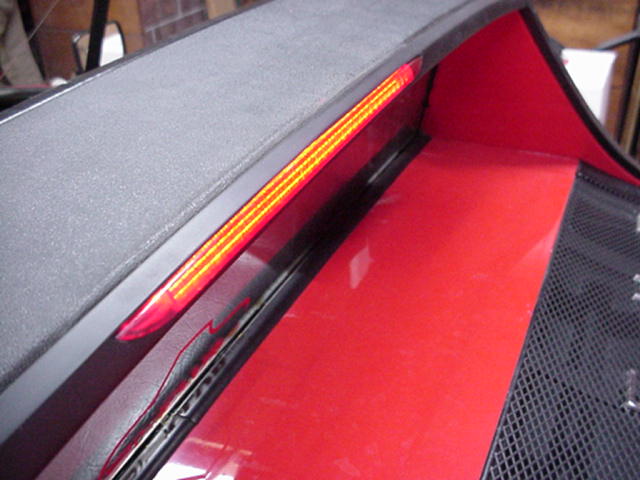

Light on

DOT approved lamp, brightest light on the car.

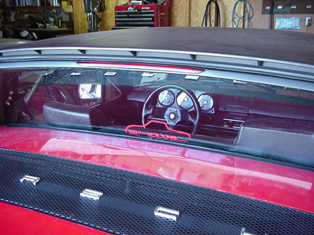

Top off.
Garland
post Apr 9 2005, 10:53 PM
Restoration Fanatic
Posts: 1,438
Joined: 8-January 04
From: ......Michigan......
Member No.: 1,535

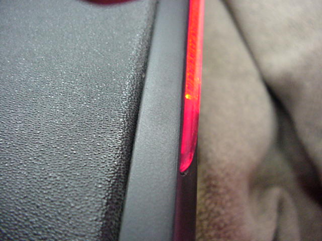

Again flush, almost with trim. Did not want to have the
"stuck on look".

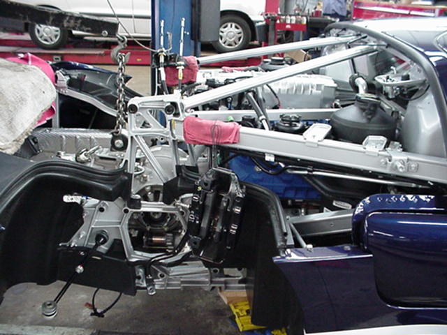

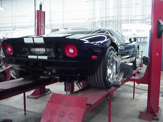

I dono.. that car looks expensive.....
what is it??
Garland
post Apr 9 2005, 11:14 PM
Restoration Fanatic
Posts: 1,438
Member No.: 1,535
You can just see it at the top of the rear glass. (O no I might be hijacking my own post.)
Garland
post Apr 9 2005, 11:16 PM
Restoration Fanatic
Posts: 1,438
Member No.: 1,535
Ford GT
