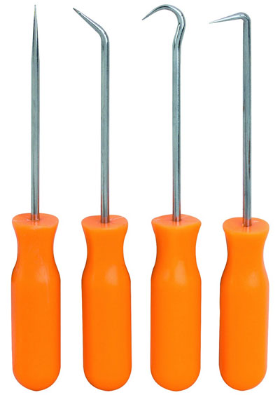

http://www.harborfreight.com/4-piece-pick-...-set-66836.html

Use a right angle pick and pull it out. Find the place where it's closest to the port opening and hook and pull. Be patient.
I can't tell you how many heads I've run through the shop that were gouged from a screwdriver or chisel. The subsequent exhaust leak is virtually unrepairable without welding.
You don't want to go there. Beleive me.
