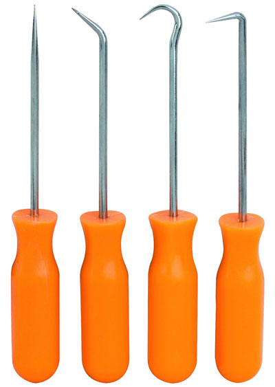

Deform them carefully with a chisel, then you should be able to get under them with a dental pick

I used a curved pick that was able to grab the edge of it and pull it doe and it popped loose, I only had 2 that were really stuck.

Use a right angle pick and pull it out. Find the place where it's closest to the port opening and hook and pull. Be patient.
I can't tell you how many heads I've run through the shop that were gouged from a screwdriver or chisel. The subsequent exhaust leak is virtually unrepairable without welding.
You don't want to go there. Beleive me.
injunmort
they are a pia. best luck i have had is to gently tap in a thin headed screwdriver into the copper gasket and deform it towards the port and then grab it with a pick. and of course when you go to replace them they won't stay in place.
