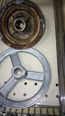

Need to see it.
(IMG:style_emoticons/default/thisthreadisworthlesswithoutpics.gif)
Damaged pulley at the top. New (but wrong size) pulley at bottom. Could one of the proper size be attached in a way that works?

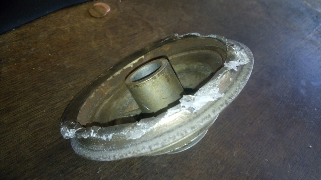

Post pictures of damage. Maybe it's something we can fix at my place.

QUOTE(Mueller @ Aug 9 2016, 11:21 AM) *
You can also convert to a DC motor with a variable power supply....which I have 2 or 3 setups I've taken off of free/salvaged threadmills. Free for the asking if want to pick one up. I want to 1 or 1.5hp motors.
Check out Surplus Center . Com, I bought my pulleys for my Bridgeport mill from there.
Its pretty bad. Anyone know if the splined bushing inside just presses out?
