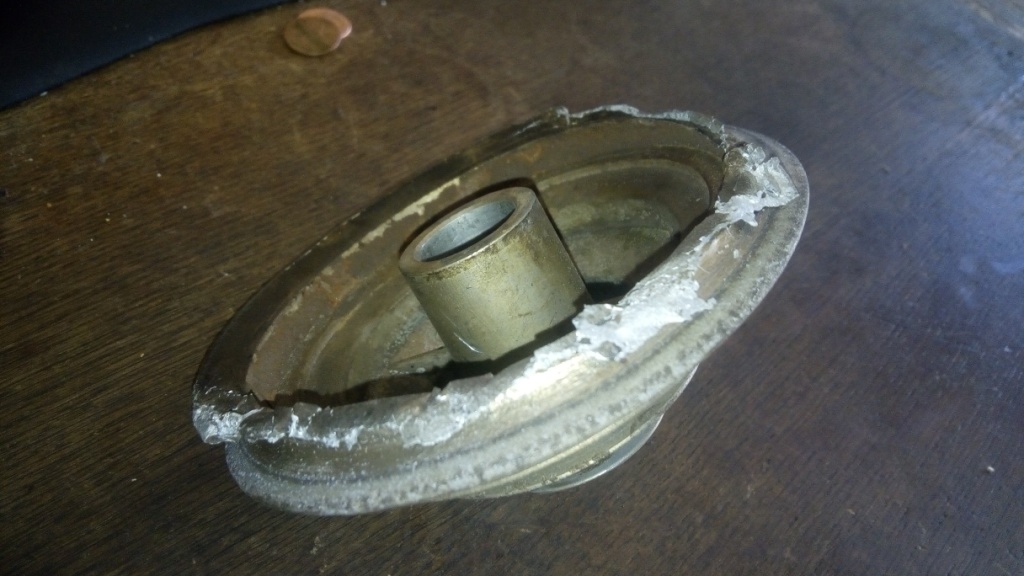

I have an old 15" Walked turner drill press that dates back to the 40's. It's a wonderful beast of a cast iron machine, but the pulley that goes on the quill is messed up. The bronze splinned bushing inside was slipping. But I am a smart guy, and taking inspiration from the method we use to put the cam gear on a type 4 crank, I heated it up on a hot plate thinking I could then drive the bushing in tighter.
I have not been able to source a replacement. Got to thinking, since I am trying to run at a lower speed, why not just get a motor controller and turn down the speed?

I would run the motor as it was designed and fix the problem. Is the part with the splines still OK? If so you can have a machine shop put it into a step pulley. It will not cost a lot and it will save the function and originality of an excellent tool. You could do it yourself...if you had a drill press dry.gif
If you do go variable speed, try to find a motor designed for it. That would cost though.

I take that it's a cast aluminum pulley?
Can you machine it down and then thread and bolt on a steel weld-on style pulley with no hub?
Tractor supply will likely have one.

You know, I was just in tractor supply thinking the same thing. I take it you are thinking to drill 3-4 holes radially?

Need to see it.

Damaged pulley at the top. New (but wrong size) pulley at bottom. Could one of the proper size be attached in a way that works?
Mueller
Post pictures of damage. Maybe it's something we can fix at my place.
You can also convert to a DC motor with a variable power supply....which I have 2 or 3 setups I've taken off of free/salvaged threadmills. Free for the asking if want to pick one up. I think 1 or 1.5hp motors.

Its pretty bad. Anyone know if the splined bushing inside just presses out?
