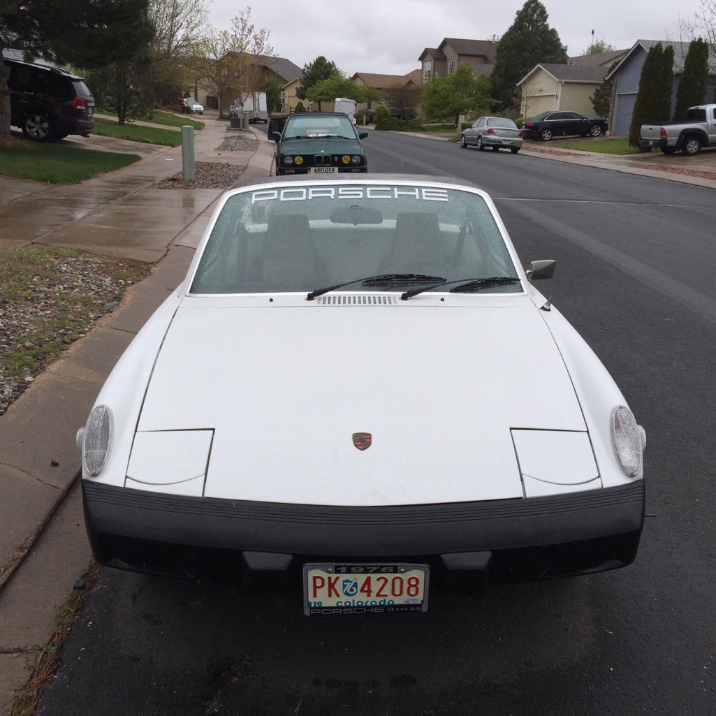

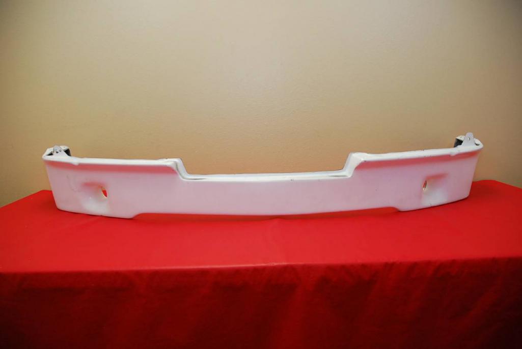

Got me a used fiberglass air dam I want to install on my late model 1976 rubber bumper square fog front end. It has 2 mounting tabs looks like. Do I have to take the front bumper off to screw it in?

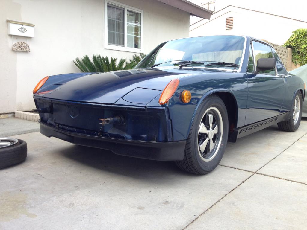

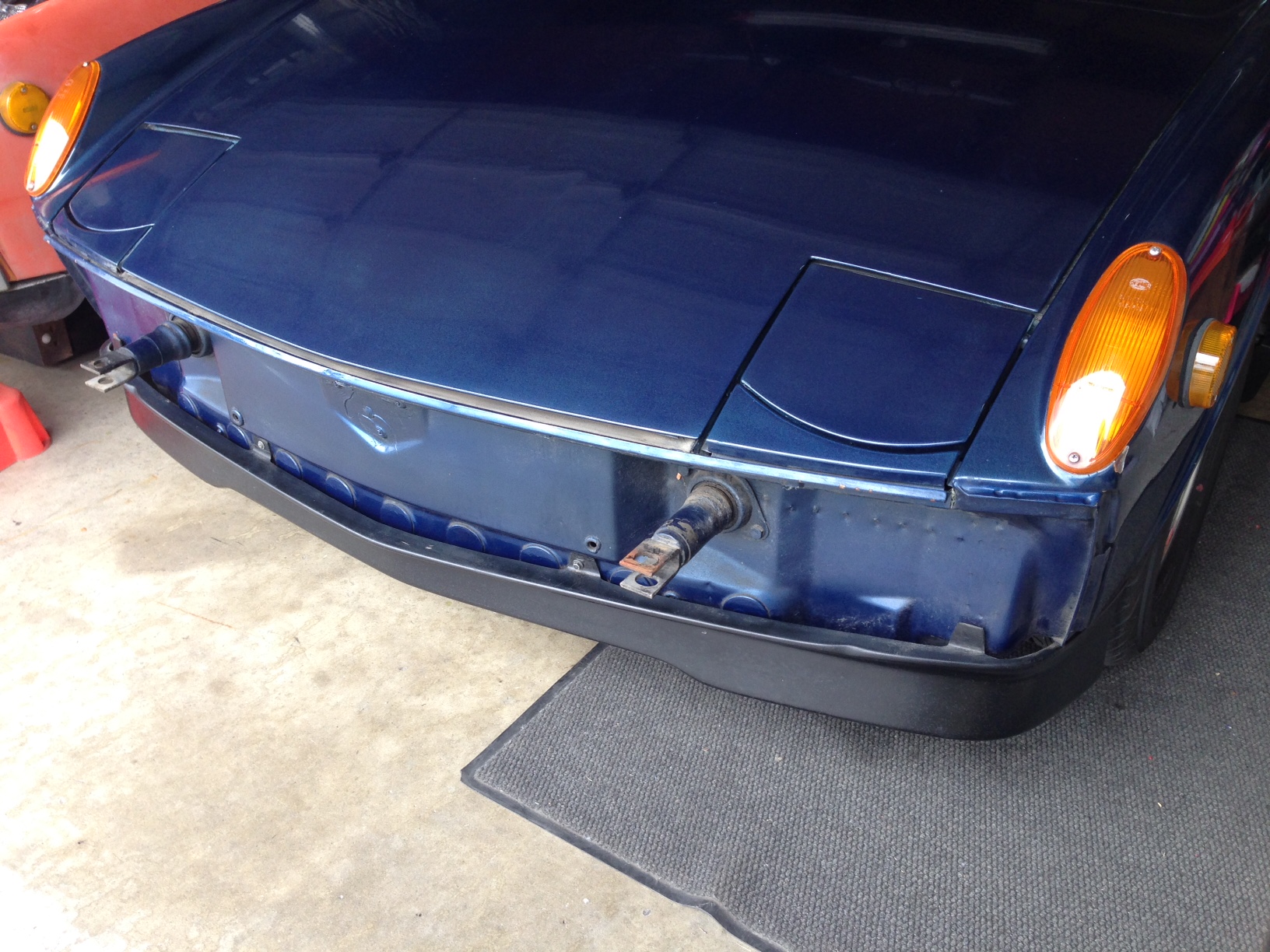

this may help you. the two tabs can be screwed to the side of the front lower body but maybe u need to support the middle part the fg bumper. Took me less than 30 mins to removed the big rubber bumper for the 1st time.

Ndfrigi's photos are a big help. When you unbolt the two bolts from the two bumper shocks you then have to release the rubber bumper cover ends from the channels on the sides before you can pull the bumper off. You sort of "peel" the sides away. When reinstalling the bumper you must work the bumper cover ends back into these channels. Somewhat of a PIA.

Take some measurements before you go too far to make sure the dam is wide enough... I had a fiberglass one that was about an inch too short (thread on here a bit ago by someone else with the same issue).
Ended up getting a new dam from Mikey914 - fit perfectly.
