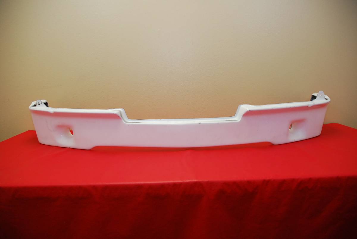

Got me a used fiberglass air dam I want to install on my late model 1976 rubber bumper square fog front end. It has 2 mounting tabs looks like. Do I have to take the front bumper off to screw it in?

So peel the rubber off the front bumper? Looks like it goes behind the bumper and afraid to peel the front rubber off the bumper. Any DIY for that? Also does it screw in or do I need to drill? Appreciate the help. I see 2 mounting holes on the valence. This is not a replacement bumper, just a lower valence air dam. Kinda confused now.

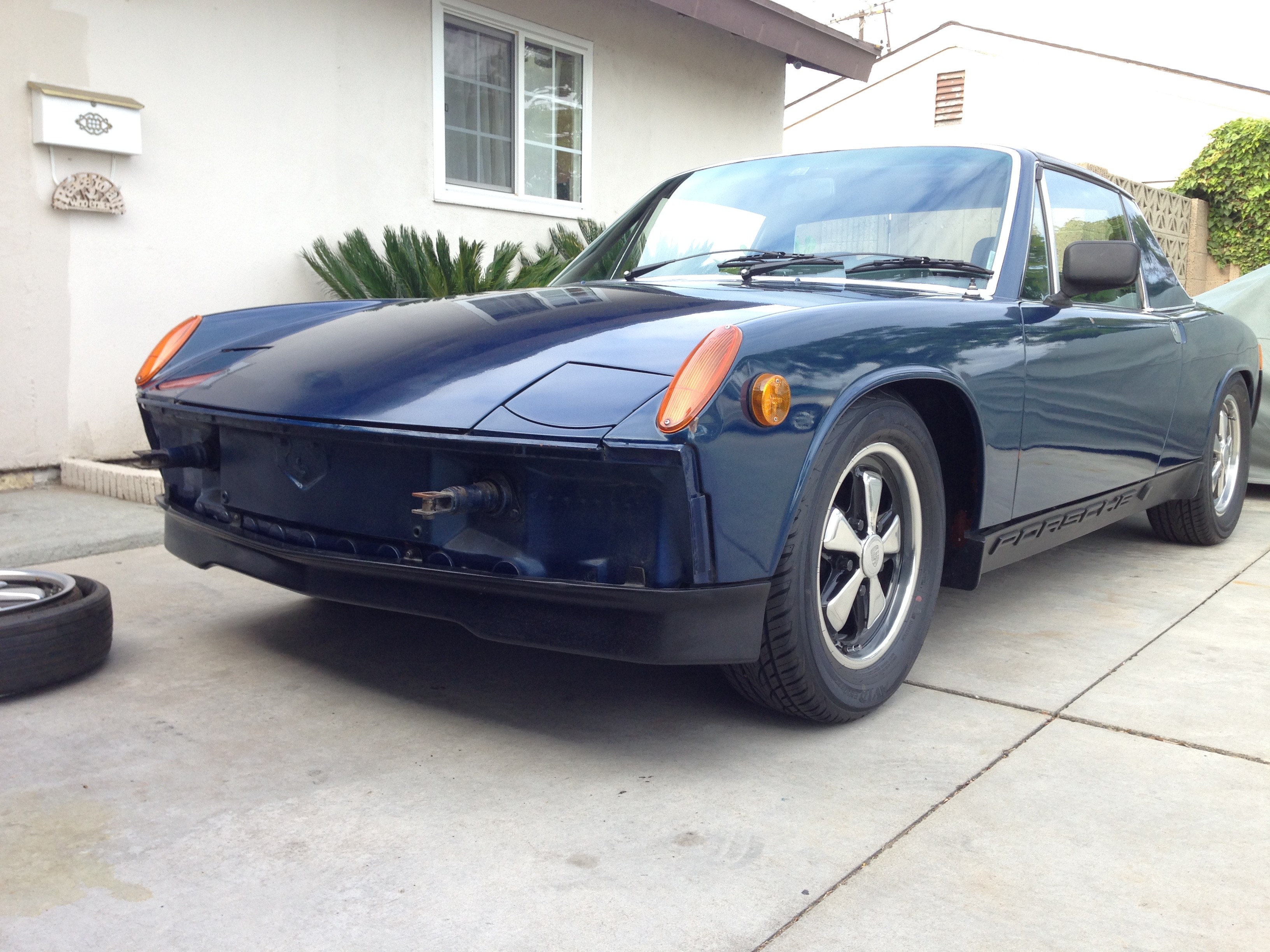

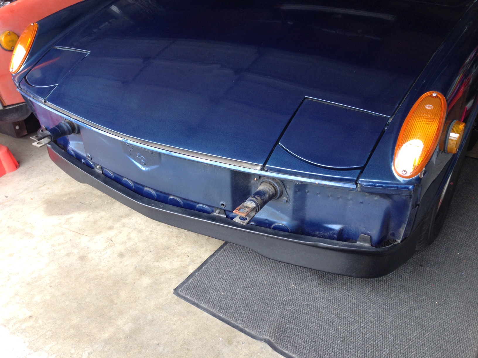

this may help you. the two tabs can be screwed to the side of the front lower body but maybe u need to support the middle part the fg bumper. Took me less than 30 mins to removed the big rubber bumper for the 1st time.
maf914
Ndfrigi's photos are a big help. When you unbolt the two bolts from the two bumper shocks you then have to release the rubber bumper cover ends from the channels on the sides before you can pull the bumper off. You sort of "peel" the sides away. When reinstalling the bumper you must work the bumper cover ends back into these channels. Somewhat of a PIA.

Jeez. You don't peel anything. Undo the bolts that insert toward the top, under the bottom of the rubber cover (inside the two holes). Push the rubber towards the rear of the car. The flanges will then release the rubber cover on the ends.
