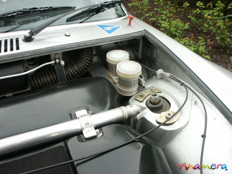

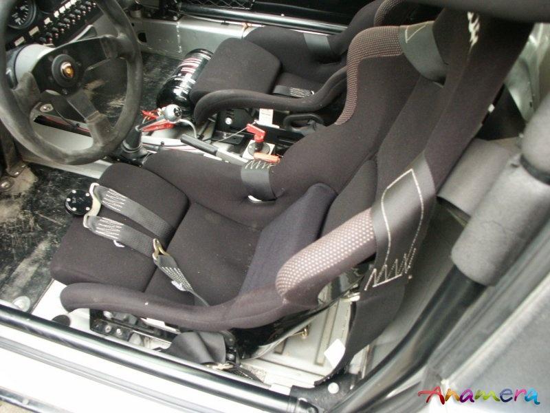

Cool....but missing the vintage seats. Its interesting that they've thrown in pics of other cars. Hhmmmmm..... and the K&N air filters?

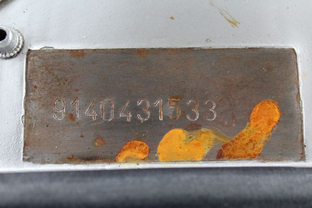

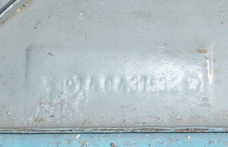

Honestly, i'm a little bit in doubt, if this is an original car ...
The chassis number looks suspicious and the vin tag in the front trunk if definately not an original one..
The chassis number is missing the star before and after the actual vin.
Maybe the car has been repaired after a front crash ...
Maybe I'm wrong, but at this price one should take care of those details ...

QUOTE(sechszylinder @ Aug 12 2016, 11:16 AM) *
br
Benno (IMG:style_emoticons/default/smilie_flagge6.gif)
Not to question your knowledge, I don't remember ever seeing this "star" before and after the vin tag. Also all the -6's that I've had the opportunity to view the vin on the body, is like the one presented in the link above.
I guess I should ask, do you actually a European-6 to compare these findings too?

QUOTE(396 @ Aug 12 2016, 11:31 AM) *
br
Hi,
the chassis number should look like this
http://www.pbase.com/9146gt/image/159313015
the vin tag should look like the 4 cylinder models but stating porsche as the manufacturer and not like the ones used on 911 and other newer porsche modells.
http://www.pbase.com/9146gt/image/159313017
I've never seen an original -6 showing this kind of markings.
br
Benno
0396

It's been awhile since I looked at mine, I guess I have to uncover mine to validate this.

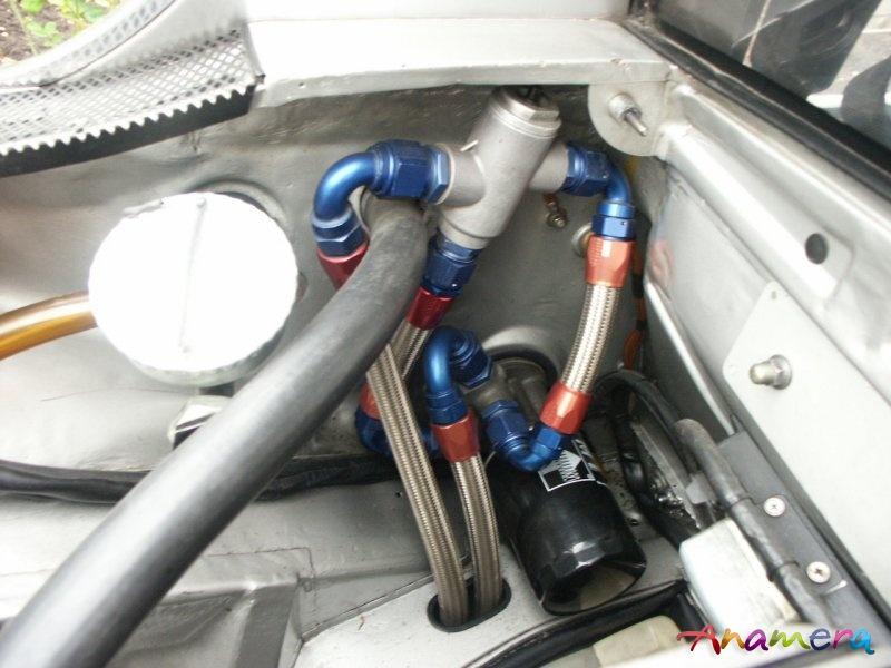

"Built with factory GT parts" (IMG:style_emoticons/default/av-943.gif)
should we start with front strut reinforcement
oil system, seat belt reinforcements
seats, steering wheel and dash
...I could go on

Yes every 1970 or 1971 914/6 I have seen has a star before and after the VIN
the 1972 914/6 has an asterisk like the 914/4
gms

and here is the the car made right before it

QUOTE(gms @ Aug 12 2016, 12:29 PM) *
so, it really seems to be a faked -6 and not the original car or a crash repair ?!? (IMG:style_emoticons/default/confused24.gif)
br
benno

I thought that given the proper evidence and participation of the factory they will re-stamp the chassis after say an inner wing replacement due to an accident
The numbers seem a bit too evenly spaced / lined up. On the production line I suspect they would not have been taking too long over the stamping
Does seem a bit odd and you would have thought the advert would be a bit more up front about the history
