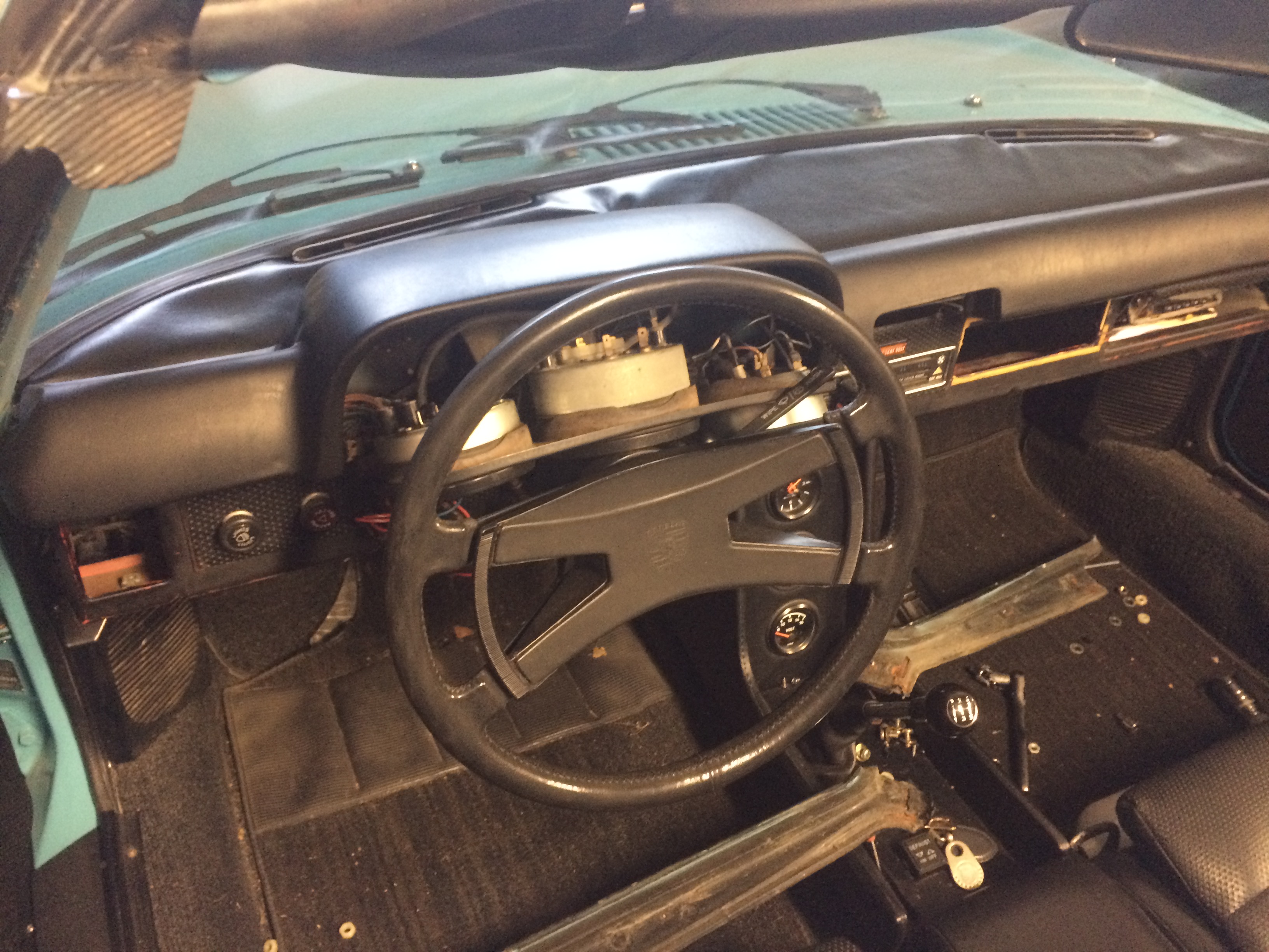

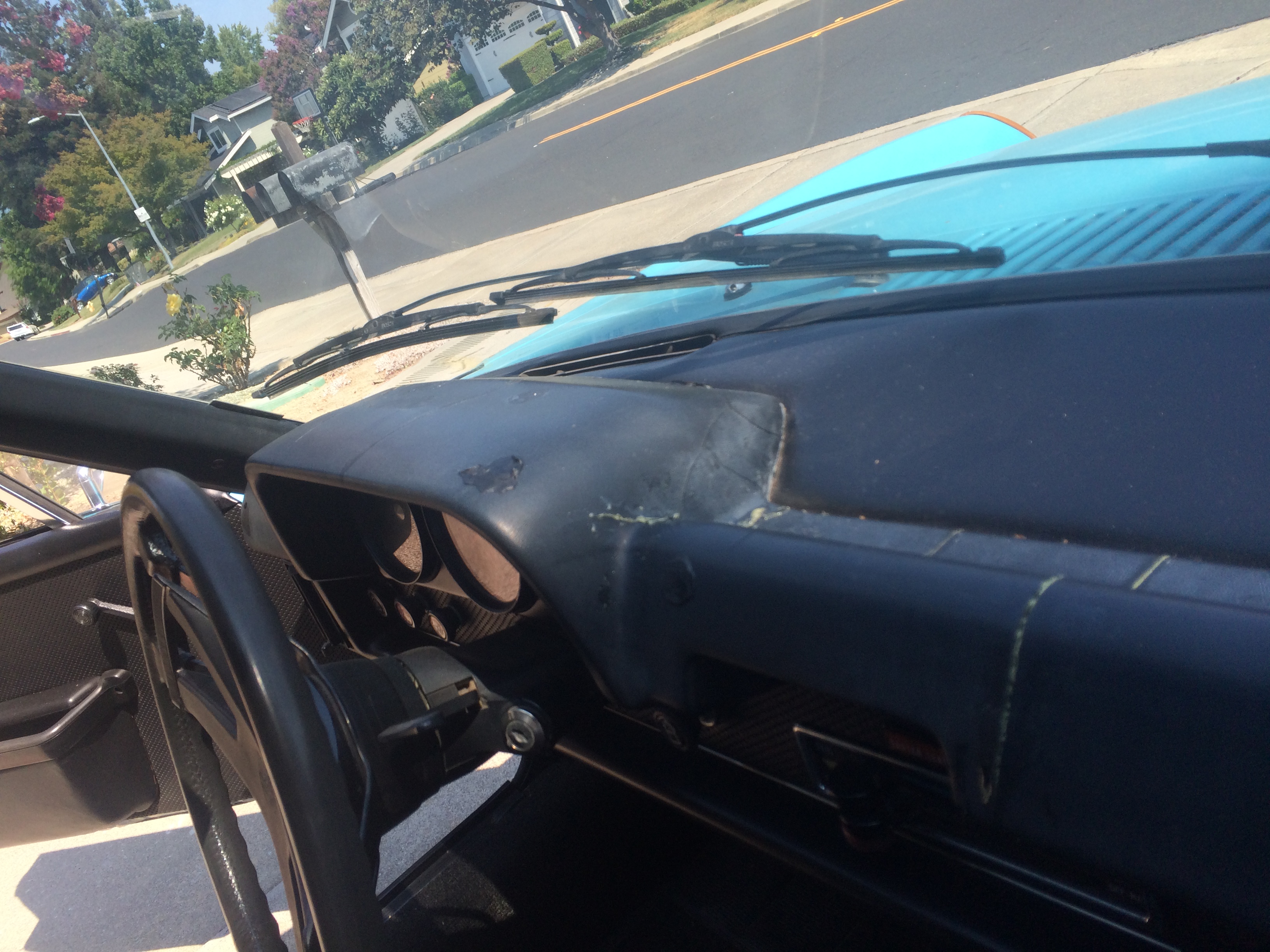

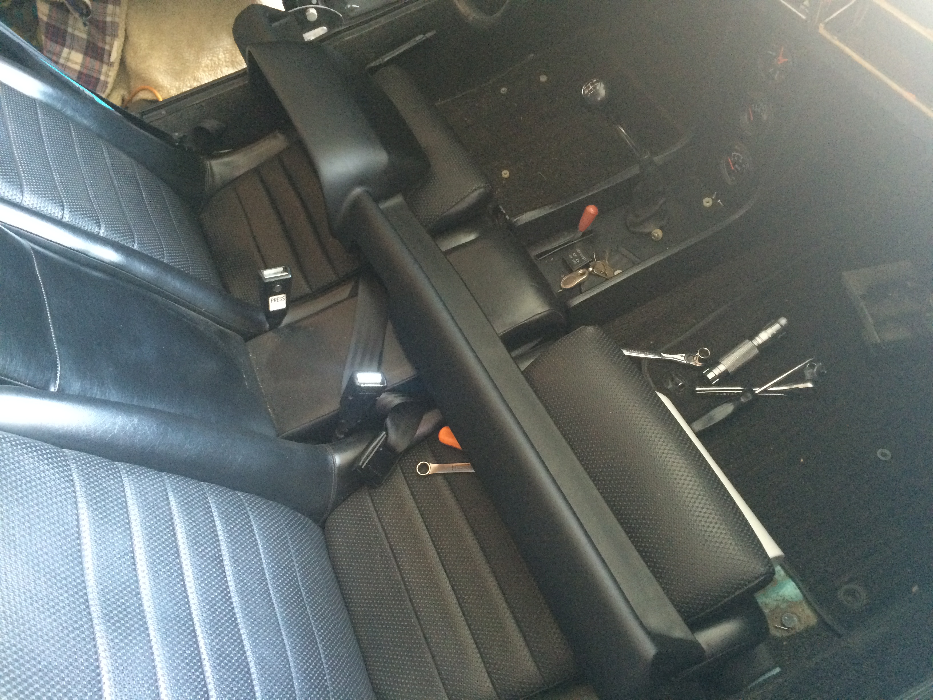

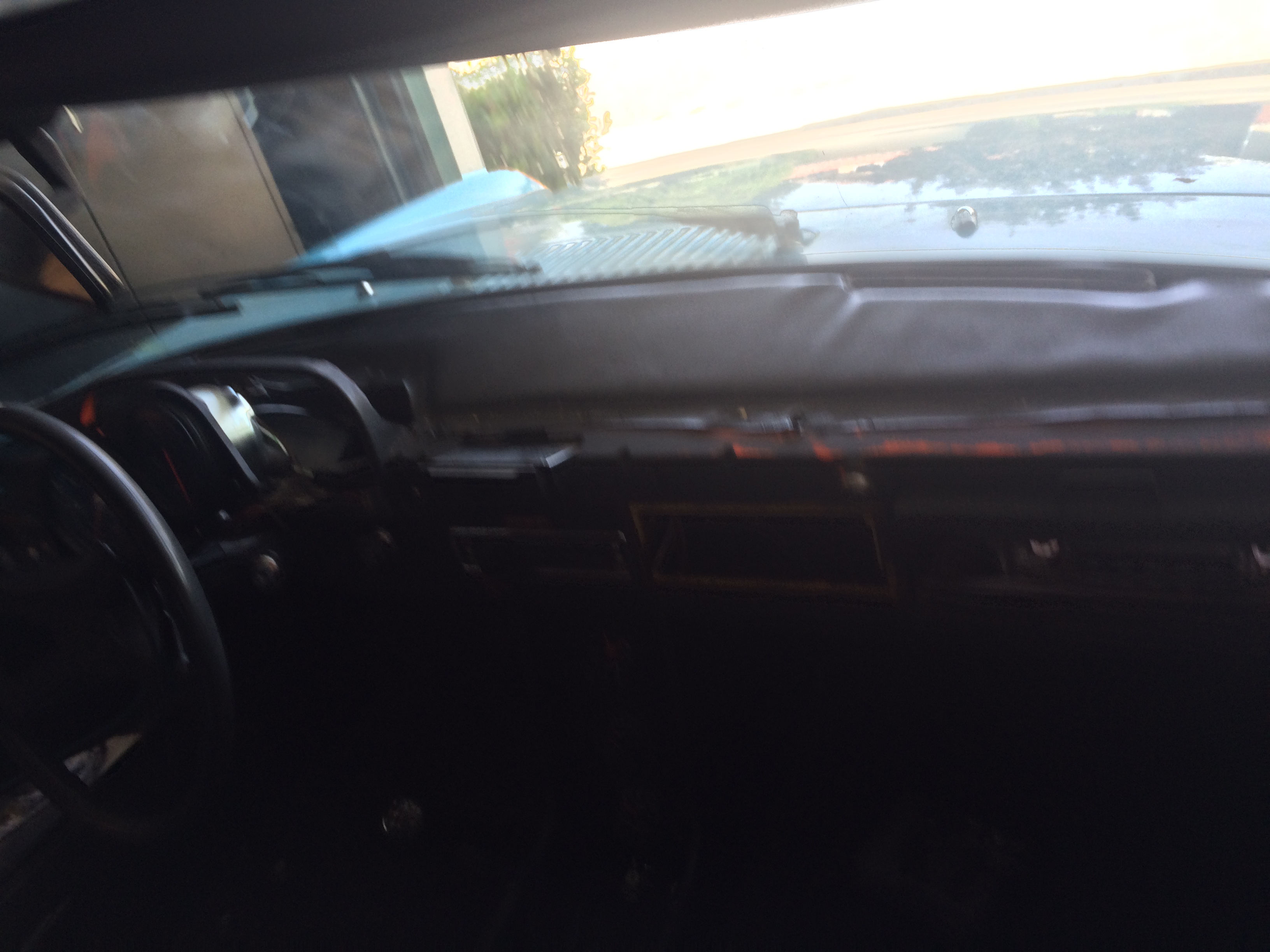

Decided to put Mikey's dash on today. Nothing wrong with the old plastic dash cap. Will put it up for sale shortly.
So far, I have the old dash out. Now I have the daunting task of putting the super nice Mikey Dash back in..... (IMG:style_emoticons/default/dry.gif)

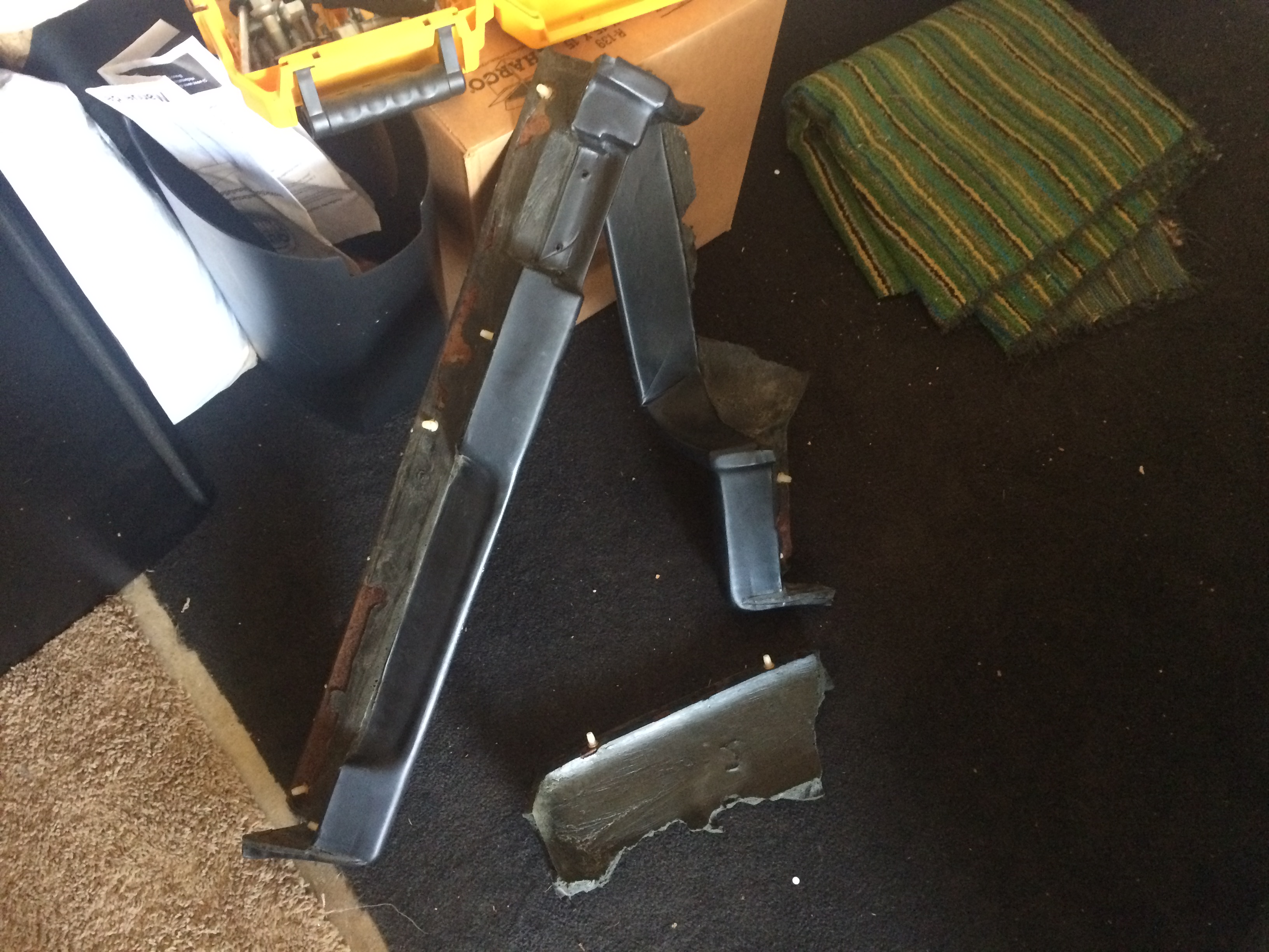

Gone

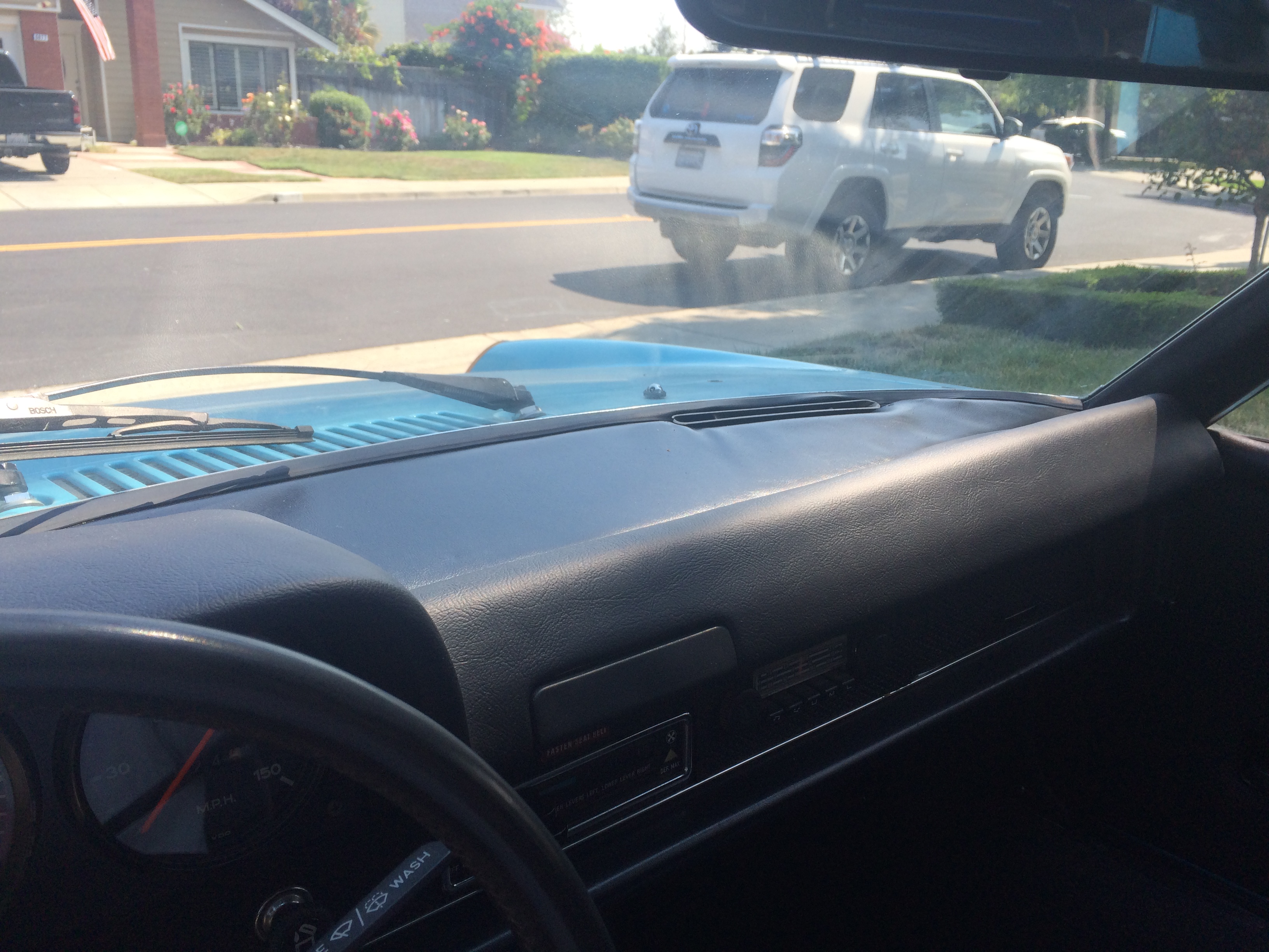

New one waiting

Does that look right to you?
EdwardBlume
post Aug 23 2016, 02:34 PM
Posts: 12,338
Joined: 2-January 03
From: SLO
Member No.: 81

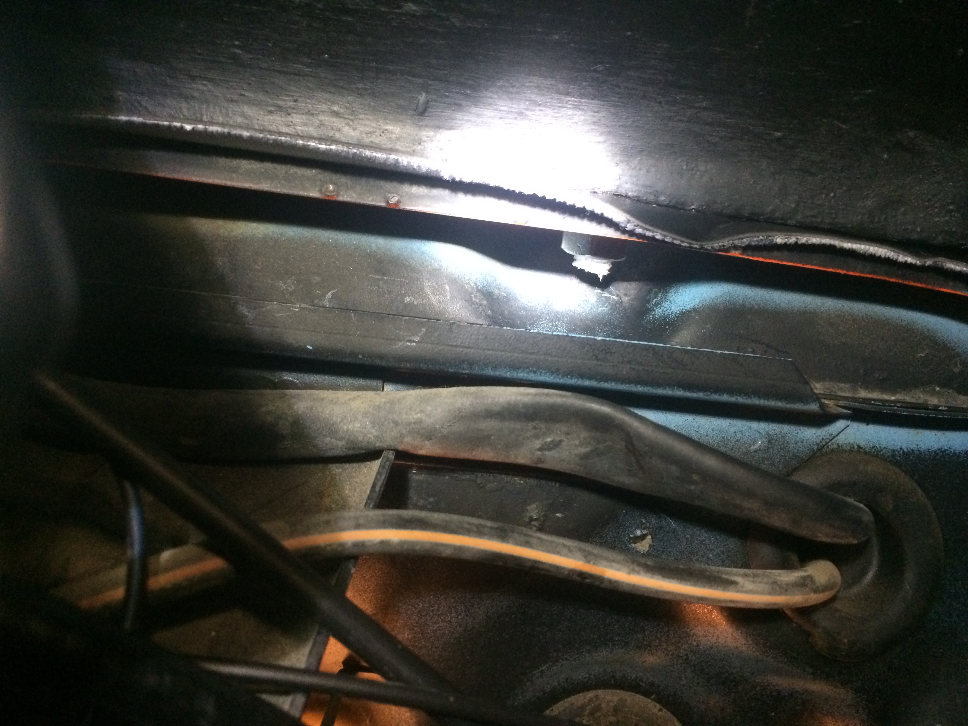

Just took the A pads off, but its not going in easily. Do the horizontal front studs mount first, or the vertical rear studs?
I put the console studs in first and the dash is hung up.
Ha, yes. I could have told you to expect that. (IMG:style_emoticons/default/smile.gif)
Just keep battling! (and be thankful you aren't replacing the defroster air box)
-Steve

Your knuckles will bleed,but it's worth it!

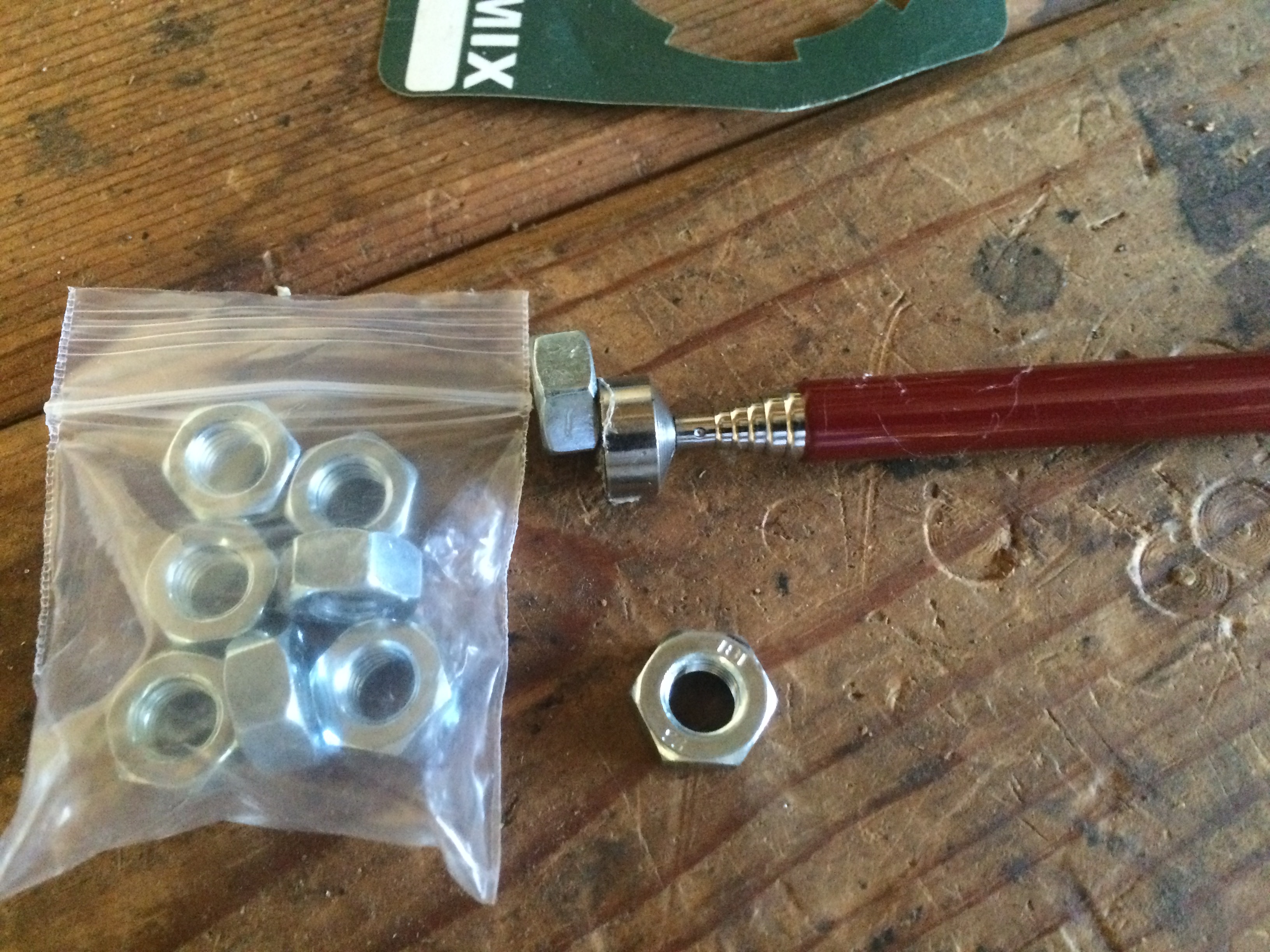

Going with the Mikey bolts (they're magnetic)

1/4" socket and floppy end extensions, and ratcheting wrenches. And I pull the gauges out completely to get my hand in there.

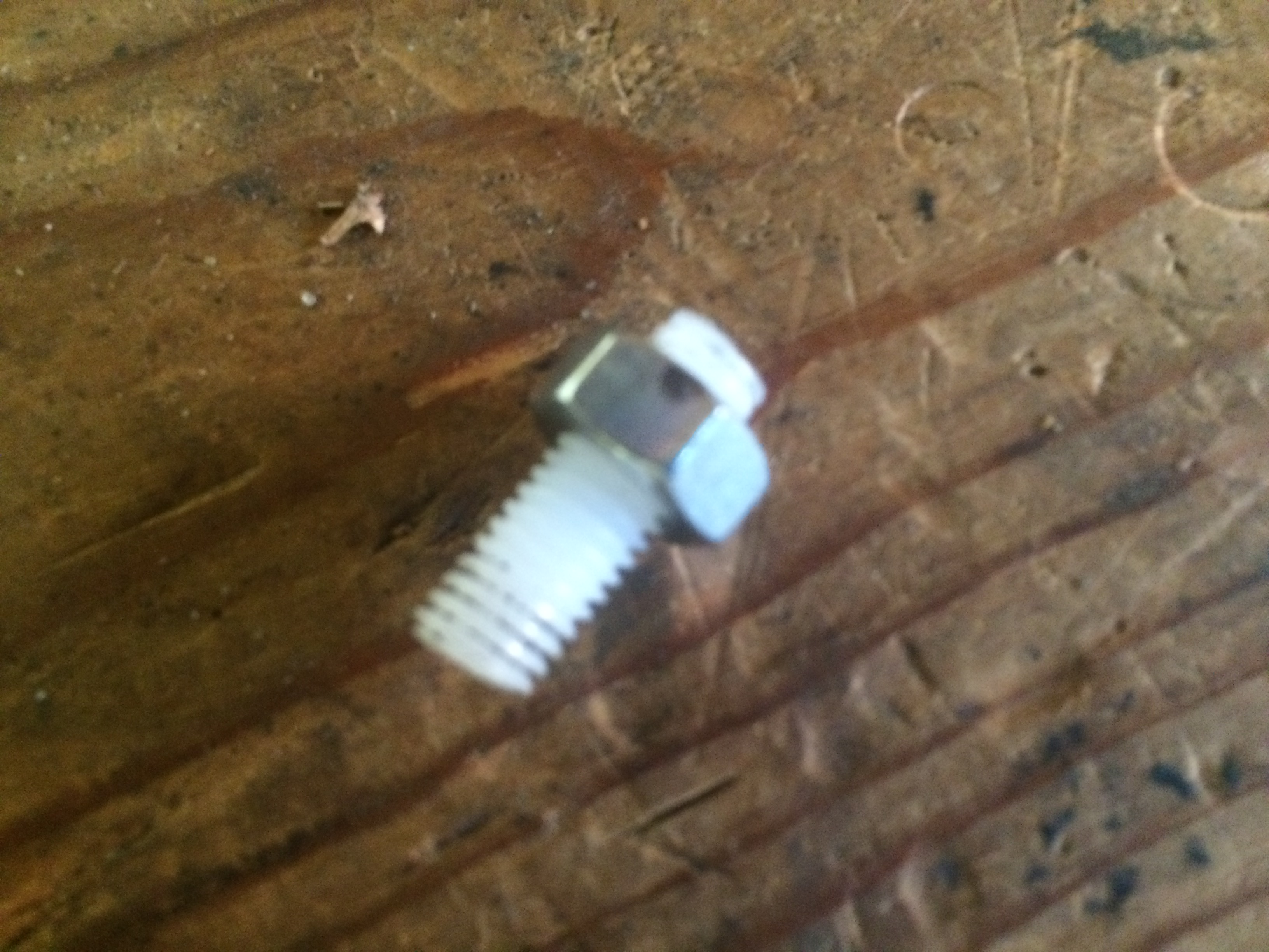

Is this a stud or am I screwed?

Lots of patience. If you only get one nut on per day, no problem. It's getting done.

That looks double threaded. Metal nuts should screw on with minimal resistance, near finger easy. Plastic nuts have been random but usually a ton of friction.

The OEM is tapered to start the nut, this one isn't but persistence pays off.
It is a stud and I was able to rethread it, reinsert it, and use it. On to the next one.

I'm almost "done". I lost one stud due to it getting chewed on installation. Like I said above there's no taper on the stud so you are on your own to line it up right and getting the nuts to thread straight. Go too far and you have a problem. Otherwise a really nice fit and finish.

Yes we started tapering them. Drop me an address in PM and I can send you another stud.

Is that top pict in the first post your dash cap? It looks nice, what brand is it?
