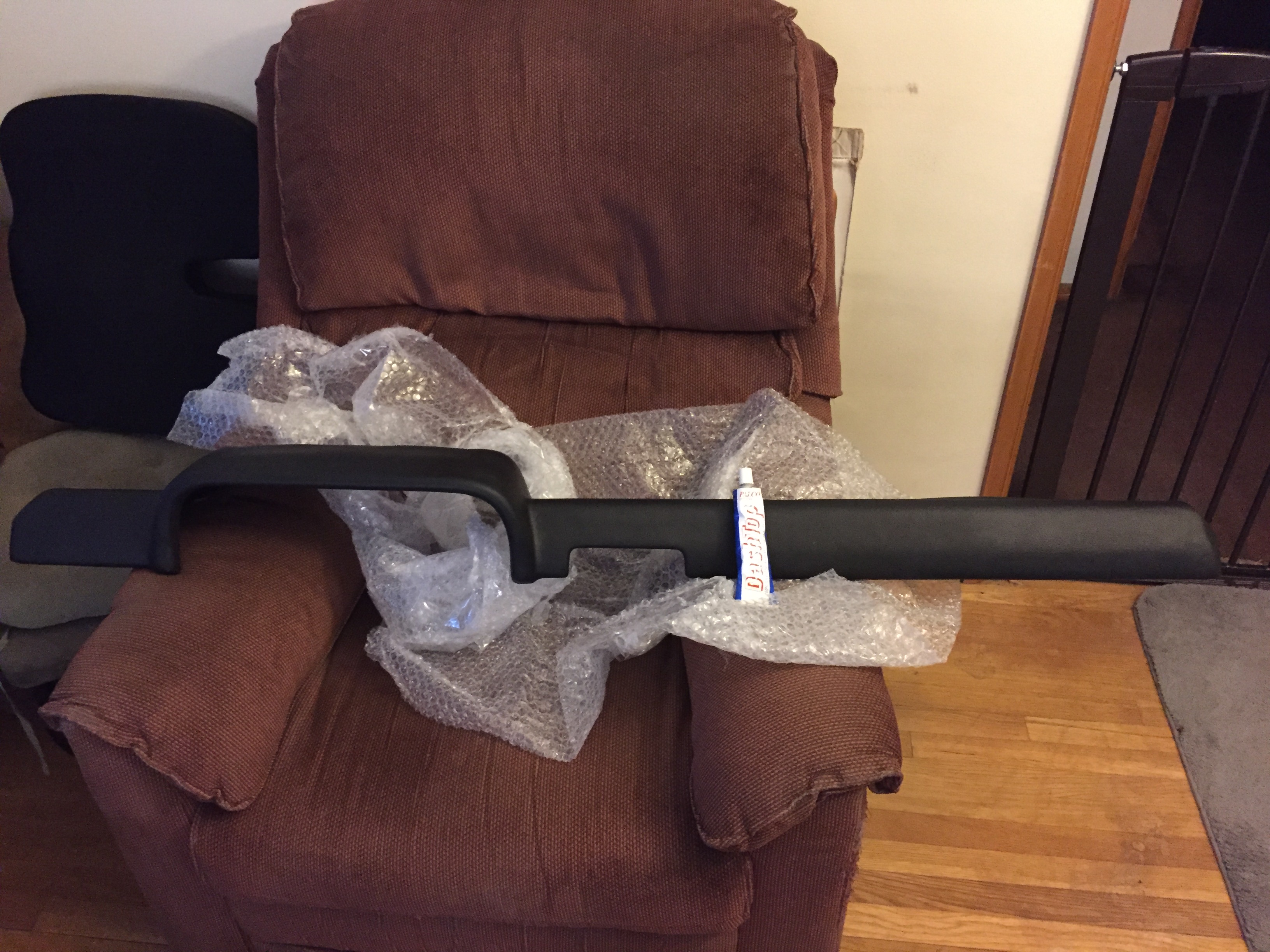

Decided to put Mikey's dash on today. Nothing wrong with the old plastic dash cap. Will put it up for sale shortly.
So far, I have the old dash out. Now I have the daunting task of putting the super nice Mikey Dash back in.....

New one waiting
EdwardBlume
Aug 23 2016, 02:19 PM
Does that look right to you?
