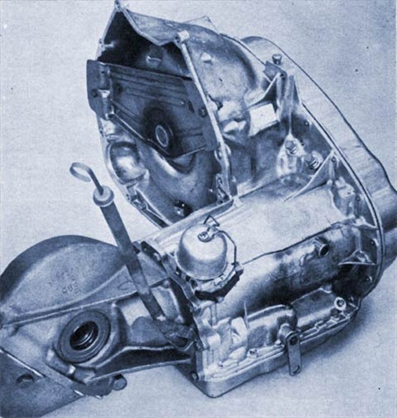

QUOTE(Mike Bellis @ Sep 2 2016, 12:58 PM) *
Toronado tranny is transverse and would mount the motor sideways...
Are you talking about the th425 or th325? It keeps the motor inline has a diff under the engine. Attached Image

here is a th425 in a fiero...

I guess you are right. I have seen it mounted transverse in a 914. possibly a different transmission... But in this case, it puts the axles in the wrong location so the engine would need to sit in the rear trunk.

On the th425 and maybe even the th325you can flip the diff upside down. then run the engine facing the rear. that would put the axles in the correct spot. If you wanted to get fancy with it you could install a tail housing from a th400 and run a short drive shaft to a 4x4 front diff or flip rwd upside down and seal vent hole.
Still not in the correct spot but closer. Still need to chop out the trunk.

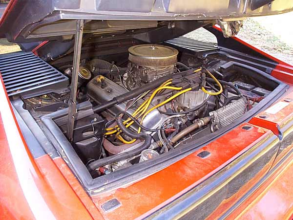

QUOTE(zach914v8 @ Sep 2 2016, 01:14 PM) *
That's an unusual swap. The Fiero trans is transversely mounted in stock form. There is a tiny, very deep trunk at the rear that has been cut out of that car. I know because I.... Cough..cough... ownedafierogtonce (IMG:style_emoticons/default/hide.gif) What? Nothing. Let's move on.
