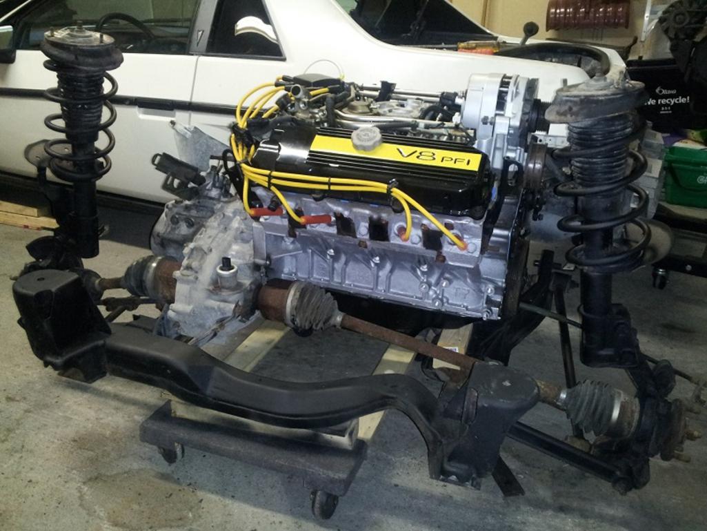

zach914v8   This is not a winter type project.... there is an...   Sep 2 2016, 11:53 AM
Mike Bellis   Toronado tranny is transverse and would mount the ...   Sep 2 2016, 11:58 AM
zach914v8   Toronado tranny is transverse and would mount the...   Sep 2 2016, 12:03 PM
zach914v8   here is a th425 in a fiero...   Sep 2 2016, 12:14 PM
Chris H.   here is a th425 in a fiero... That's an u...   Sep 2 2016, 02:05 PM

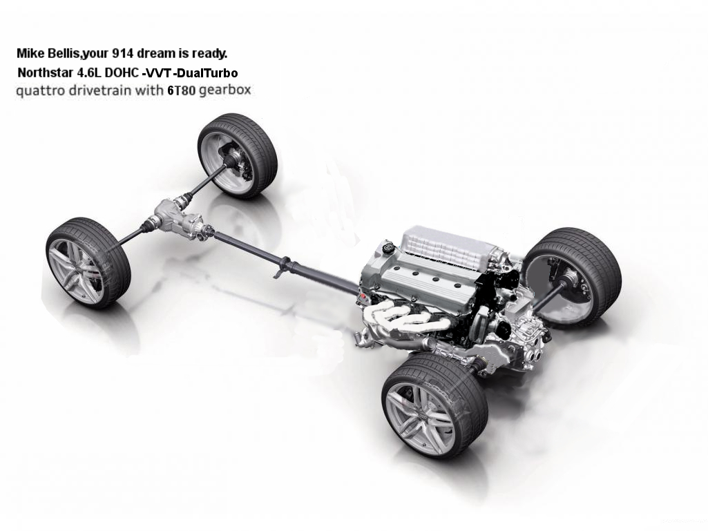

veekry9   :D The center diff is custom torque biasing,th...   Sep 5 2016, 04:59 AM
veekry9   Well,an option not yet considered here,is the ...   Sep 8 2016, 09:28 AM
