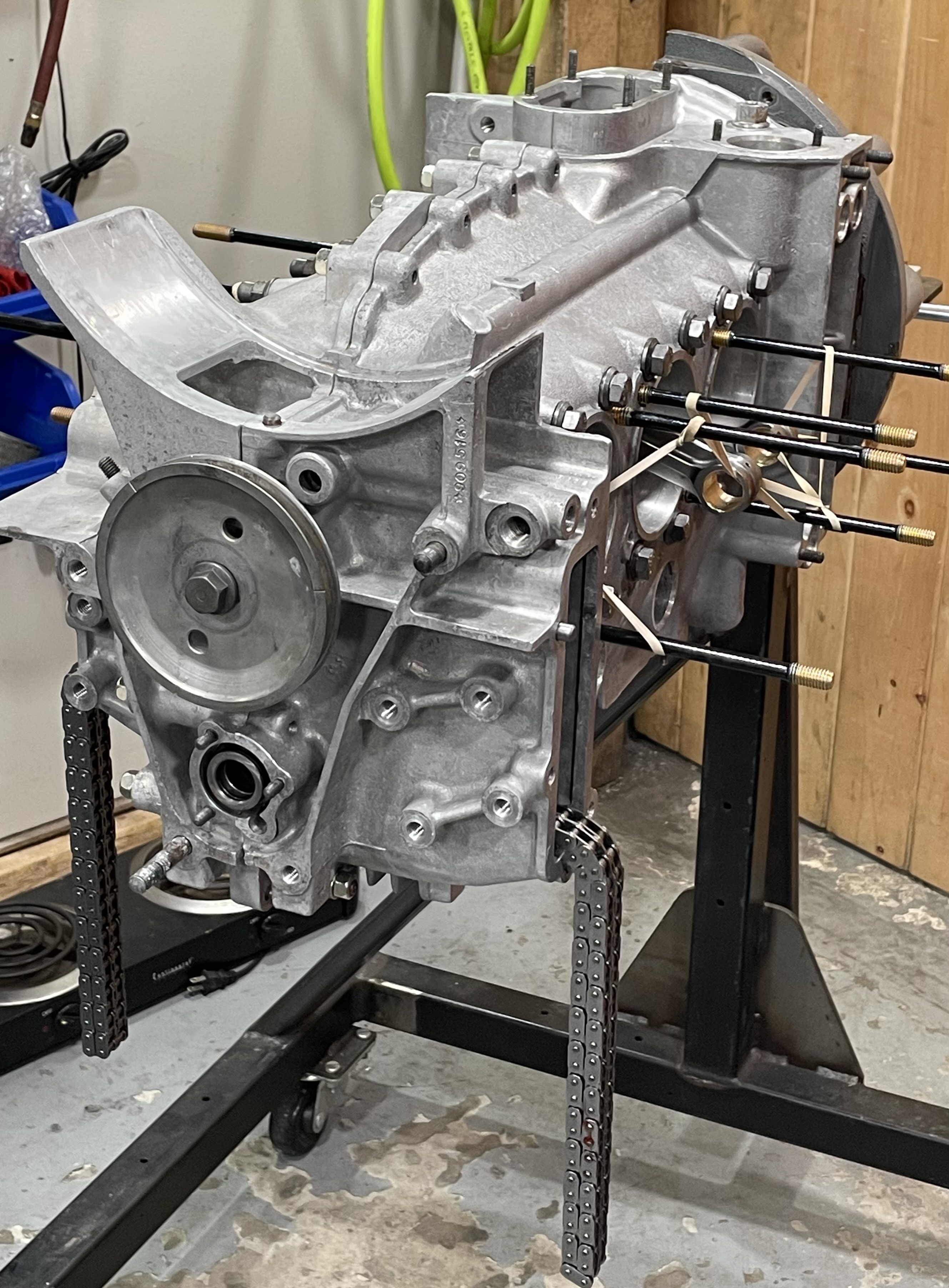

Come together

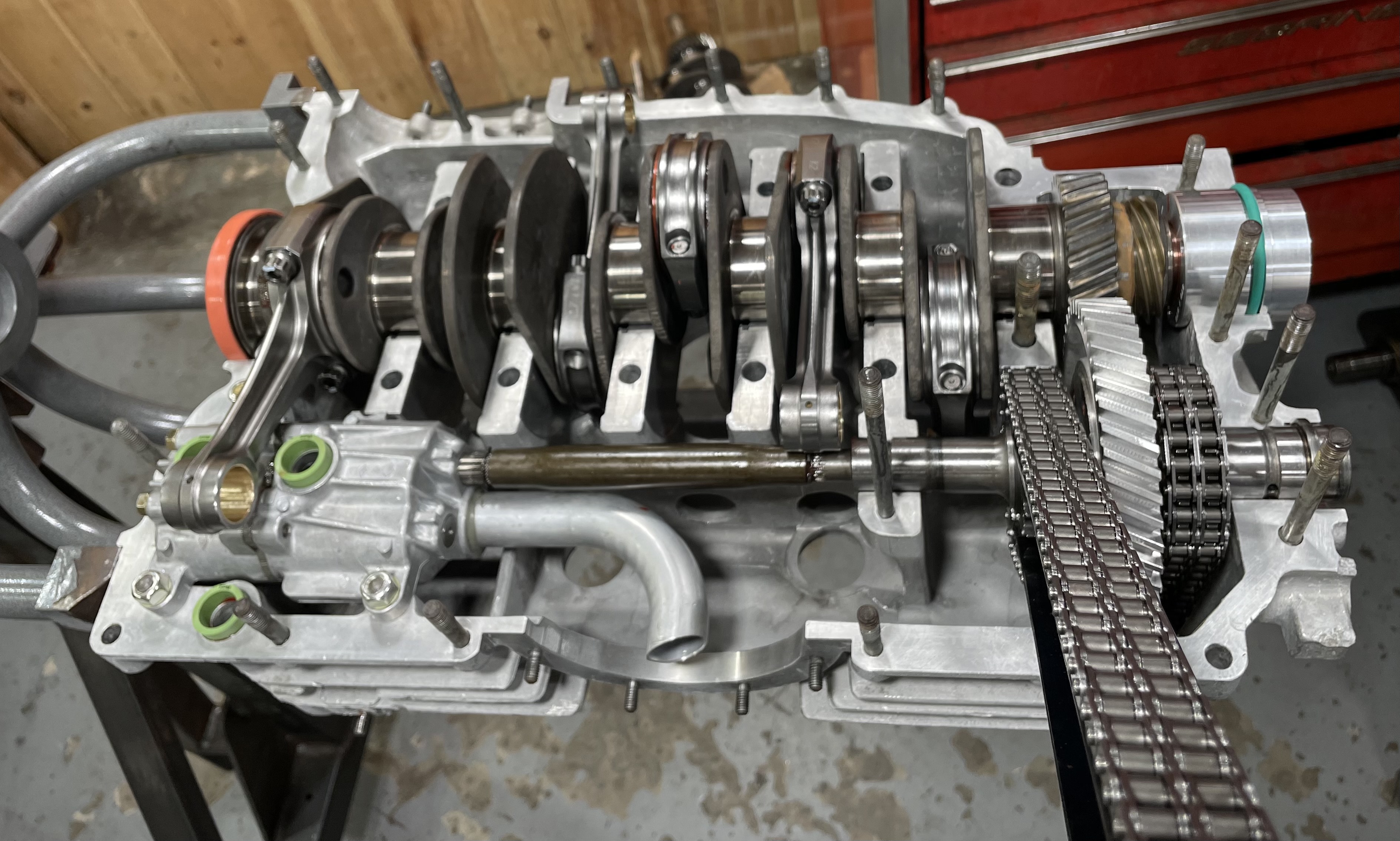

Mating case halves

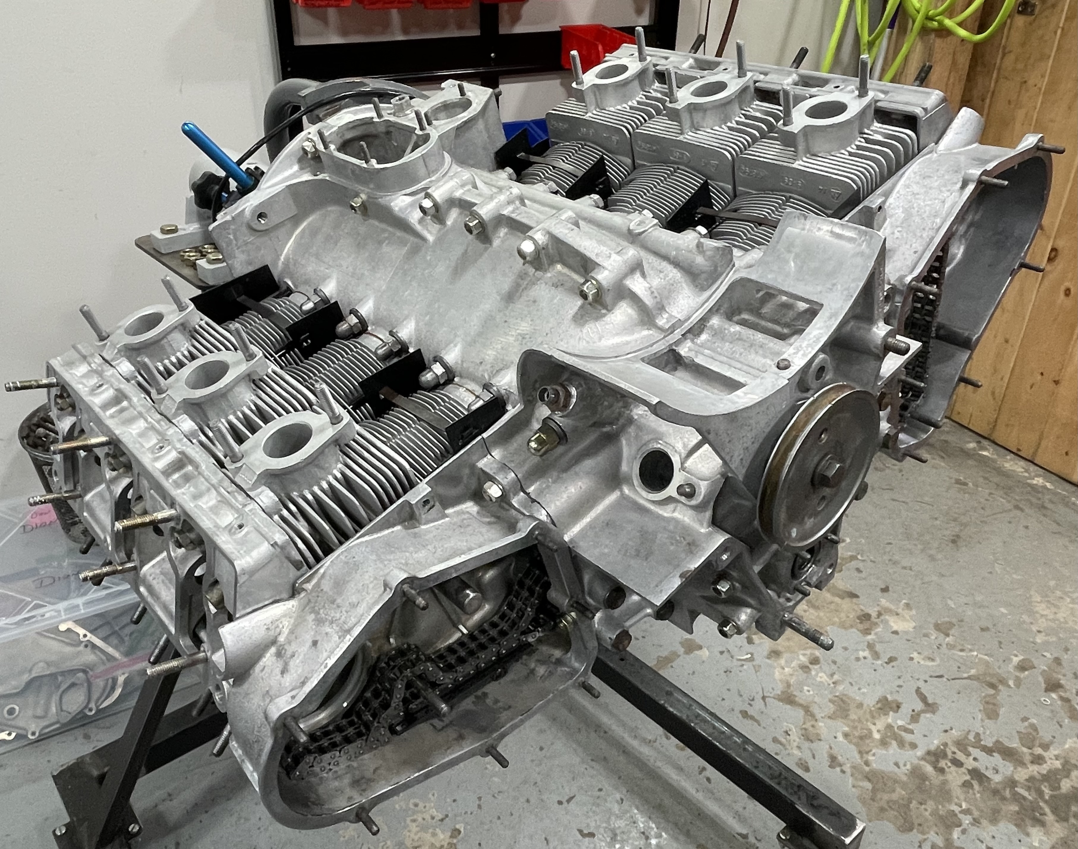

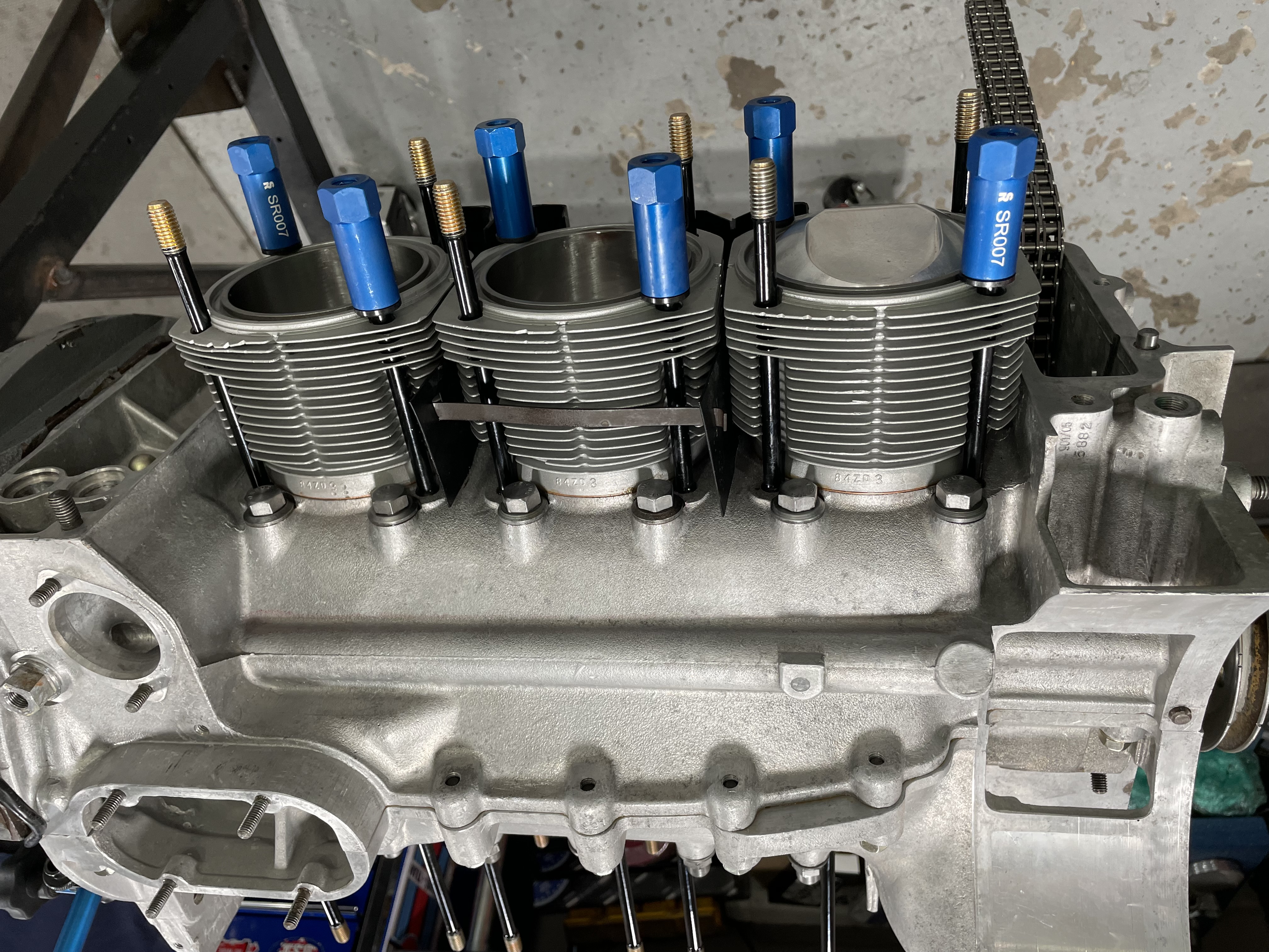

Pistons and barrels on

Getting there

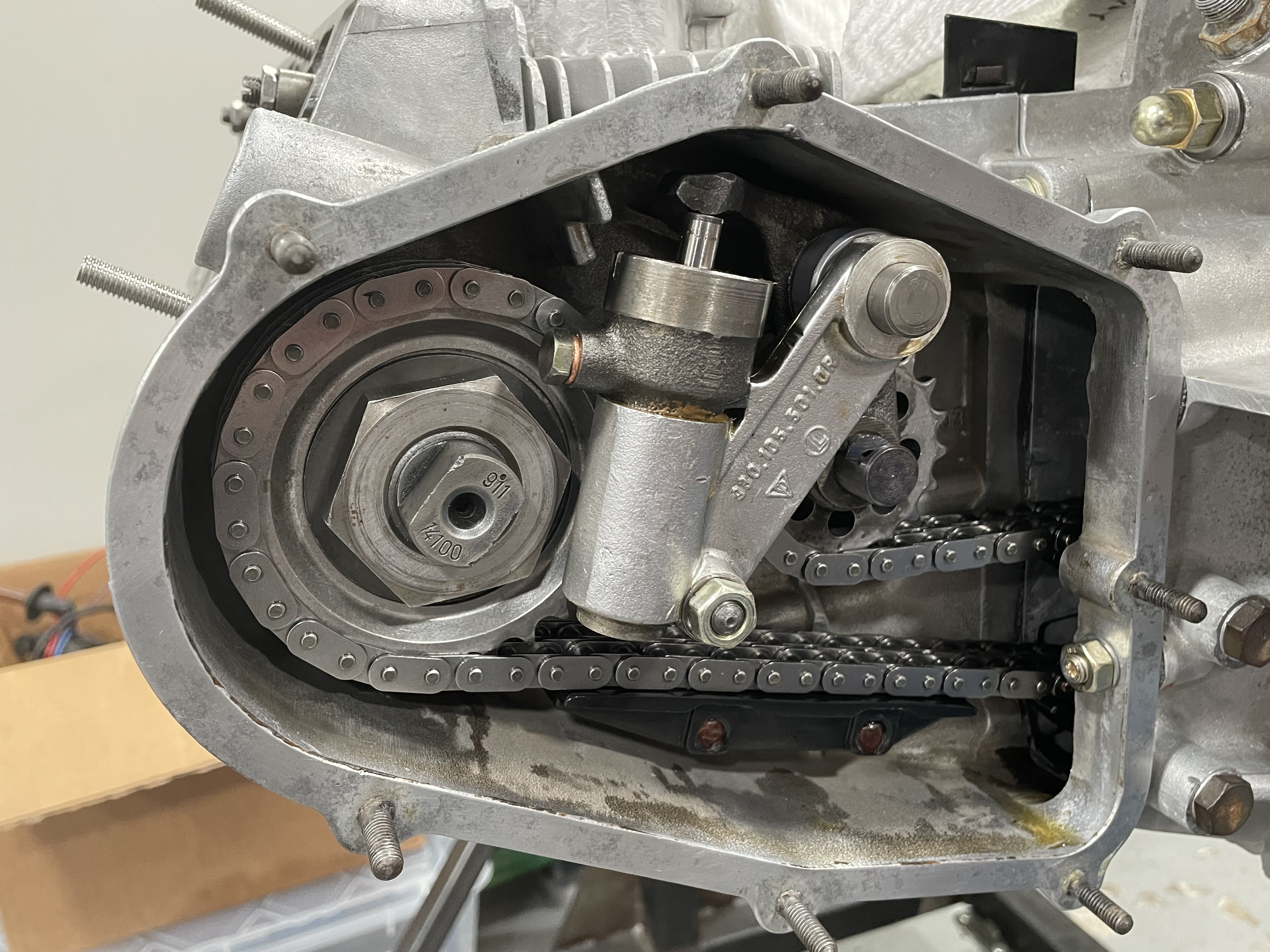

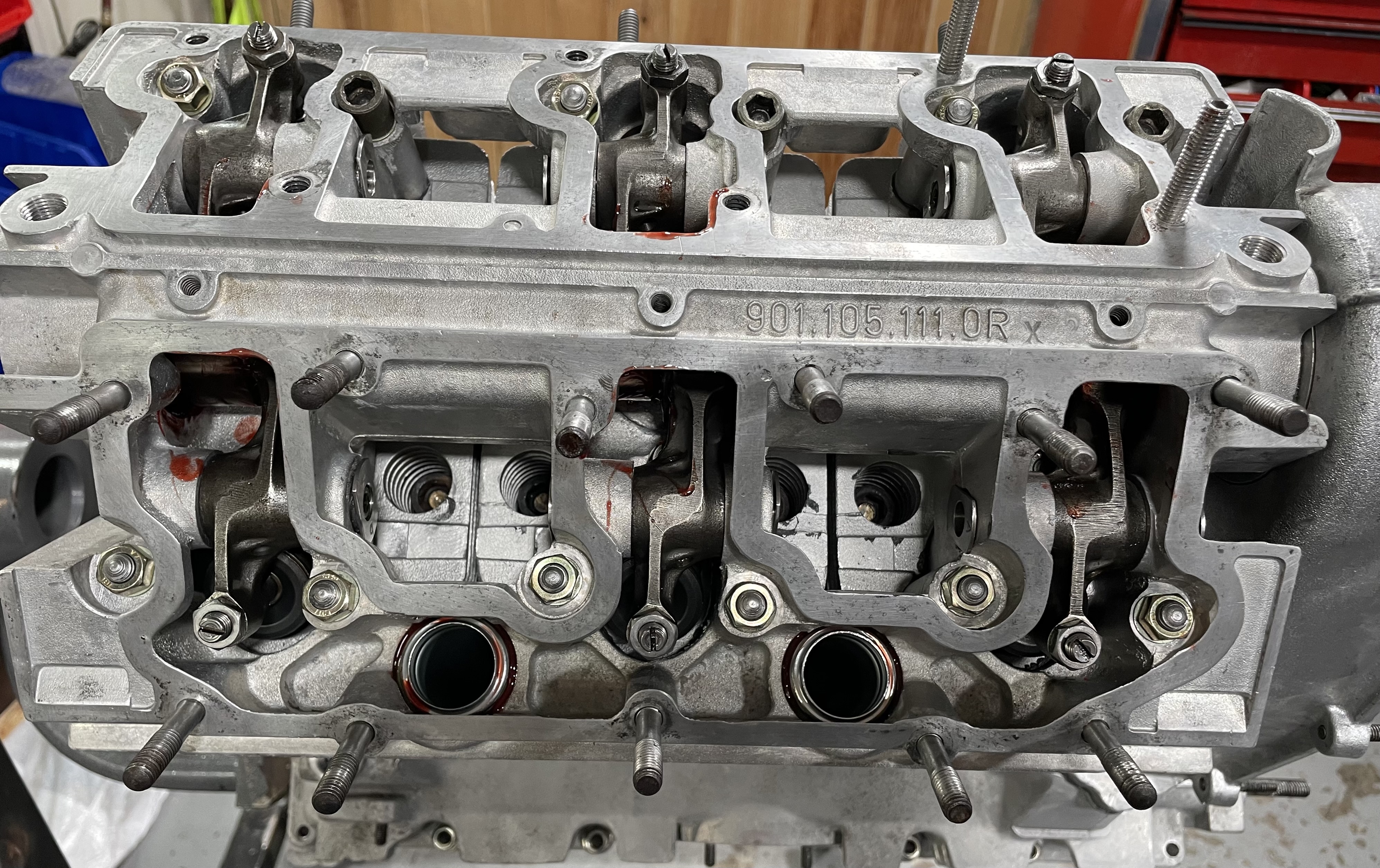

930 tensioners with safety collars:

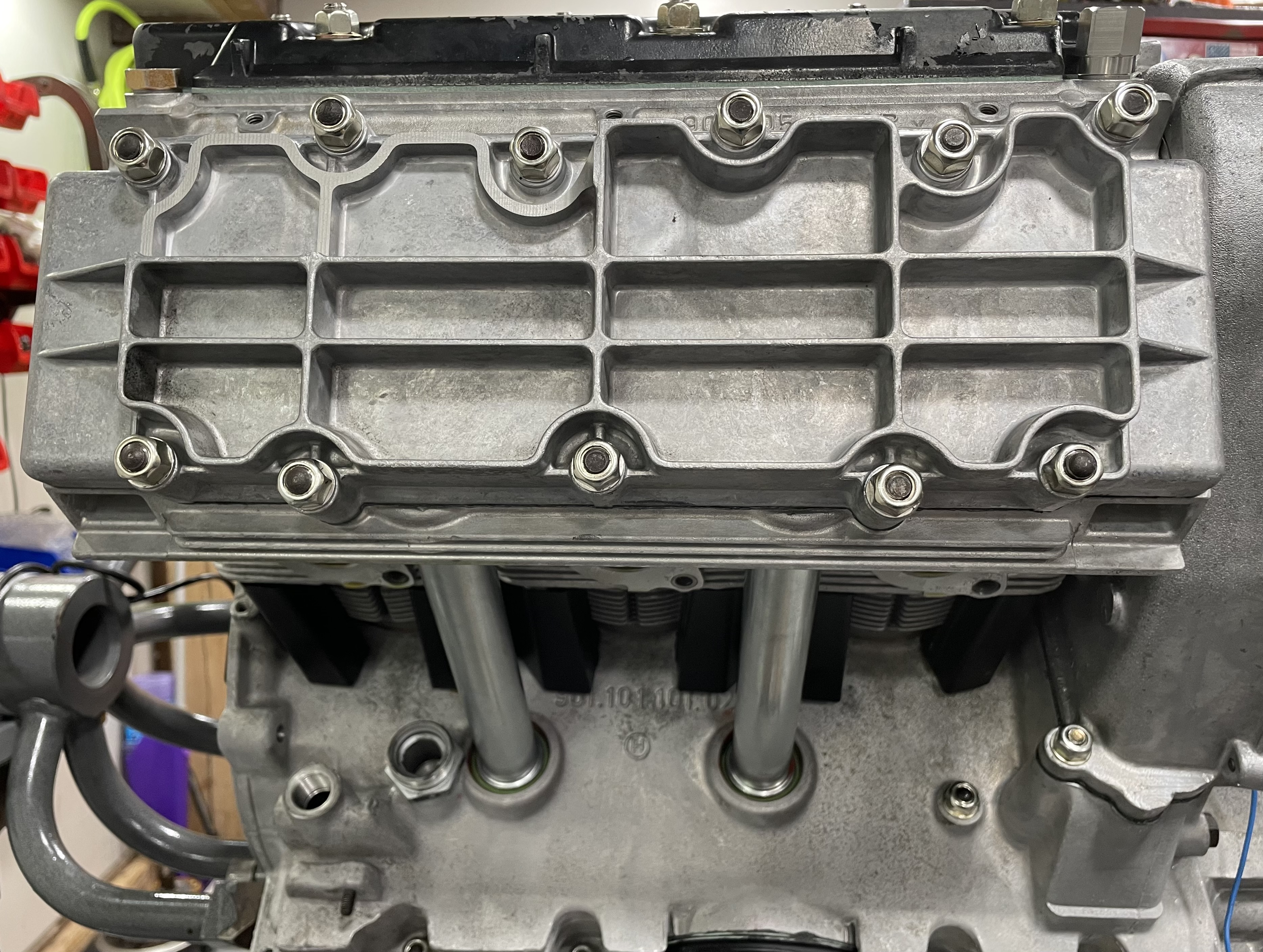

Rockers in & valves adjusted:

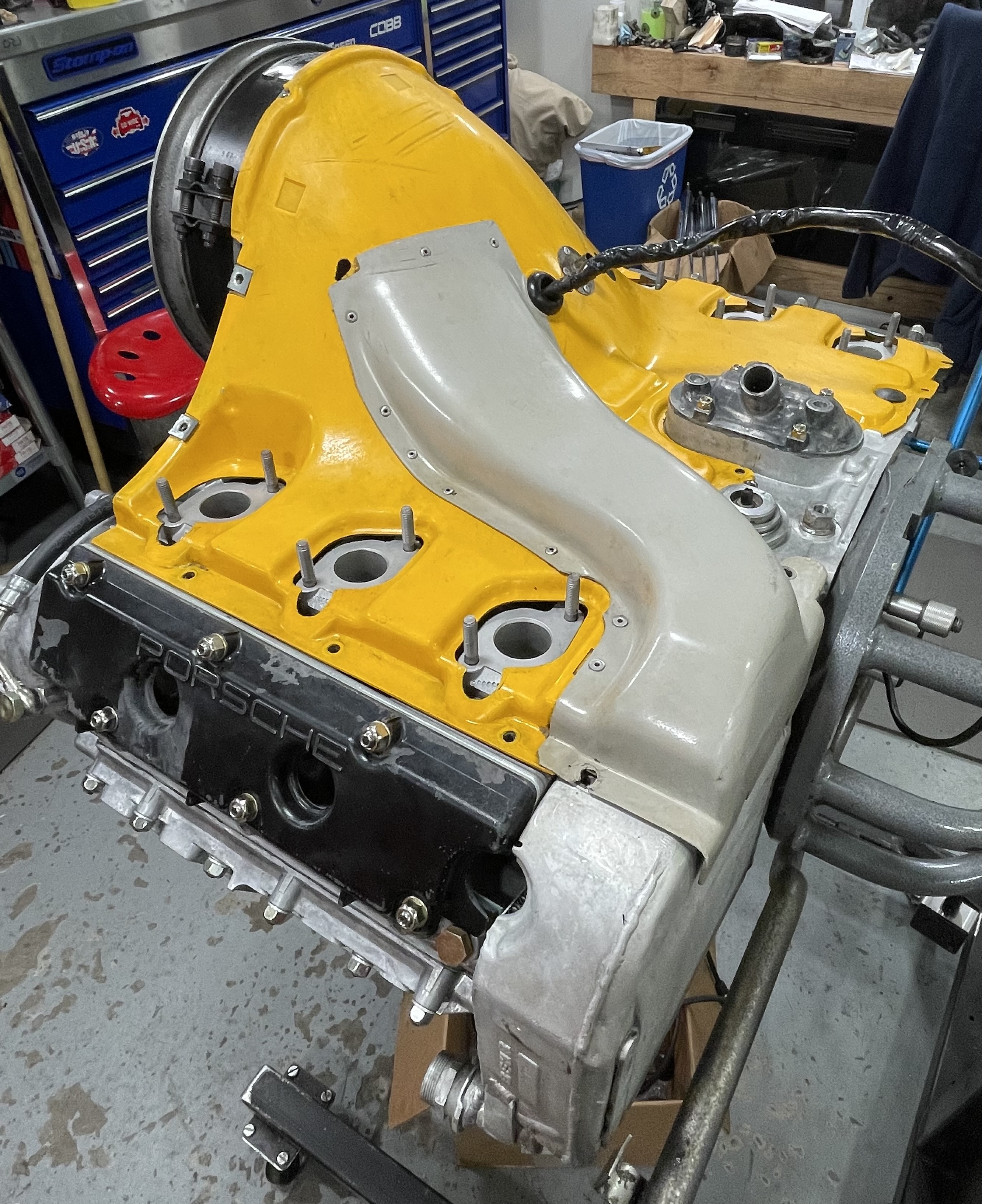

Bottoms up

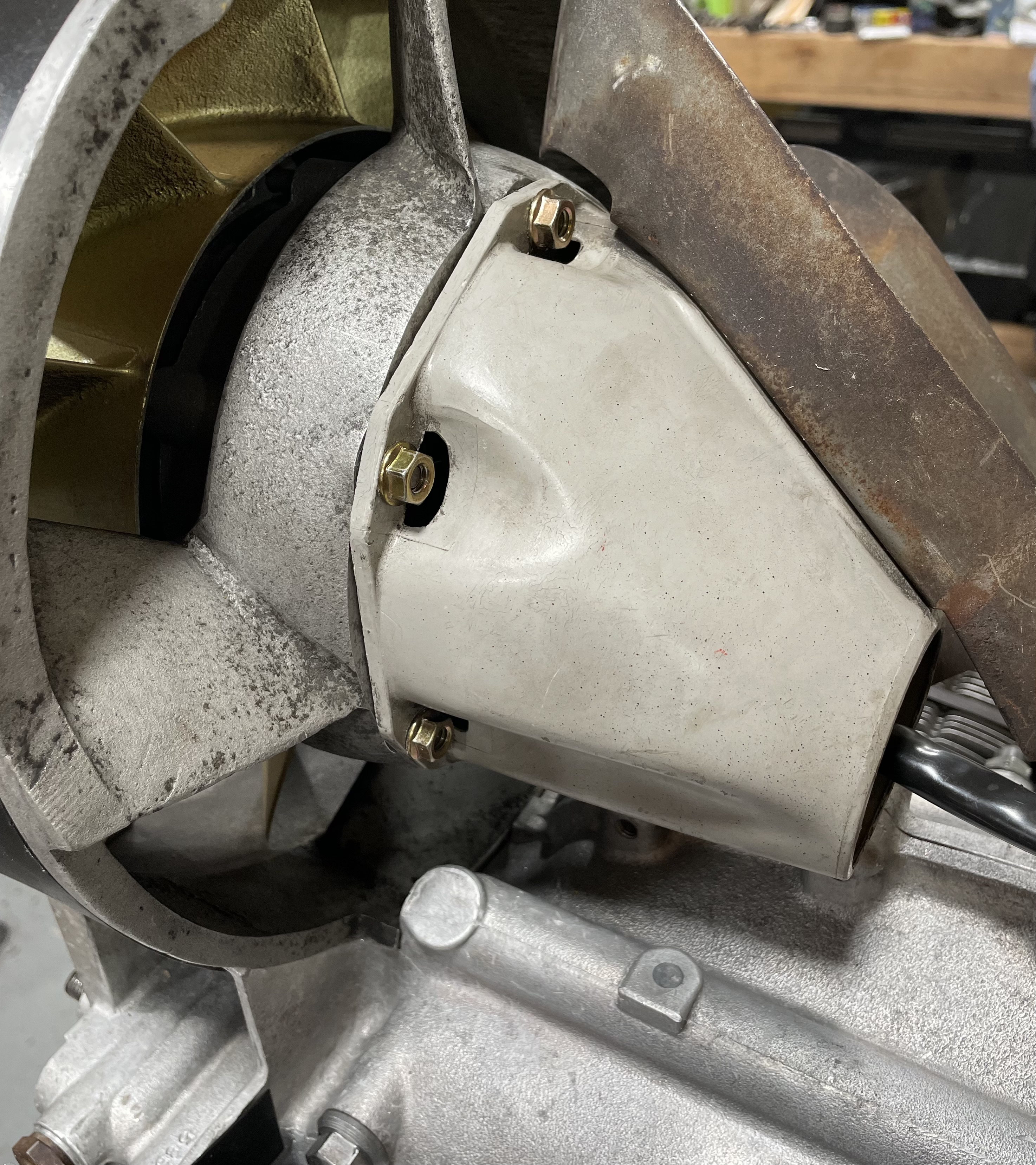

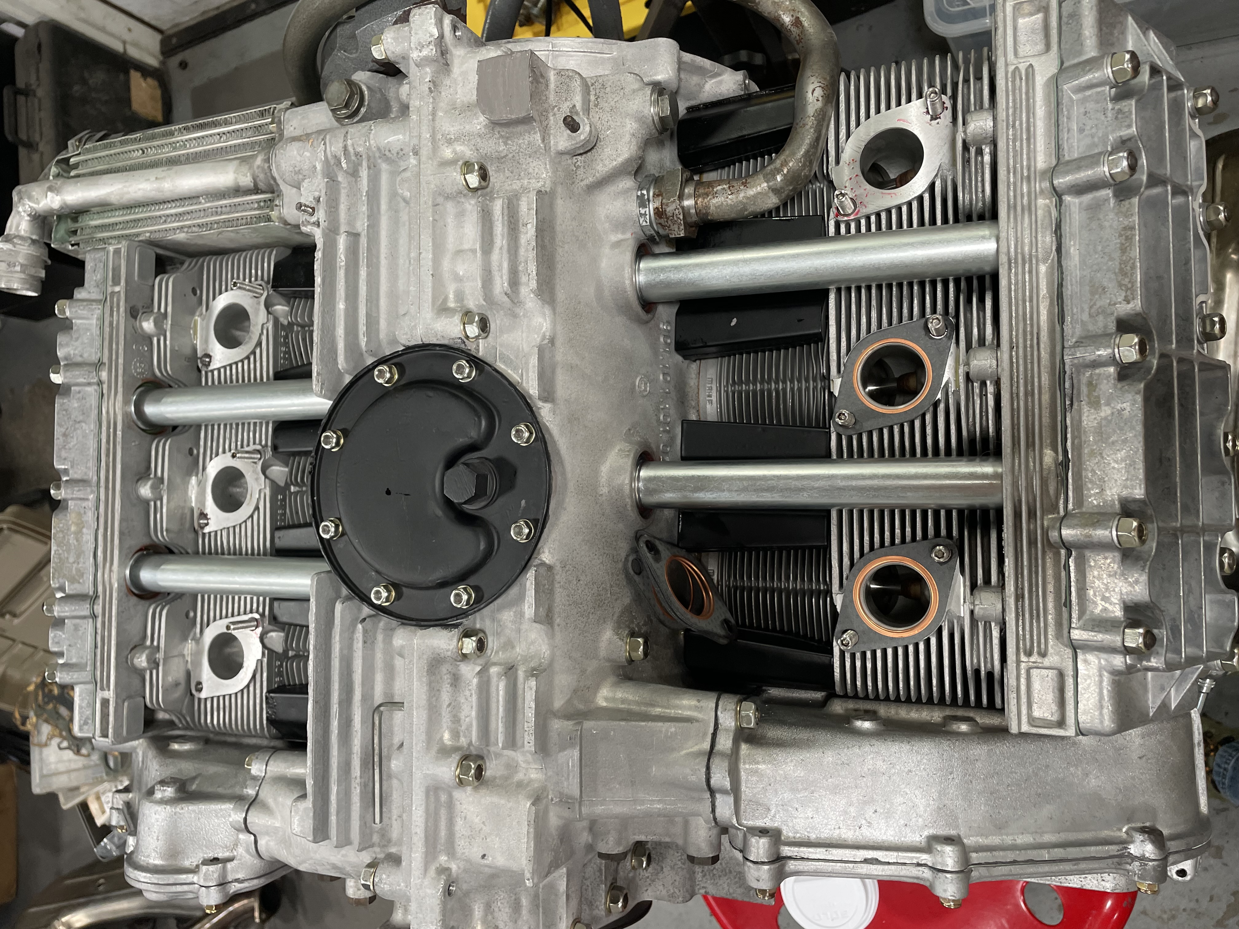

Came to find out , my engine never had a cozy cone. Now it does!

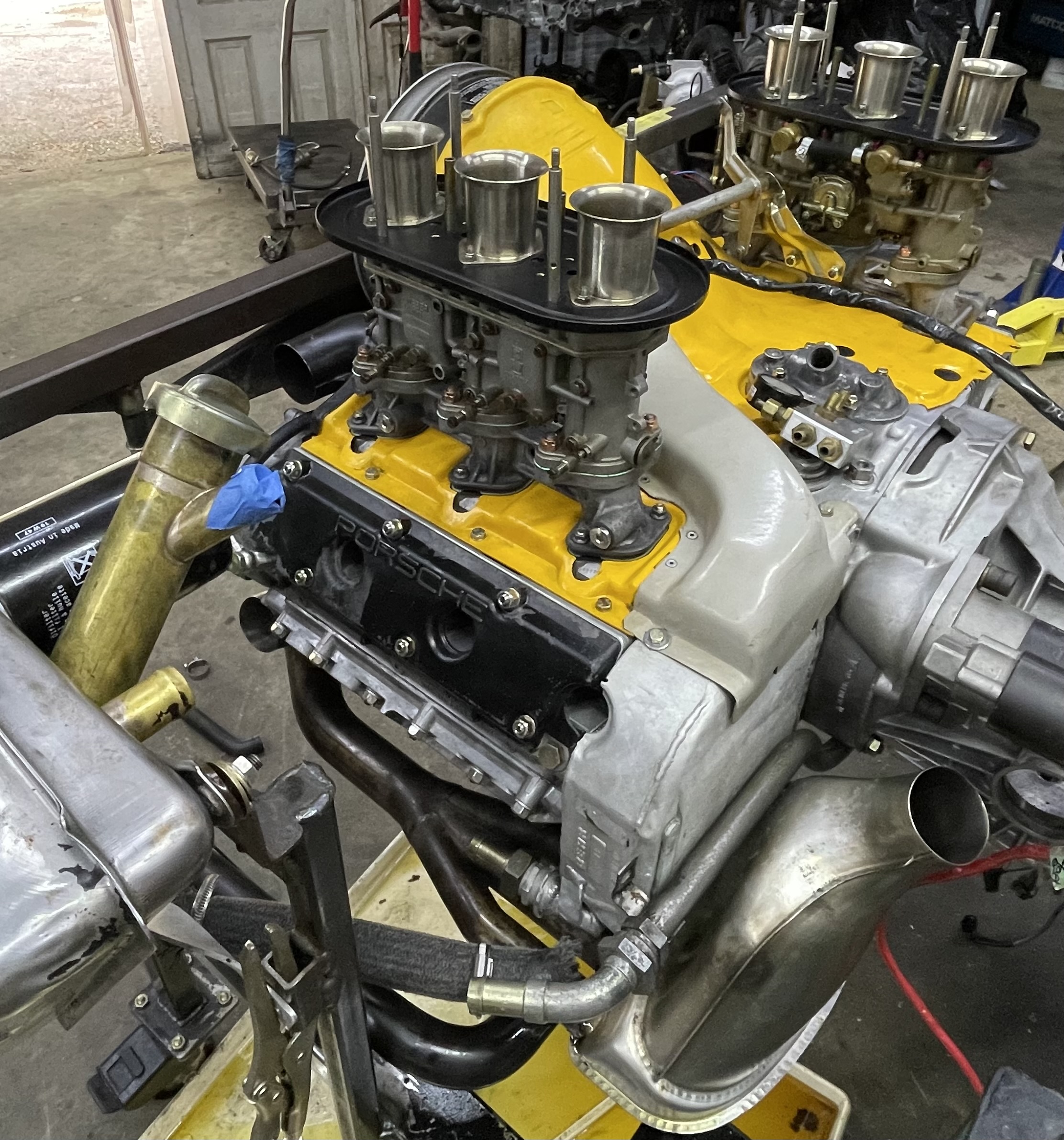

On the test stand

Dialing the Webers
