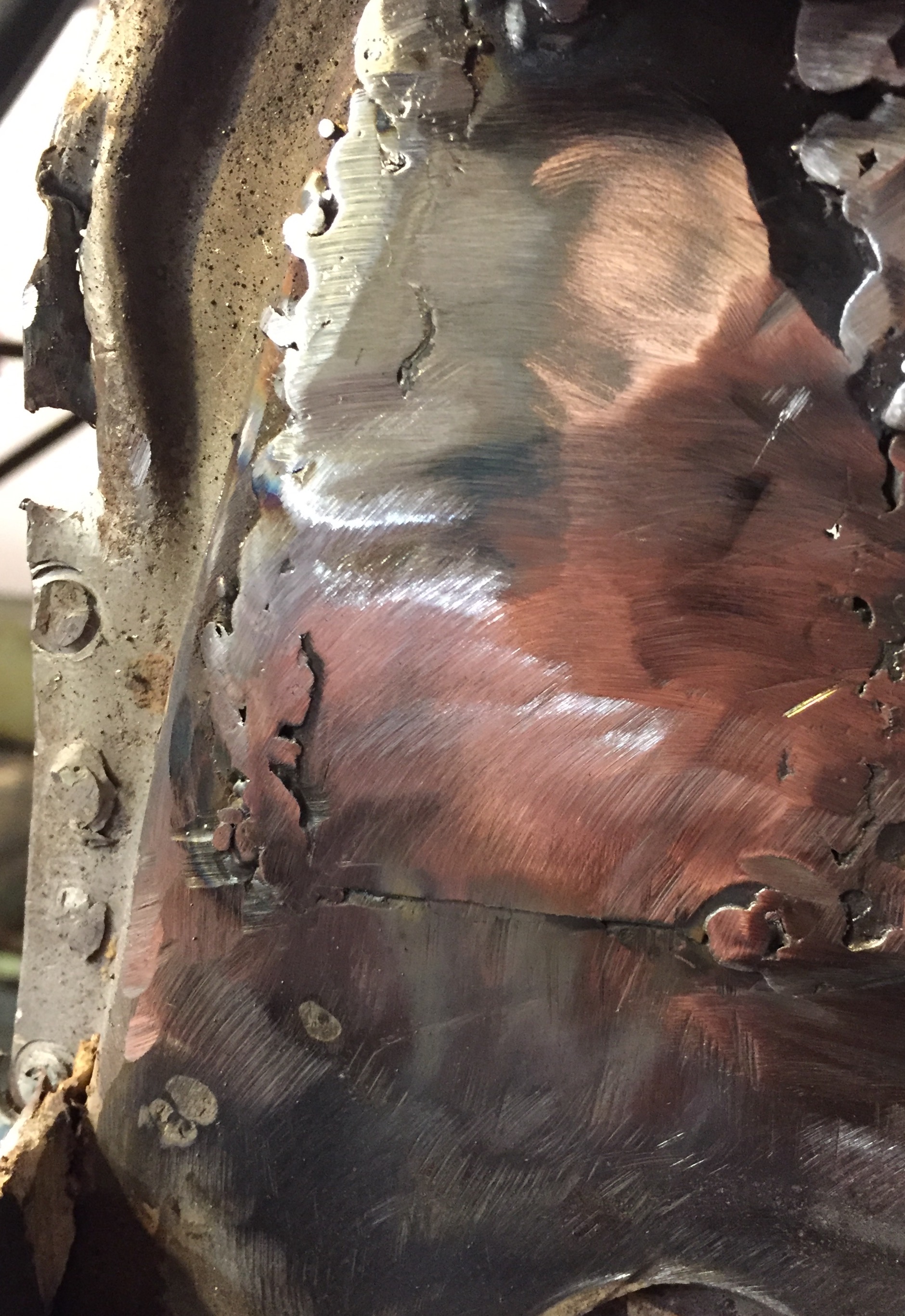

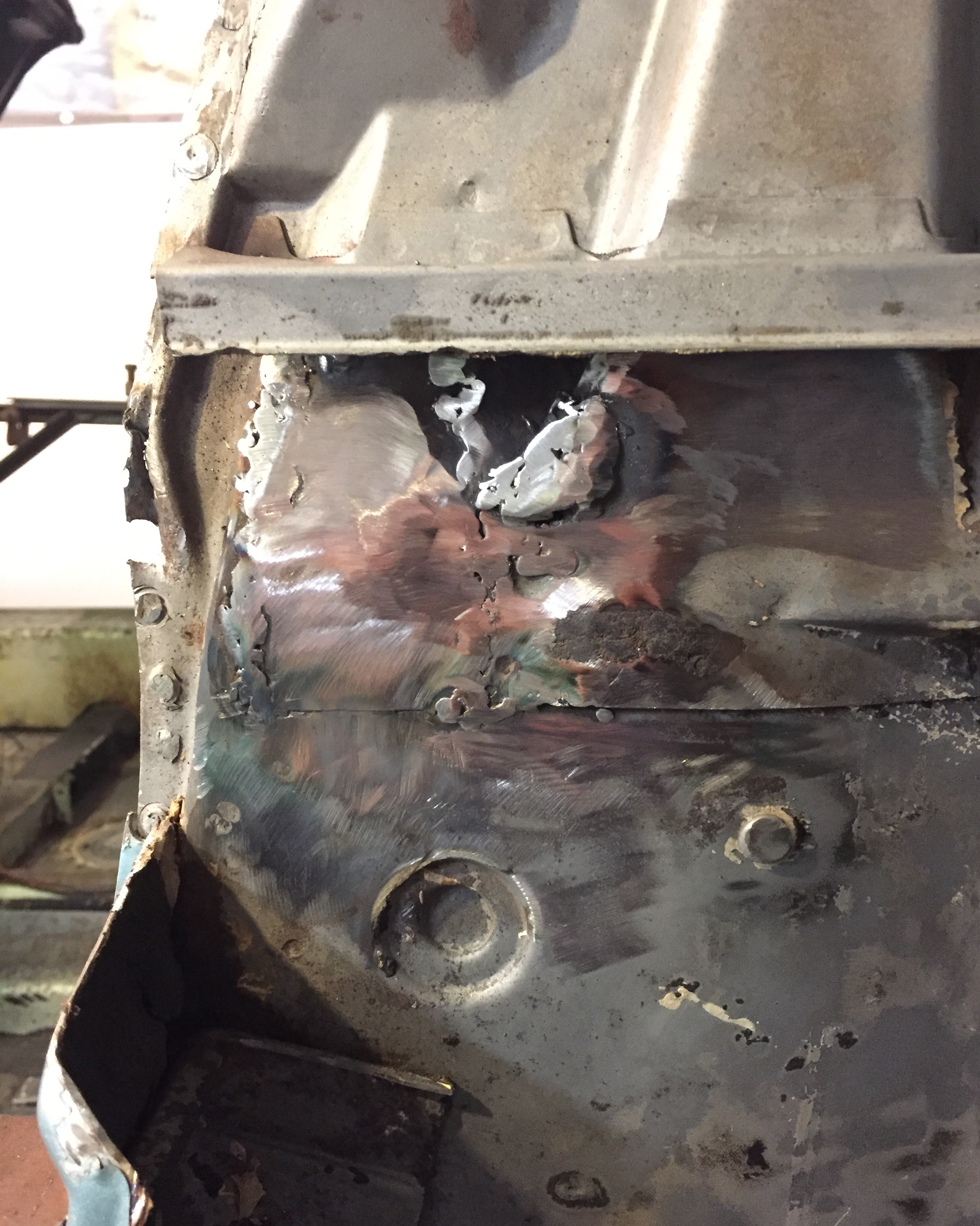

Ok per Bens advice. Obtained some flap discs. Trying to correct my sins. Welded some pin holes and reground, then flapdisc the area again. No one will see the amateur job but it's giving me practice. This patch will get cut open again for the snorkel tube.
At least it's a rust free and solid area. Not the prettiest.

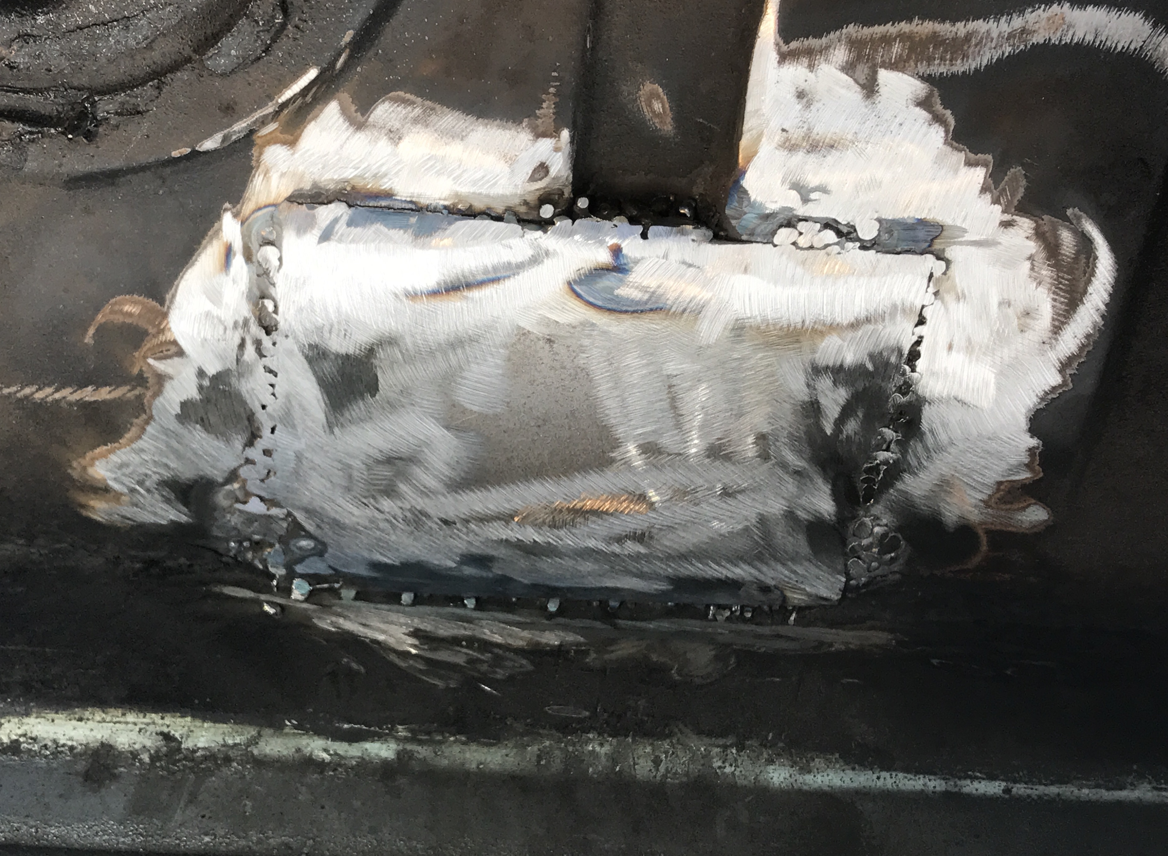

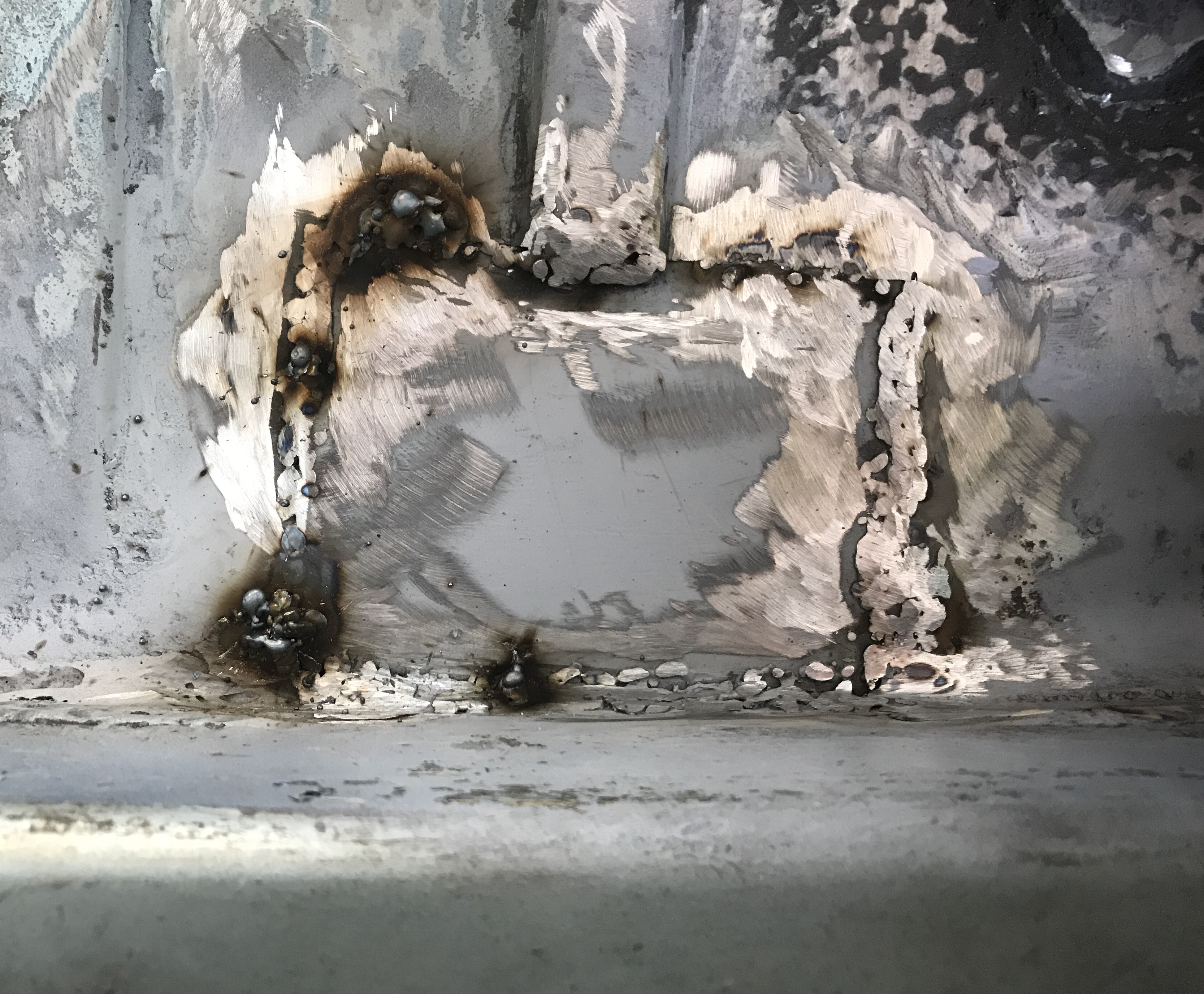

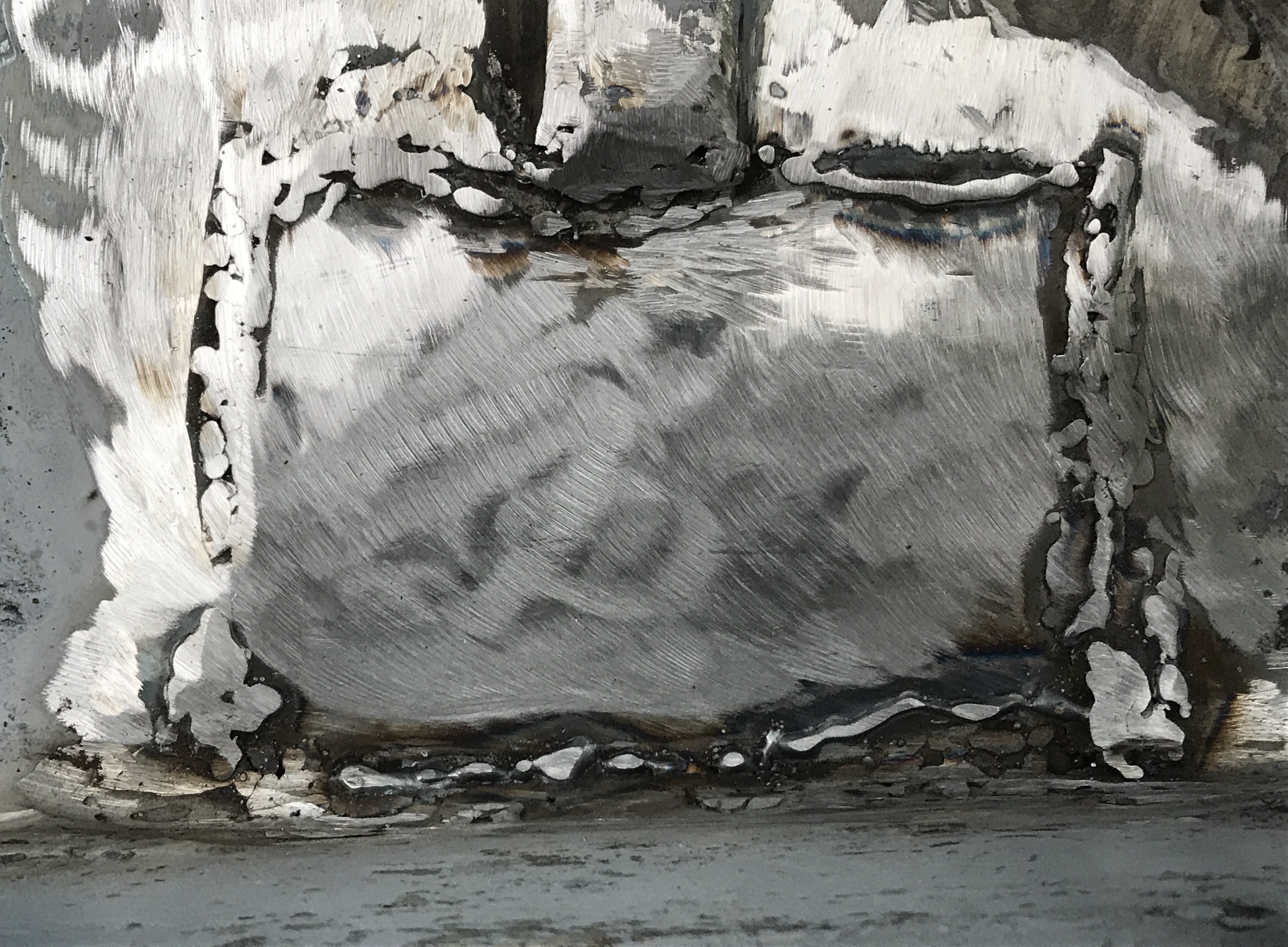

For your viewing pleasure and critiquing:
Heeding the advice of the experienced on this board, I went back to my trunk floor repair. It improved a little. I'll need some body filler to smooth out for better aesthetics
and then paint. I know it gets covered by the mat and carpet. My concern is being watertight. I do like summer but working with the safety equipment on when it's 85F and
90% humidity , whew! A new appreciation for those that do this for a living.

Top:

Bottom:

Dion - It's hard to tell from the pics but it looks like you may have the repair piece not quite aligned / in level. It looks like you're ending up with a step where your weld is.
I know I've got it "right" when I can use a 1/4" grinding wheel to knock down the majority of the weld bead and not get into the parent material of either side.
I use the grinder to get close then hit it with a 2" or 3" abrasive wheel on an air angle grinder (depending on the available clearance) to take it almost to the parent material level.
If I have the room, I then do 80 grit on a d/a sander. If no room, 100 grit on the 2"/3".
On the water tight: get a powerful light and shine it on one side of the weld while viewing from the other side. You'll see pinholes where there are, well... pinholes!
buzz them closed and check again til they're all gone.
And remember: It's only metal!
Keep up the great work.

Chris, you are correct. Slowly getting there. Yes I have a halogen work lamp under the car shining up. Pinholes revealed themselves. Closed them, found another after I hit the area with some primer. Yep it's only metal. I'll still need to address it. But it's way better than my previous attempt. Thanks for the encouraging words.

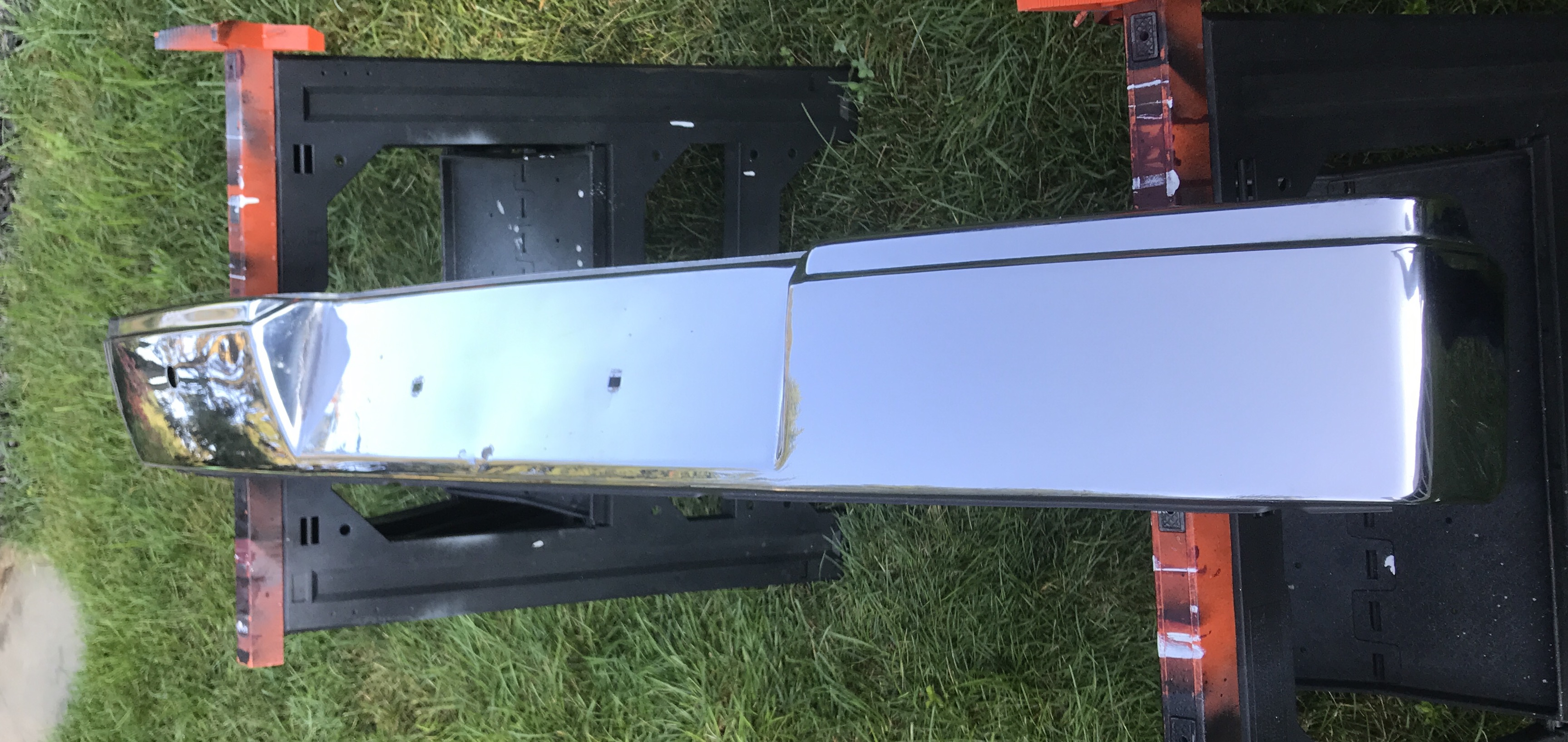

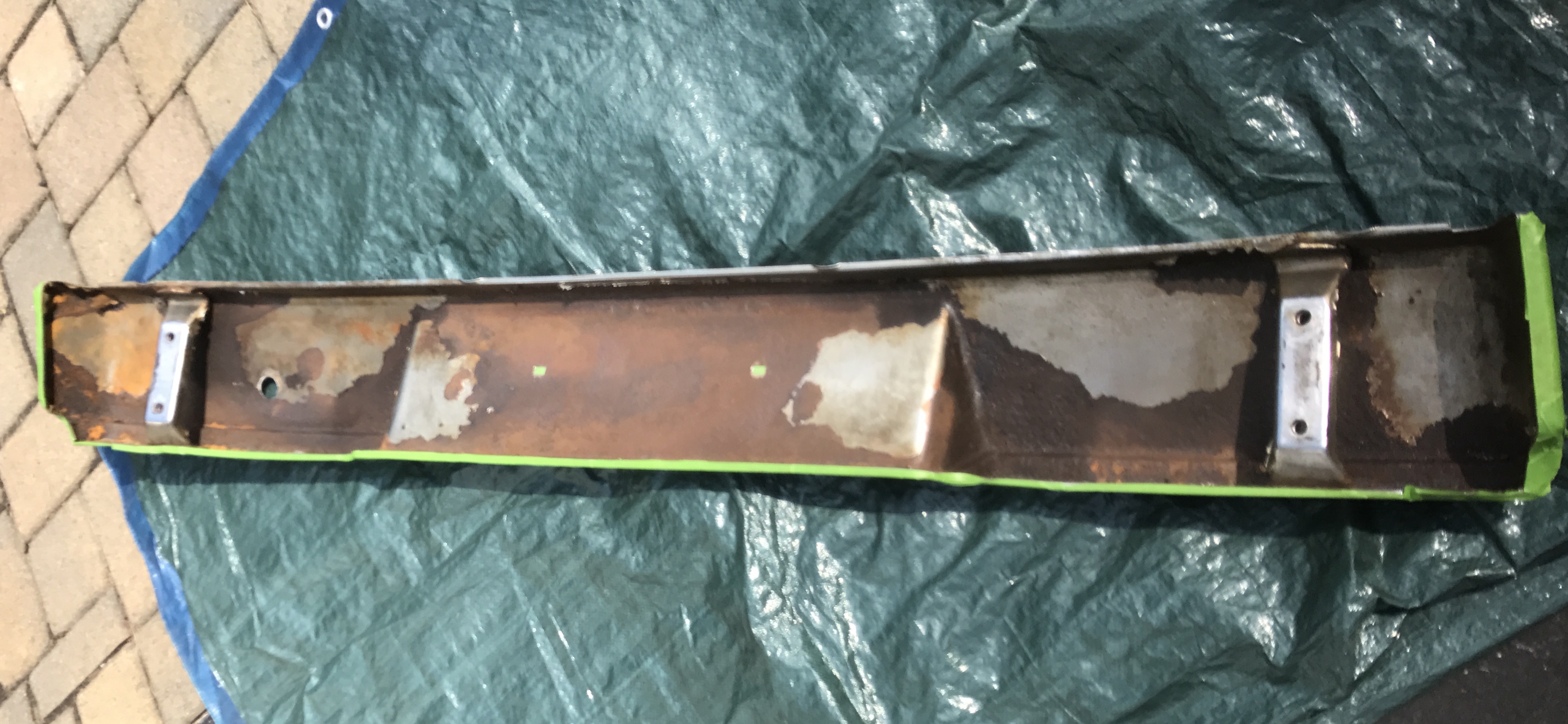

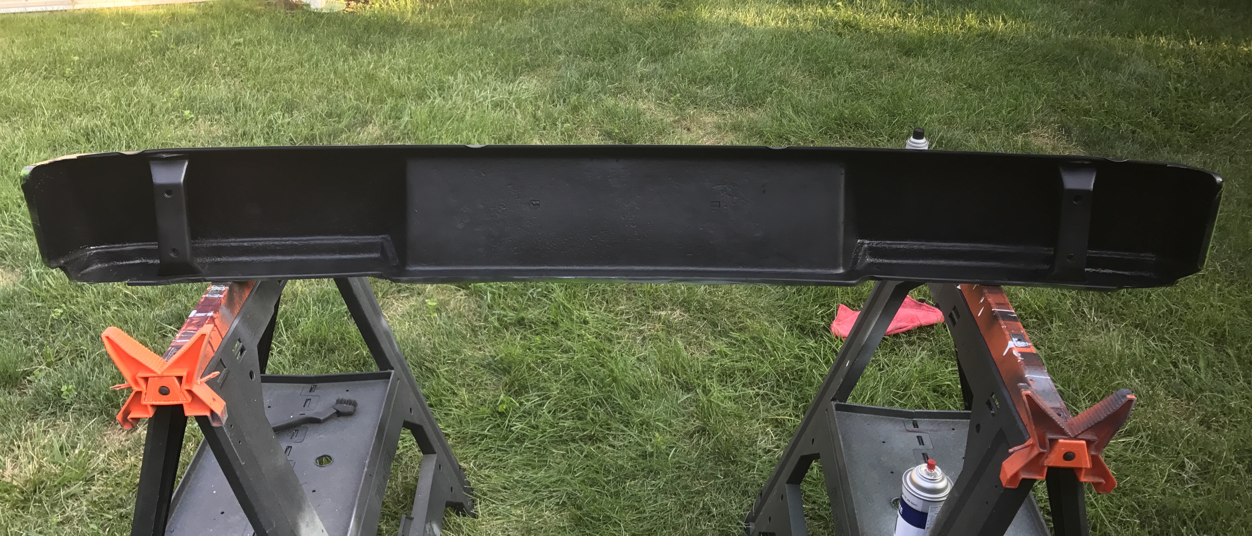

Rescuing an early bumper. Rusty backside. Sandblasted, some flap disc work. Rust encapsulater from Eastwood. Then some paint. Chrome side is.... well it's better than
my scratched and dented one. This one has a few dimples but less obvious than my previous bumper. Took a buffer to it. It's a 10 footer. Good for my driver. It has built in
patina (IMG:style_emoticons/default/biggrin.gif)

Polished

Looks nice way better then what I had ..
