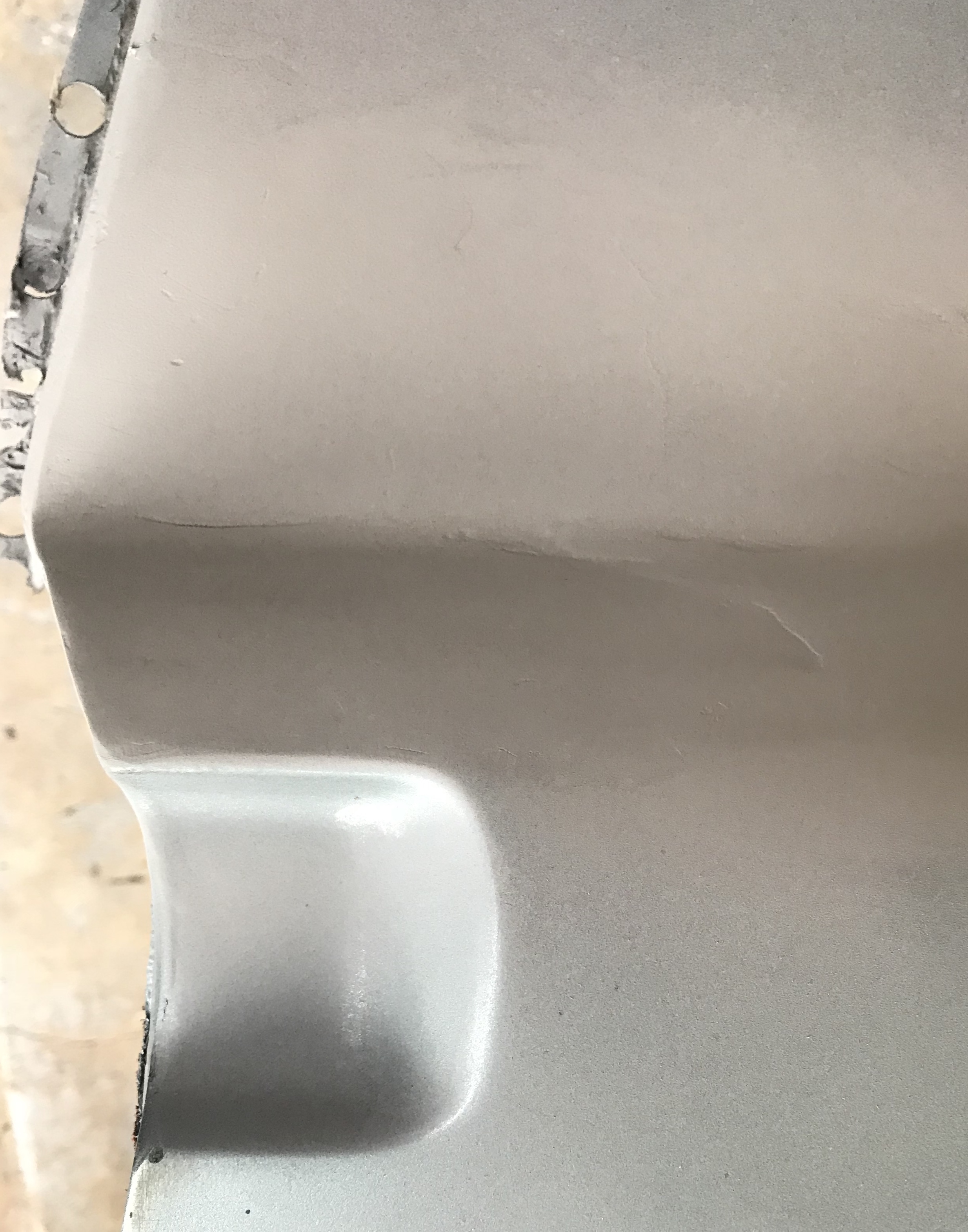

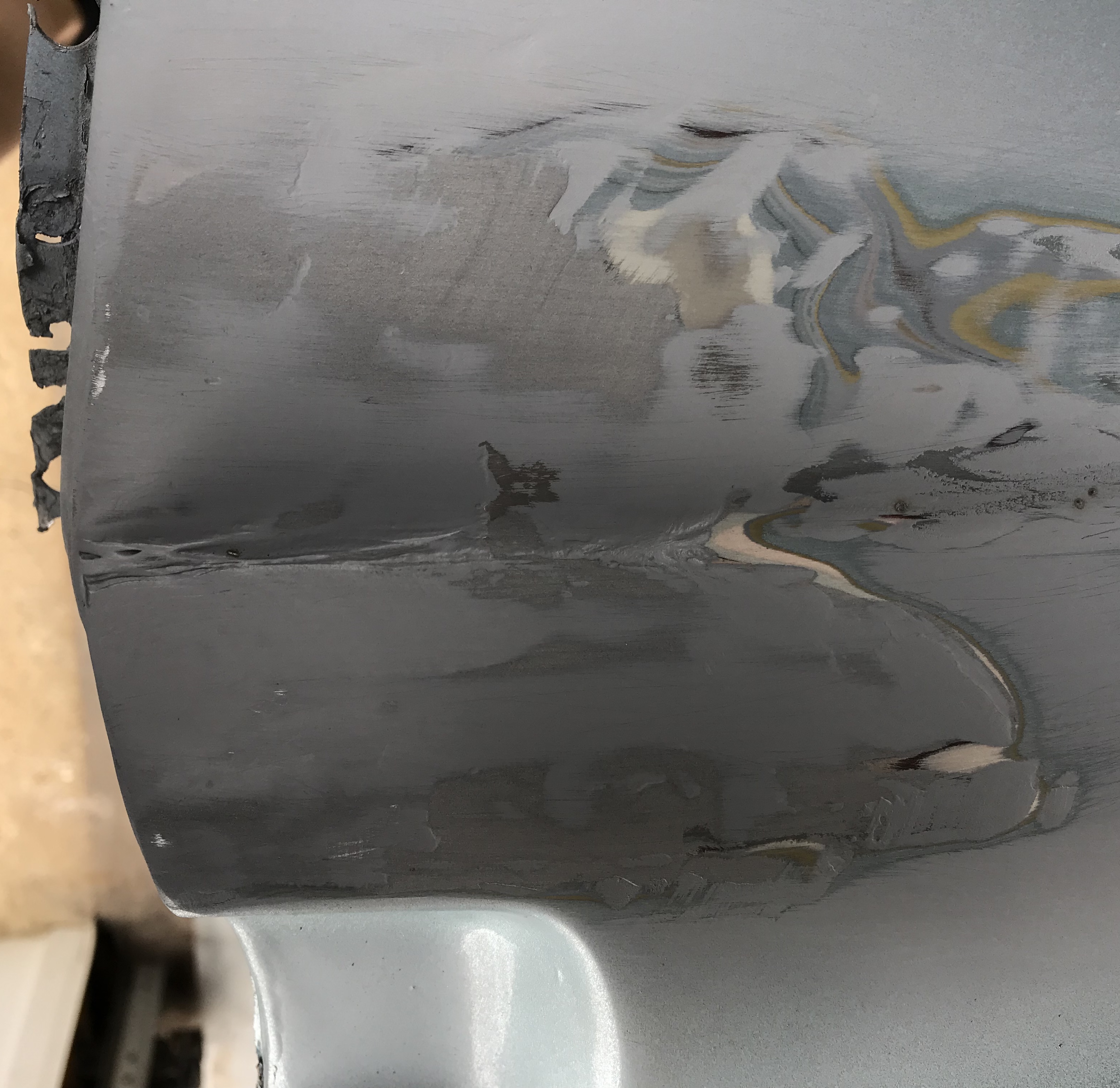

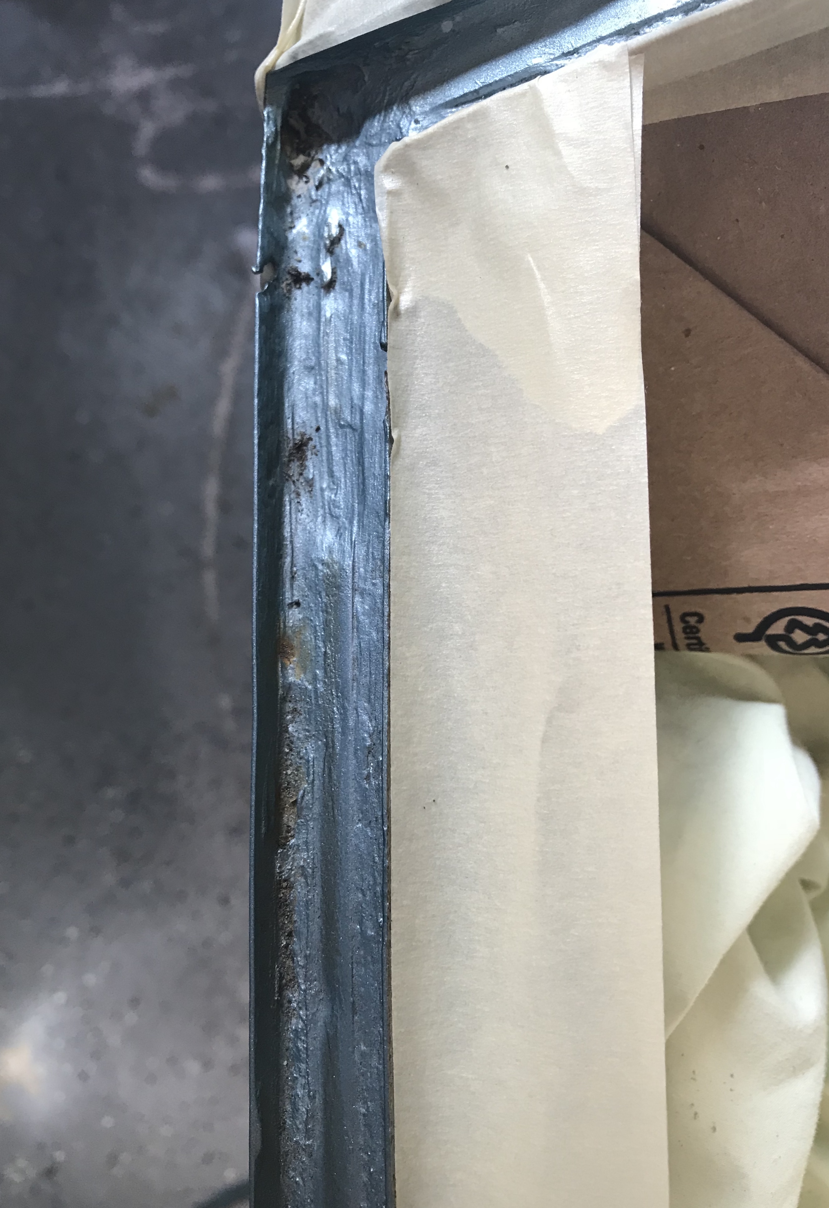

Went back to work on the sail panel patch again.

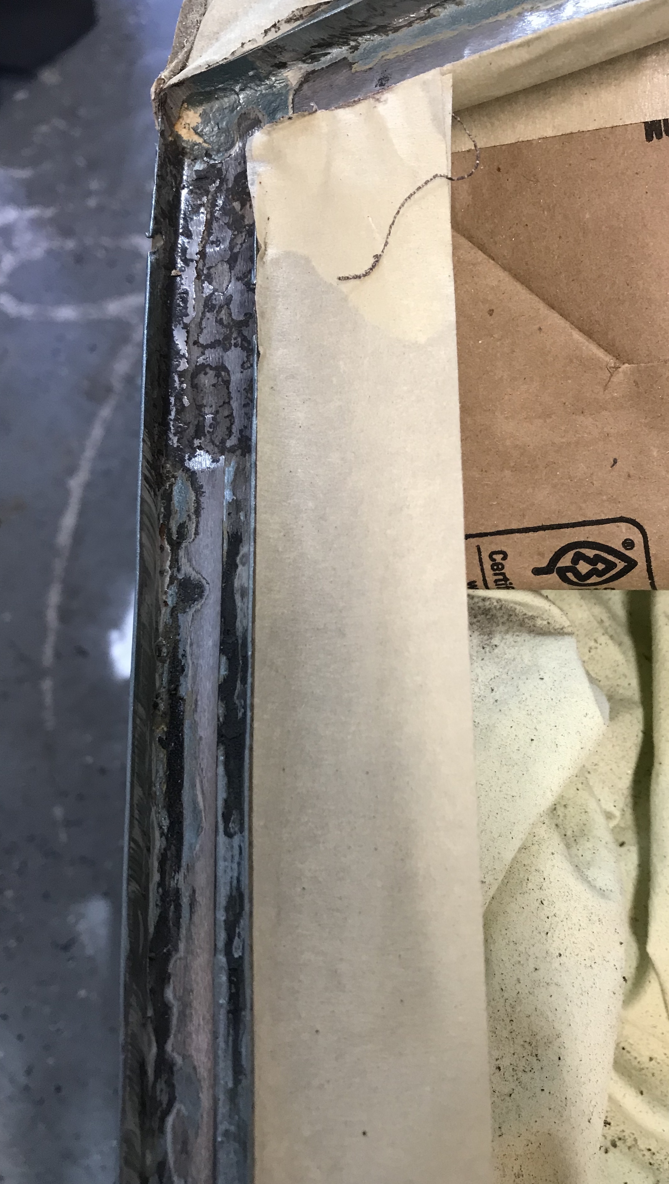

Wasn’t really happy that some flash rust had shown through the primer.
Sanded that area again and prepped. Then used some self etching primer there
since it has the “zinc” content in it.

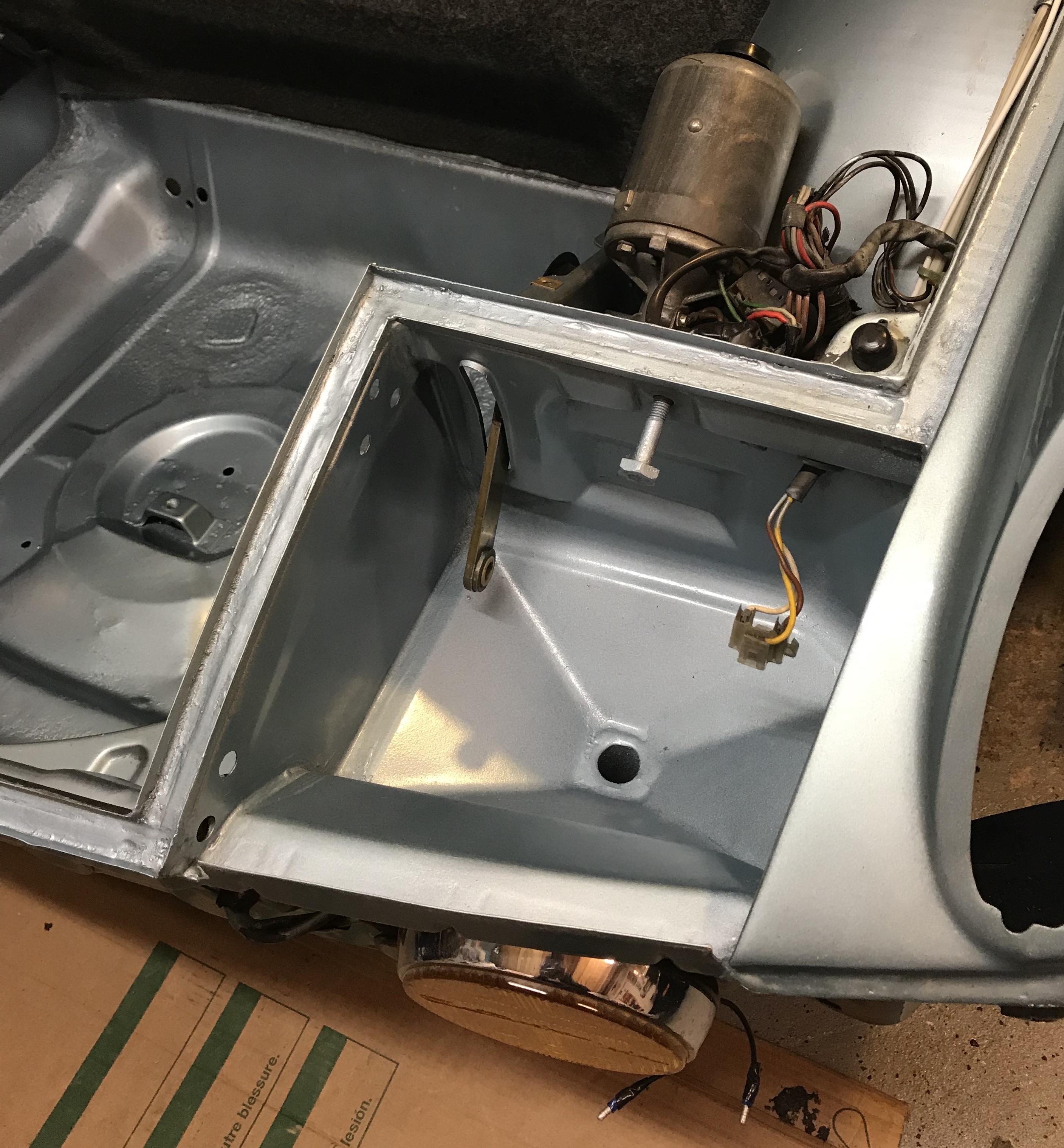

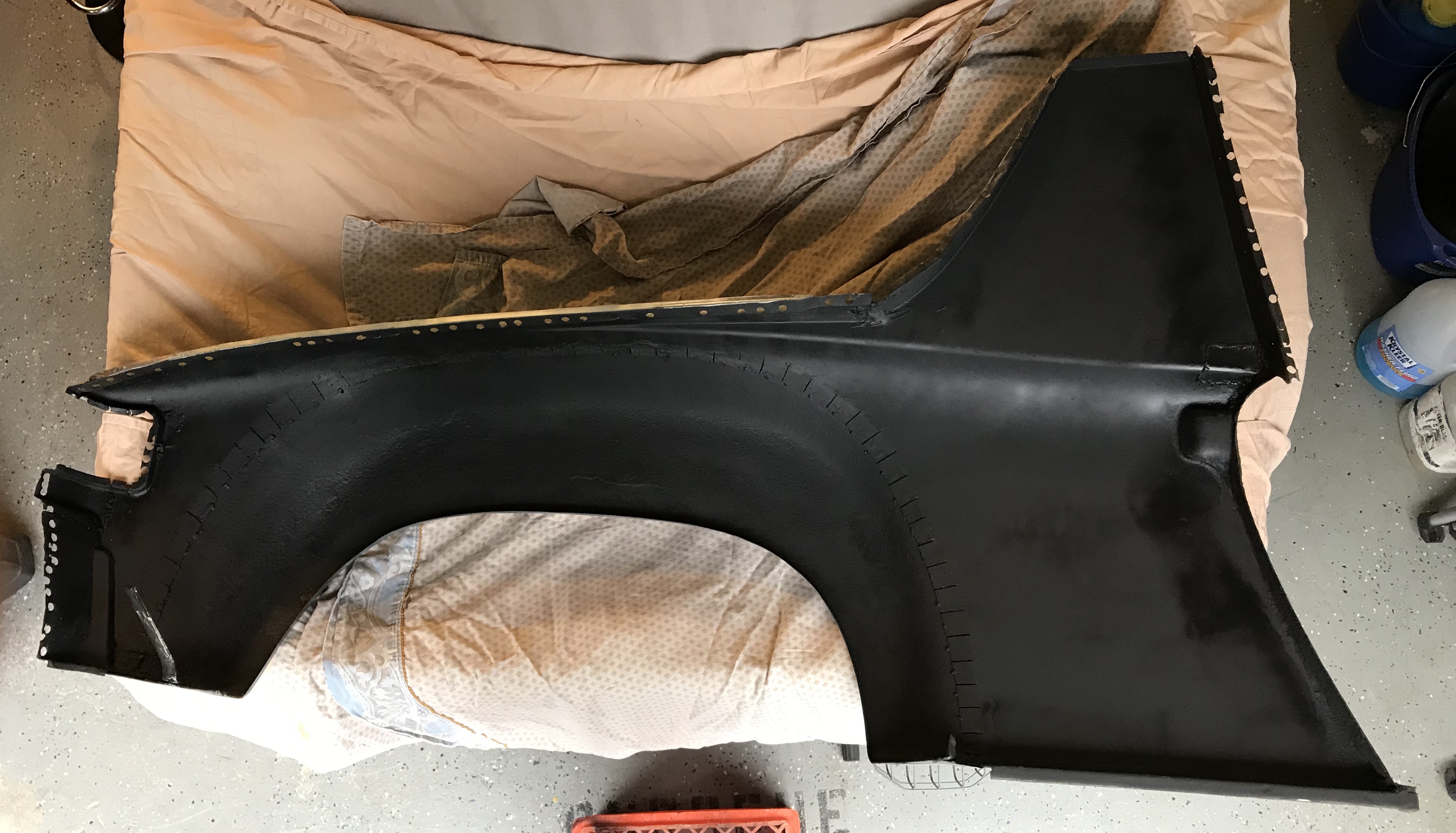

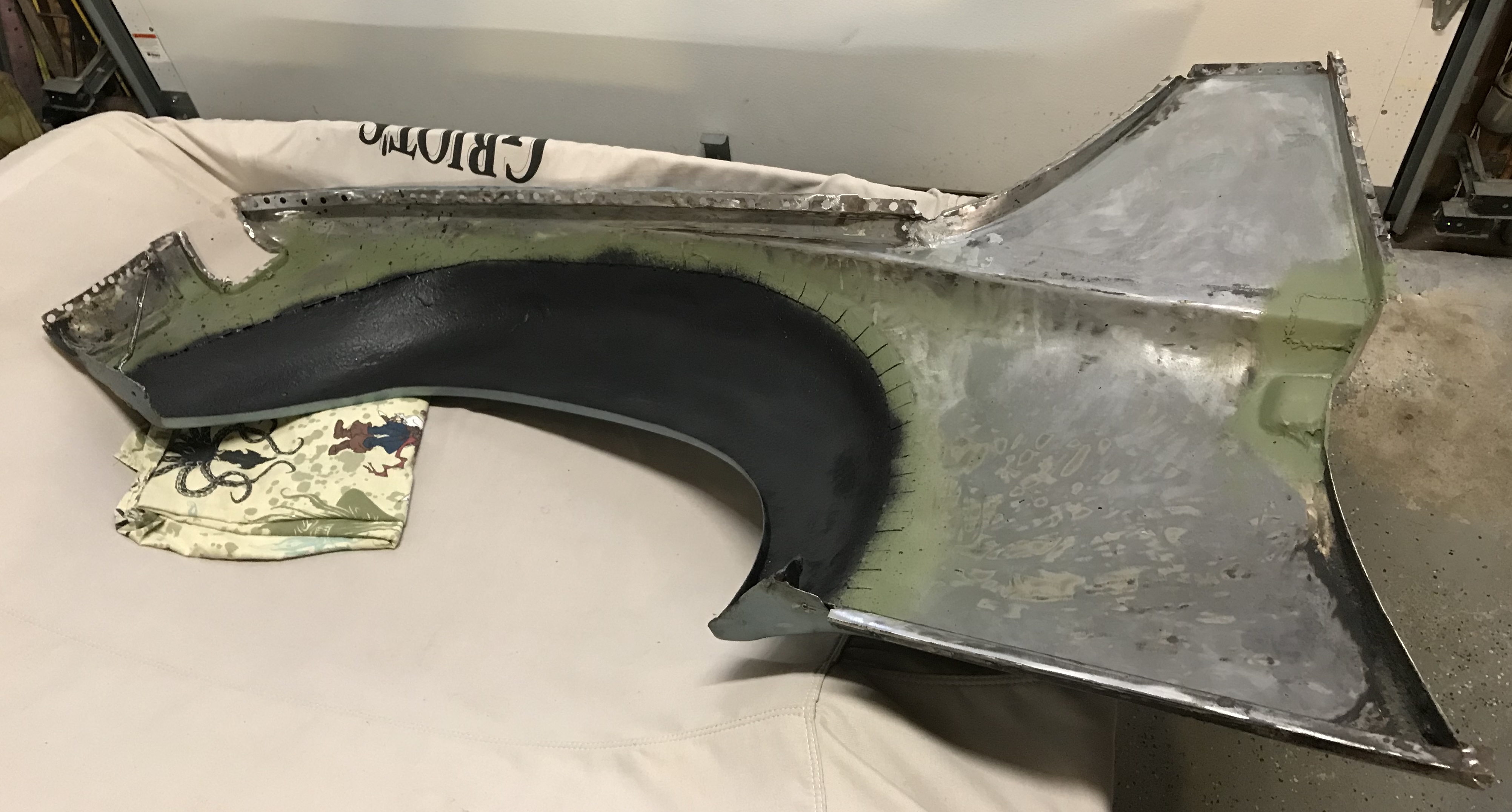

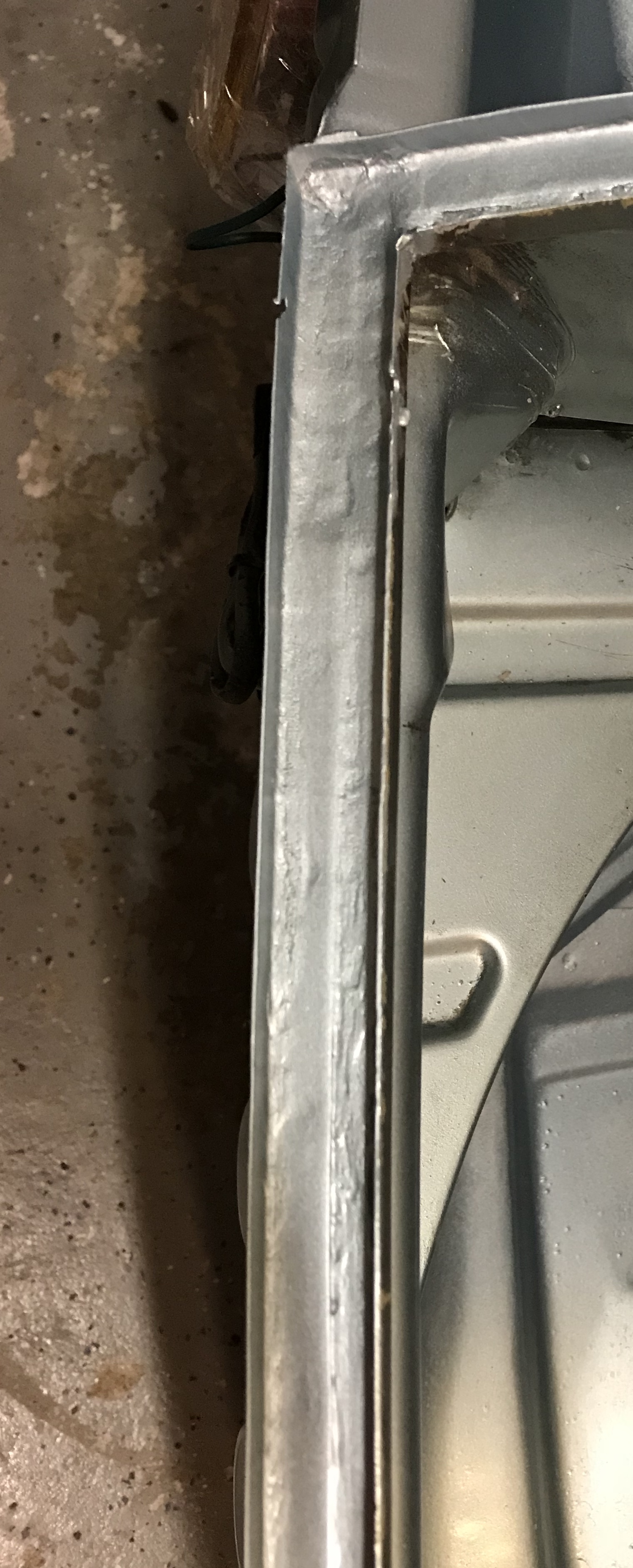

Flipped the fender over and used the same treatment I did for the other flares.
Where as my flares had been “lap welded” as opposed to “butt weld” , I wanted to add
an extra means chemically to warn off problems.
I used Eastwood’s internal chassis coating to have it creep into the small crevices of the welded areas. Of course cleaned it thoroughly first. Then I used “rubber undercoating” on the flare itself. The condition of paint on the inner flare was quite sound. After prepping and cleaning the rest of the interior of the fender I then sprayed with epoxy primer. This should keep till the rest of the chassis is done. Then finish bodywork can begin.... that’s a bit aways yet!

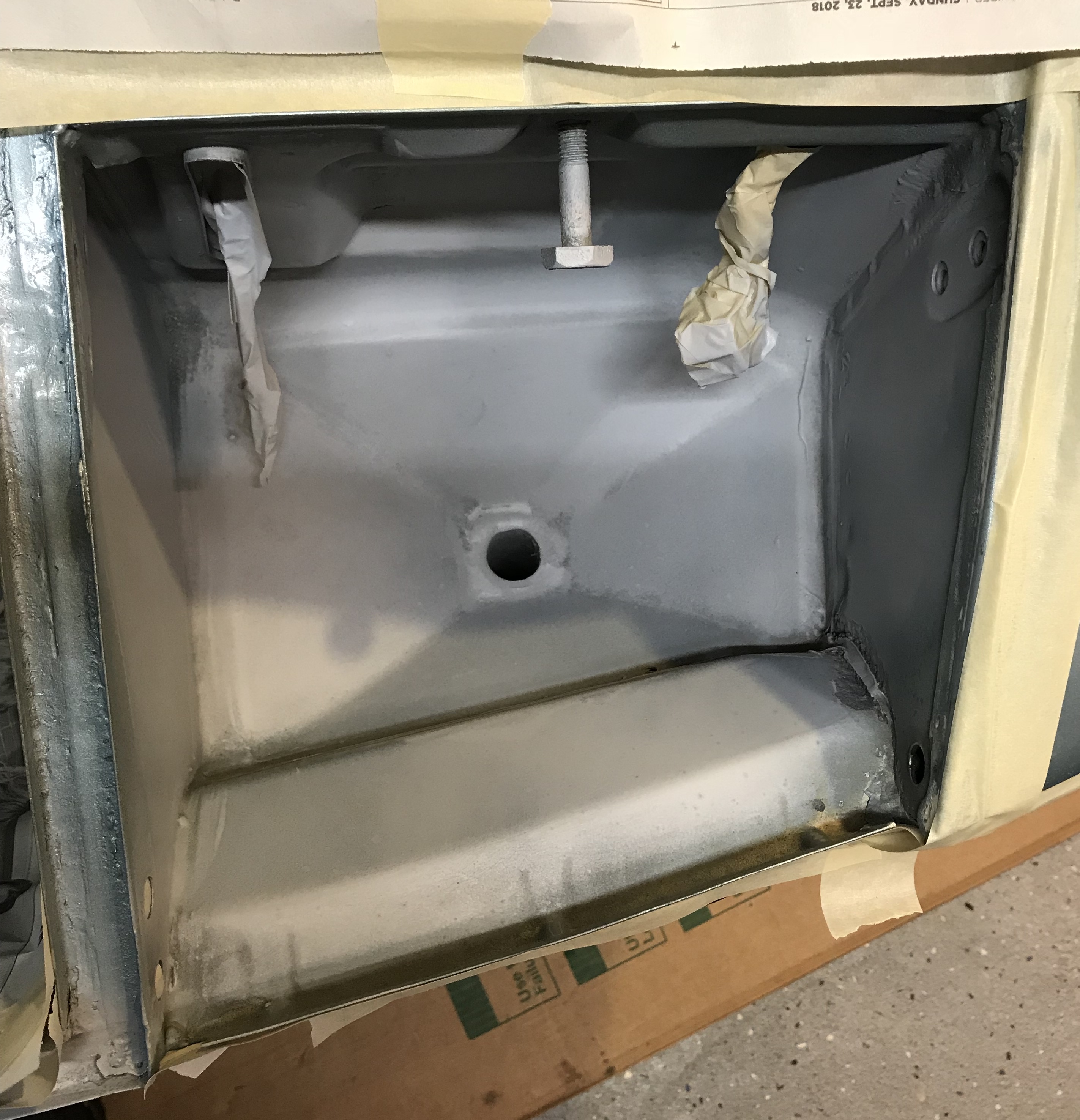

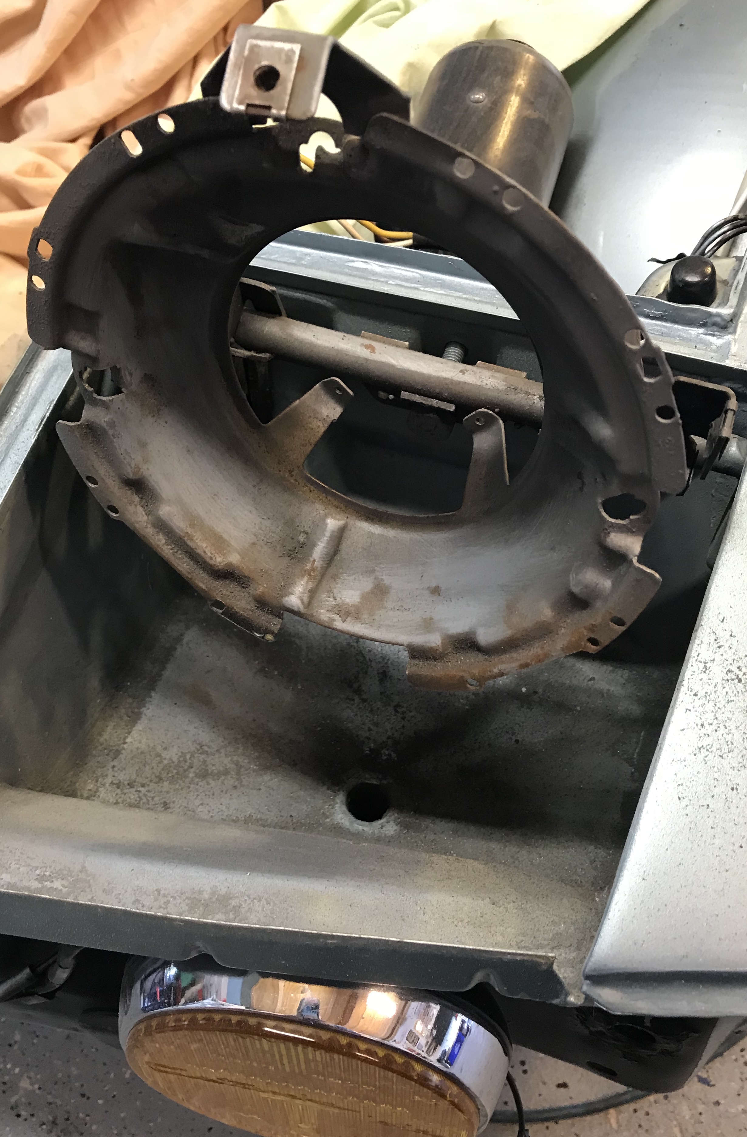

I know this car was a COTM & I appreciate that very much.
However the paint job was 14 years old and was just applied on the topsides.
No door jambs or underhood areas. So since we’re in for a pound in for a penny,
I’m addressing areas that need attention. I’m not calling this a restoration but a freshening. This is my build, my hot-rod. Not concours by any means. So if ya see flaws

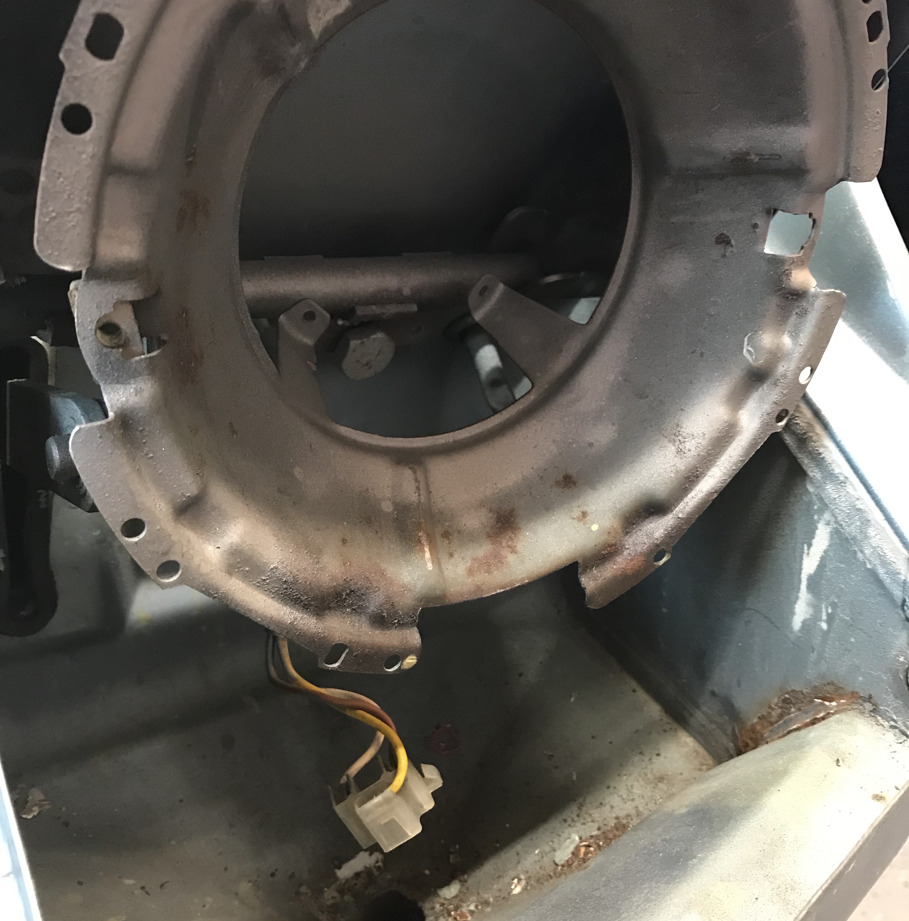

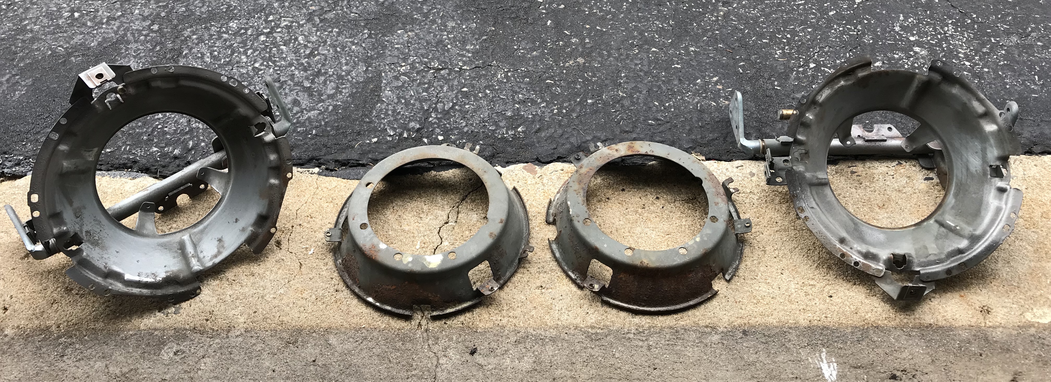

oh well I’m doing my best. So this weekend I tackled the headlite hardware and
the buckets. Sanded the headlite hardware, primered and gave em the zinc phosphate look with a spray bomb from Eastwood.

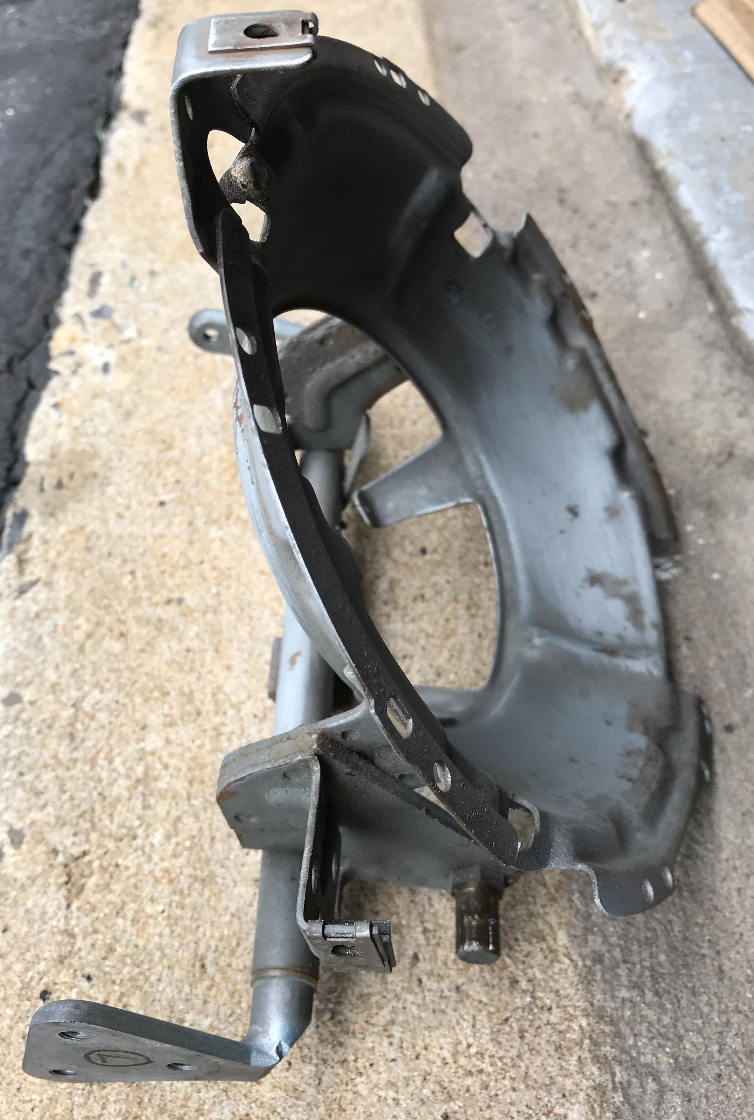

Dion
post Sep 23 2018, 07:38 PM
Post #344
RN
Posts: 2,931
Joined: 16-September 04
From: Shepherdstown, WV
Member No.: 2,766
Sanded
Dion
post Sep 23 2018, 07:39 PM
Post #345
RN
Posts: 2,931
Member No.: 2,766

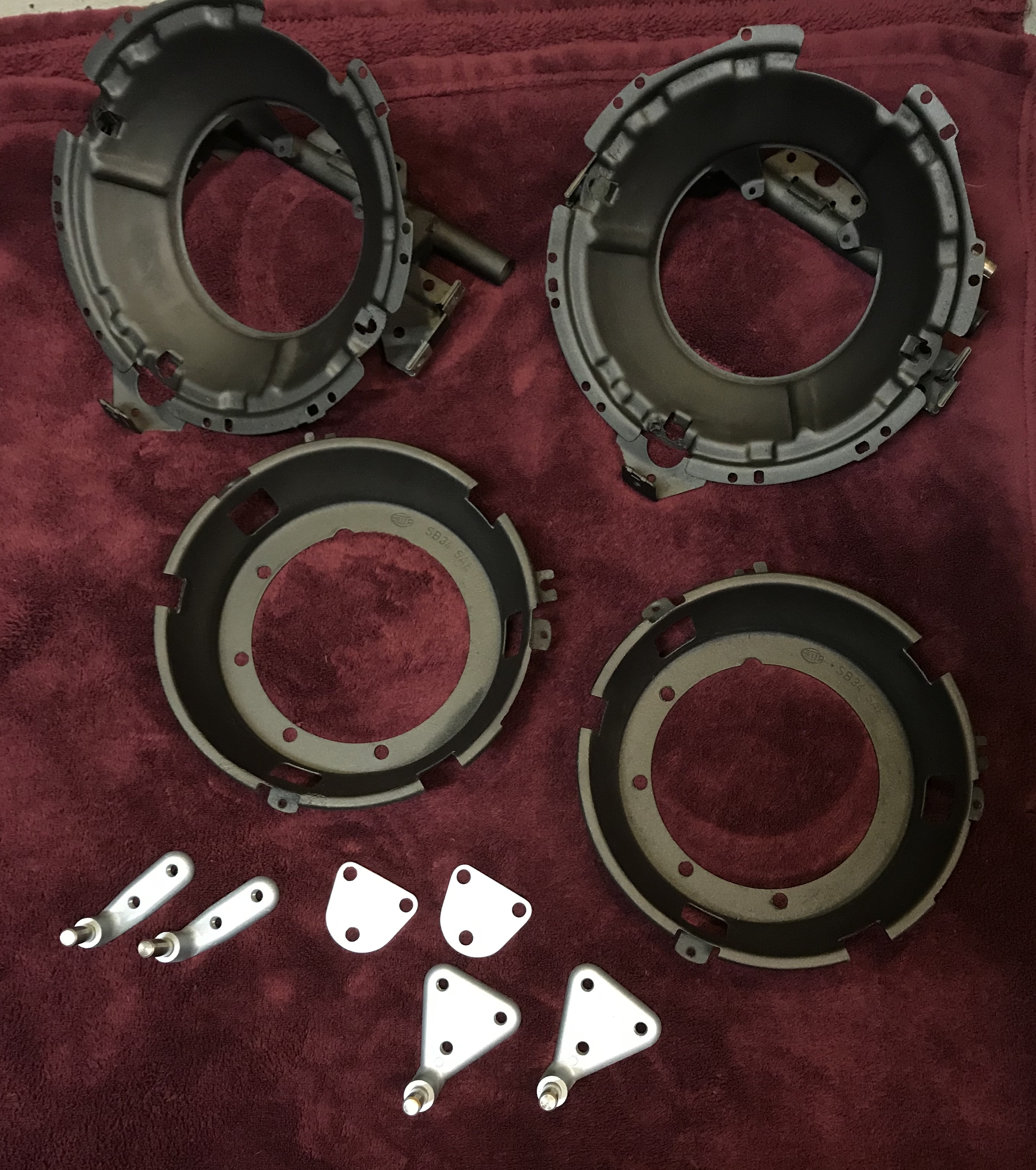

Sanded
Dion
Post #346
RN
Posts: 2,931
Member No.: 2,766
Paint
Dion
post Sep 23 2018, 07:44 PM
Post #347
RN
Posts: 2,931
Member No.: 2,766

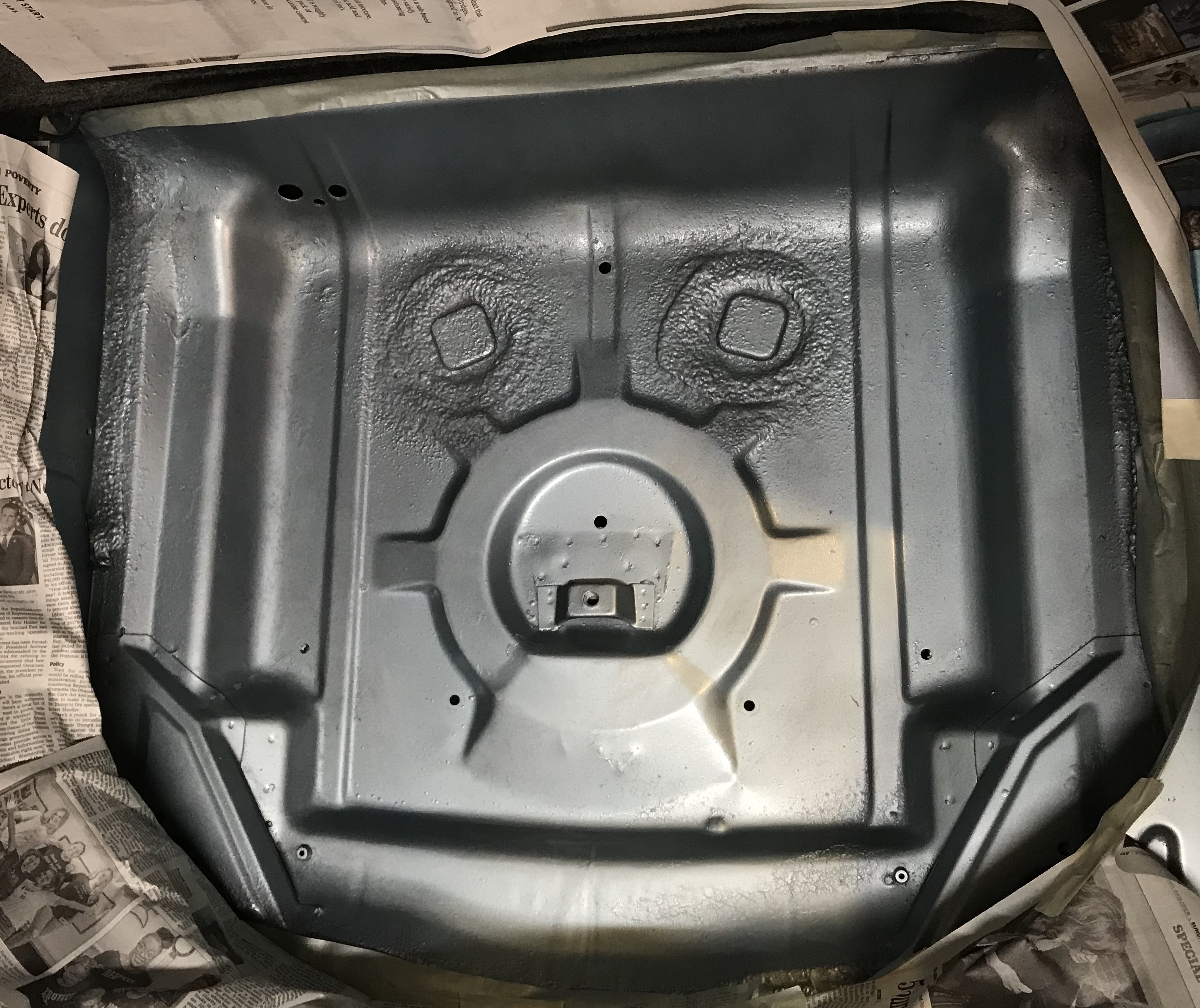

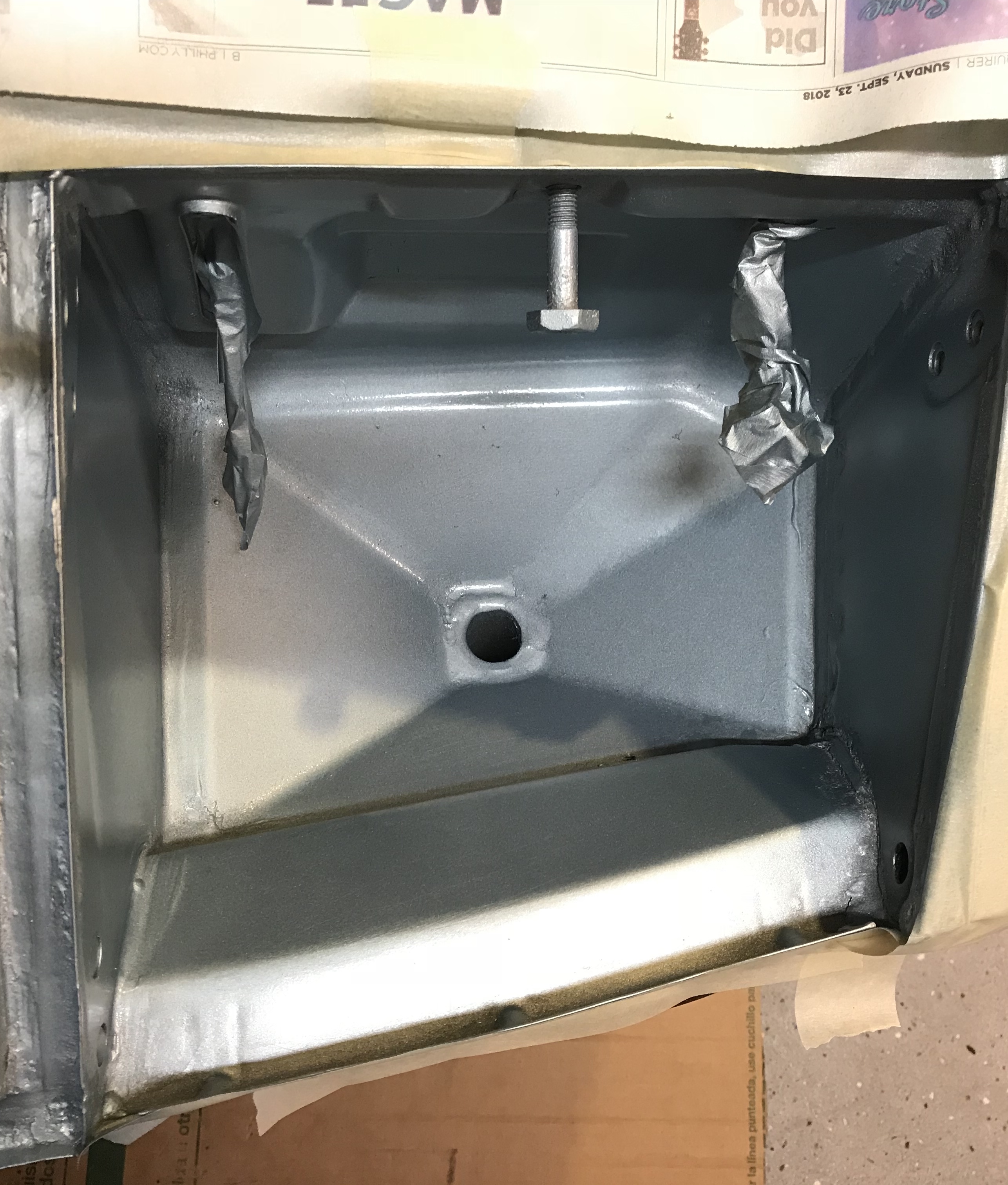

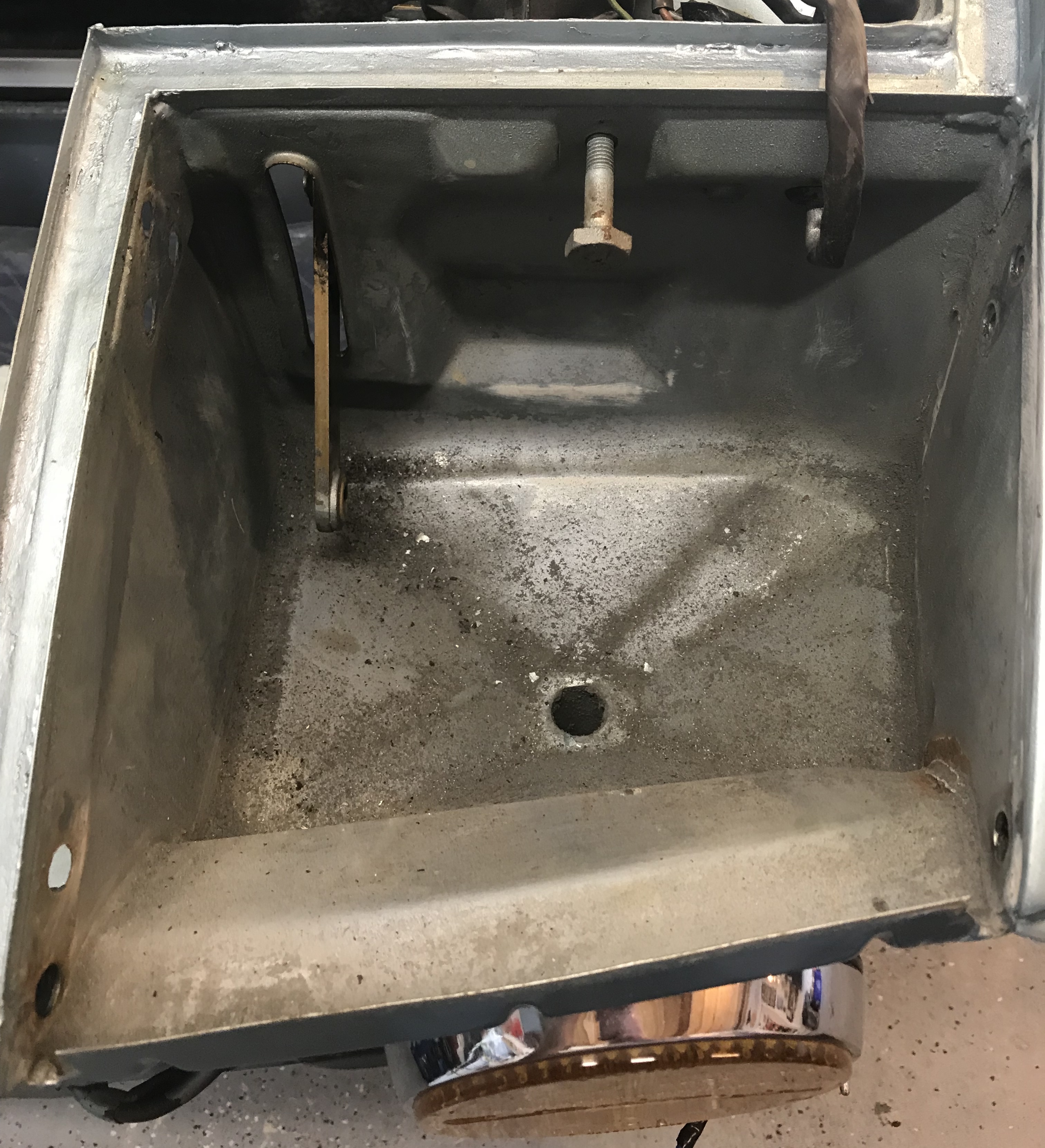

Sunday’s chore was the bucket area and the front portion of the rain channel around the hood. Also did a re-spray of the floor of the frunk. It was a bit scuffed up.
Dion
post Sep 23 2018, 07:45 PM
Post #348
RN
Posts: 2,931
Member No.: 2,766

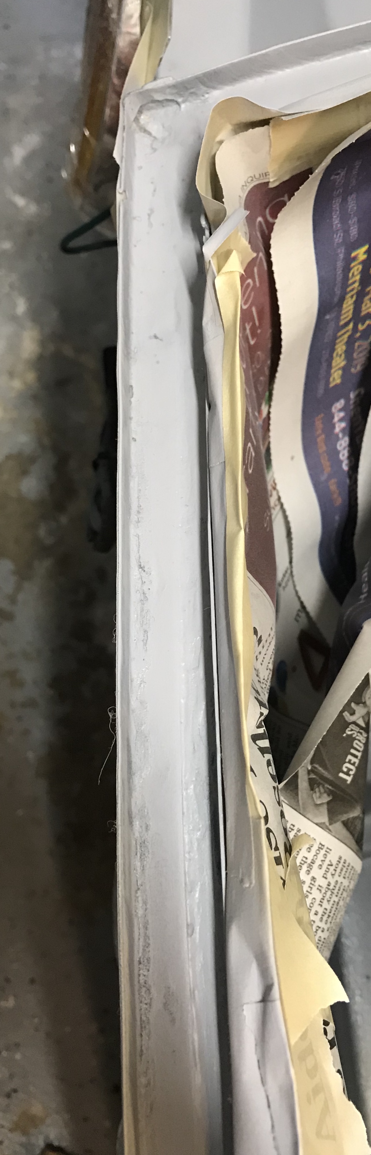

Primer & Paint on channel
Dion
post Sep 23 2018, 07:49 PM
Post #349
RN
Posts: 2,931
Member No.: 2,766
The buckets & frunk
Dion
post Sep 23 2018, 07:50 PM
Post #350
RN
Posts: 2,931
Member No.: 2,766

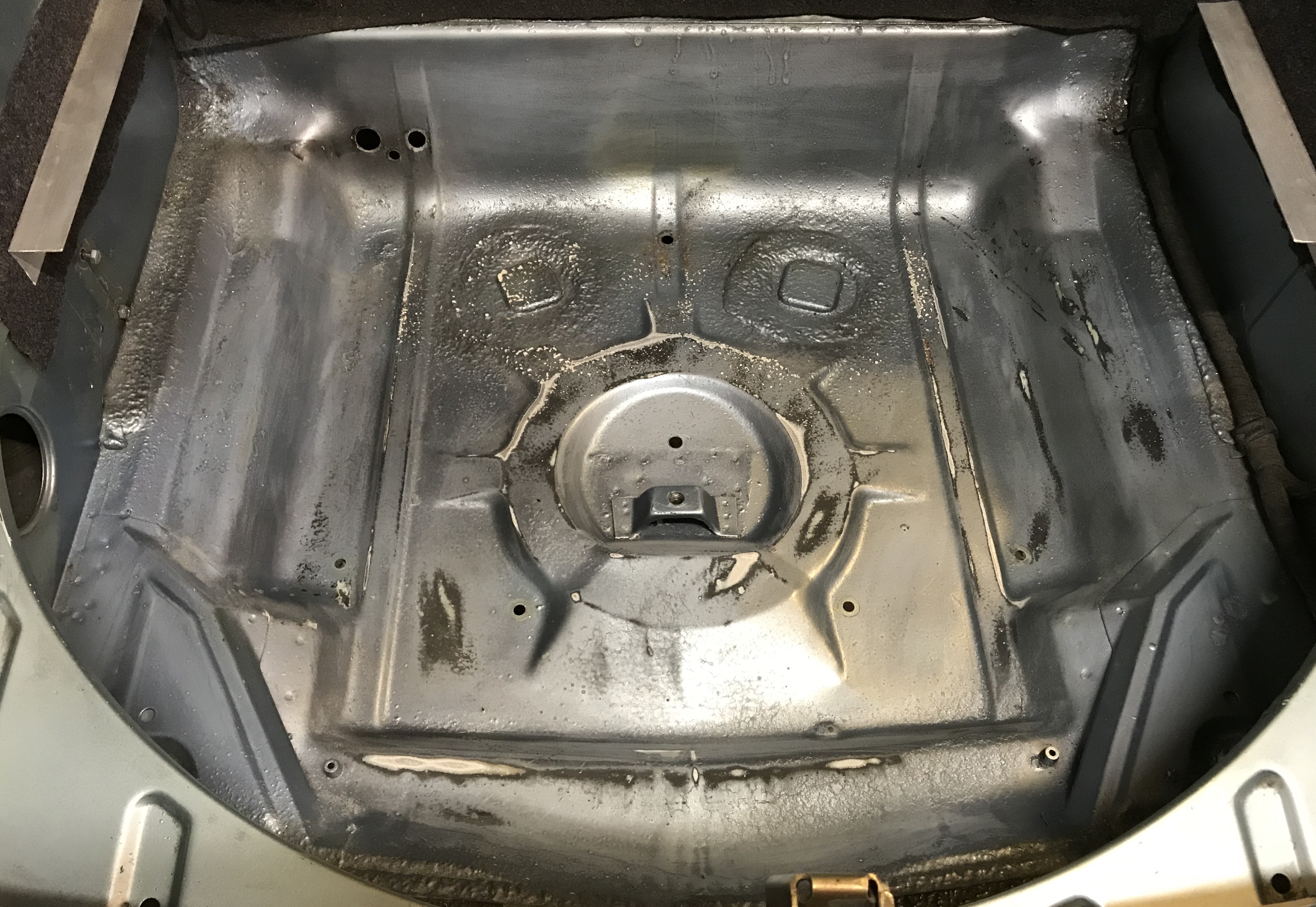

Frunk
Dion
post Sep 23 2018, 07:52 PM
Post #352
RN
Posts: 2,931
Member No.: 2,766
Fresh paint
Dion
post Sep 23 2018, 07:53 PM
Post #353
RN
Posts: 2,931
Member No.: 2,766
