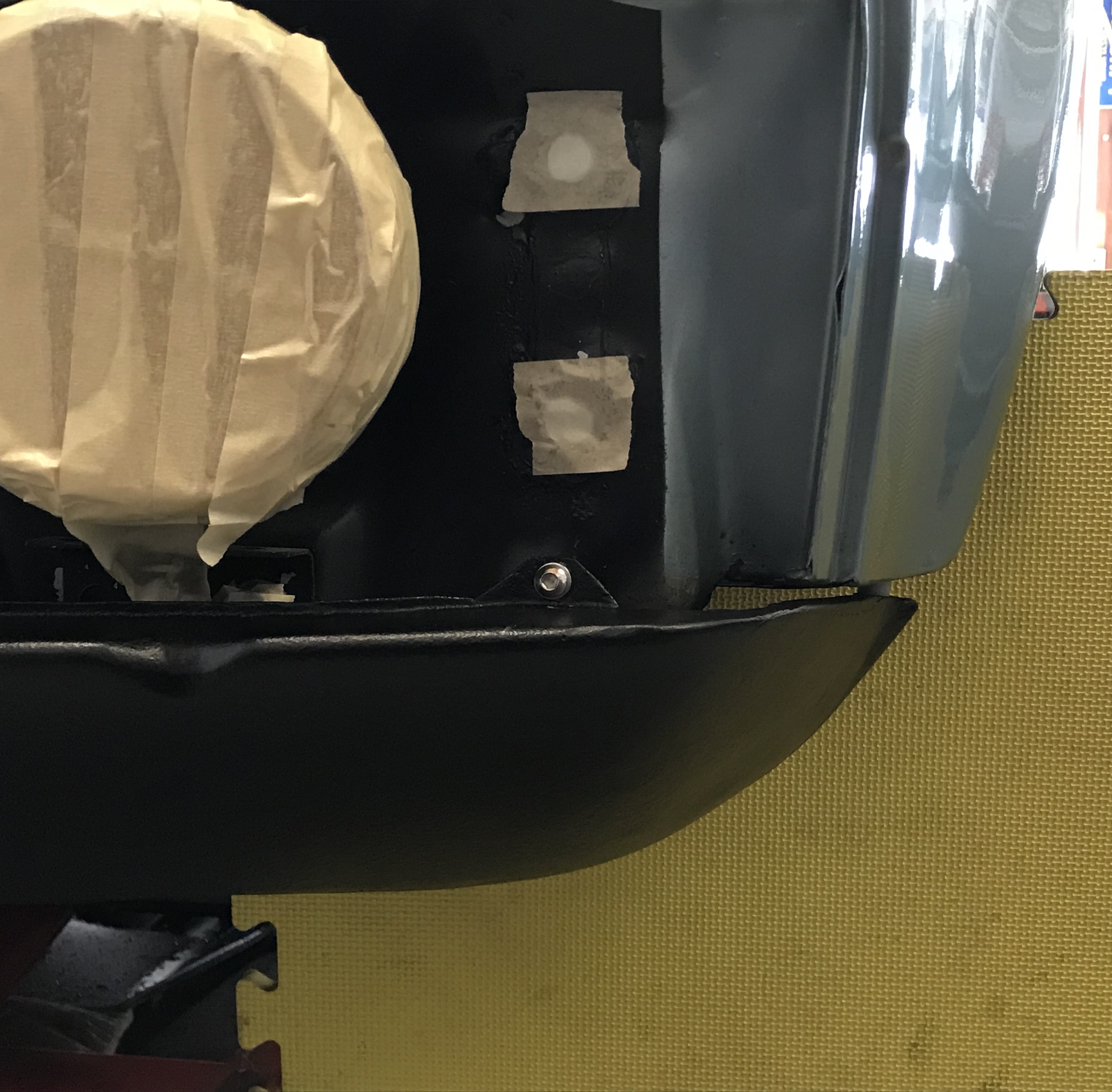

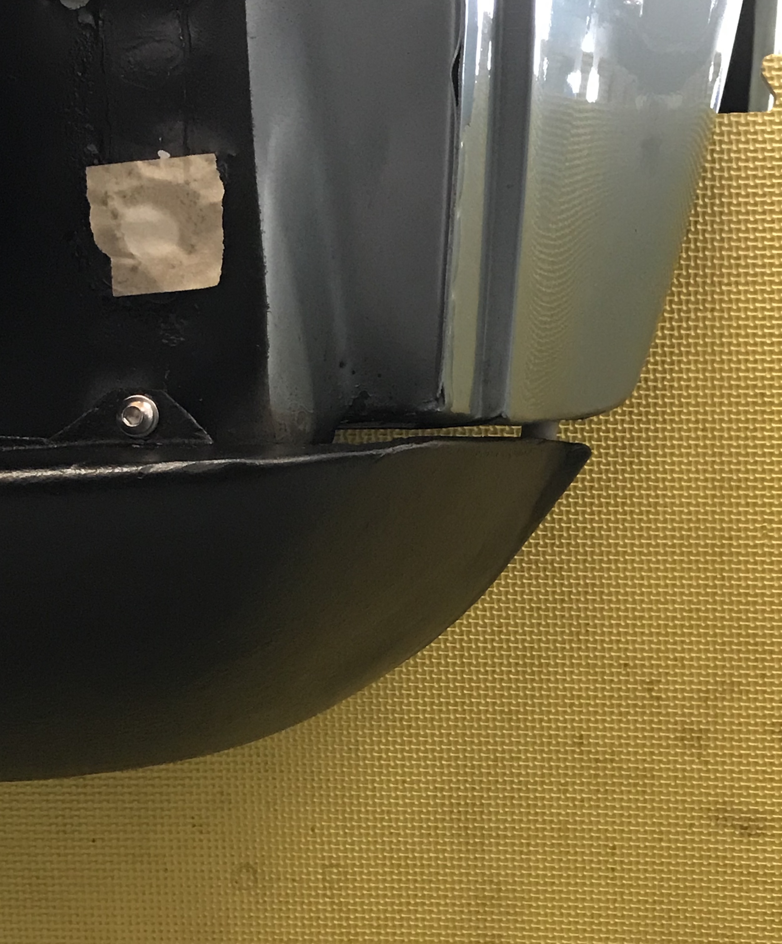

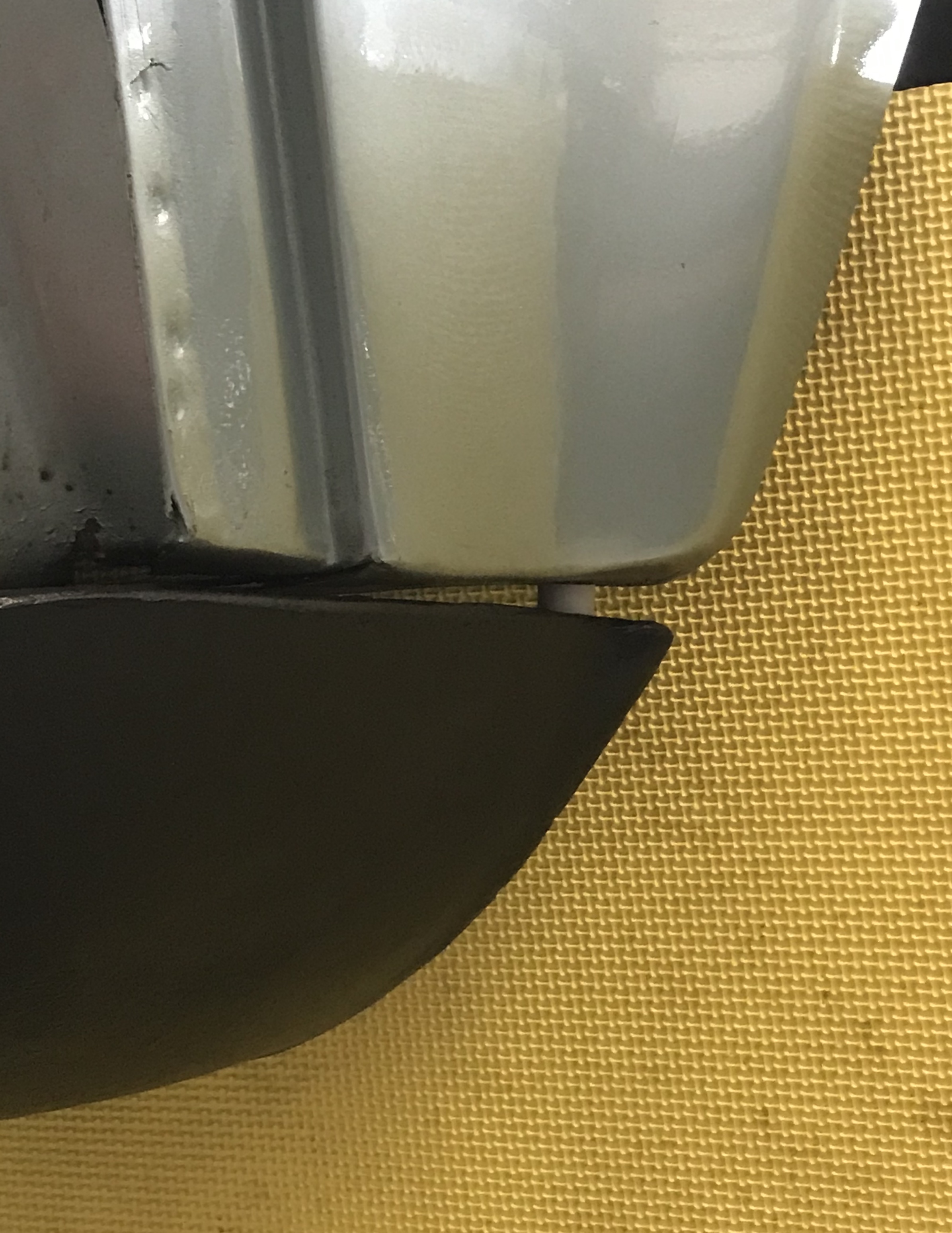

Did a test fit. I’m pretty happy with it.
The contour match is ok. I can live with it.

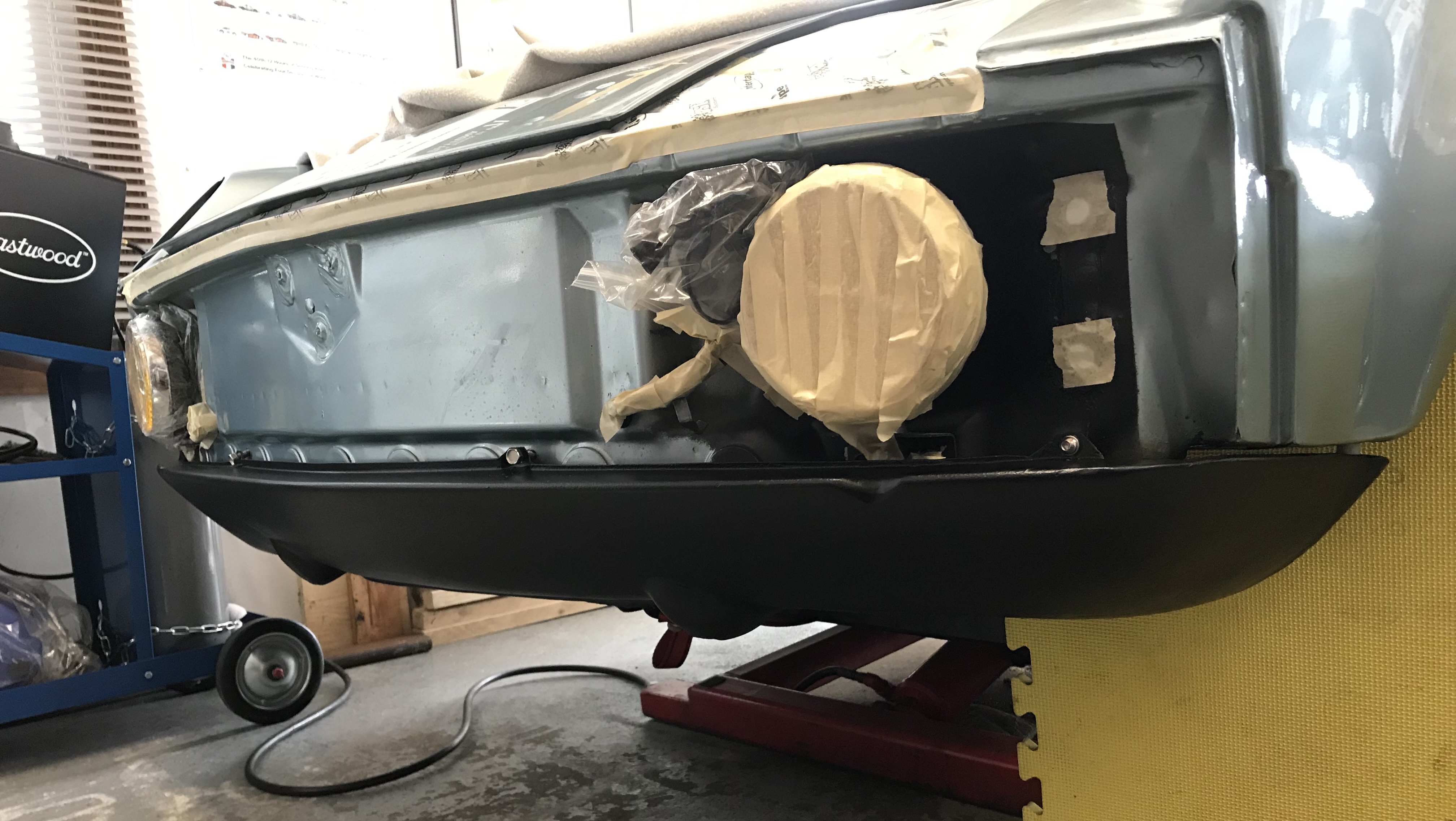

Long view.

My goodness that's a lot of snow (IMG:style_emoticons/default/poke.gif)
That valance looks nice. How do you like the stone chip paint? I was thinking of using that myself on valances and rocker covers. Looking sharp (IMG:style_emoticons/default/thumb3d.gif)

@bbrock Ha, our snow prolly looks like a lite frost to you! Hey Brent,
I like the SEM stuff. Especially the satin trim black.
The “stone chip” is nice. It all depends on distance your spraying with
the rattle can. Farther=small beads, close=blobs. If your using a “gun” I’m sure you’ll have better control.
The only thing is I’m not a total fan of is the sheen. It looks ... well...
rubbery. Being it’s gonna get pelted with debris, fine. Even though it’s
Satin finish it’s more gloss than I’d like.
I’m gonna try and topcoat with normal black satin.
Maybe temps affected it.
It was only 54F out today. I’ll try again when warmer.
I prefer the rockers just smooth satin.
Looking good out there! Keep at it.
Cheers. Dion
bbrock
post Mar 11 2019, 07:32 PM
Post #465
Posts: 5,269
Joined: 17-February 17
From: Montana
Member No.: 20,845
QUOTE(Dion @ Mar 11 2019, 02:54 PM) *
Cheers. Dion
Good info, thanks! I was hoping it was more like the stuff on the rockers of my newer cars that shows a little extra orange peel, but has the same gloss/sheen as the body paint. I can live with some orange peel on the rockers in exchange for fewer chips, but yeah, it needs to be satin.

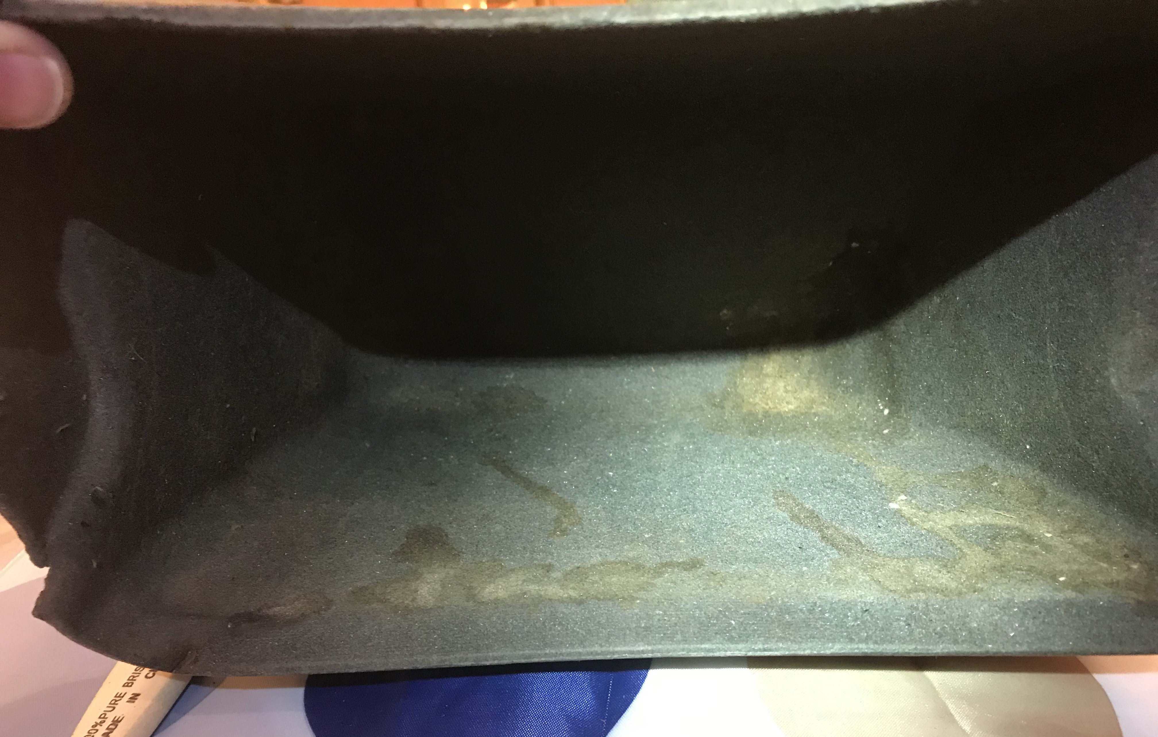

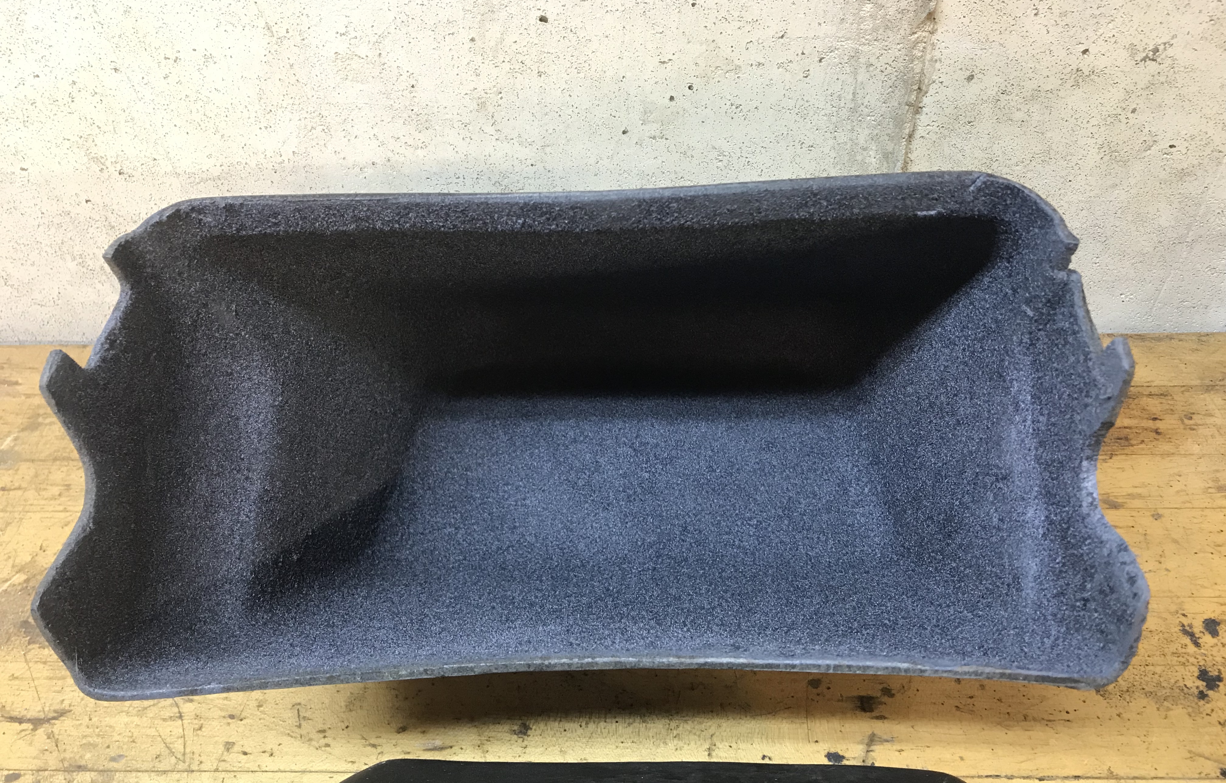

Following the master of all things detailed... @bbrock ,
(He keeps raising the bar doesn’t he?!)
I rejuvenated the glove box.
It was in a sad state. The mice had enjoyed a stay in it.

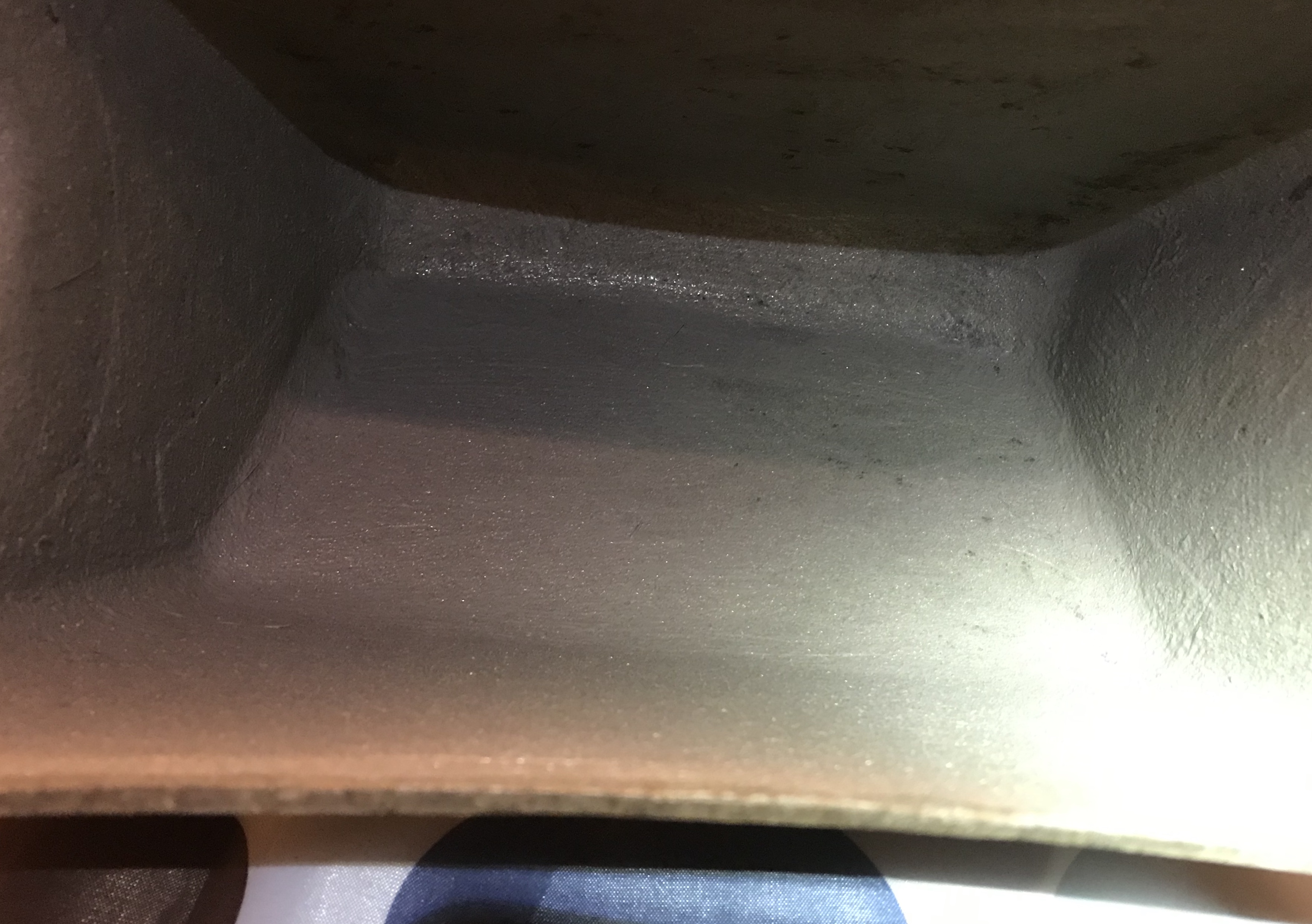

First the acrylic grey paint..

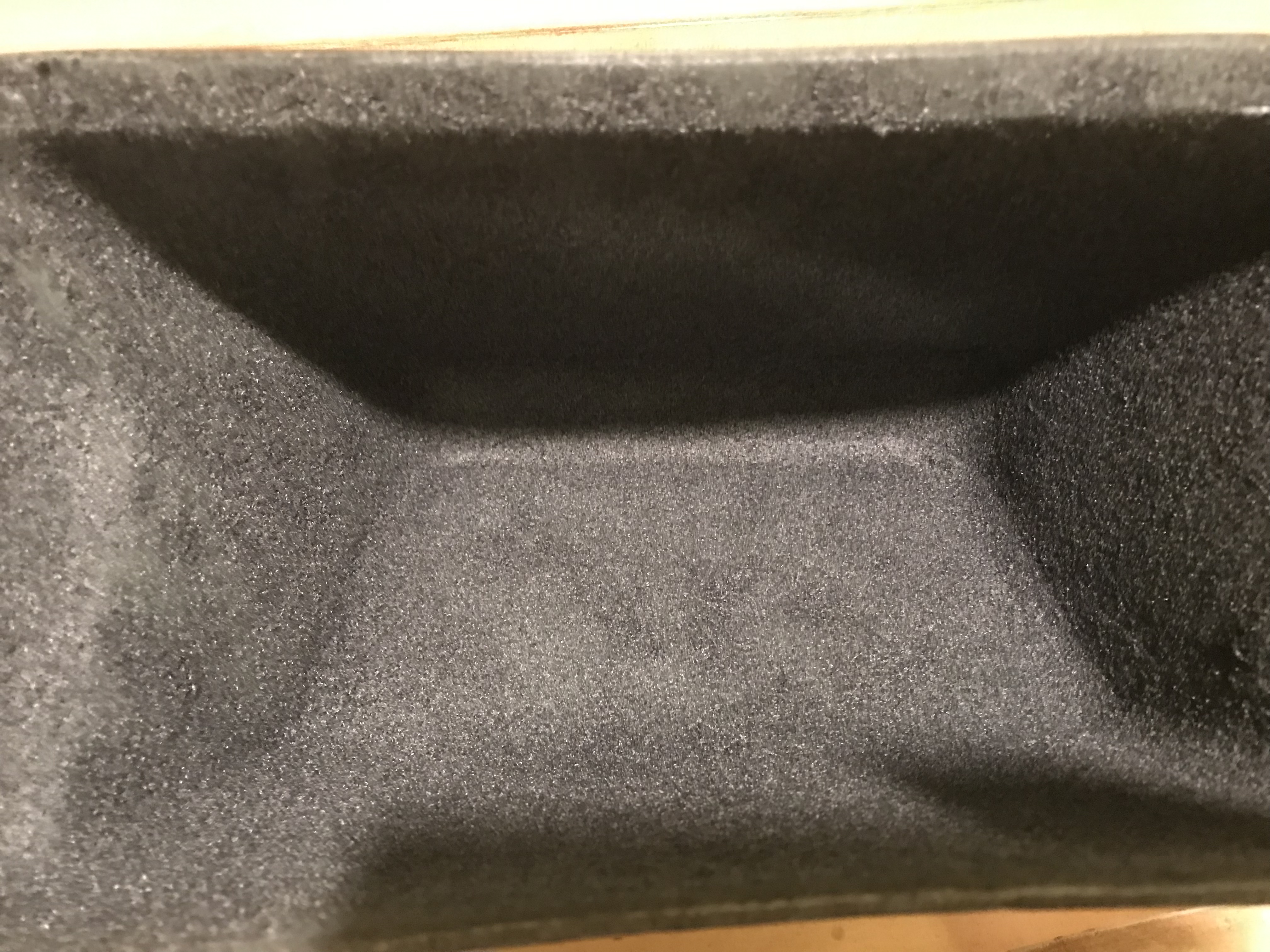

Then the gray (grey?) flocking ...

fin....
bbrock
post Mar 16 2019, 07:33 PM
Post #473
Posts: 5,269
From: Montana
Member No.: 20,845
That looks fantastic (IMG:style_emoticons/default/cheer.gif) Sure beats the mouse pee stains, but you can't blame me for this one. This is all on @raynekat . I didn't know a flocking thing about flocking until Doug steered me right.

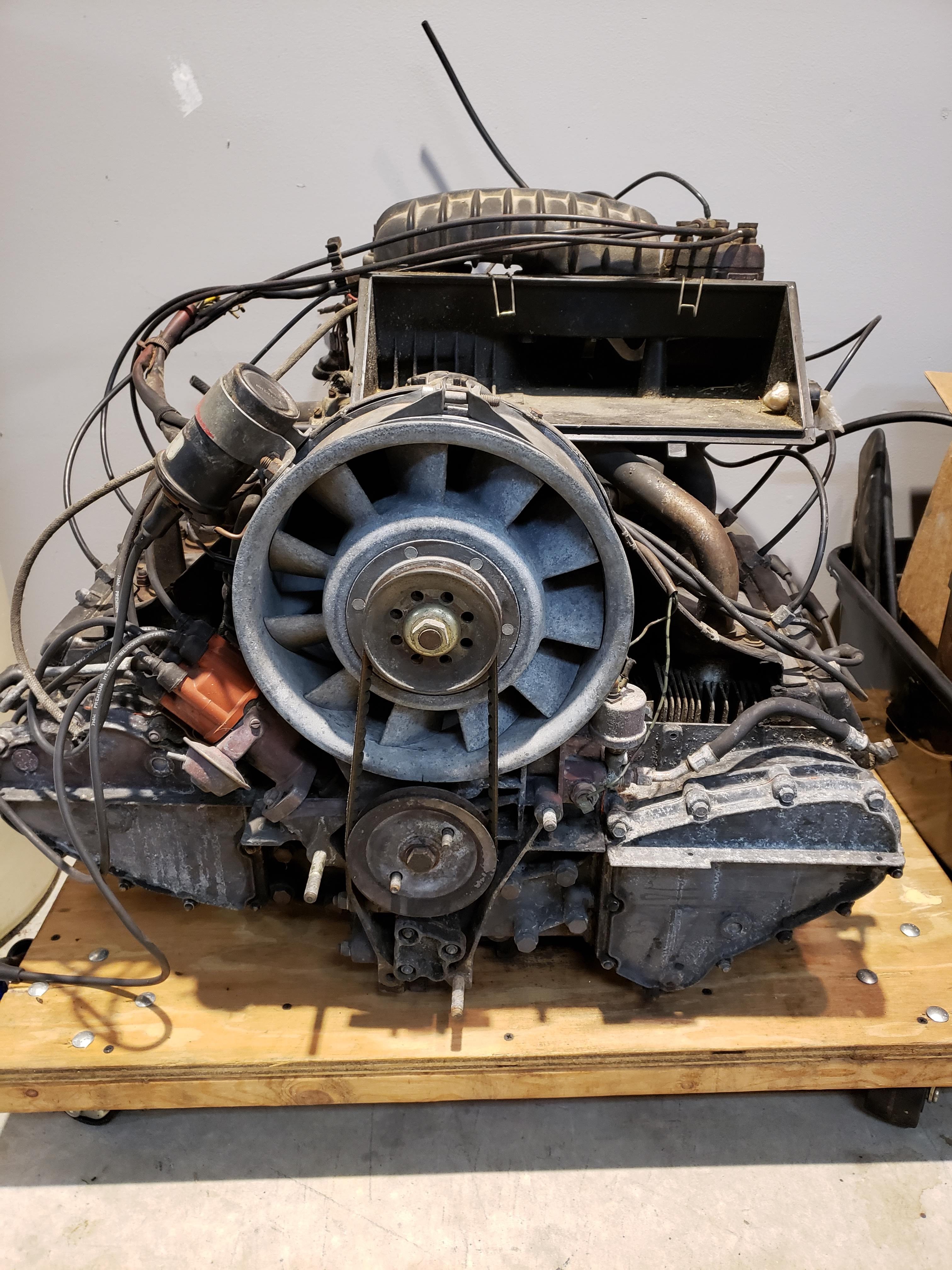

Let's see that 2.4??
Any mods, carbs, cis?
I've got one too (IMG:style_emoticons/default/aktion035.gif)

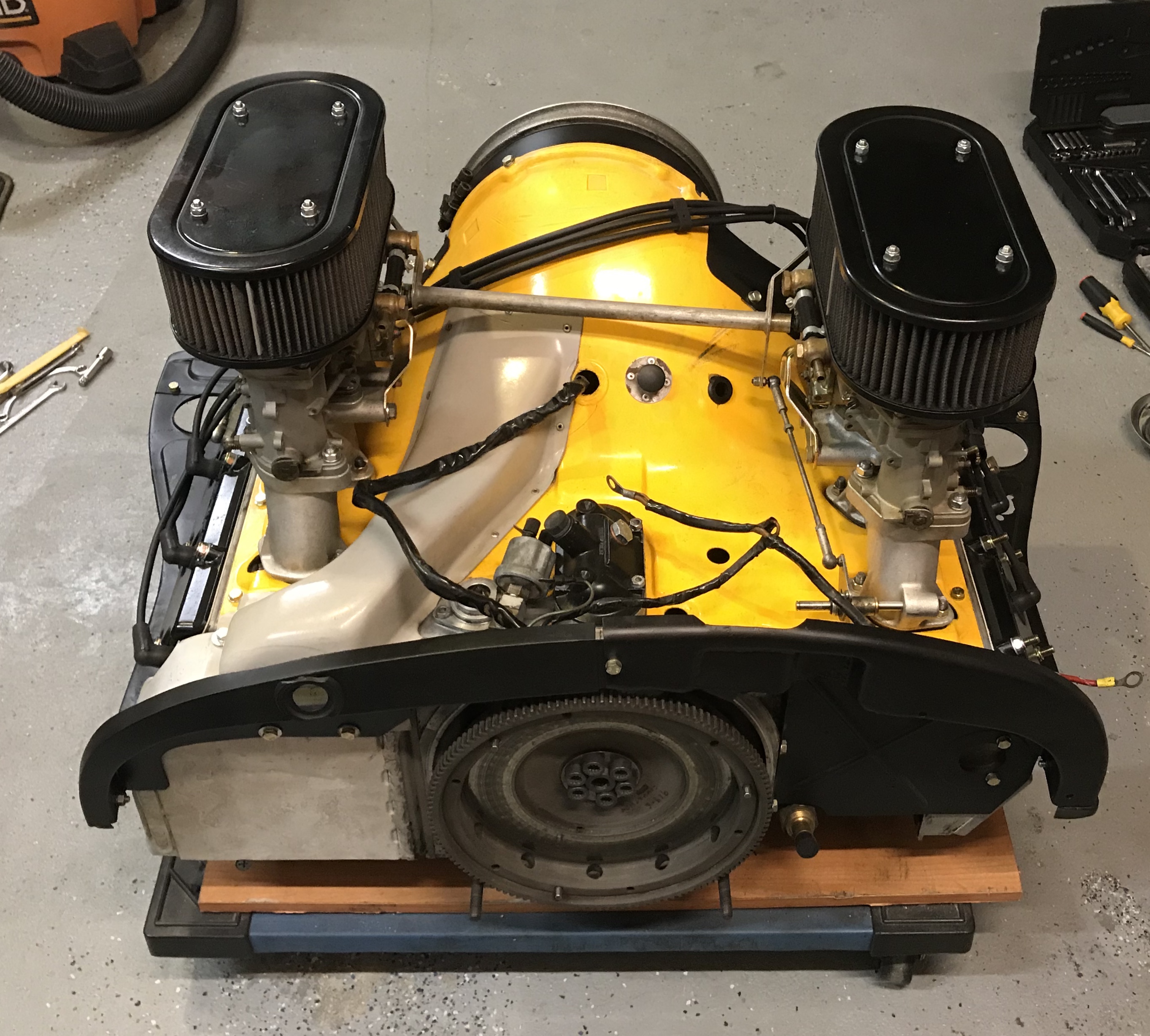

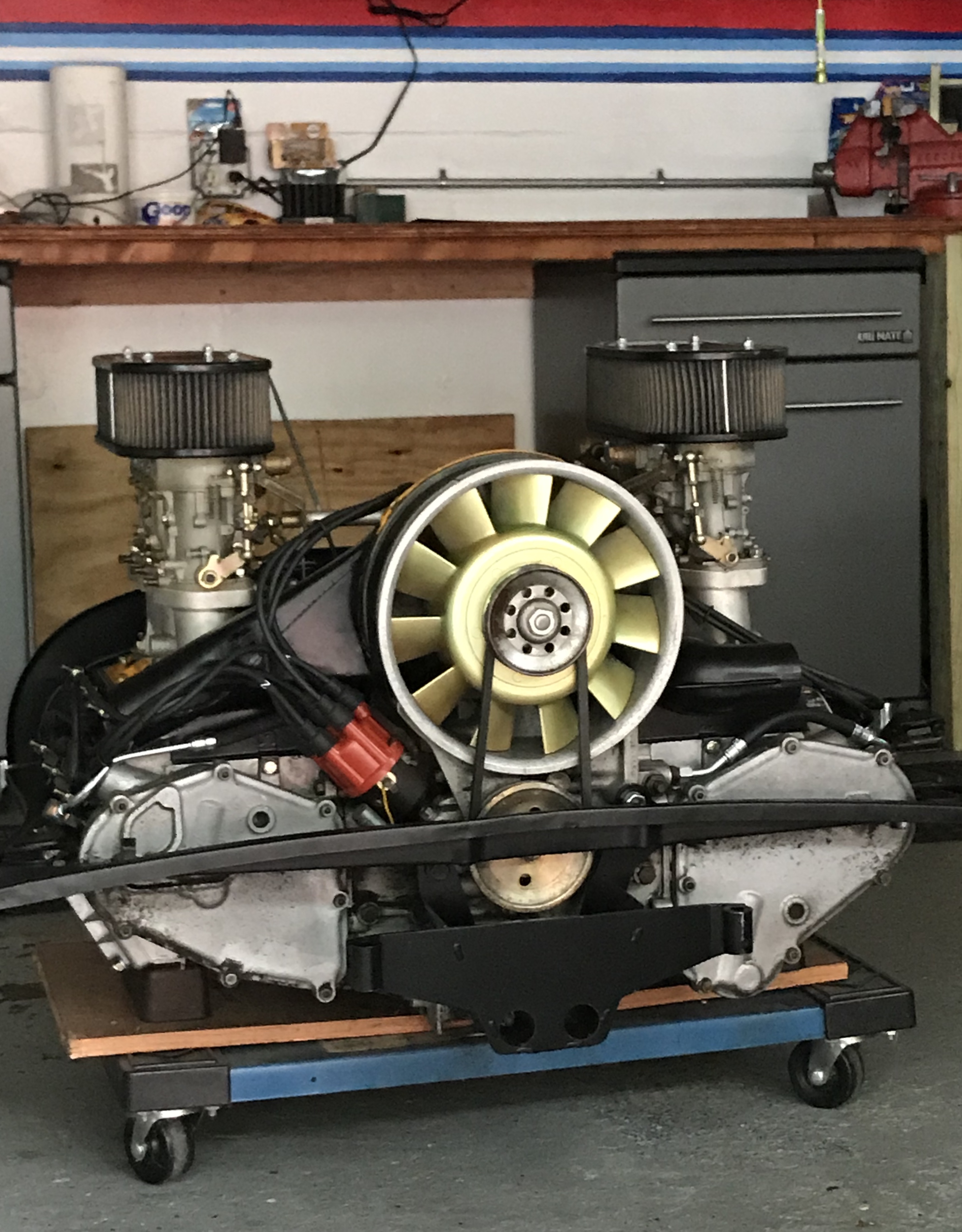

@RolinkHaus it’s a 2.4 on a ‘67 case. Originally with MFI before my purchase. Now on
Webers. The counterweighted crank and rods came from a 2.7 Liter 911 engine .
Standard of course . Rods were sent to Ray Litz to be checked and balanced .
No other mods. Your motor looks sweet.

It will be a long time before it looks anything like yours;)
What's your HP?

Well it’s all to factory spec. Rebuilt around 20K miles ago.
Supposedly good for 140 per the books. We know Porsche is conservative with their stated numbers. I’d love to dyno it when the car is
complete. I’m sure it will be pleasing no matter what:-)
