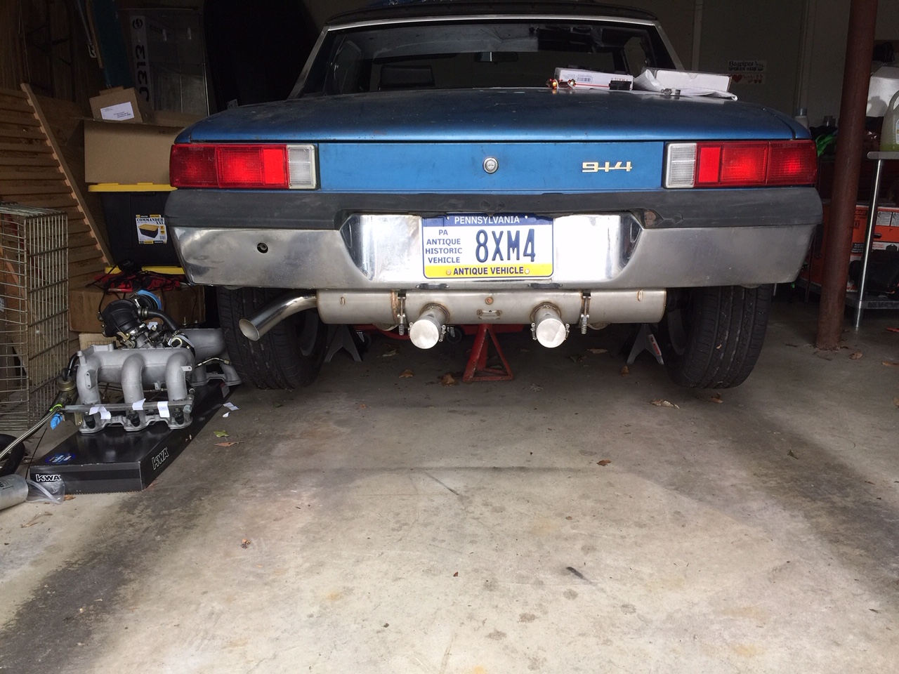

@dion yes but one step further were the center tail pipes remove and then cap. That way you don't bang your shins on them

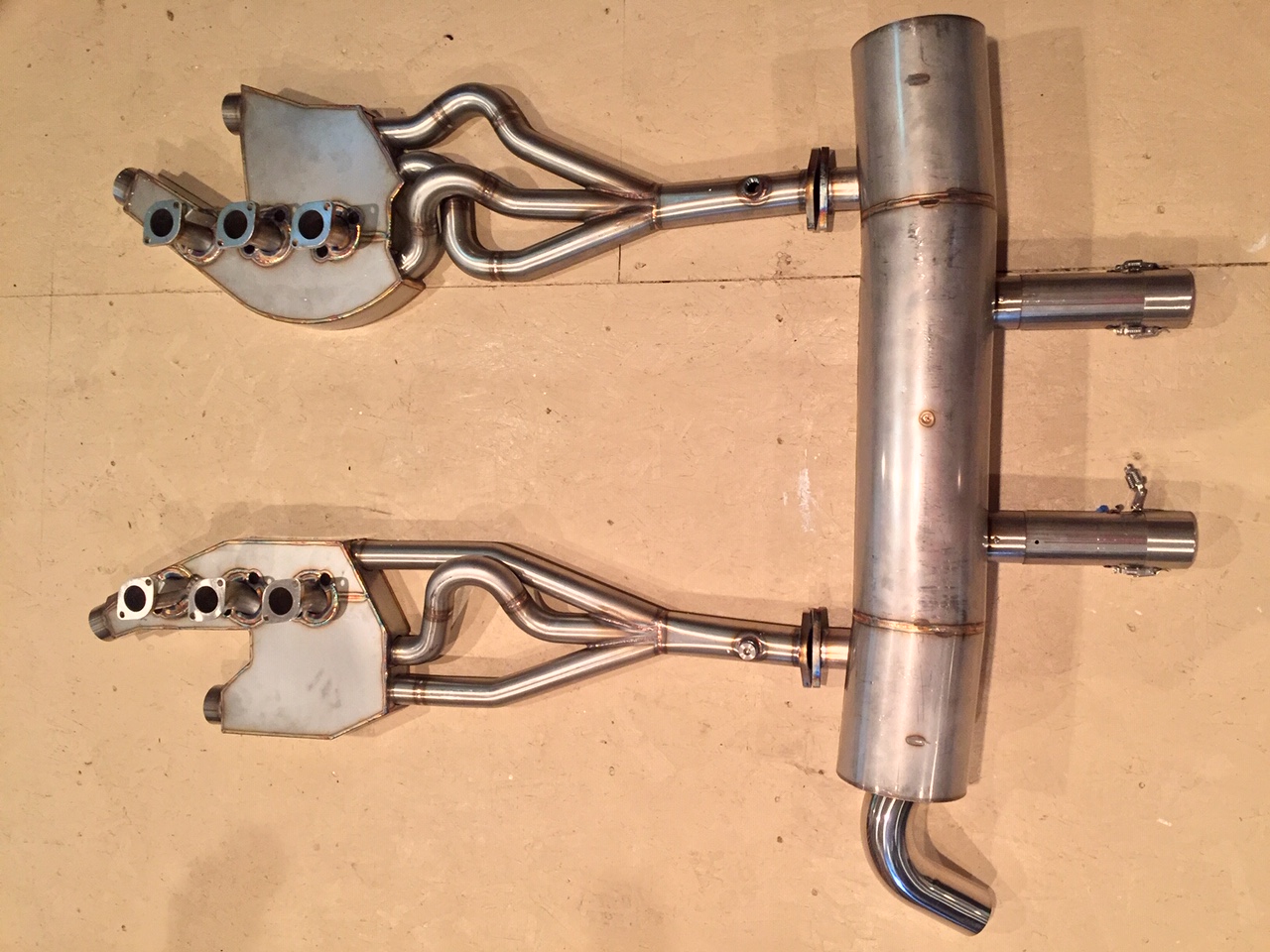

Dion - here’s what Ben made for me.

The drone of a 3.2 with a sport muffler is numbing. 2000/2800 rpms. I’m considering a single outlet or convertible muffler like yours Mark.

It's built on Ben's quiet muffler so it can be truly duel purpose. The ss latches to hold on the caps were my idea but Ben did all the work. If the latches go bad, the extensions are removable and replaceable - Ben's idea.
If I ran a rear valance, I could cut the third pipe short and cap the center two to make people wonder what's going on.

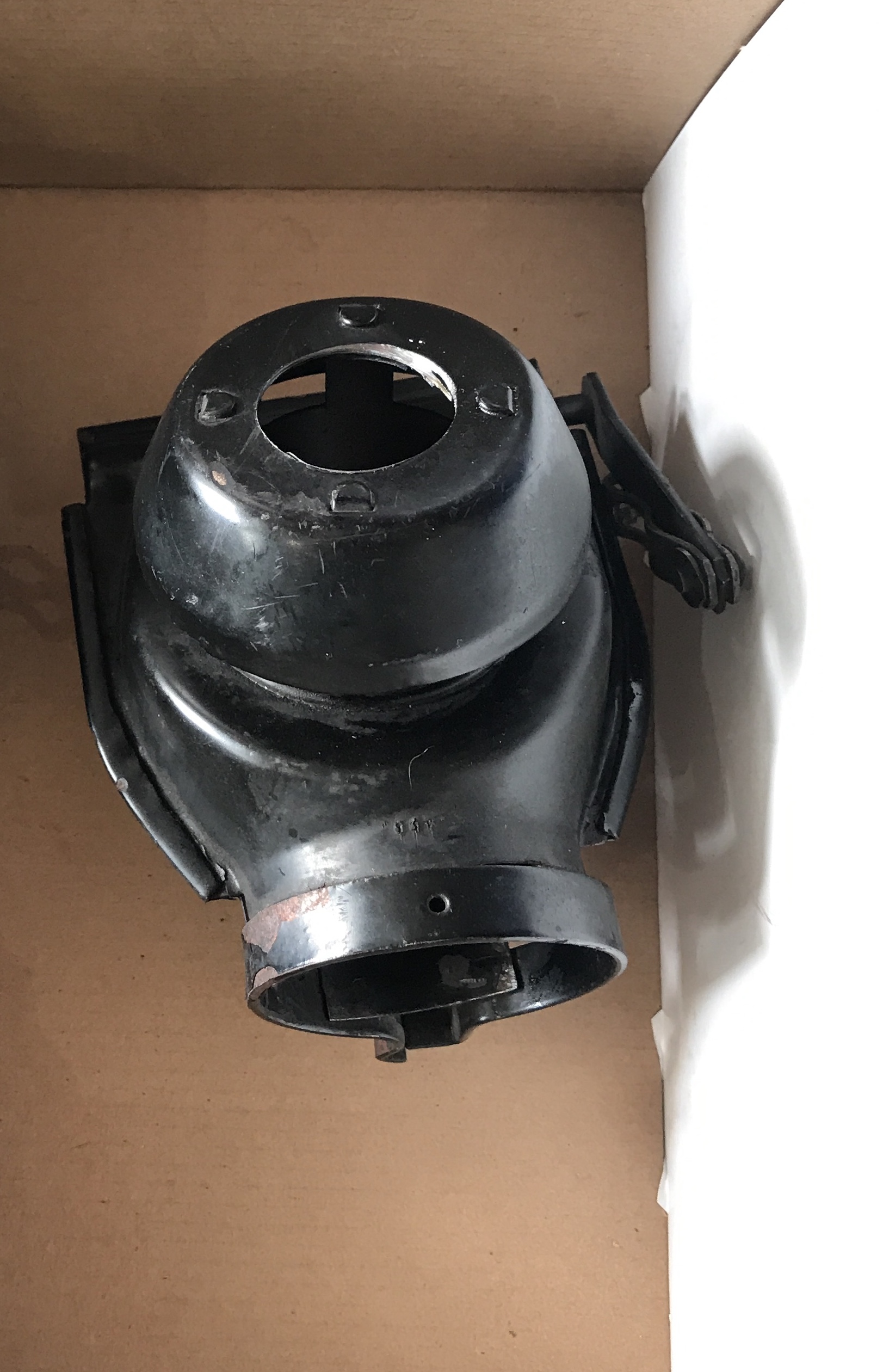

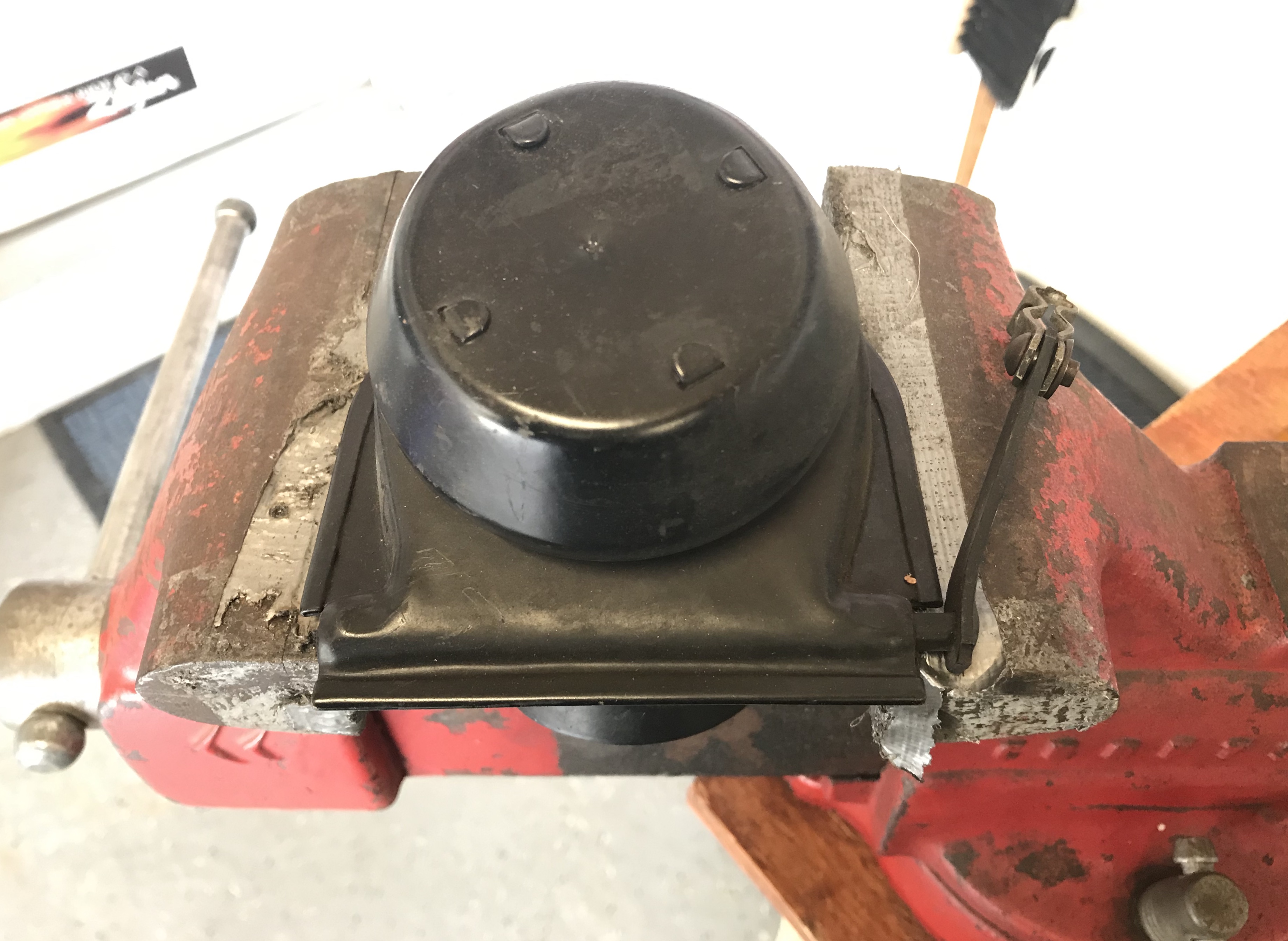

Staying as close to “six” form as possible, I tried to emulate the
heat flapper valves on the sixes. Took a page out of @mepstein technique.
I’ve never seen one for sale for quite a while, so a bit of diy.
Basically a hole saw cut in the mushroom cap.
I’m a bit pissed as the craftsman arbor refused to stay clamped
tightly and we had a wobble on the one cap. (IMG:style_emoticons/default/headbang.gif) So we don’t want to look at that one too closely. (IMG:style_emoticons/default/barf.gif)

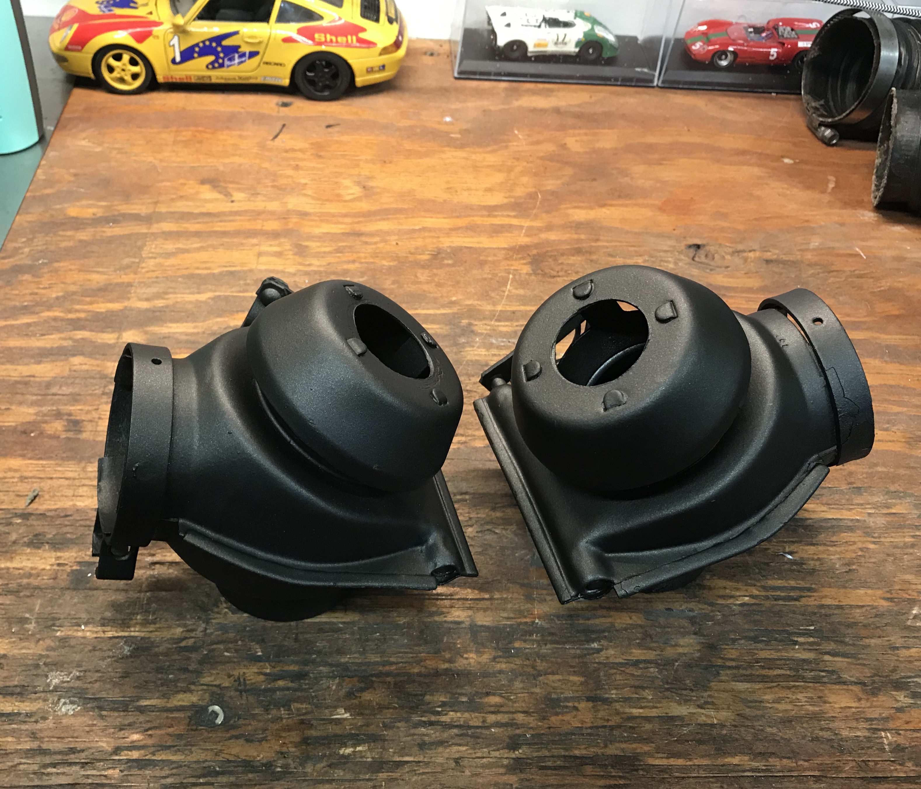

Ran to Lowe’s and picked up a new Lenox arbor and 32mm hole saw.
A lick of paint later. We are ready for heat.
