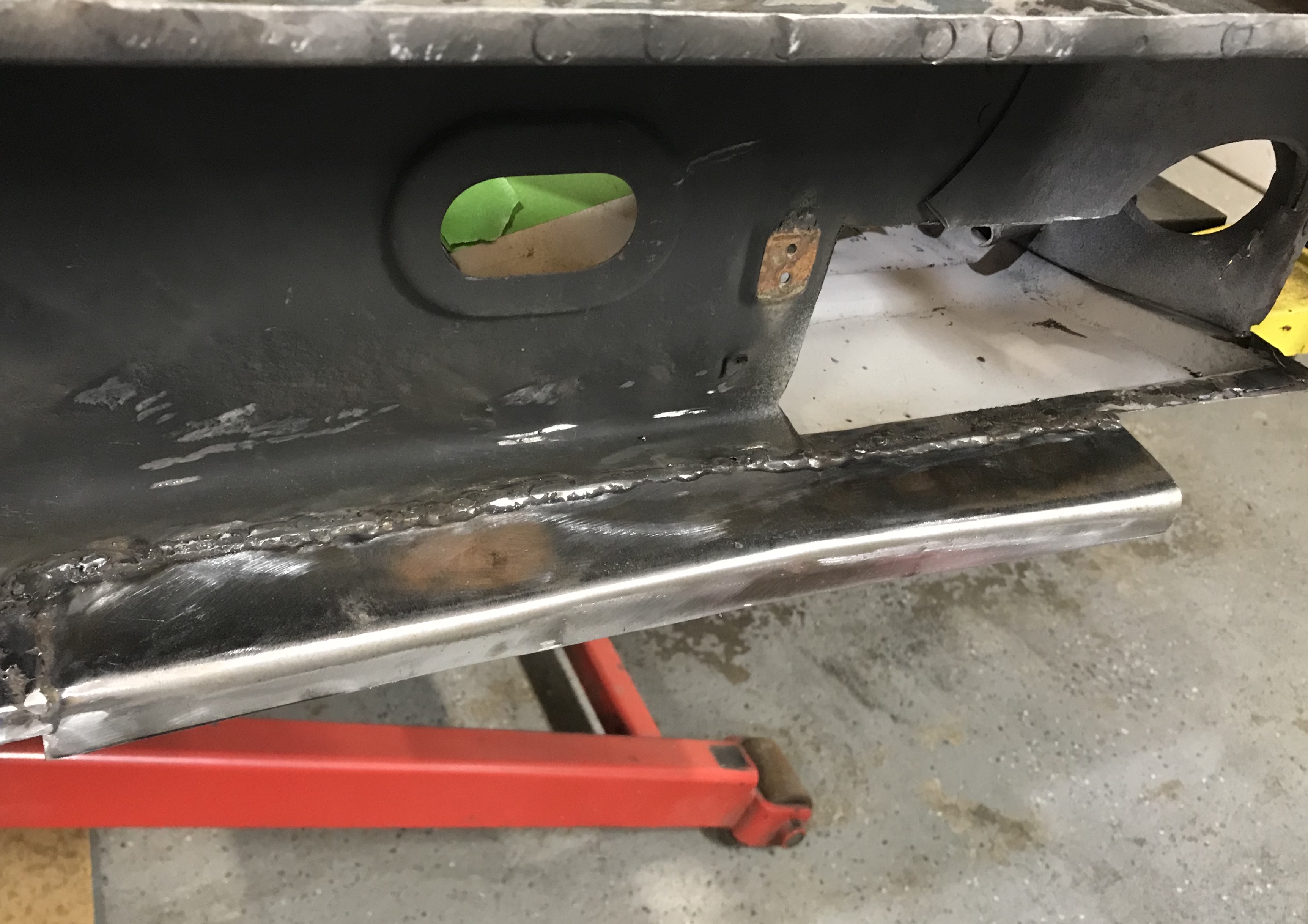

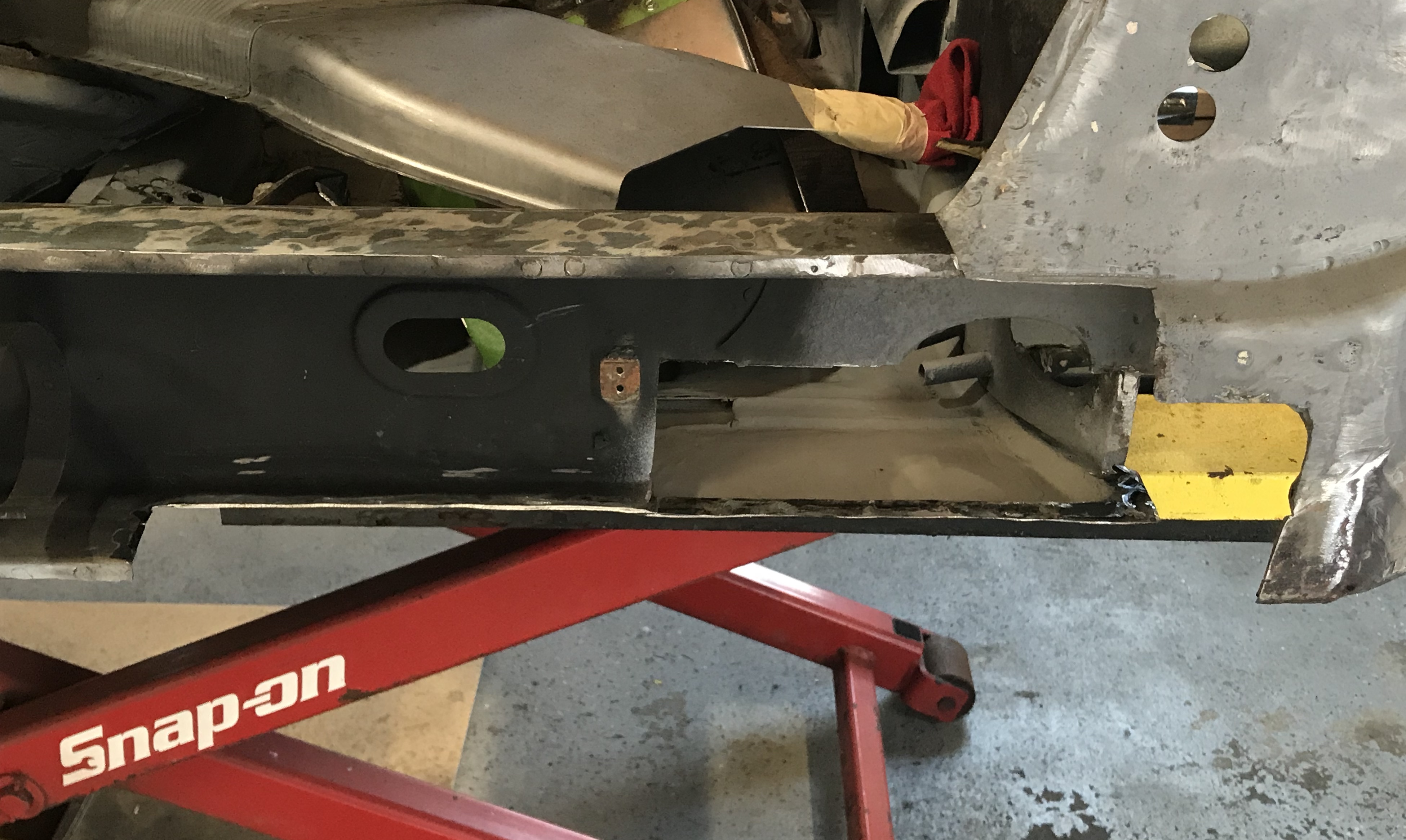

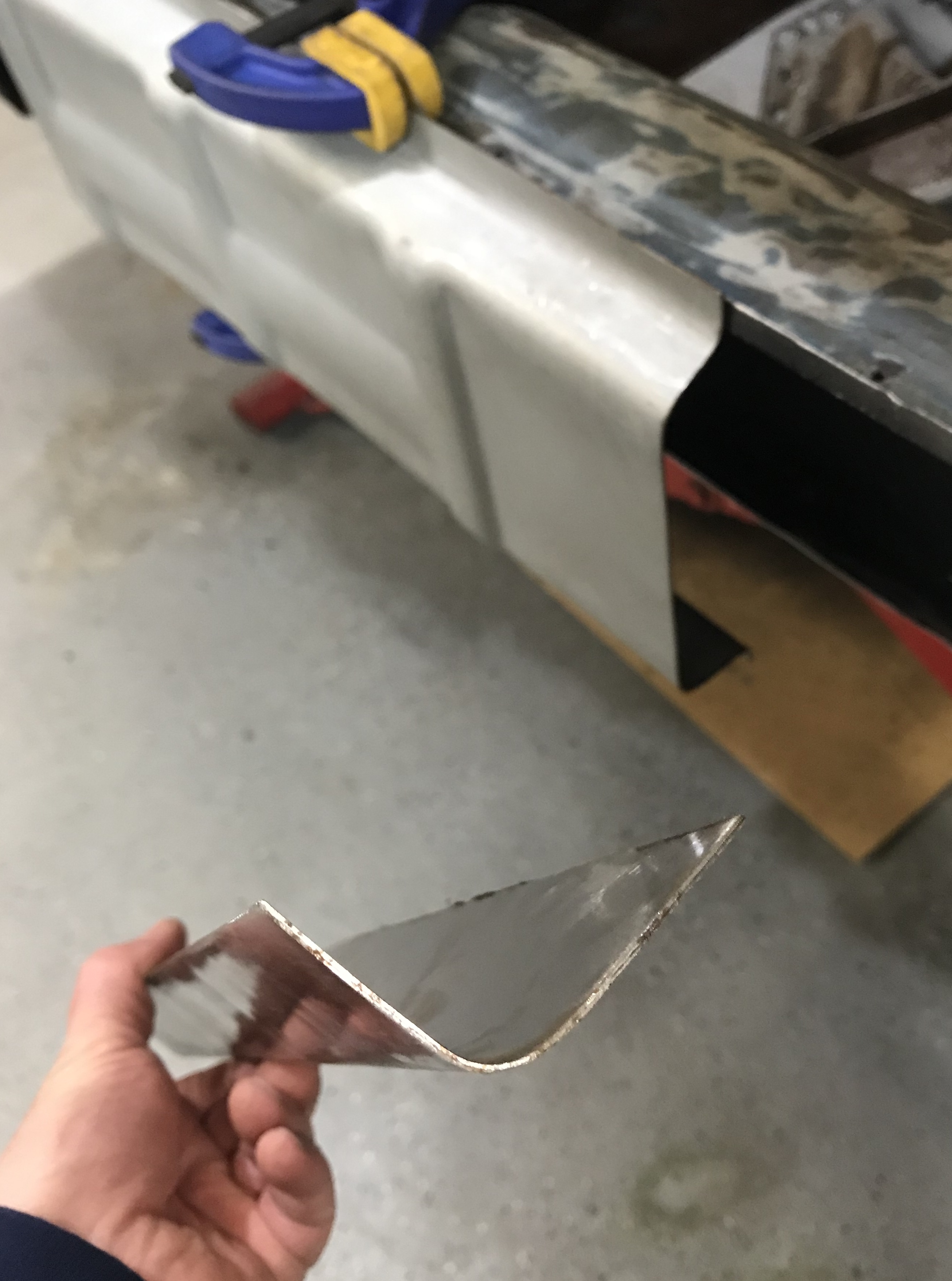

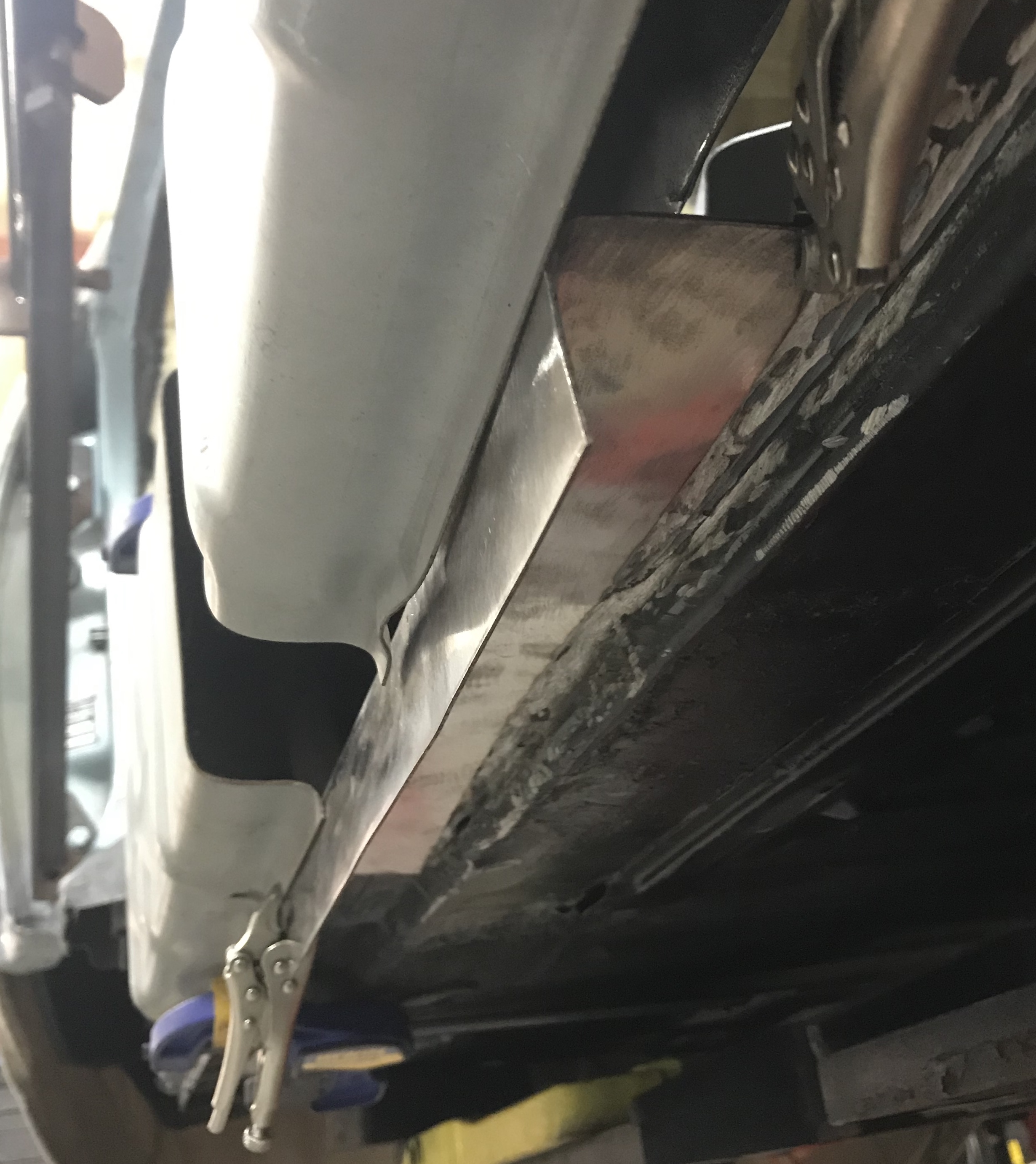

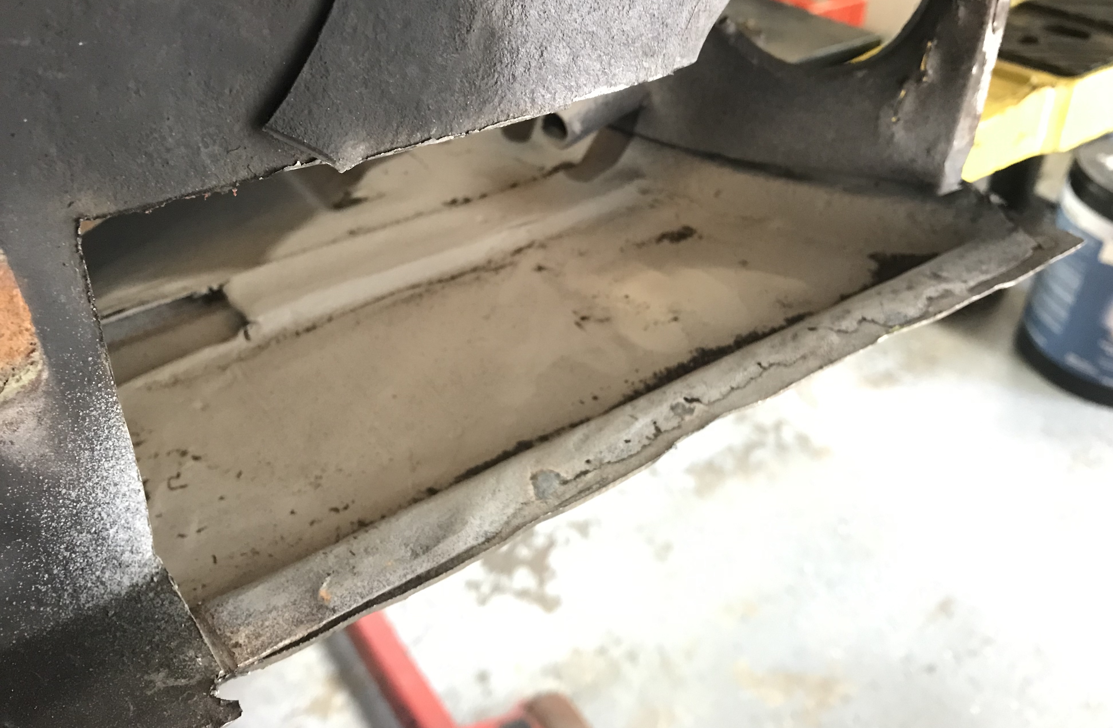

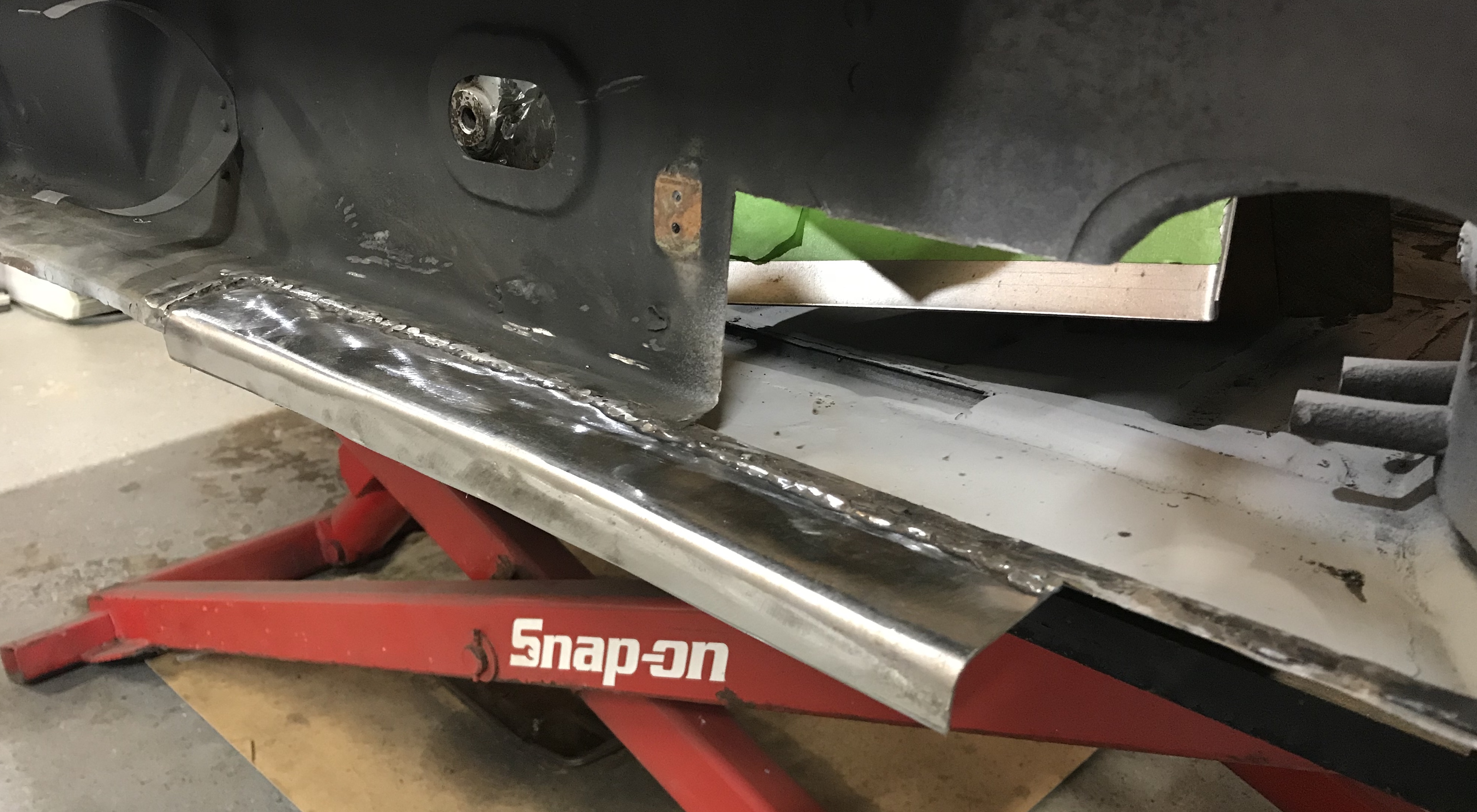

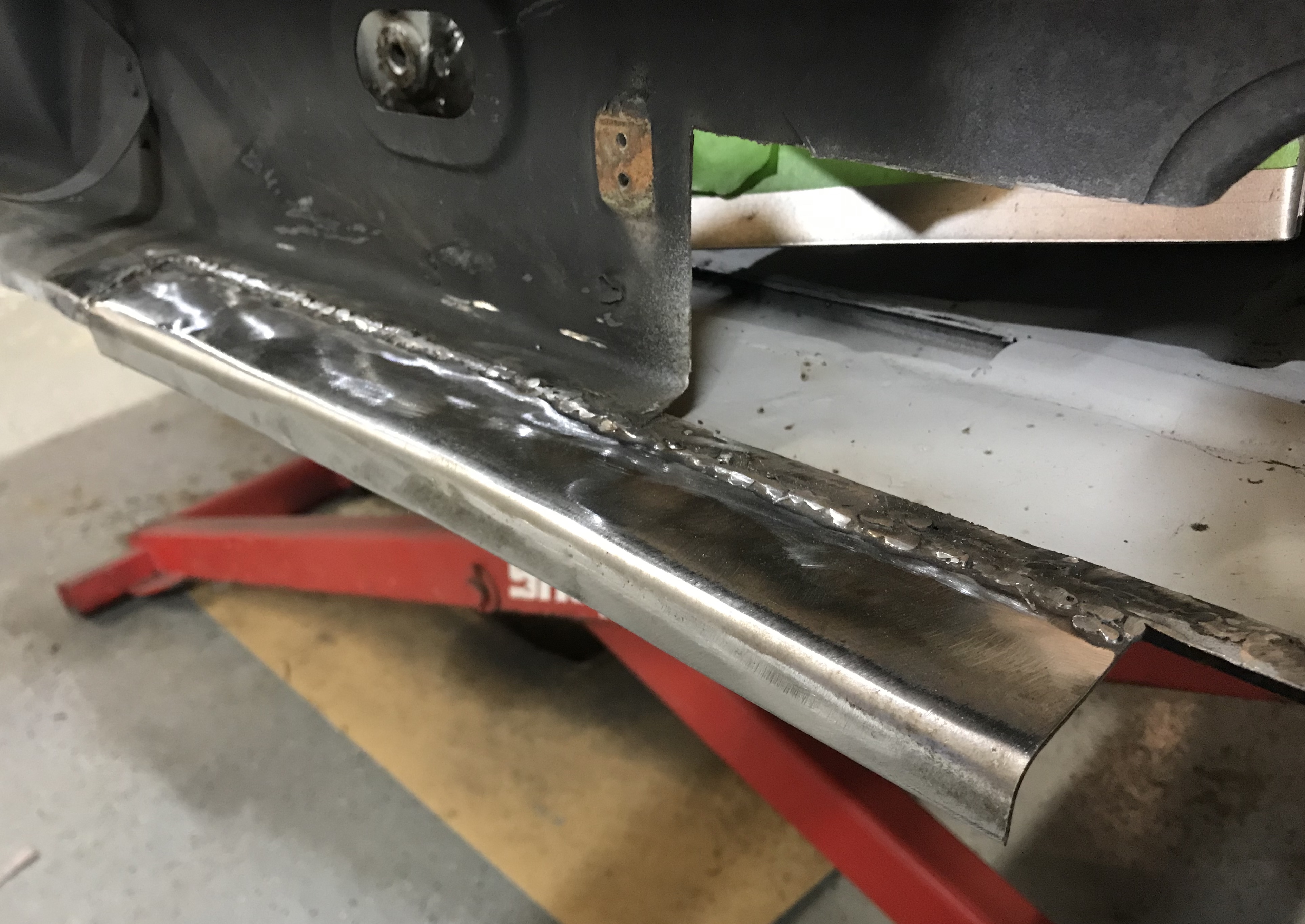

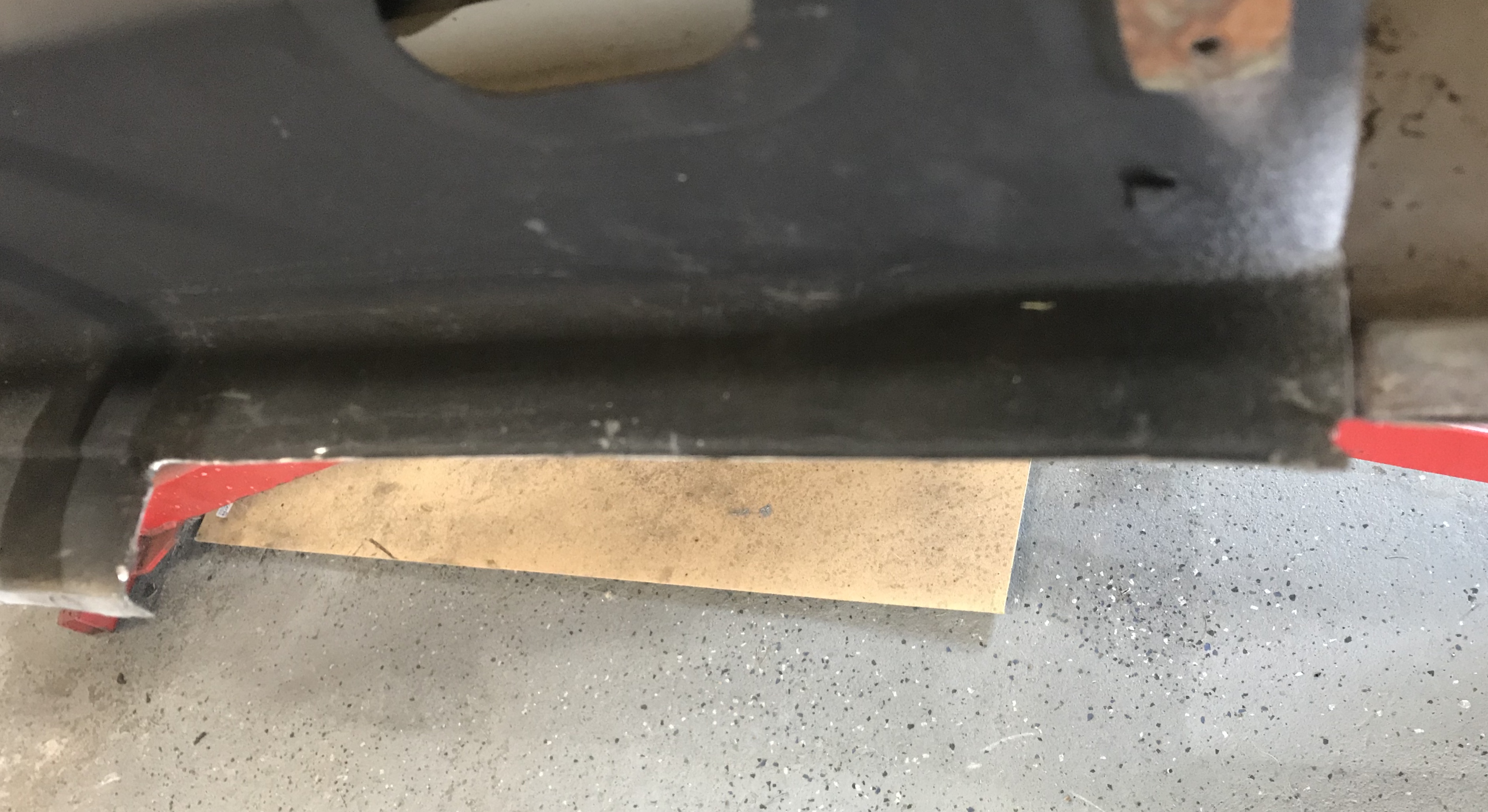

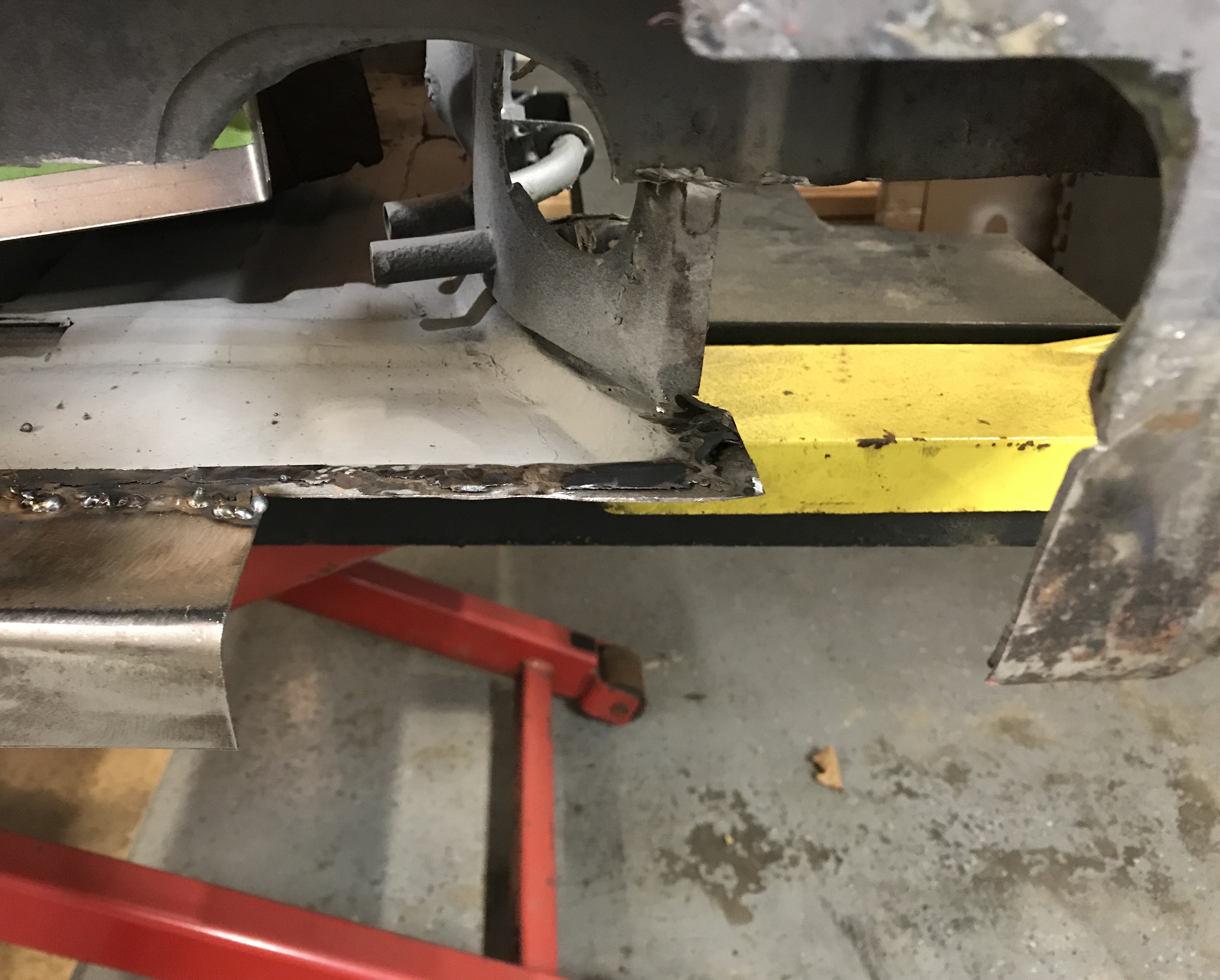

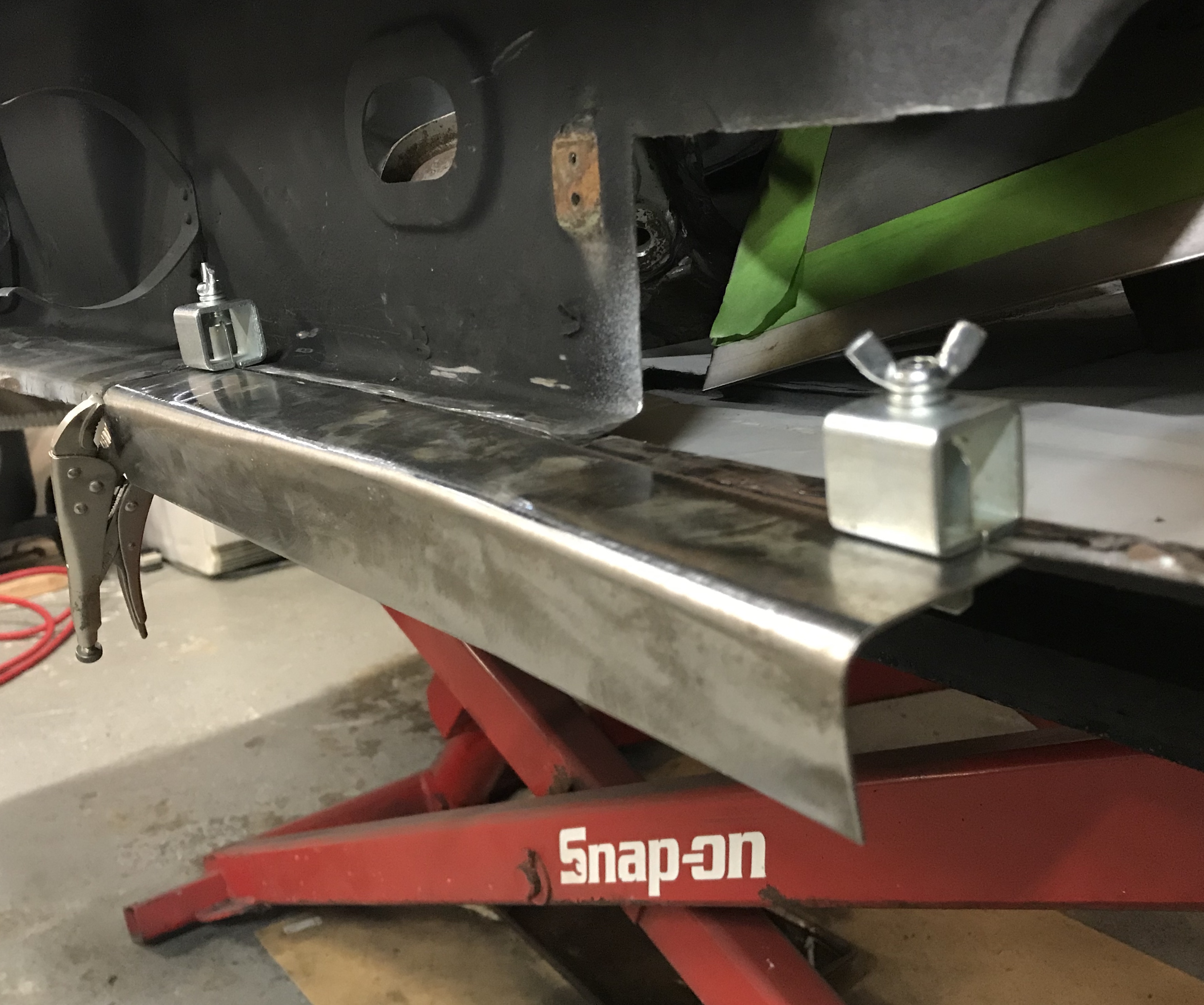

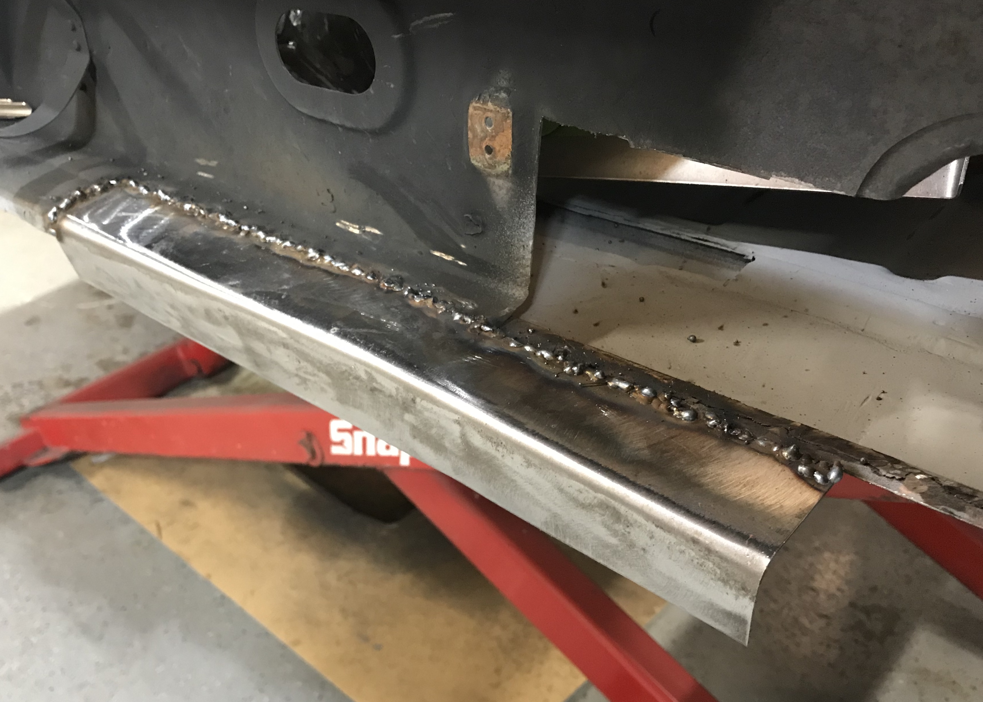

Small update to chassis repair. A strip of steel added to the area where the floor meets
the outer Lt. long. It took some coaxing to put that bend in! Was surprised in all honesty! It does not run the whole length because Dave said to hold off because we will need to tie in a couple other pieces. The piece on the buck is not done yet, so
just a small patch for now. I used a piece of an outer long to line up where the outer edge should lie. Levels & straight edge where very important here. I’ll trim off the
excess later.
Wanted to make sure there was plenty of real estate to weld the out halves to.
Dion

(IMG:style_emoticons/default/welder.gif) (IMG:style_emoticons/default/smilie_pokal.gif)
bbrock
post Apr 2 2019, 07:39 AM
Post #517
Posts: 5,269
Joined: 17-February 17
From: Montana
Member No.: 20,845
Nice work! (IMG:style_emoticons/default/welder.gif) It's causing flashbacks though (IMG:style_emoticons/default/evilgrin.gif) I did the same thing leaving the weld flanges wide and I think it is a good idea. It is easy to trim those back to flush with the outer clam shell flanges for perfect alignment.

One day there prolly will be a diagnosis of 914 PTSD. (IMG:style_emoticons/default/blink.gif)
Thanks for the props & encouragement.
