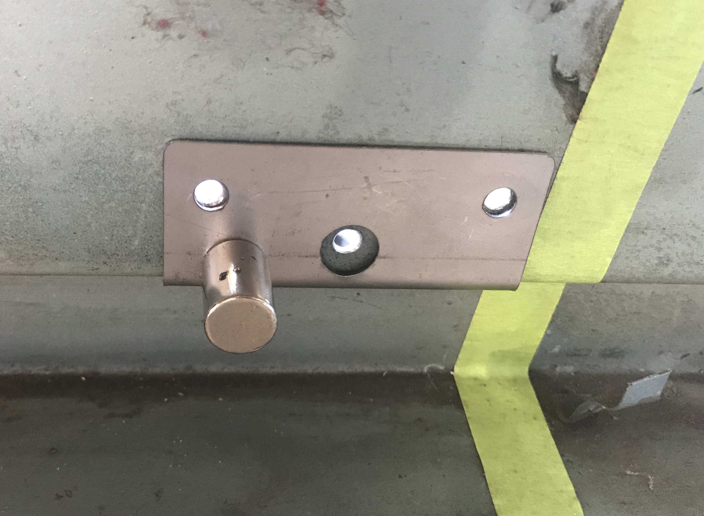

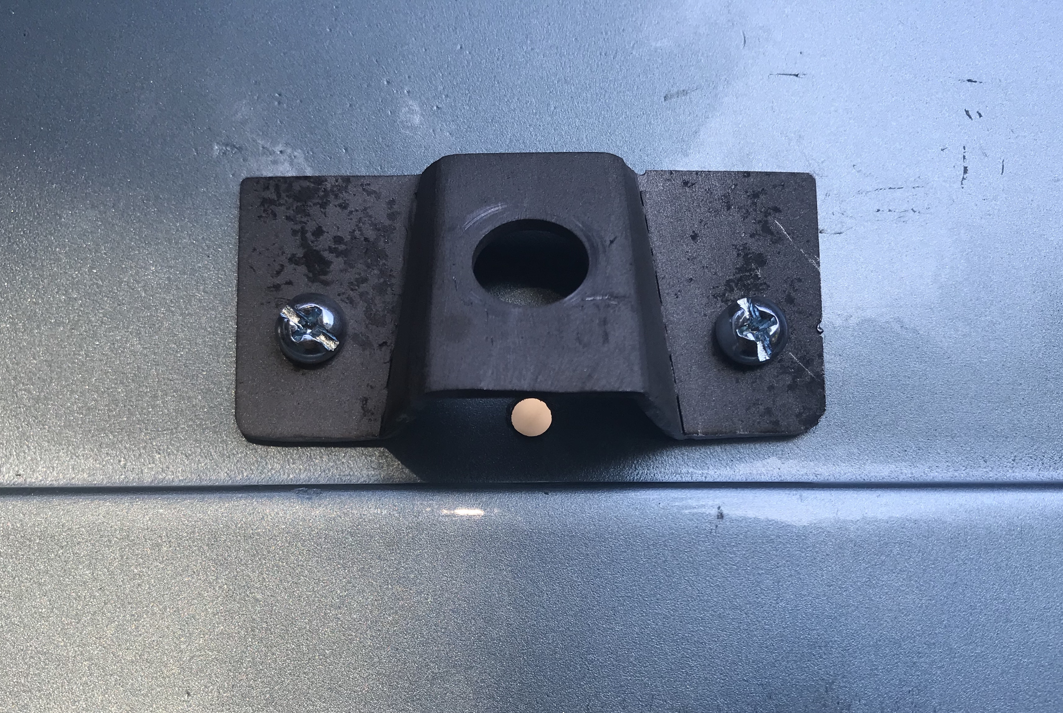

QUOTE(mepstein @ Mar 25 2019, 01:03 PM) *
Rhodguy/Kevin was selling a six flapper box. I figured Porsche did it for a reason so I just copied it. I just used some regular 4 pieces, cut out the hole with a hole saw in a drill press and then blasted and powdercoated the parts. Mine weren’t in great shape so I had nothing to loose.
First one is Kevin’s original.
2nd is my modded one.
3rd pic is a comparison from Rory.
I thought that looked familiar.

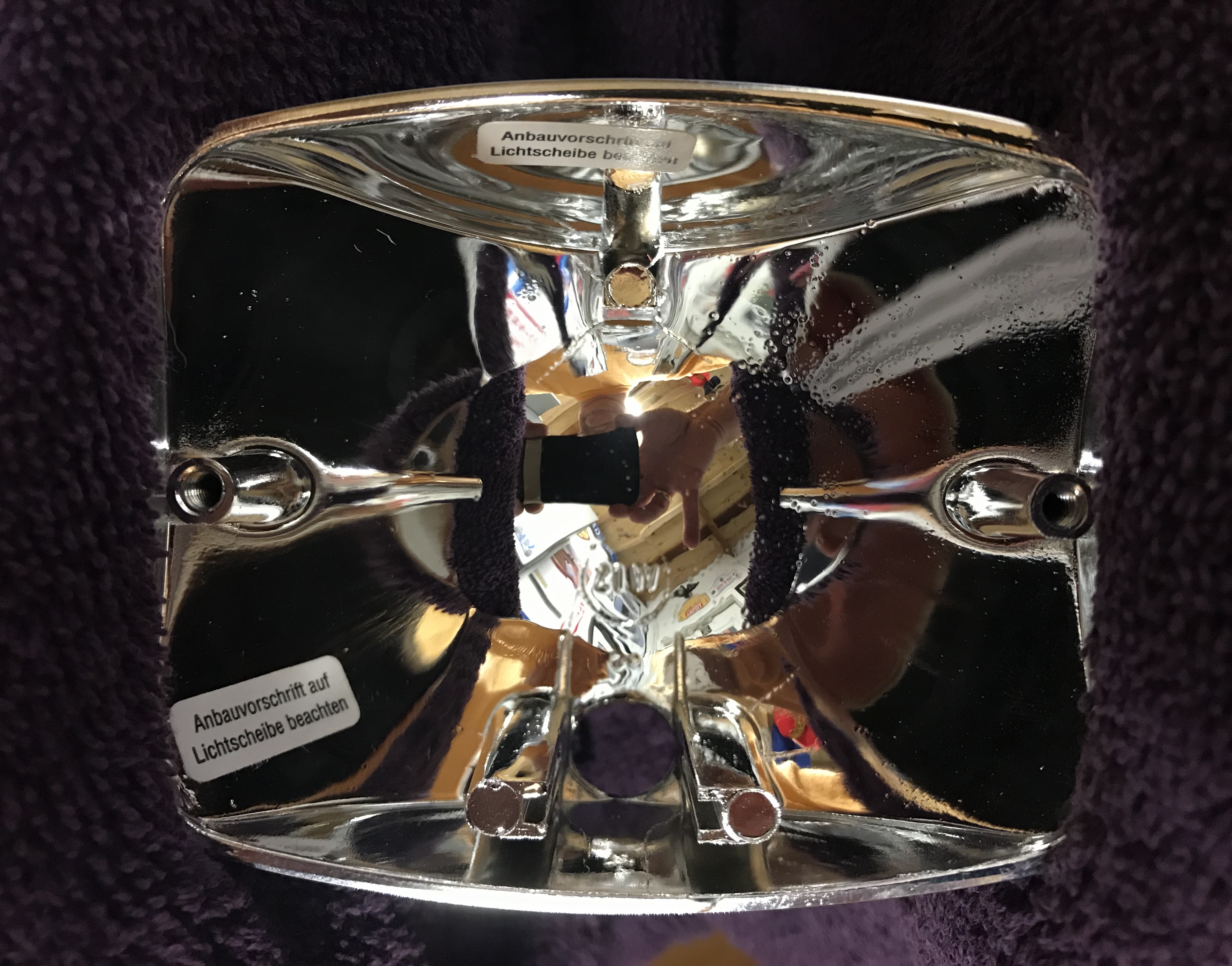

QUOTE(Dion @ Mar 18 2019, 09:23 AM) *
I posted this earlier in my thread but I think it’s cool to look at
and I’m sure it’s gonna be loud. The primitive diffuser is interesting.
Hey Dion
I have one of those.
I can report it IS friggin' LOUD !
Loved it.
But not easy to be inconspicuous with.
Mine is not nearly as clean as yours.

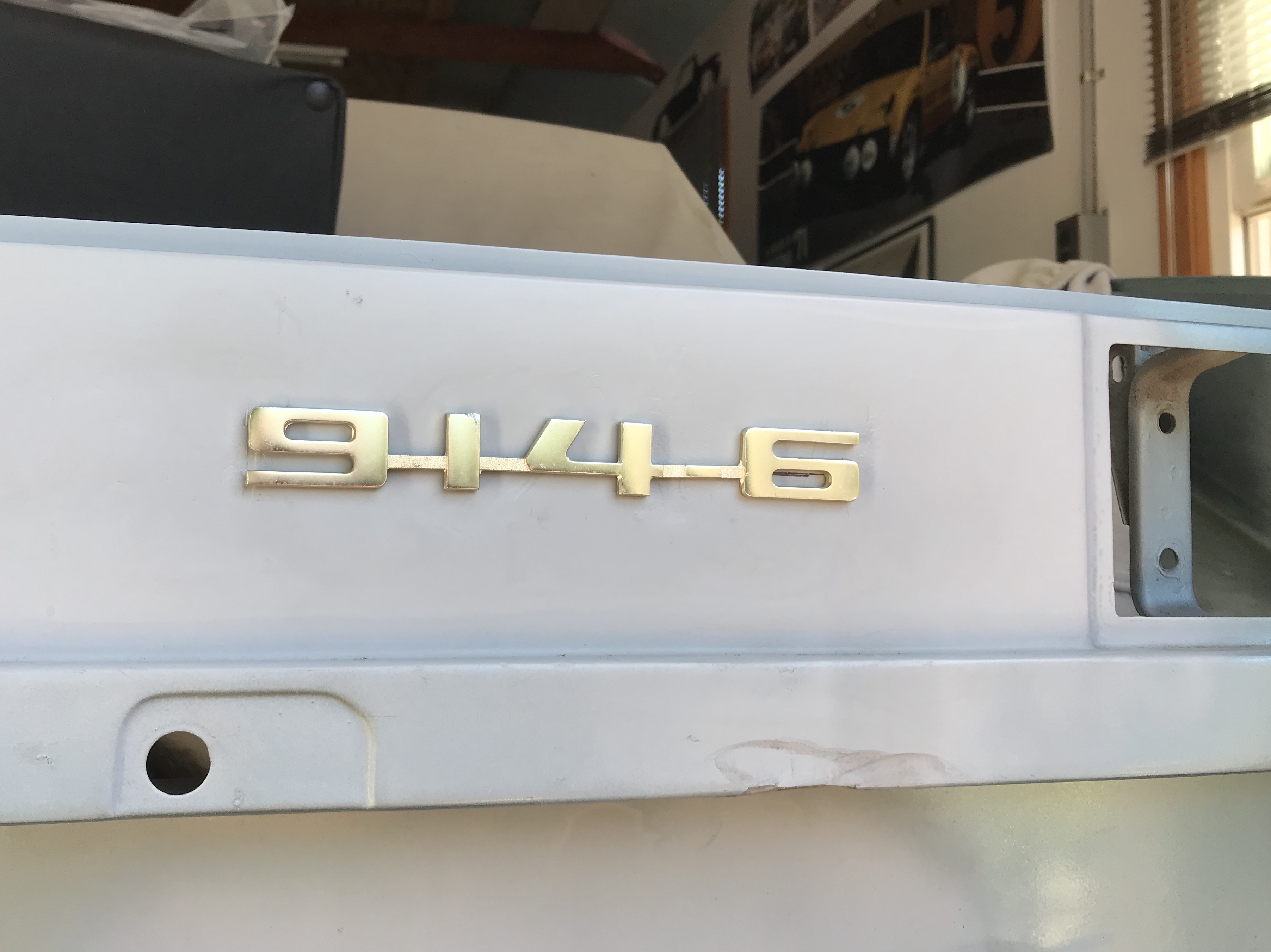

Seeing all these 914 50th celebrations got me inspired again.
Kids are sorted and back at college. Enough of that running around.
Not too mention the new Jeep toy. So didn’t do any big welding of chassis
just little jobs for now.

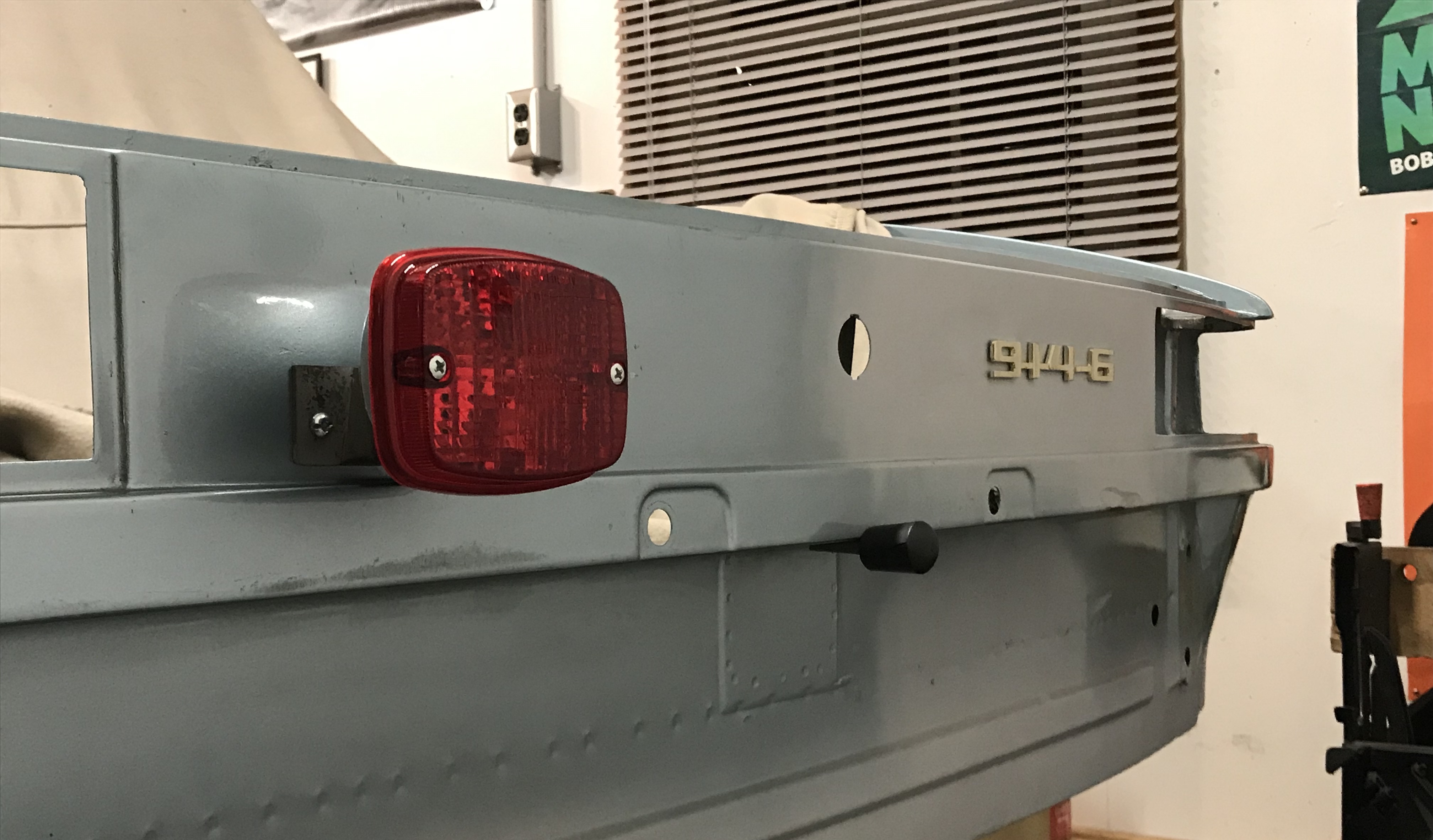

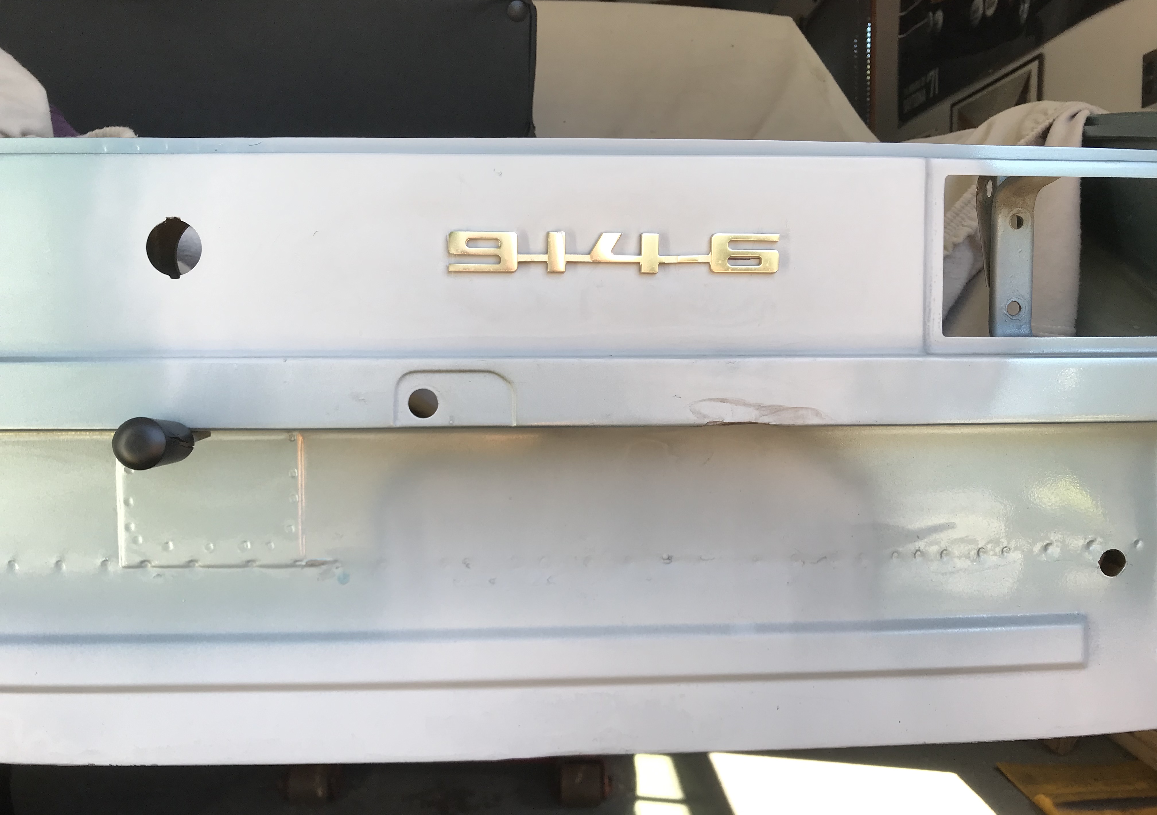

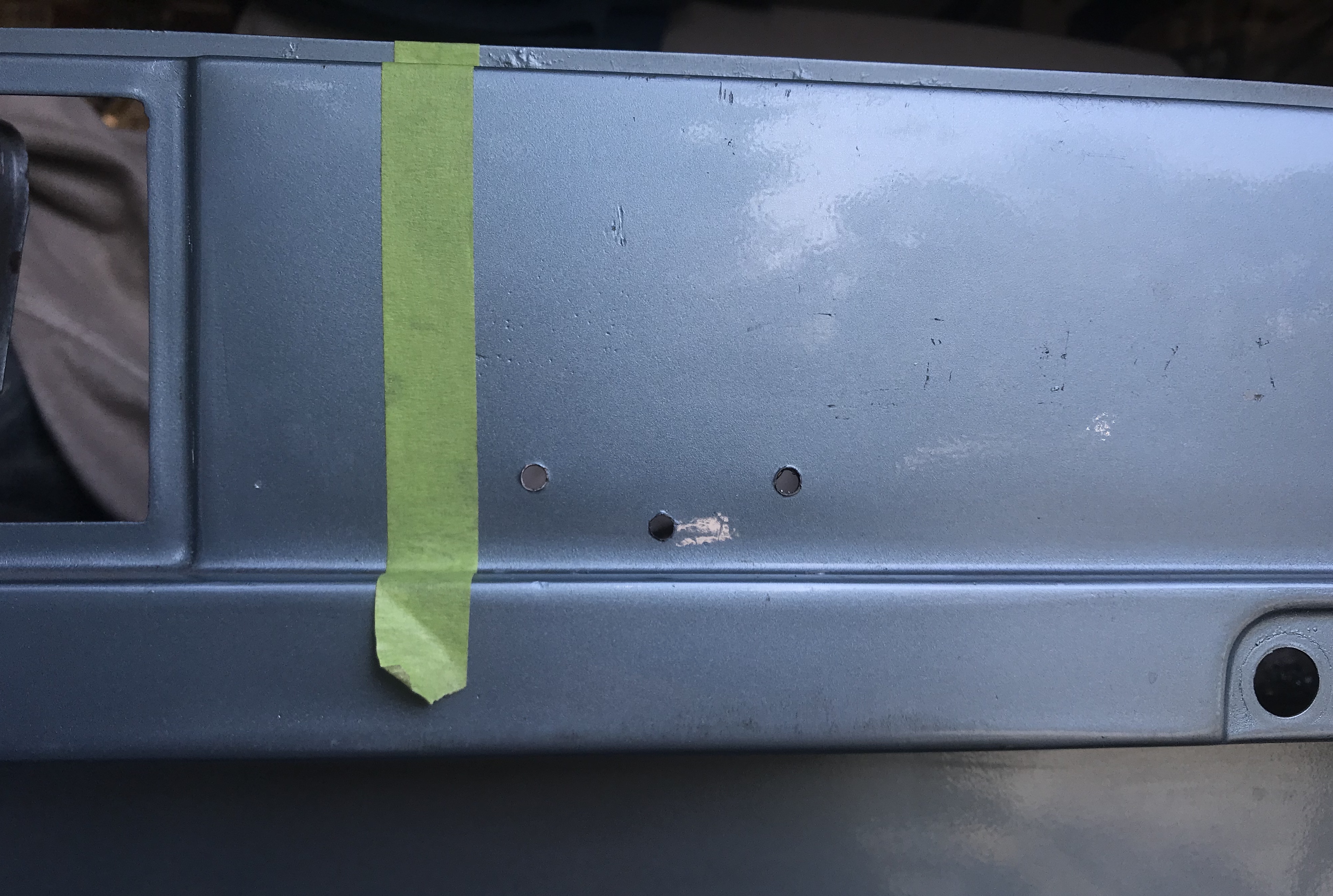

First up drilled the rear panel for proper 6 emblem placement.
Dion
post Sep 17 2019, 07:18 PM
Post #548
RN
Posts: 2,935
Joined: 16-September 04
From: Shepherdstown, WV
Member No.: 2,766

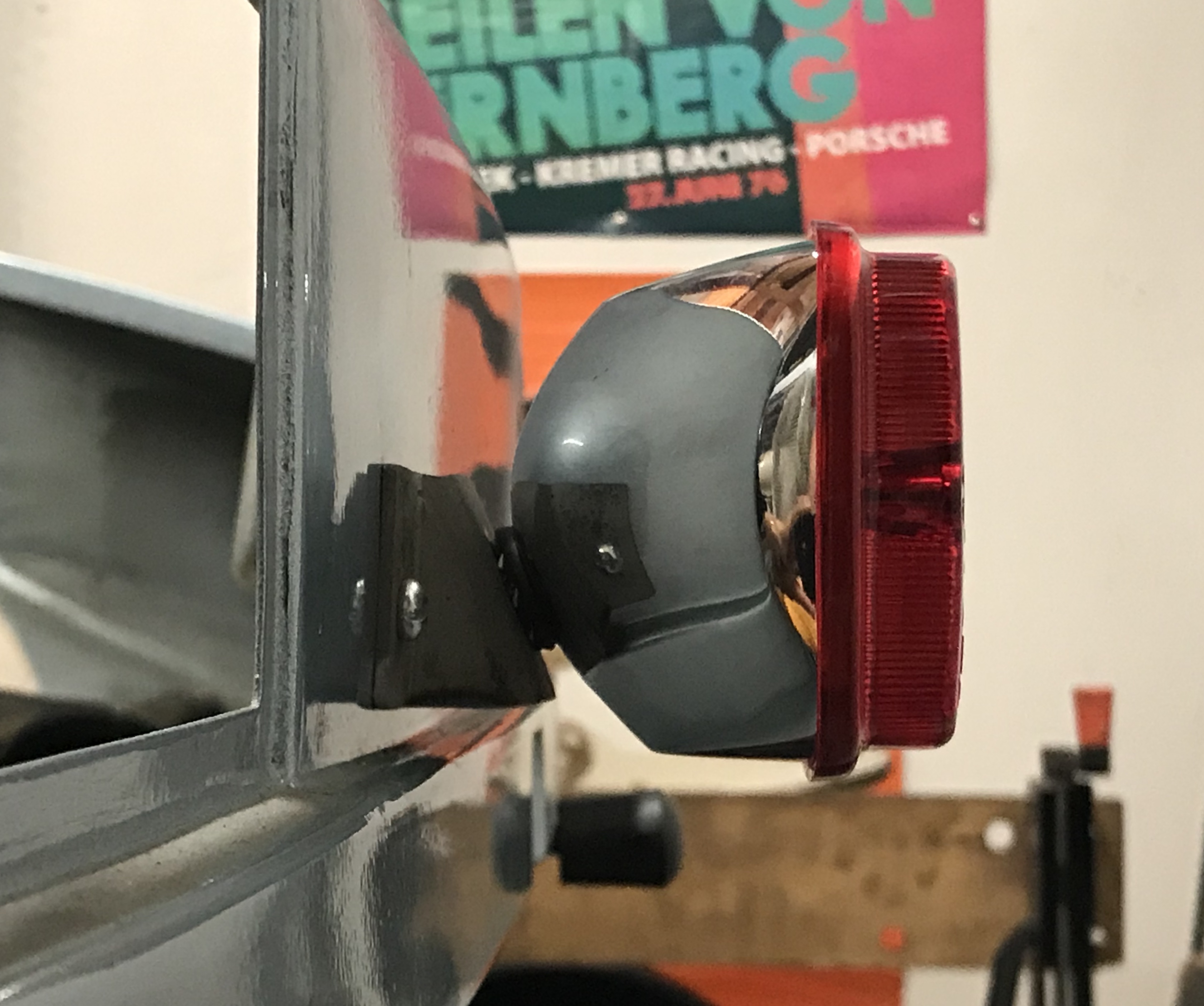

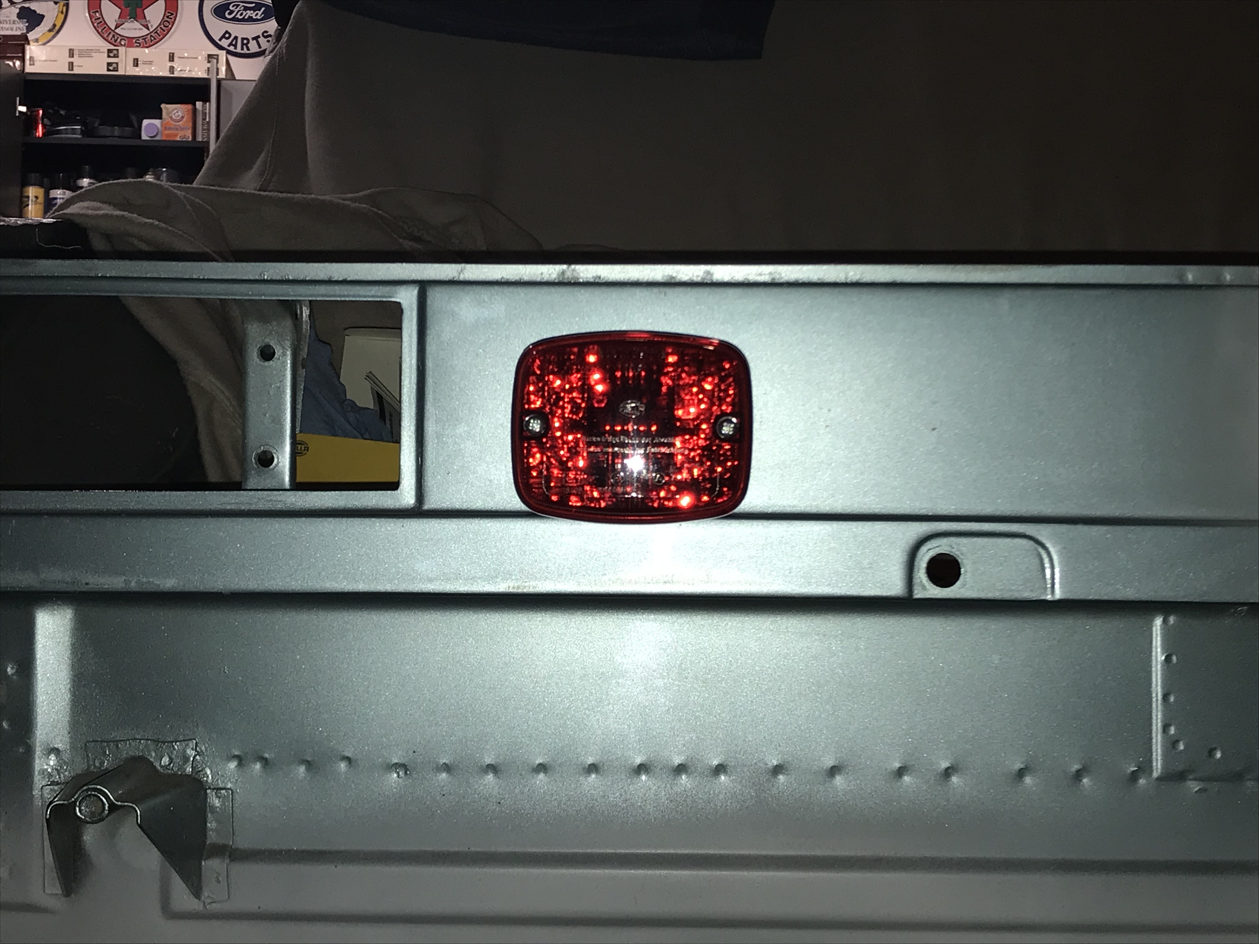

2nd on the list today. Mocked up the bracket for the rear fog lamp.
Dion
post Sep 17 2019, 07:19 PM
Post #549
RN
Posts: 2,935
Member No.: 2,766
Placement

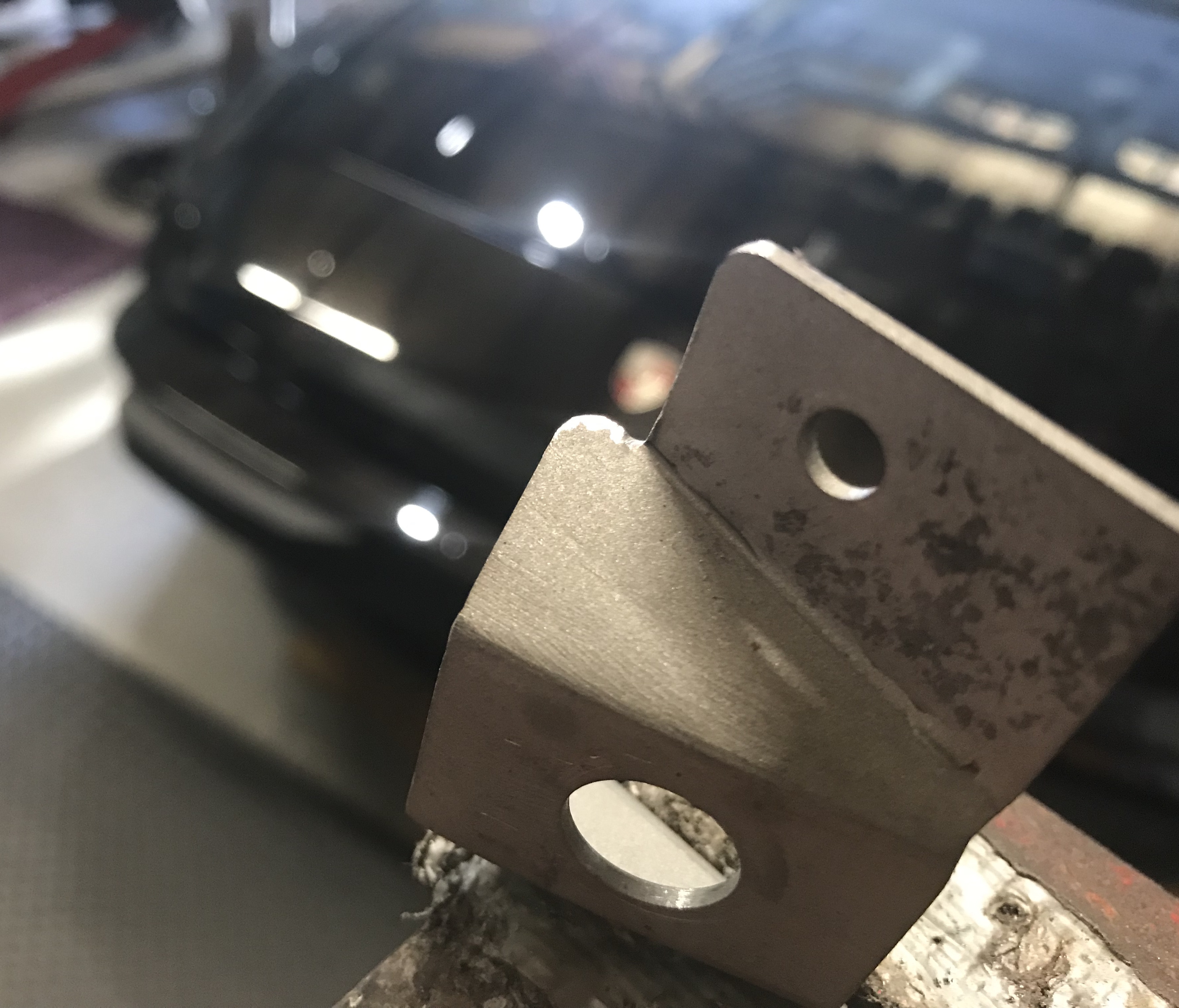

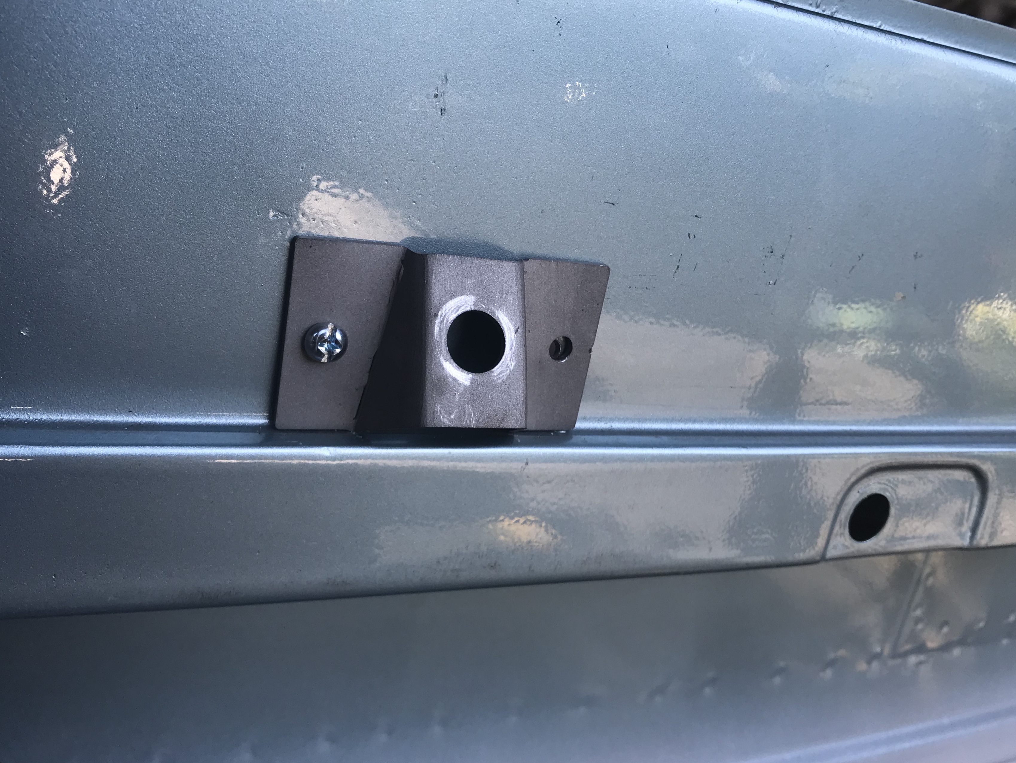

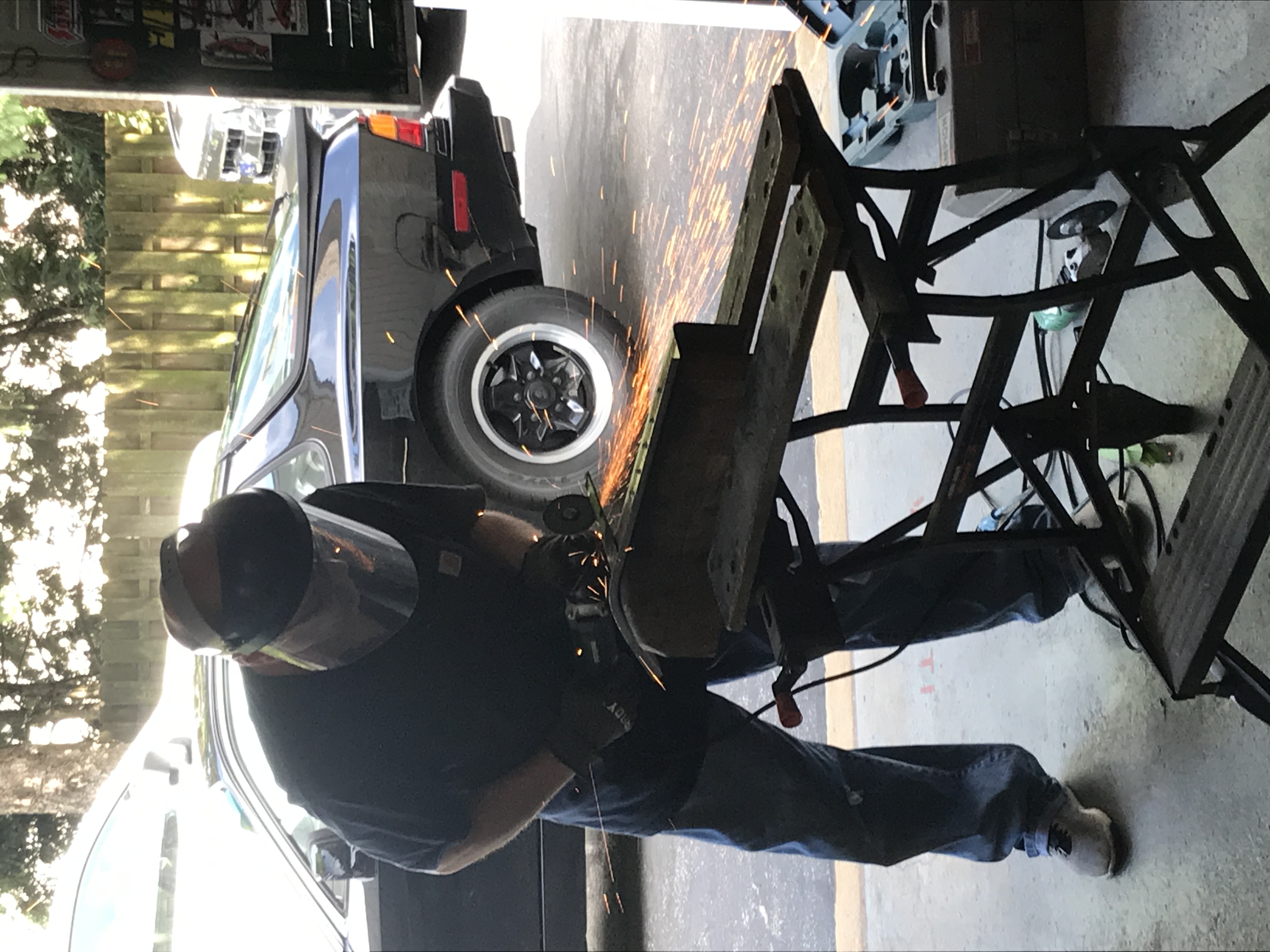

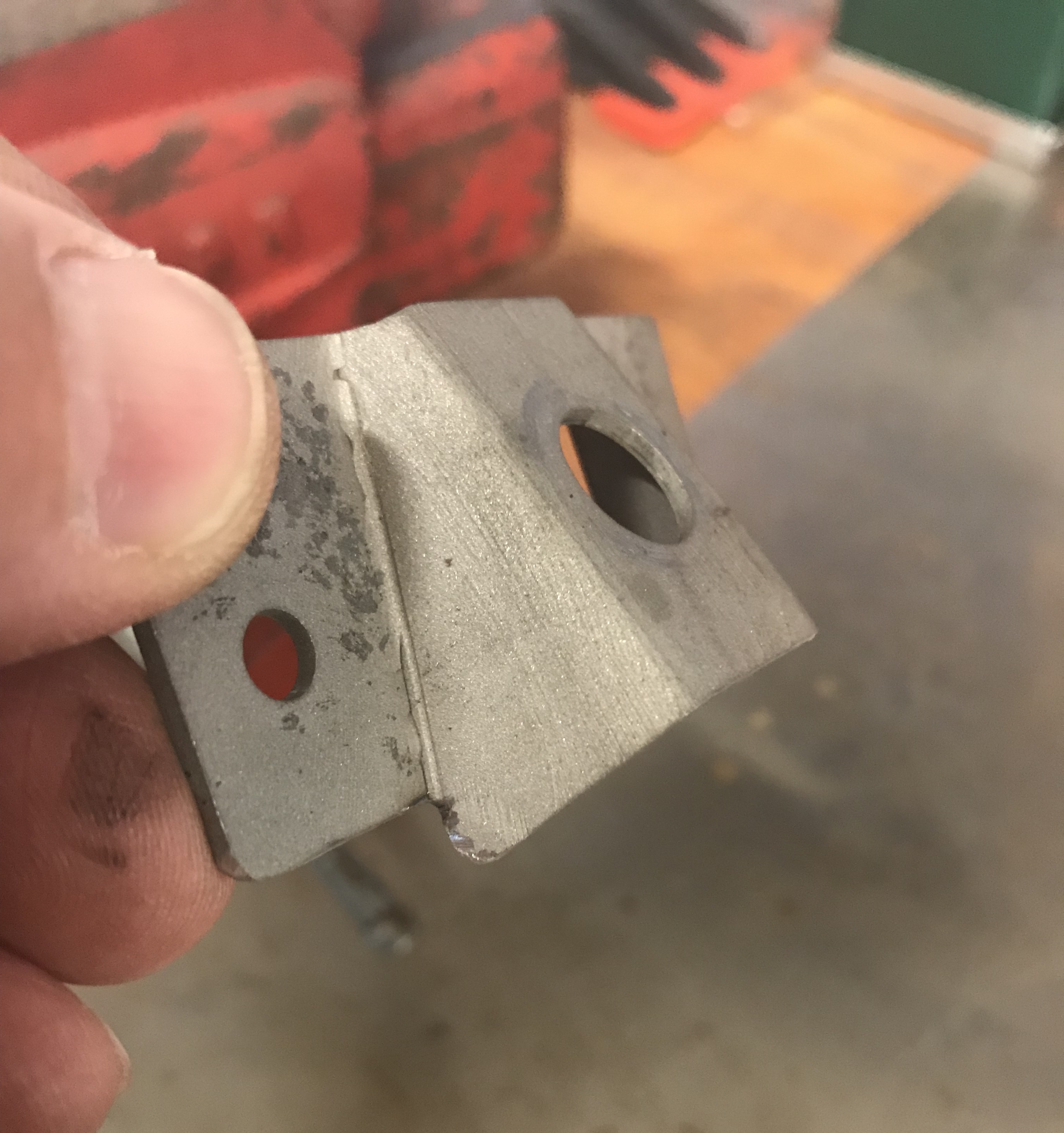

Realized that the bracket is just a little too big so I skimmed some metal off the bottom portion.
Dion
post Sep 17 2019, 07:21 PM
Post #551
RN
Posts: 2,935
Member No.: 2,766
Finished edge

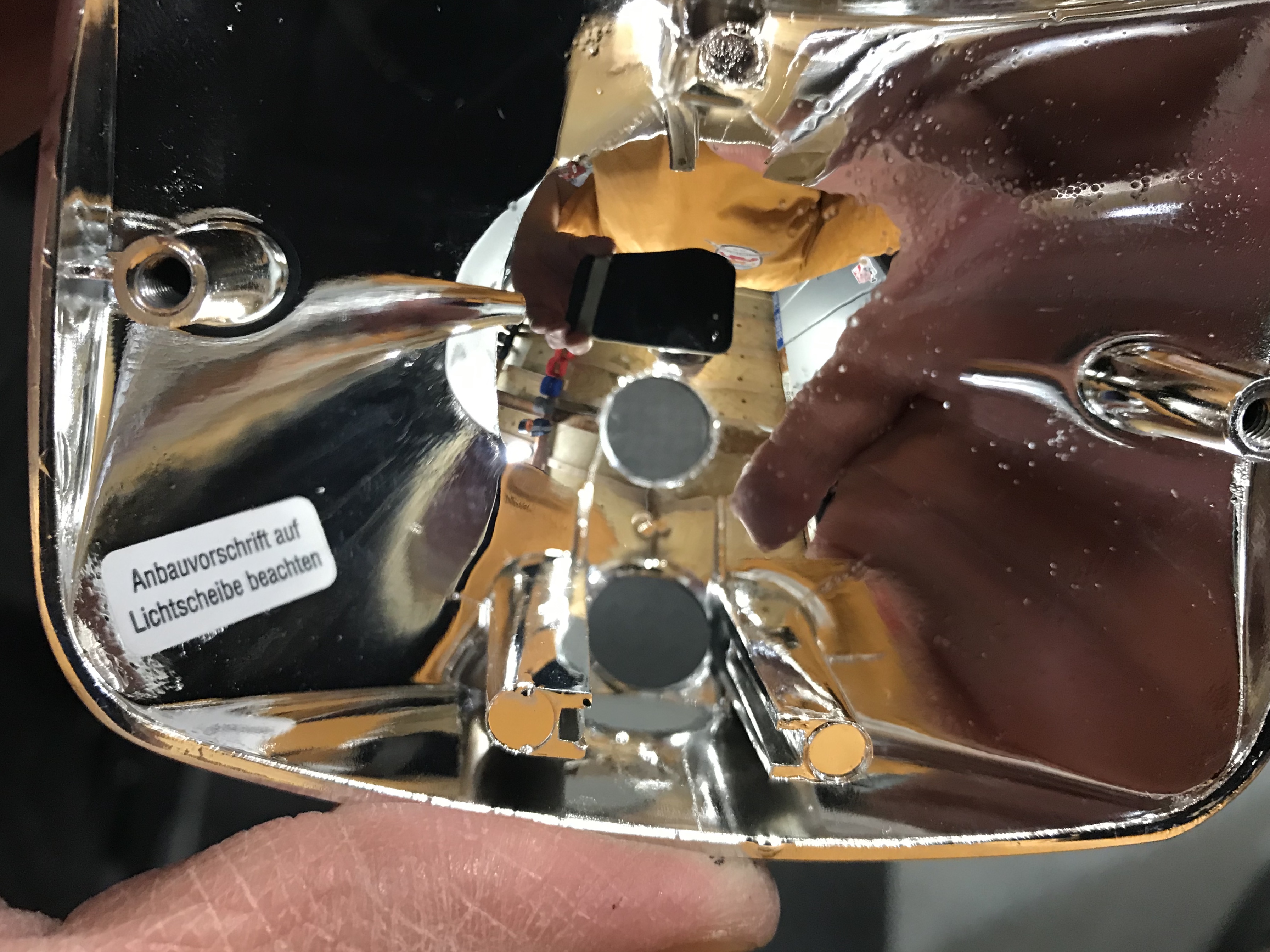

Next was taking Larmo’s advice and bored a new hole in the fog lite itself so
it is oriented in the proper plane with regards to the car.
Drilled out the “21w” logo
Dion
post Sep 17 2019, 07:26 PM
Post #553
RN
Posts: 2,935
Member No.: 2,766
New hole. Hard to see.
Dion
post Sep 17 2019, 07:27 PM
Post #554
RN
Posts: 2,935
Member No.: 2,766
And mounted. Will run wiring when the rest of bodywork is completed. It looks massive without the bumper being there. I’ll
source some proper hardware when doing the finish work. Give the brackets a proper coat as well.
Dion
post Sep 17 2019, 07:28 PM
Post #555
RN
Posts: 2,935
Member No.: 2,766
