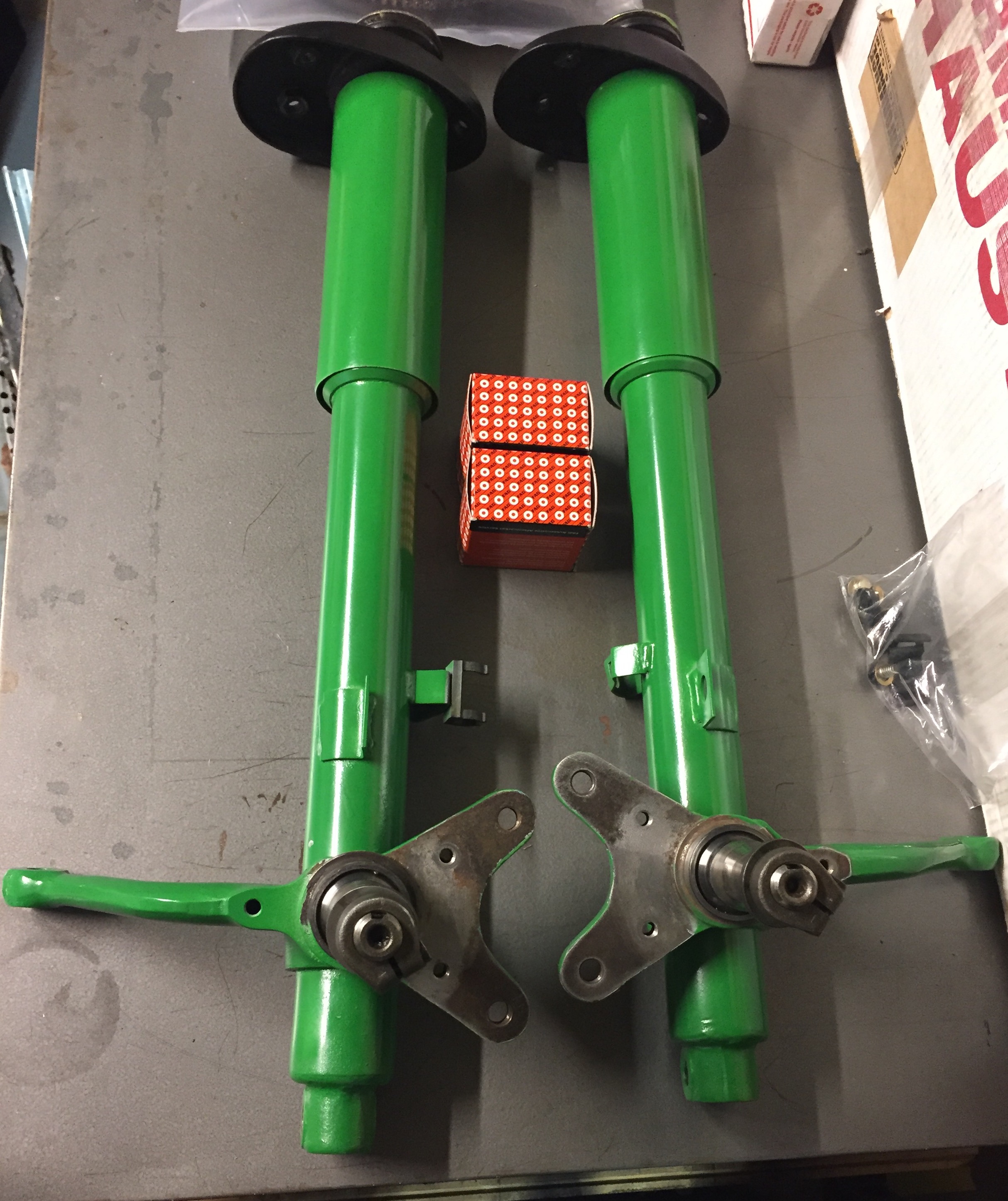

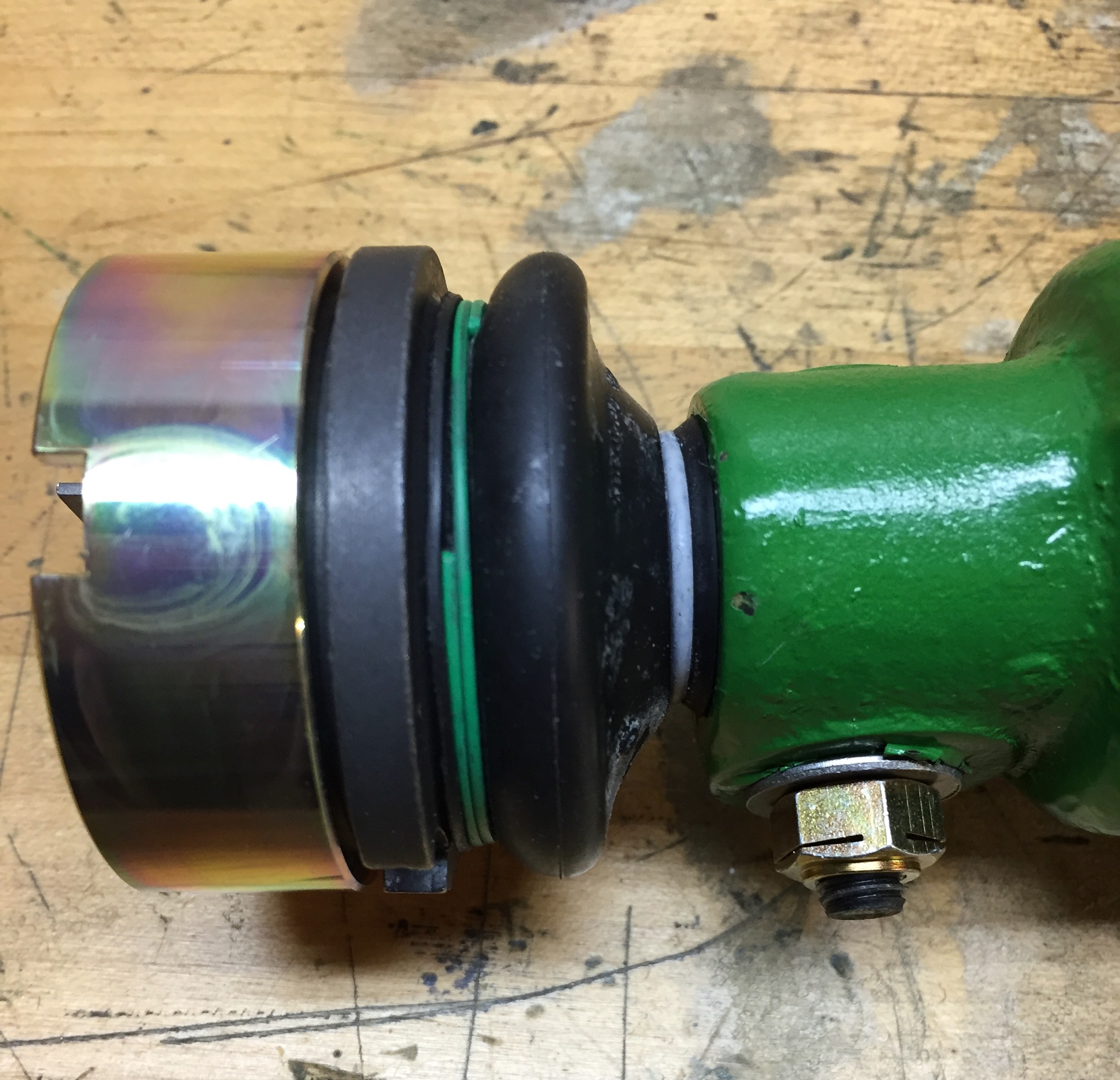

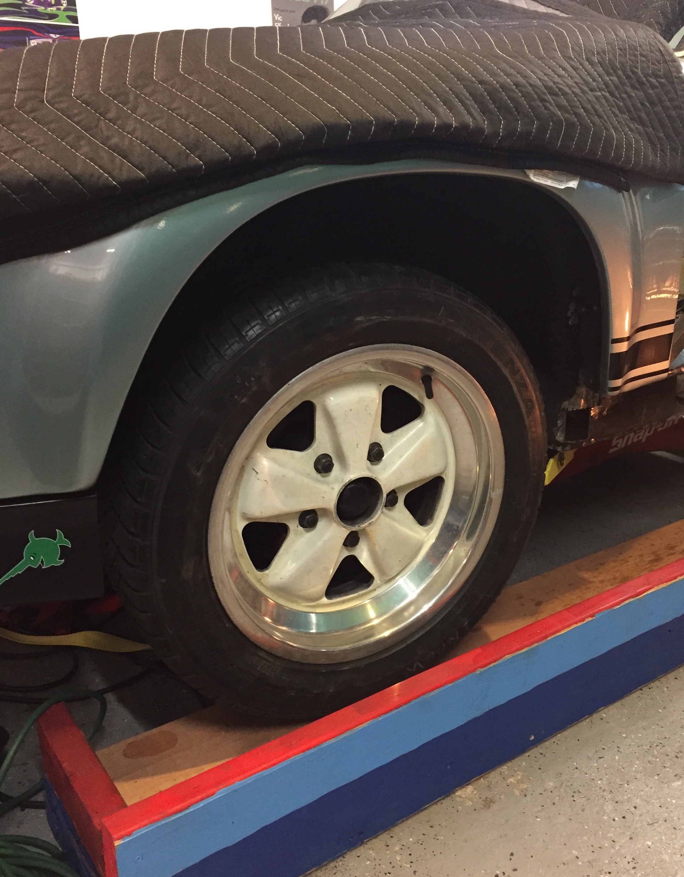

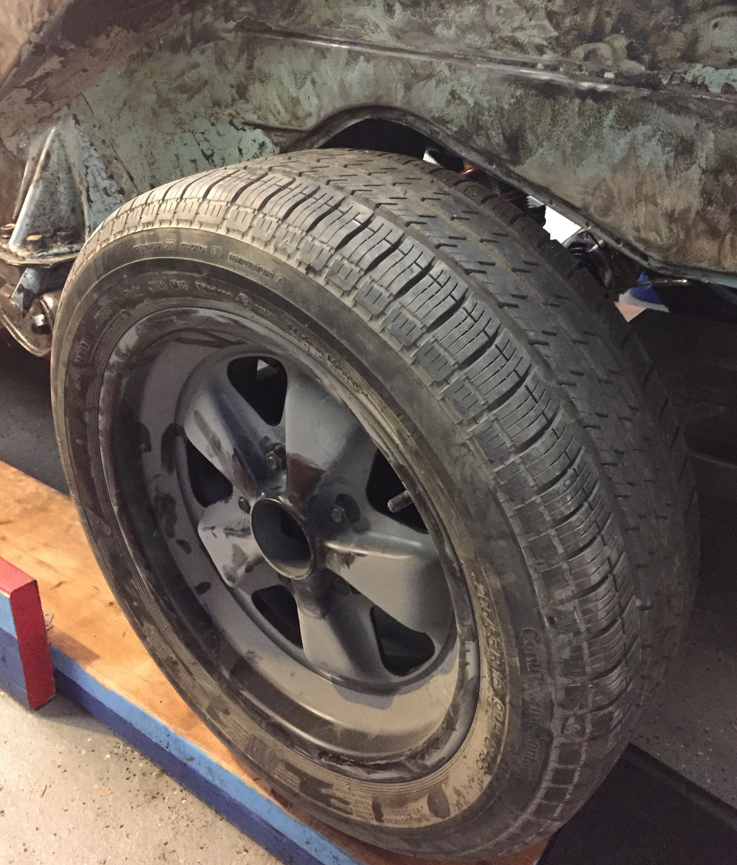

Obtained some "past it" Fuchs to roll the car around for when
the weather breaks and commence with the sandblasting.
Also working on front struts. They are renewed and painted.

Bilsteins

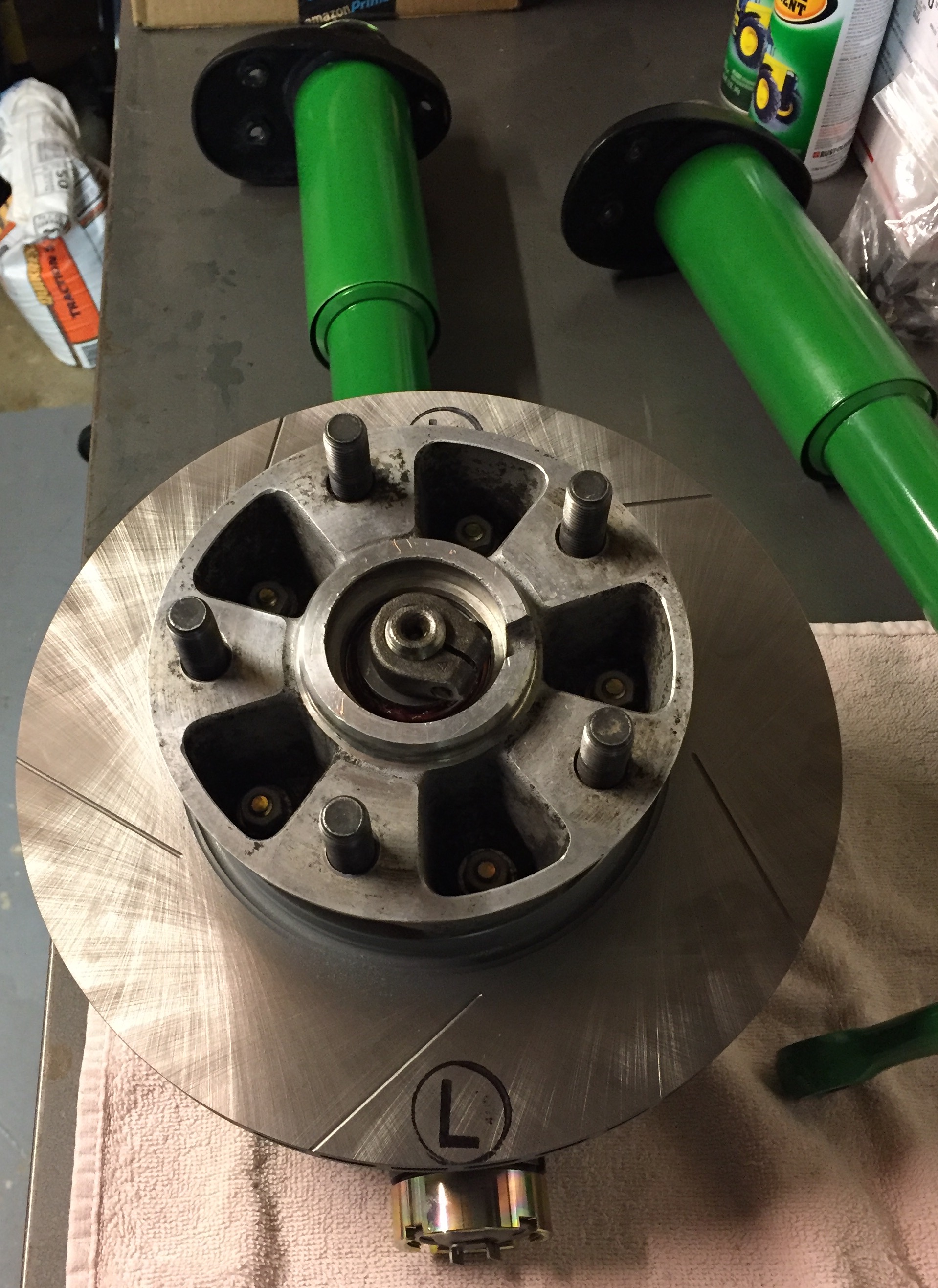

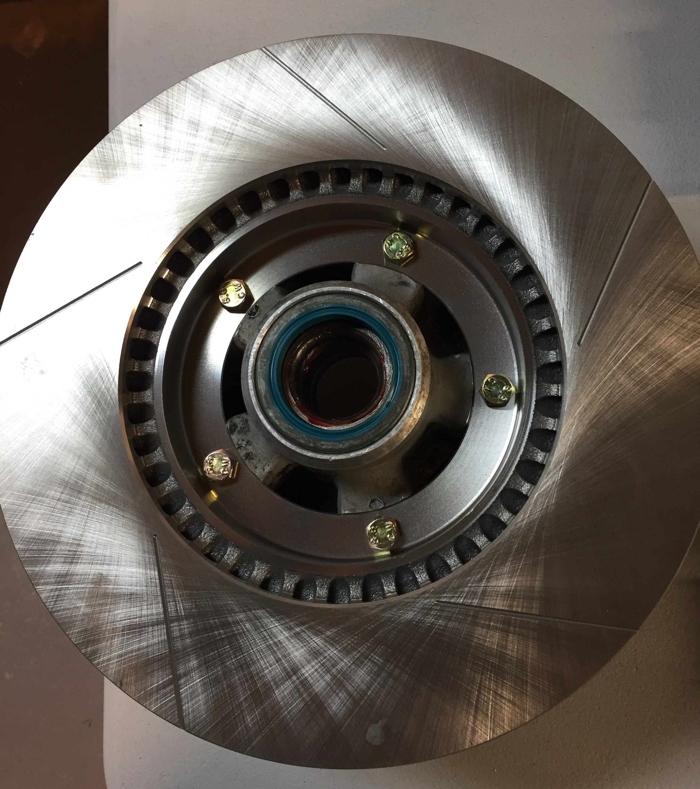

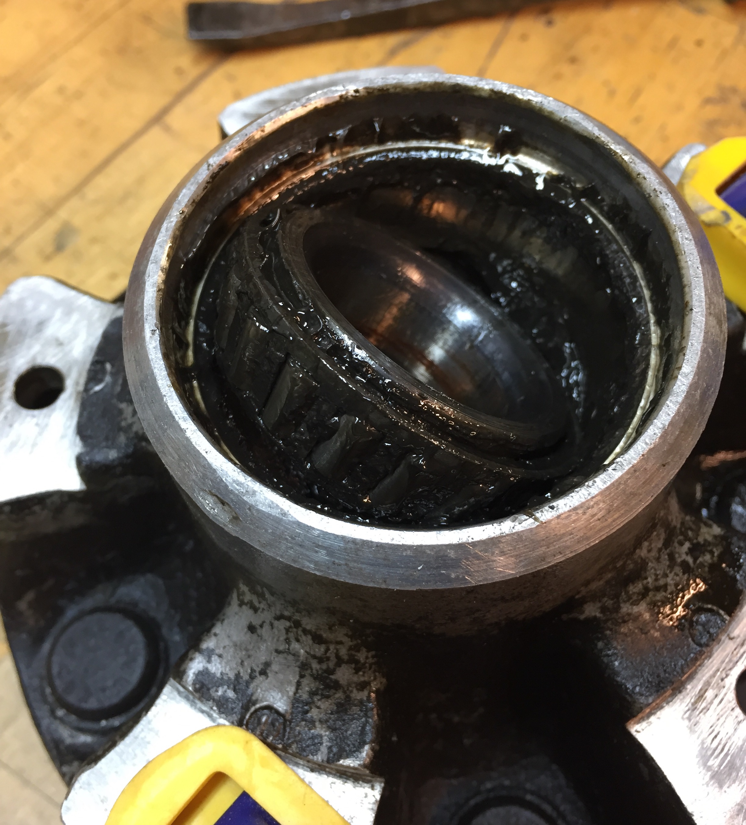

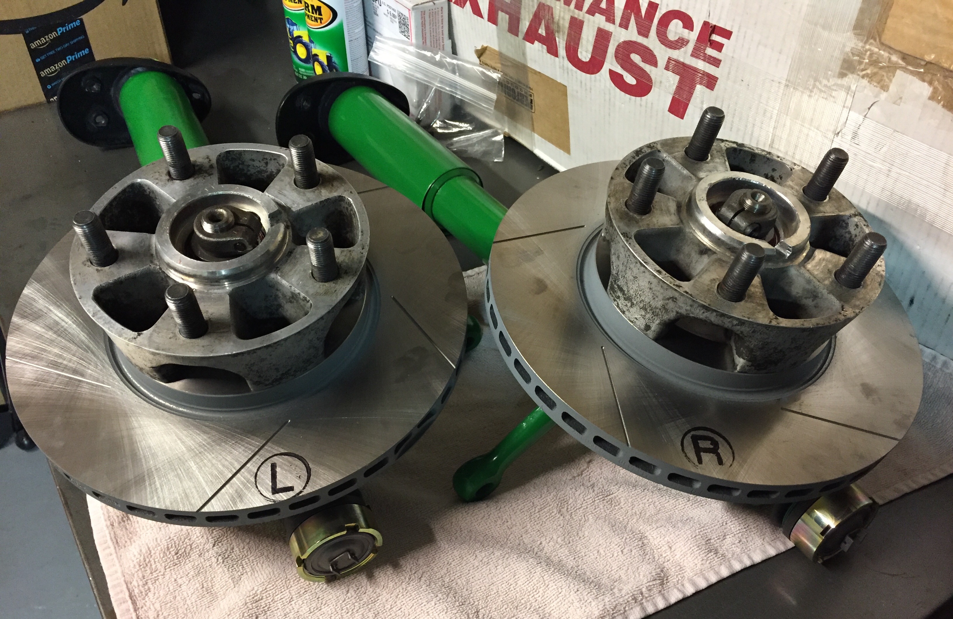

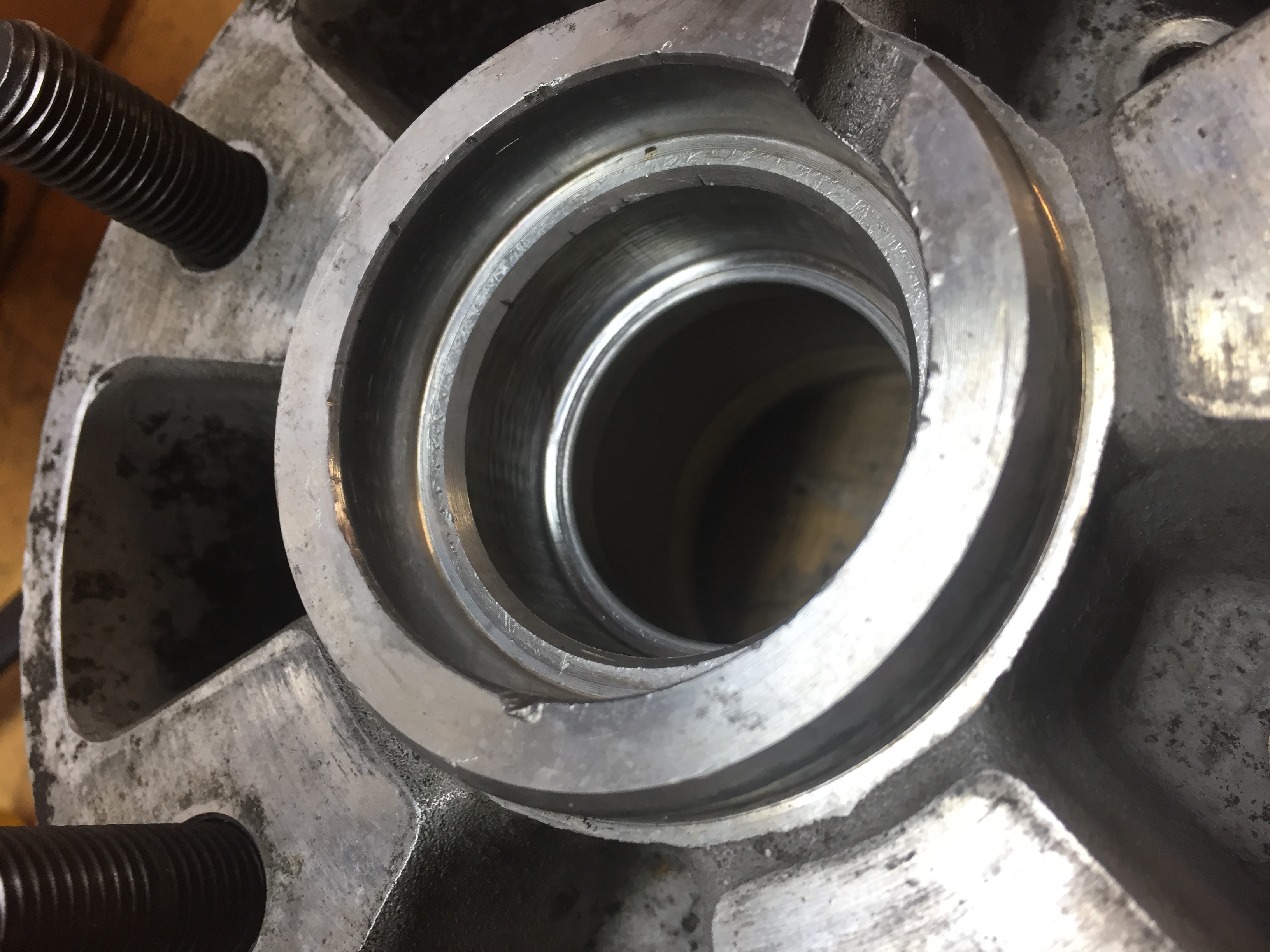

Tackling front suspension work. Replaced hub bearings and installed new
vented rotors.
Dion
post Jan 22 2017, 09:28 PM
Post #66
RN
Posts: 2,931
Joined: 16-September 04
From: Shepherdstown, WV
Member No.: 2,766

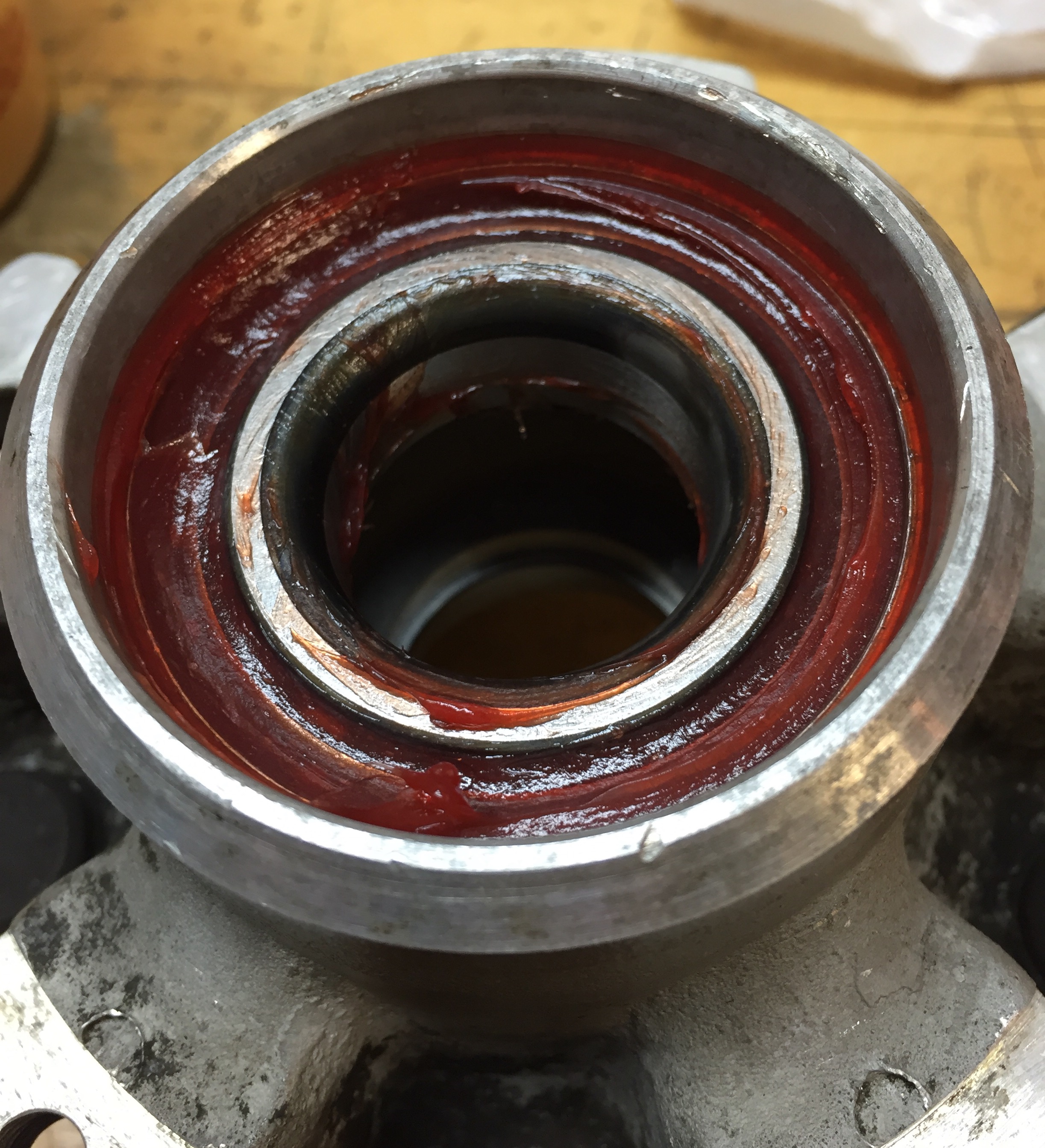

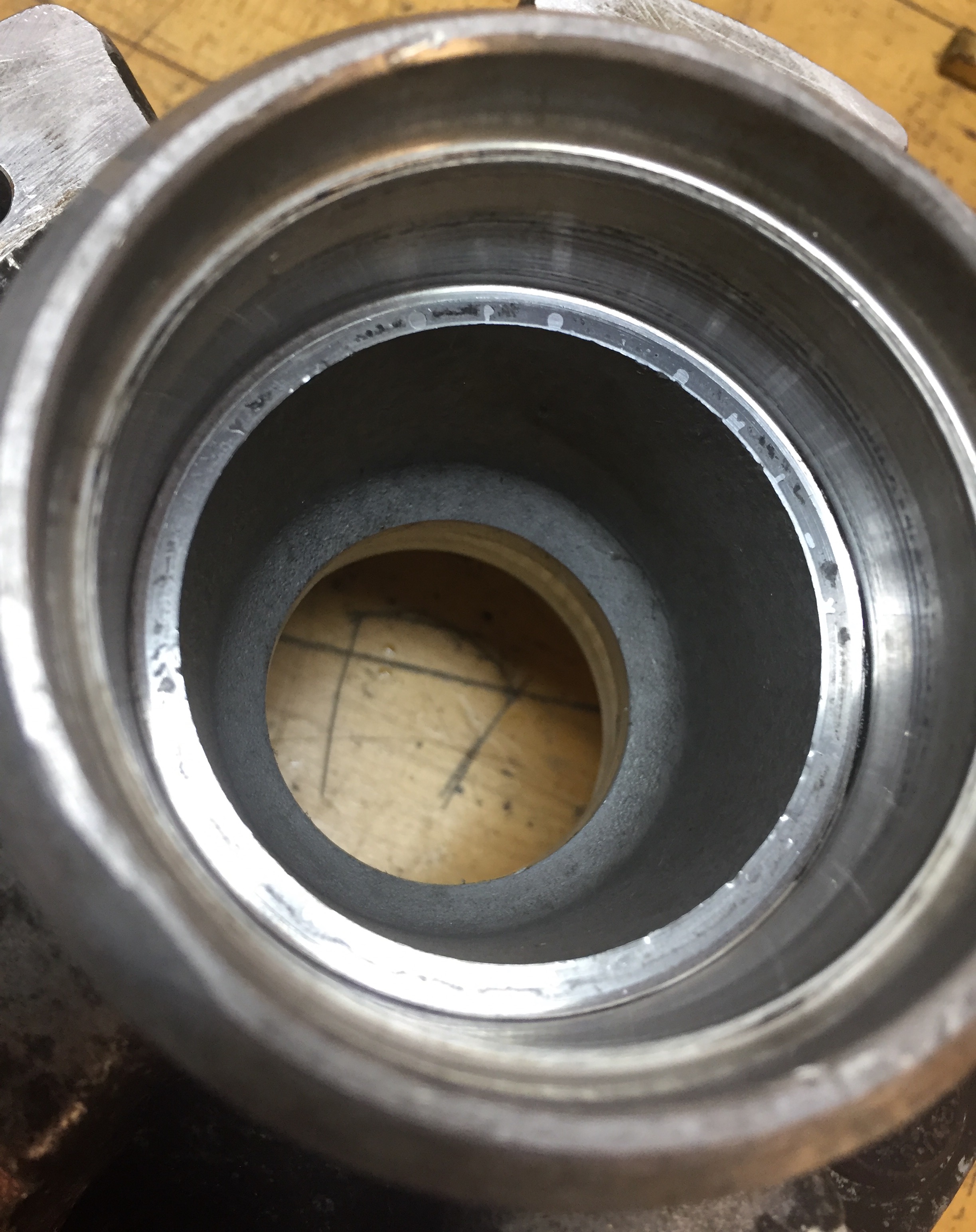

Baked the hubs at 250*F for 25 minutes to coax the
races out.
Dion

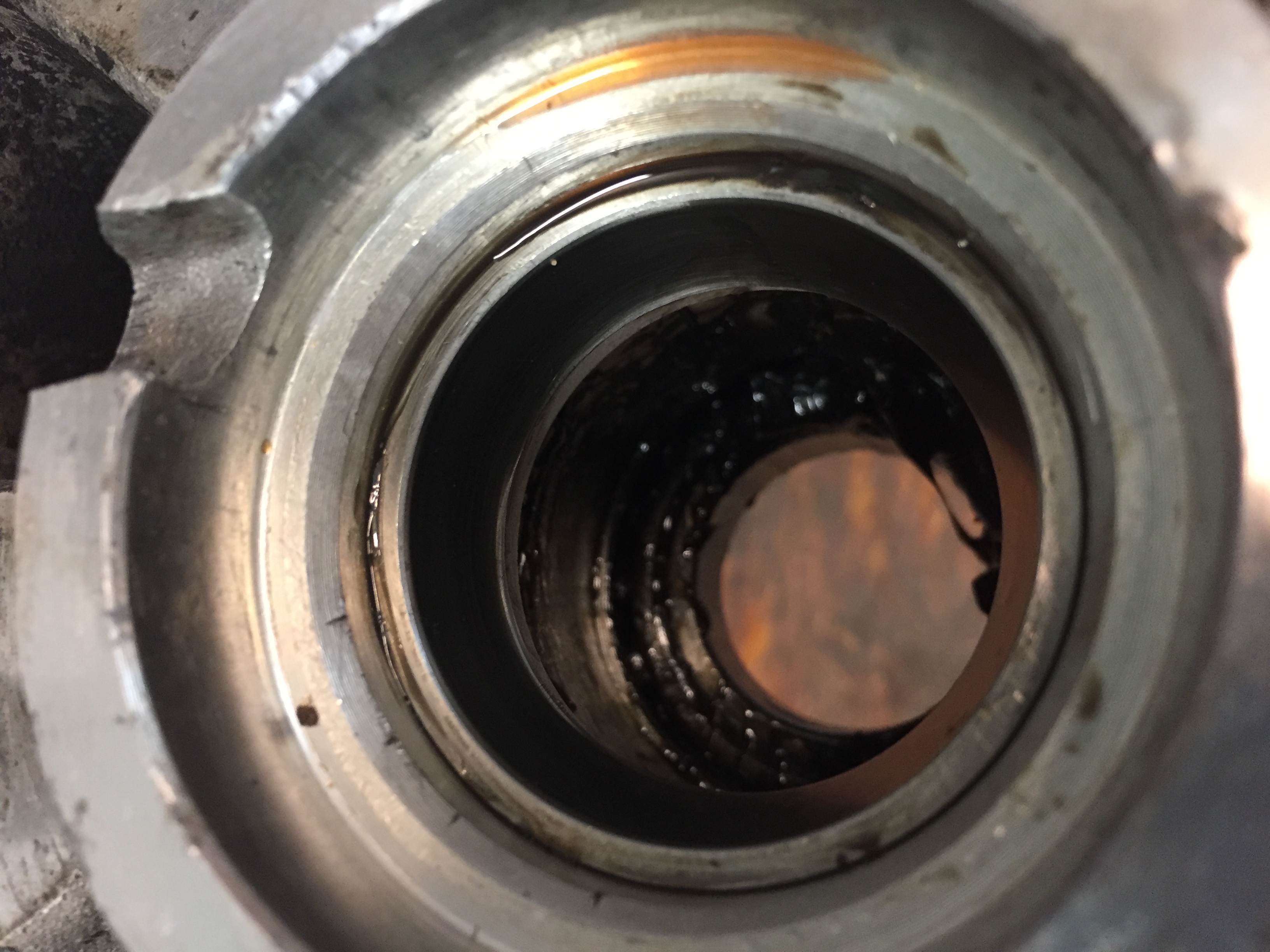

Clean hubs
Dion

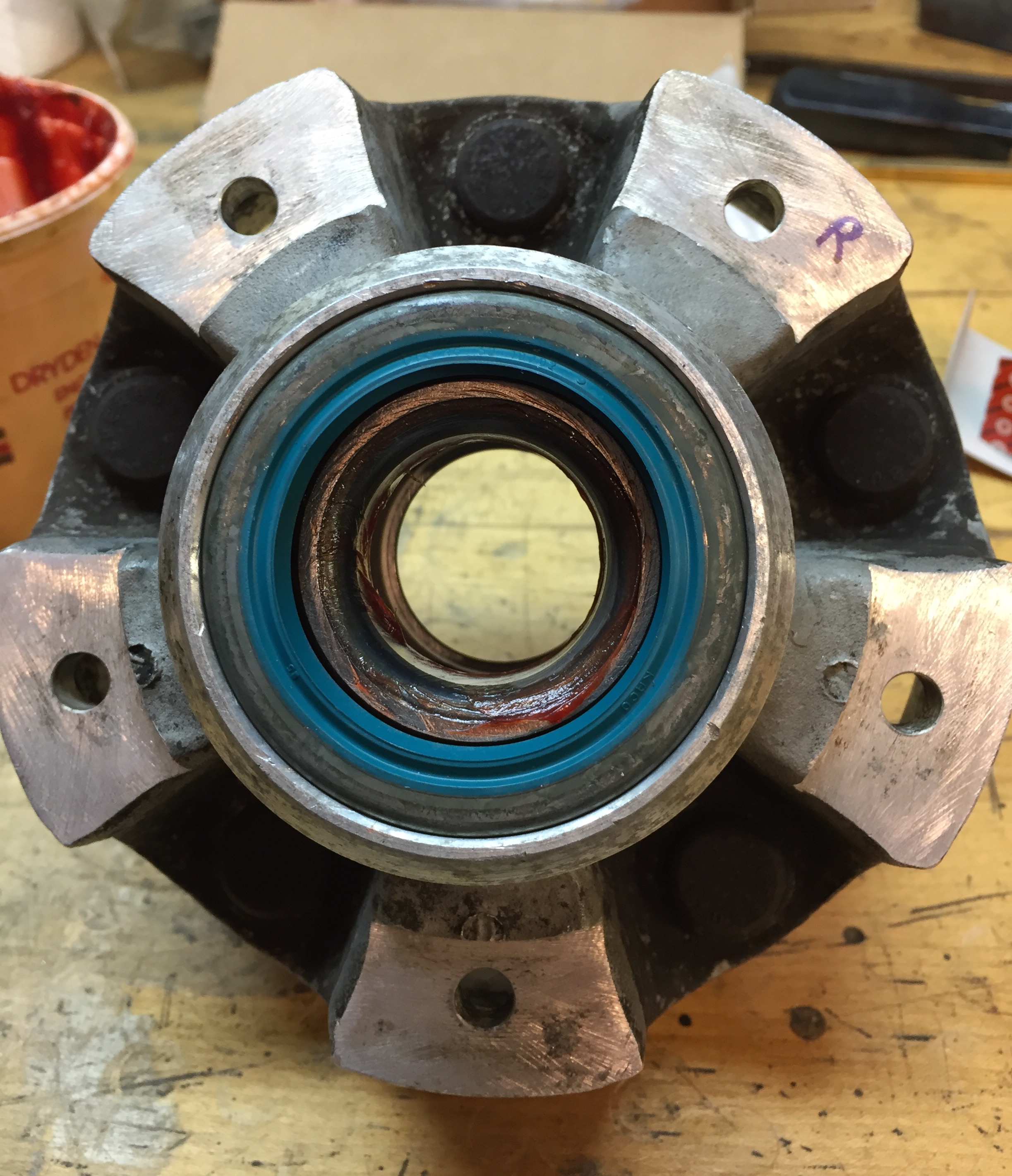

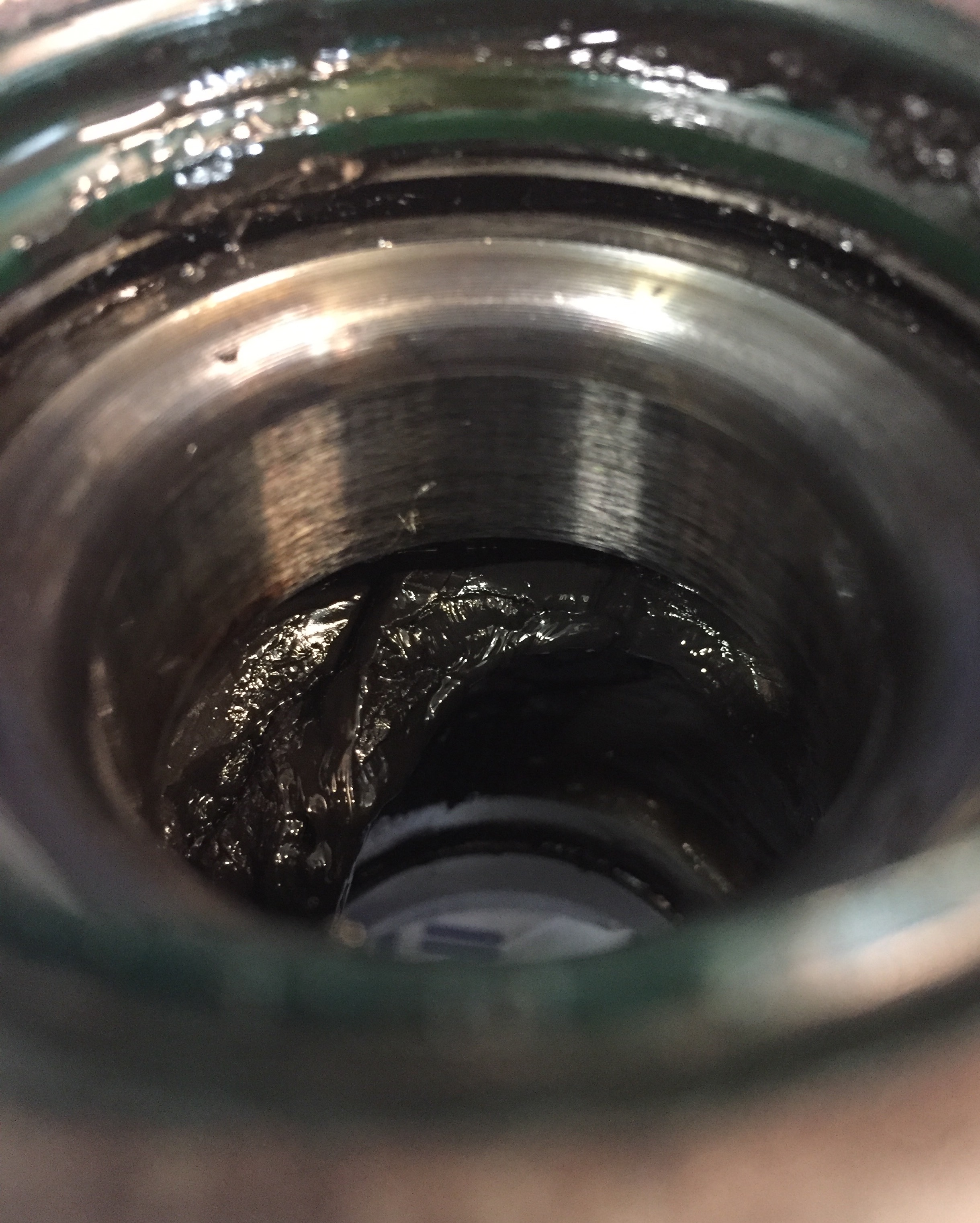

Repacked
Dion

Rotors
Dion

Front calipers will be sent to PMB soon.
Time to get back to the chassis rust repair.

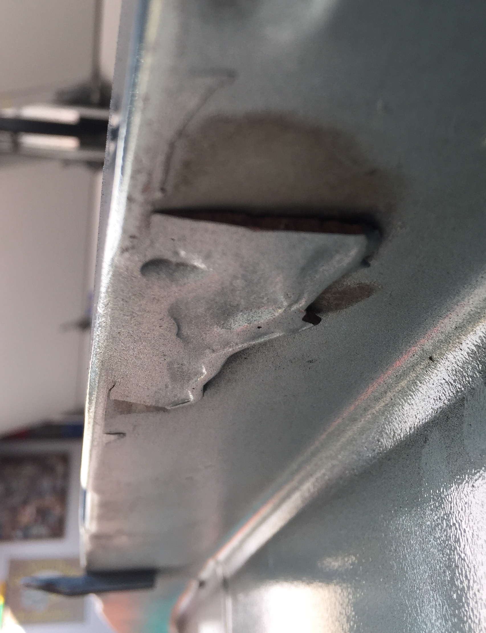

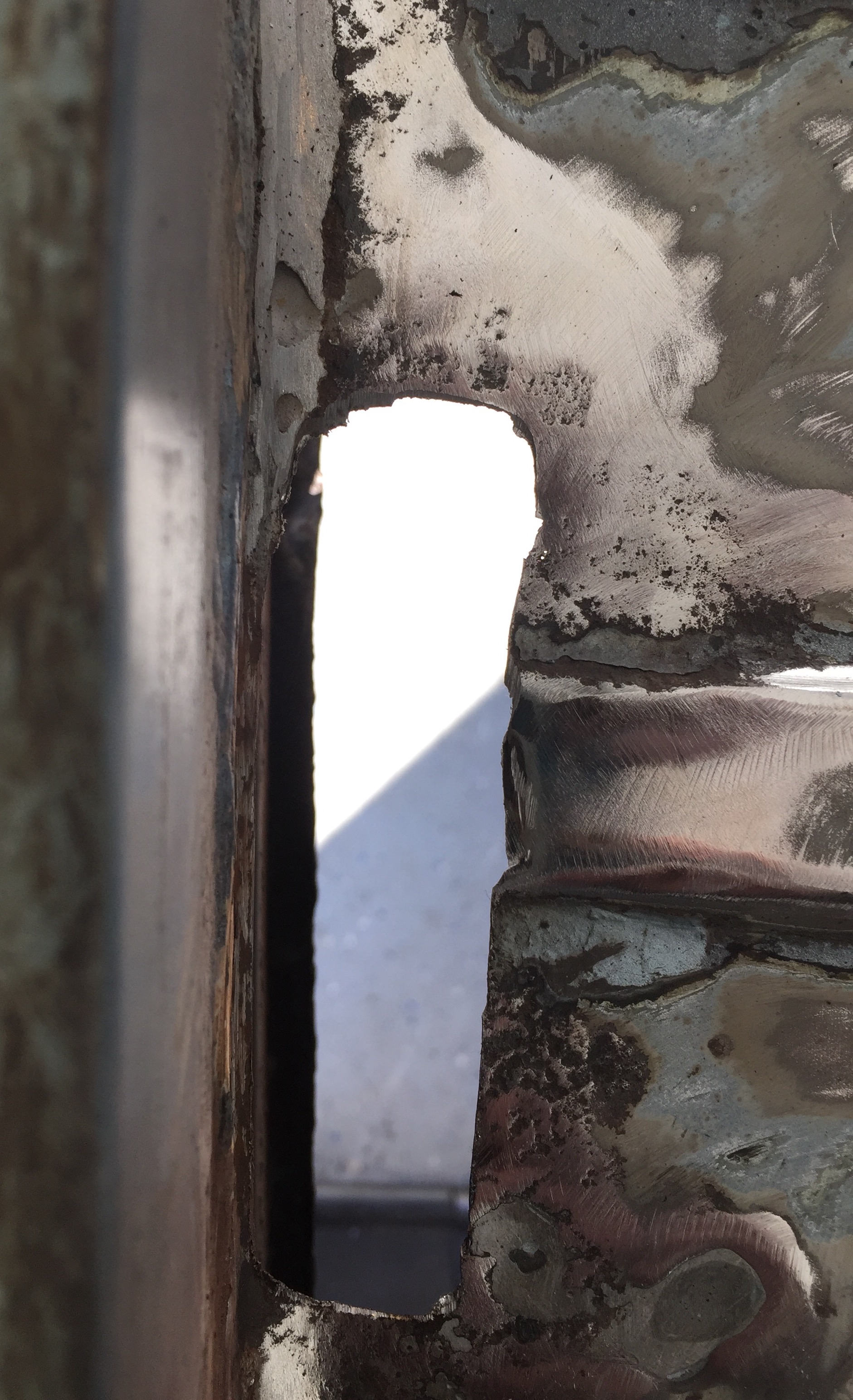

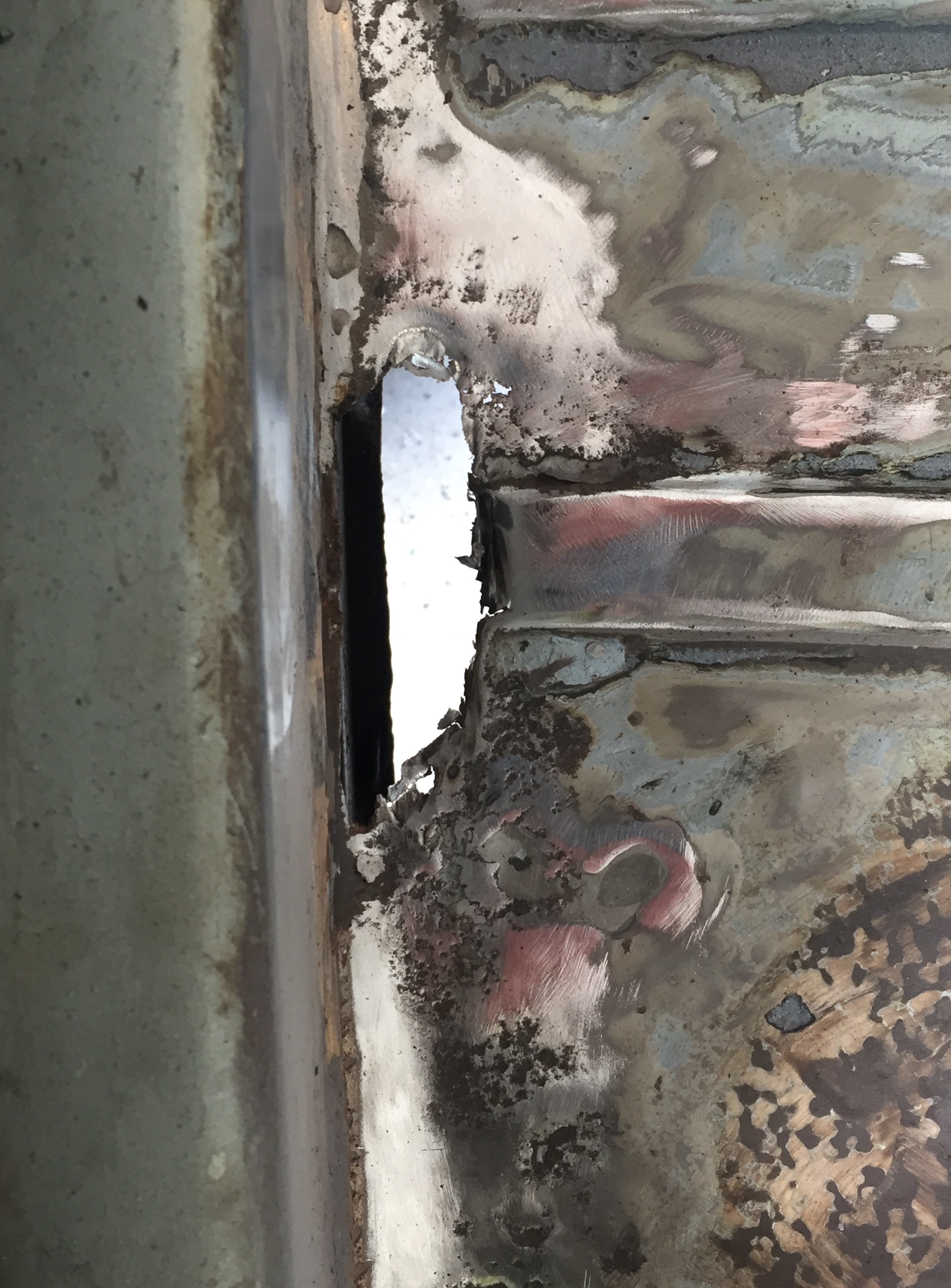

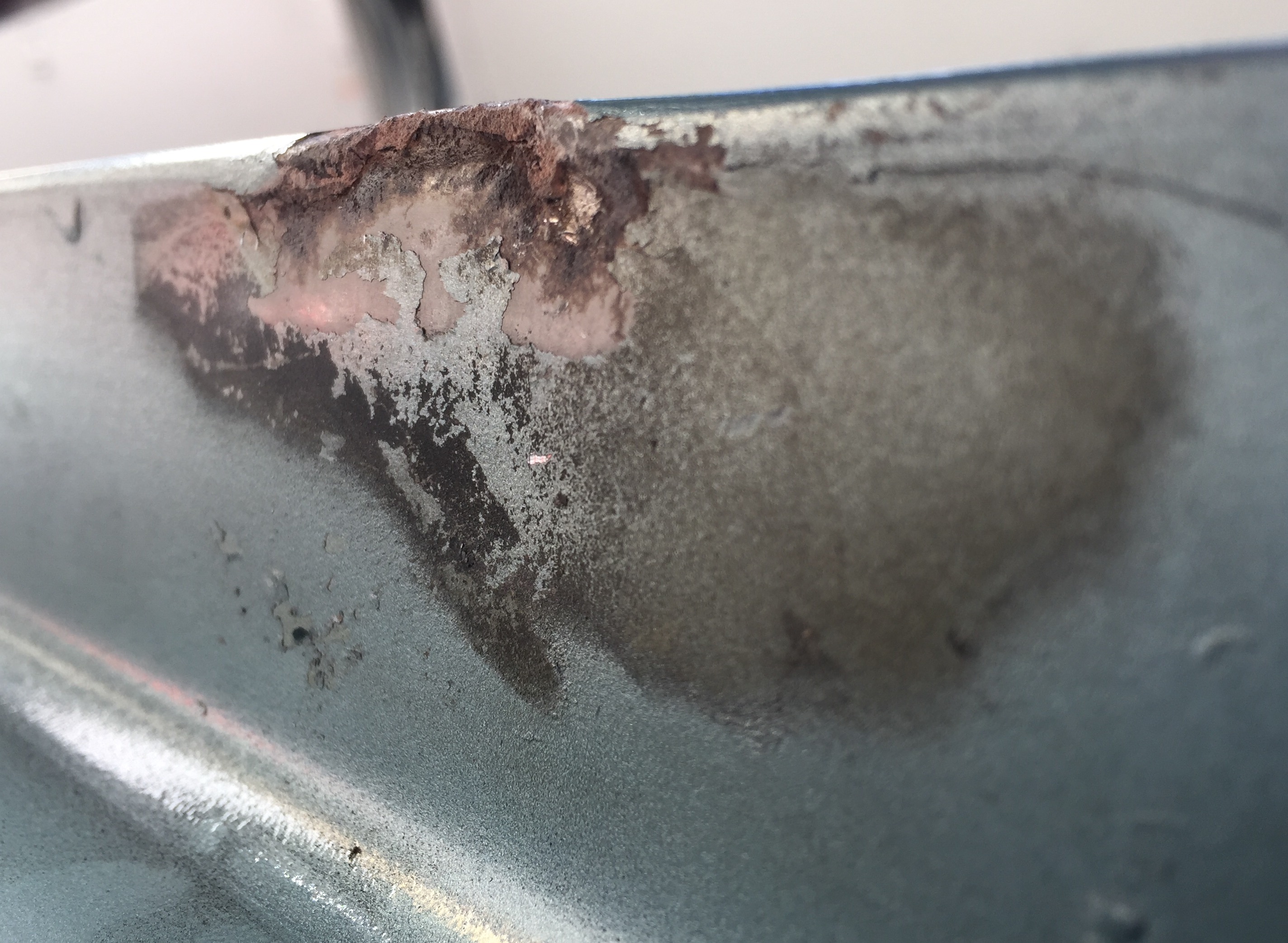

Some garage time this afternoon.
Started prepping trunk area. Removed a chunk of JB weld from trunk I patched
years ago. Needless to say hole enlarged. Learned my lesson. So cut out around it.
This will get a patch.
Dion

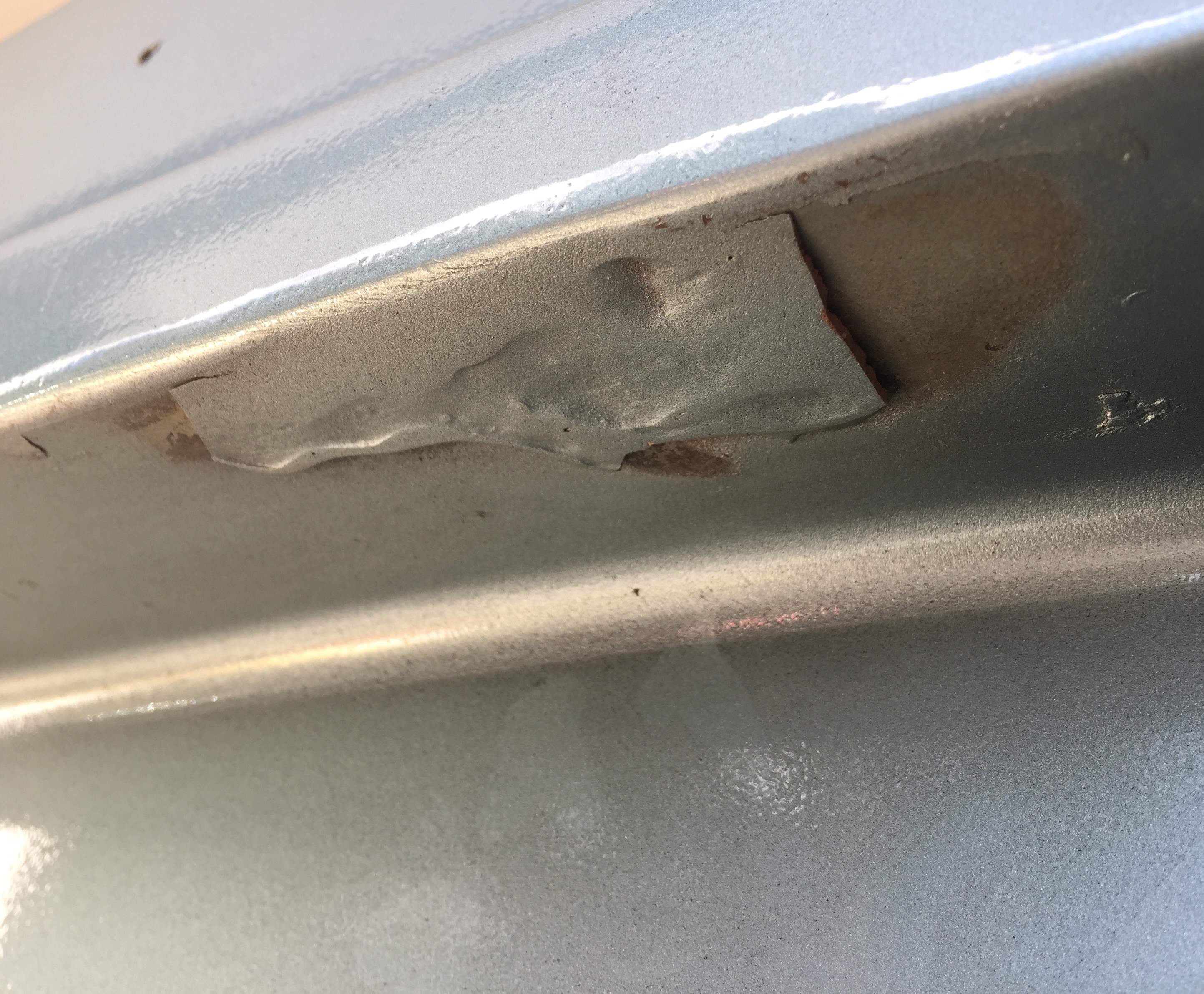

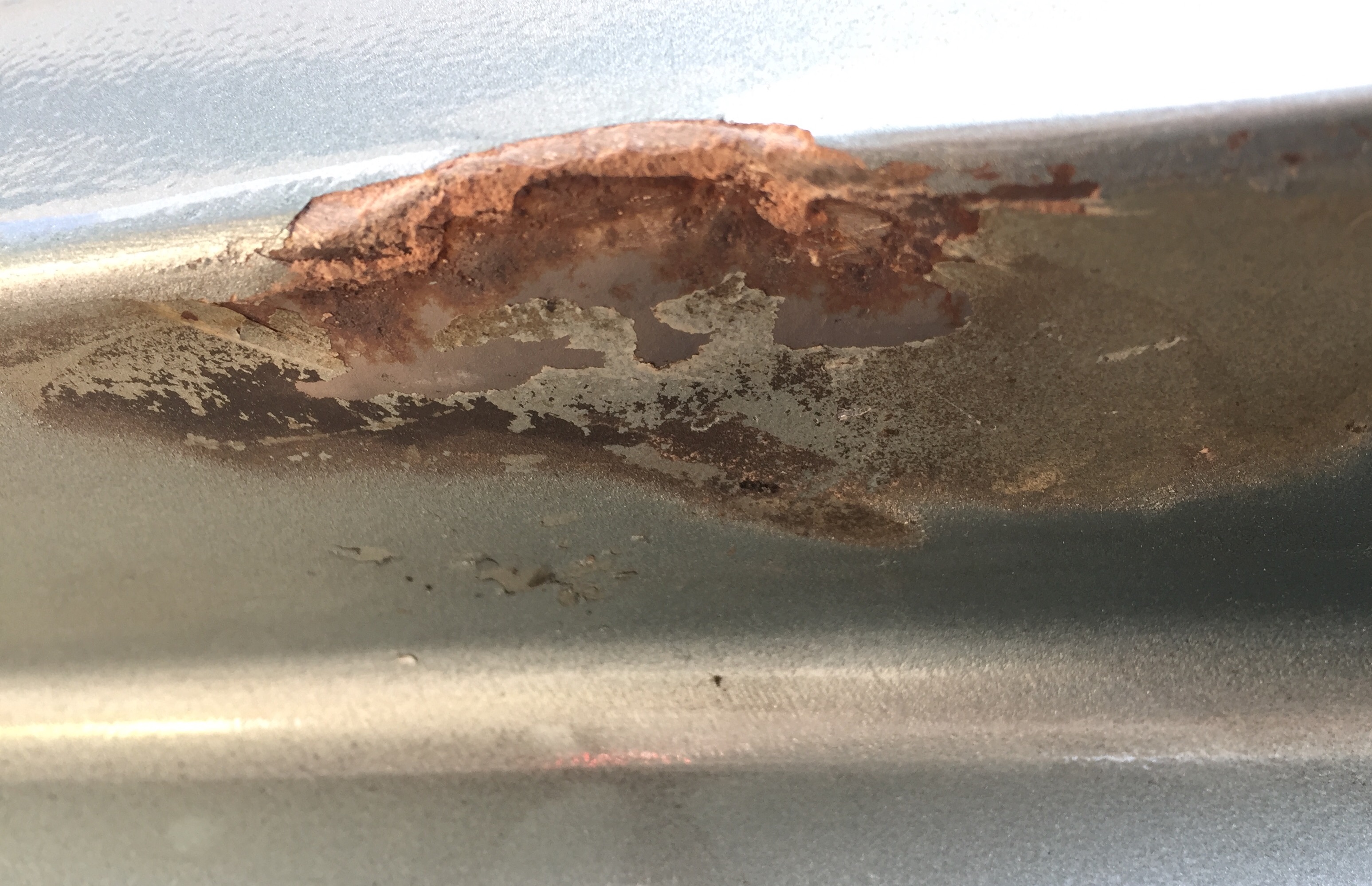

Also some body filler escaped proper contouring from way back in 2004.
Popped it off to find a strange upward dent. No idea how
that would ever happen since it behind the rubber cap of bumper top.
So hammered it back to more appropriate shape.

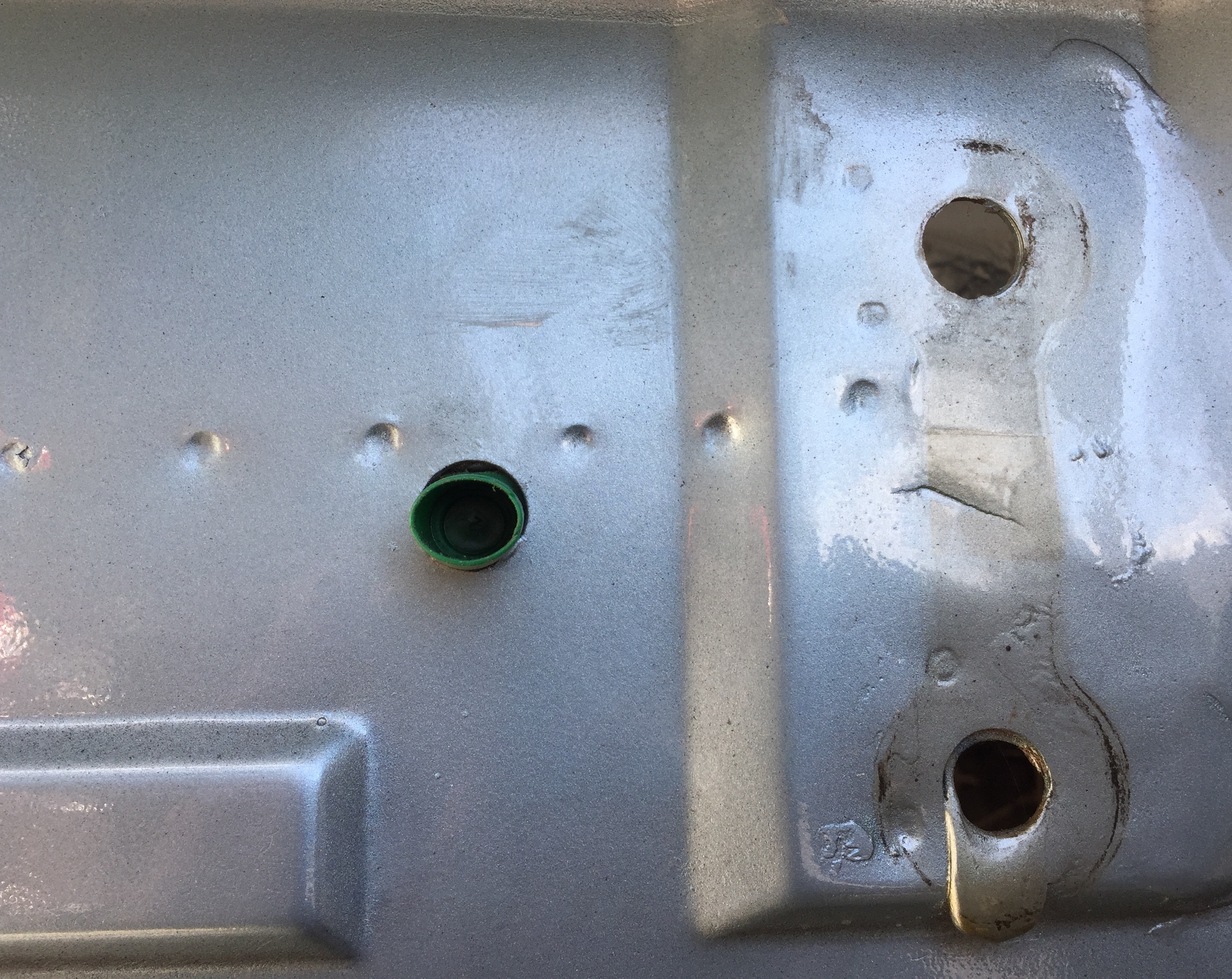

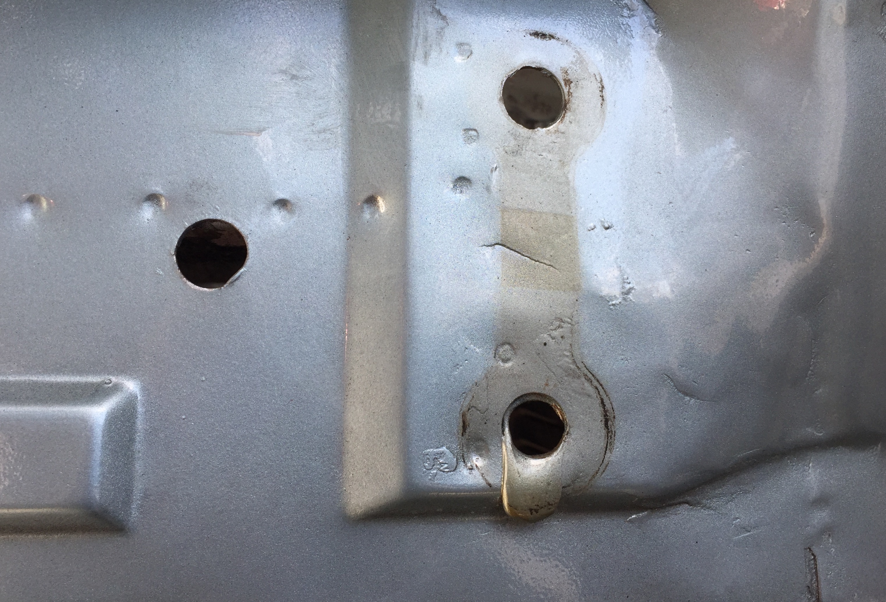

Curious? Anyone have a "proper" hole on right side of rear of car near bumper mounts?
Looks like it's a mirror placement for tow eye bolt on left minus the tube and bracing.
Dion
post Jan 26 2017, 04:32 PM
Post #79
RN
Posts: 2,931
Member No.: 2,766
Tow hook spot?
altitude411
post Jan 26 2017, 04:49 PM
Post #80
I drove my 6 into a tree
Posts: 1,306
Joined: 21-September 14
From: montana
Member No.: 17,932
QUOTE(Dion @ Jan 26 2017, 03:31 PM) *
Yes. SOP
