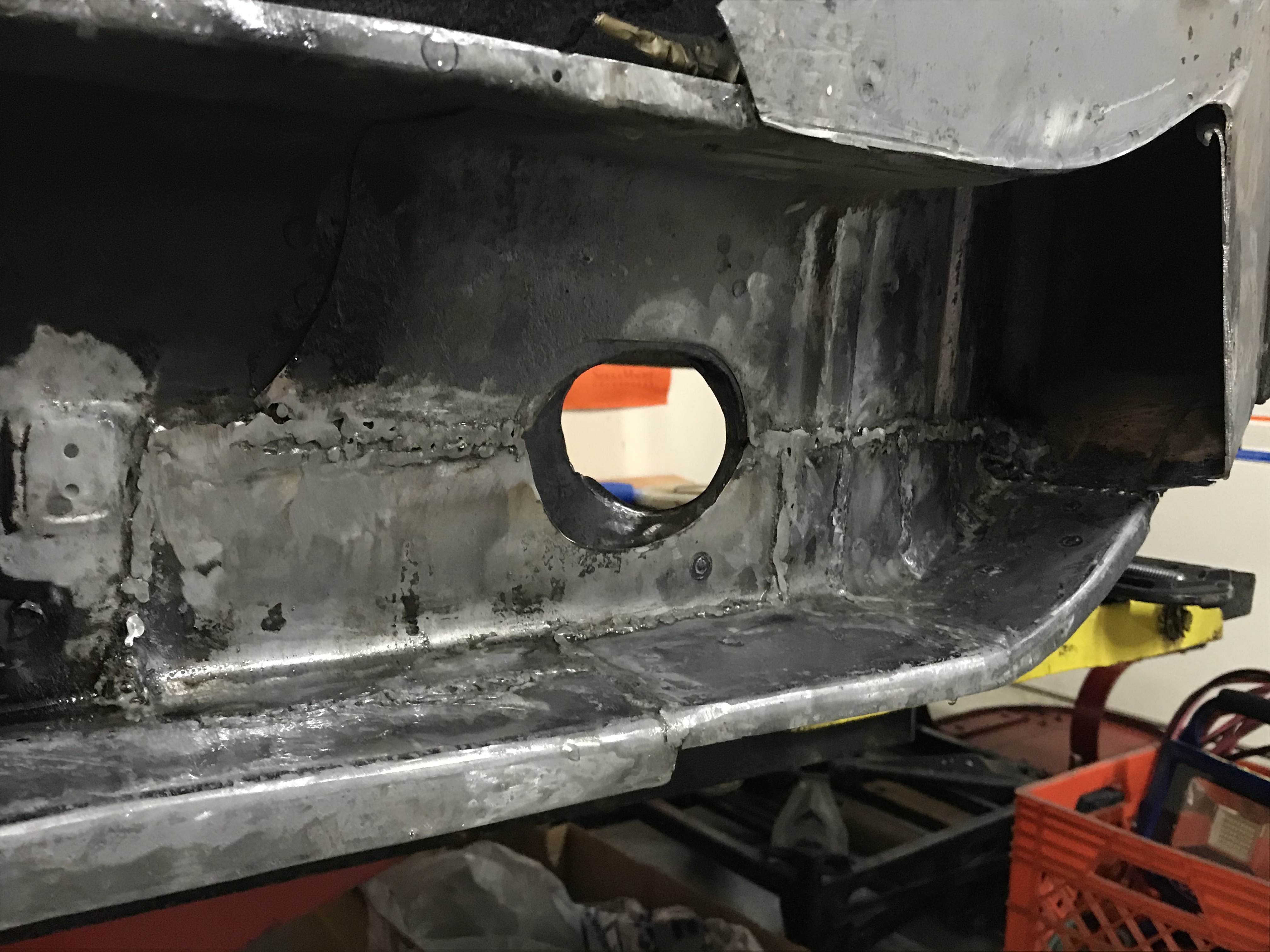

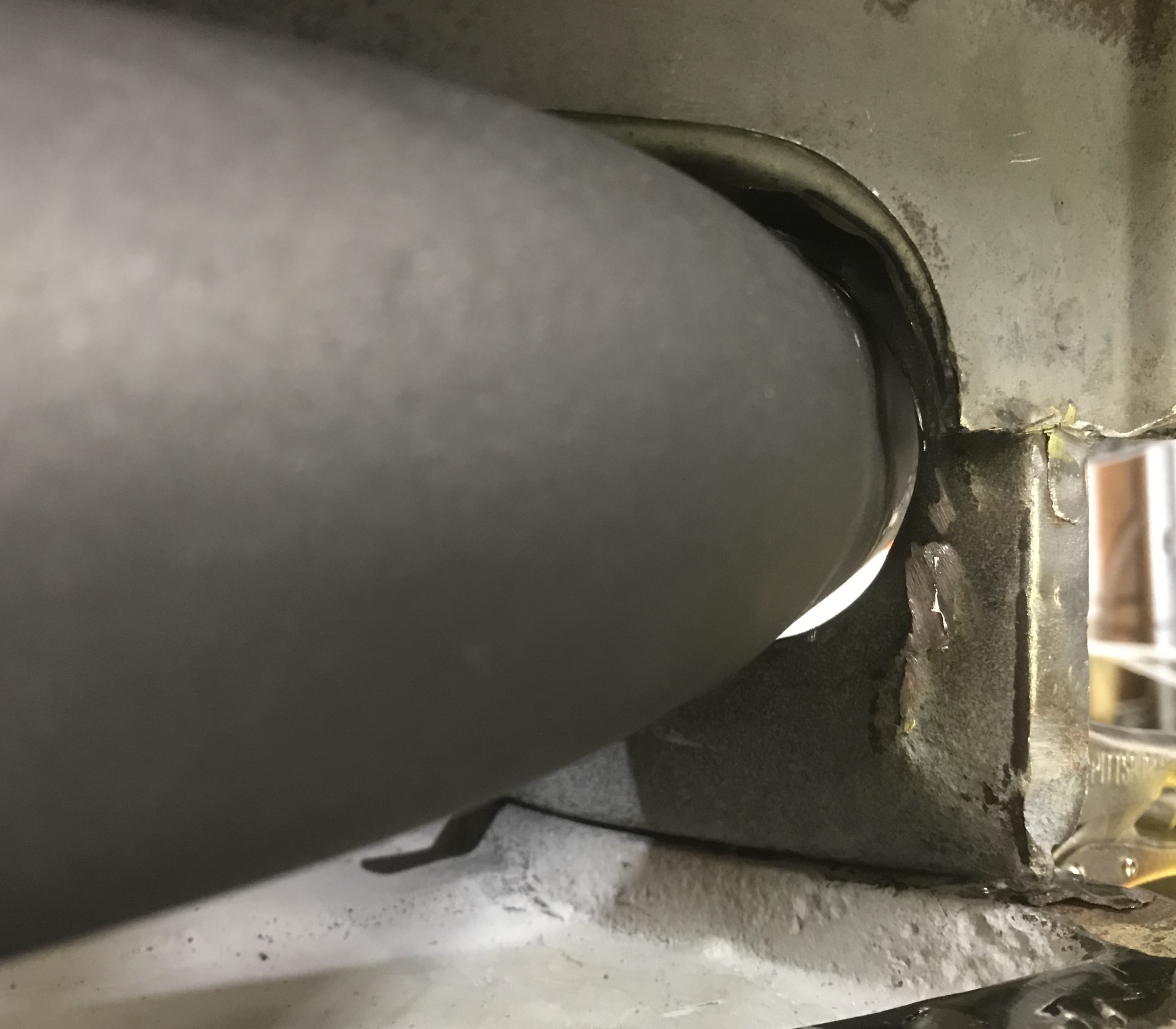

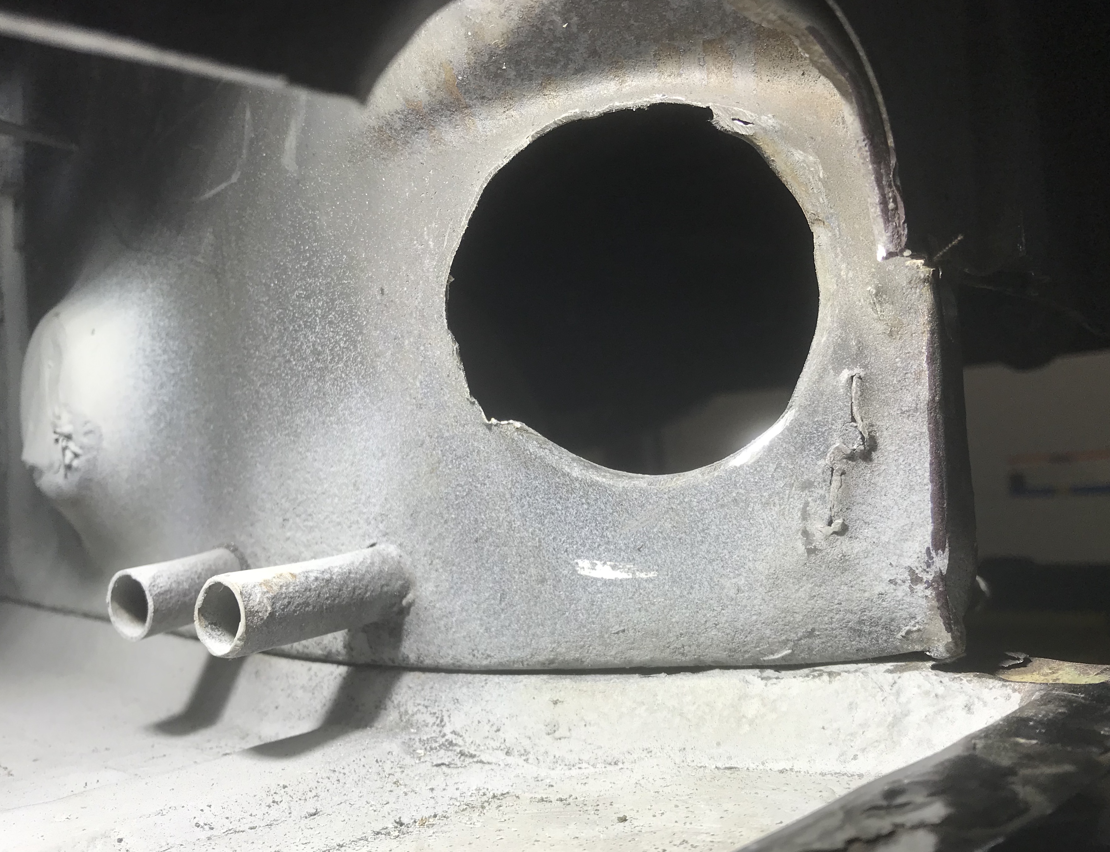

Finally found time to get back on the 914 project. Distracted by my sons 944. It needed new injectors and motor mounts. So that is finished, back to this P-car.
Tackled the opening for the heater tube coming from the engine bay.
Not exciting but needed to be done. Cleaned up the firewall opening a little from the seam sealer that was gooped all around and then made a paper template of the area I needed to open on the new metal.
Dion
post Mar 25 2020, 06:25 PM
Post #603
RN
Posts: 2,935
Joined: 16-September 04
From: Shepherdstown, WV
Member No.: 2,766

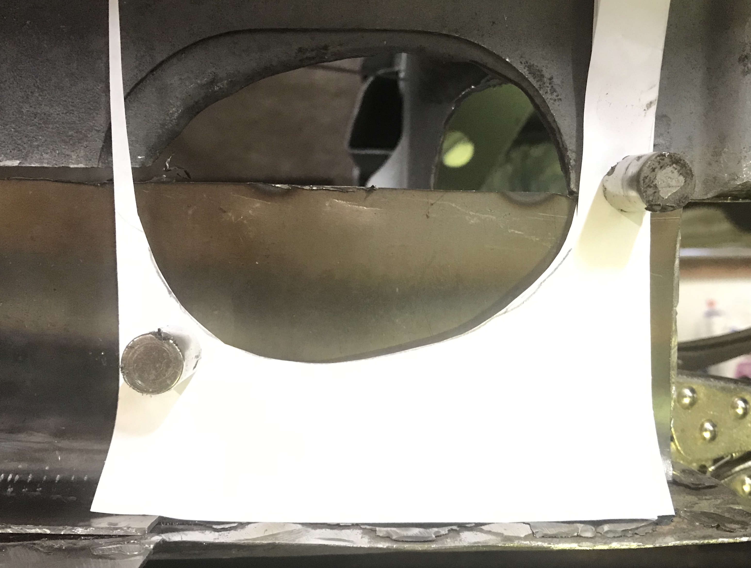

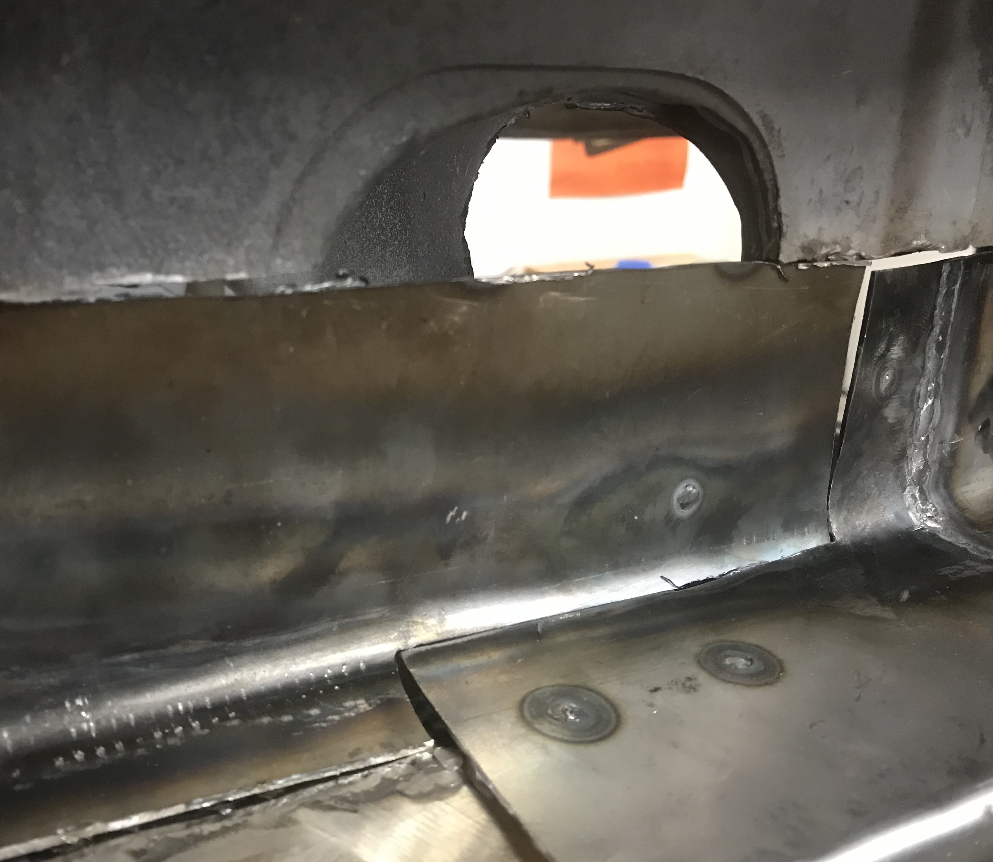

Paper template & test fit of heat tube.

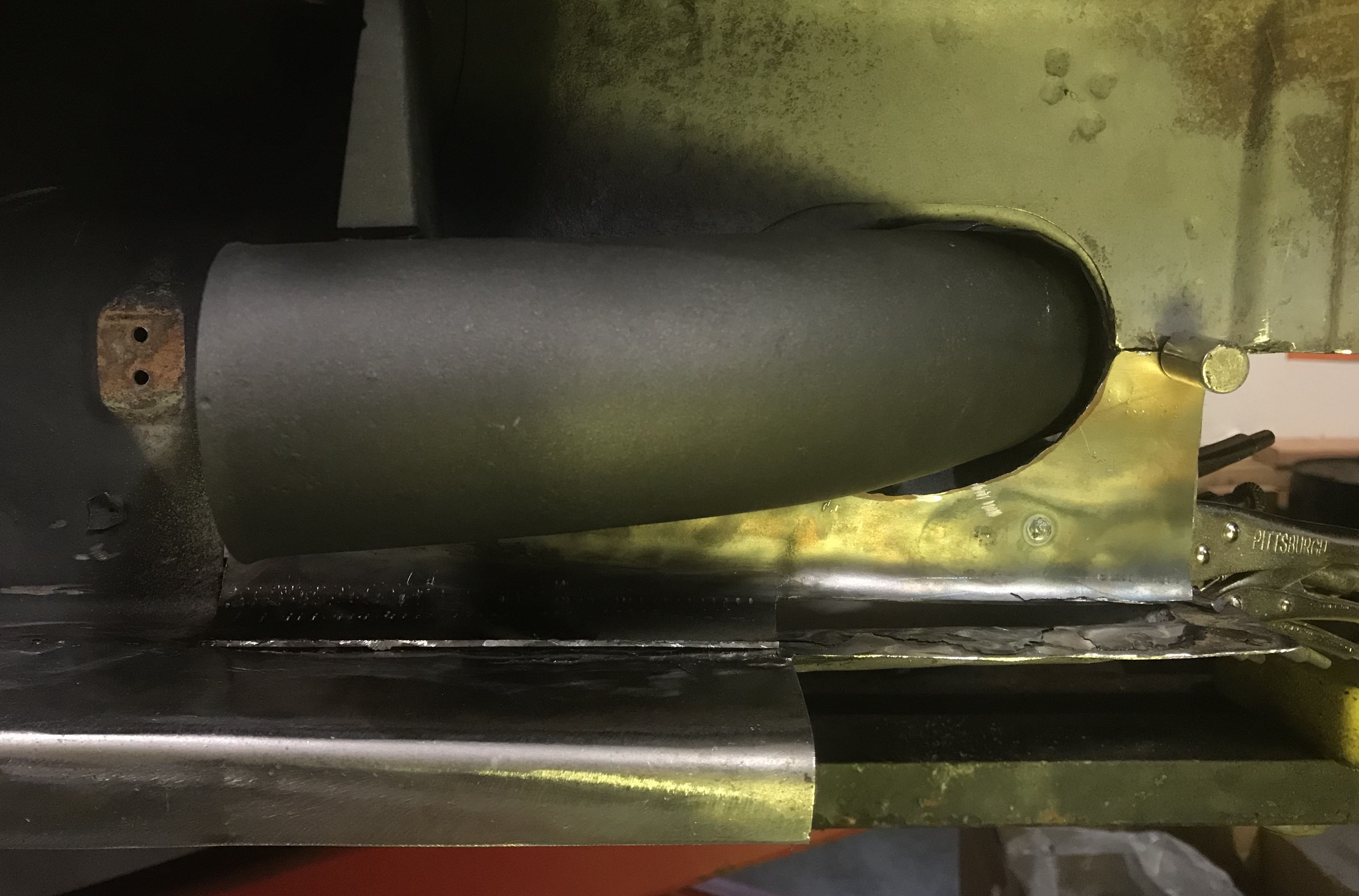

Dion
post Mar 25 2020, 06:26 PM
Post #604
RN
Posts: 2,935
Member No.: 2,766

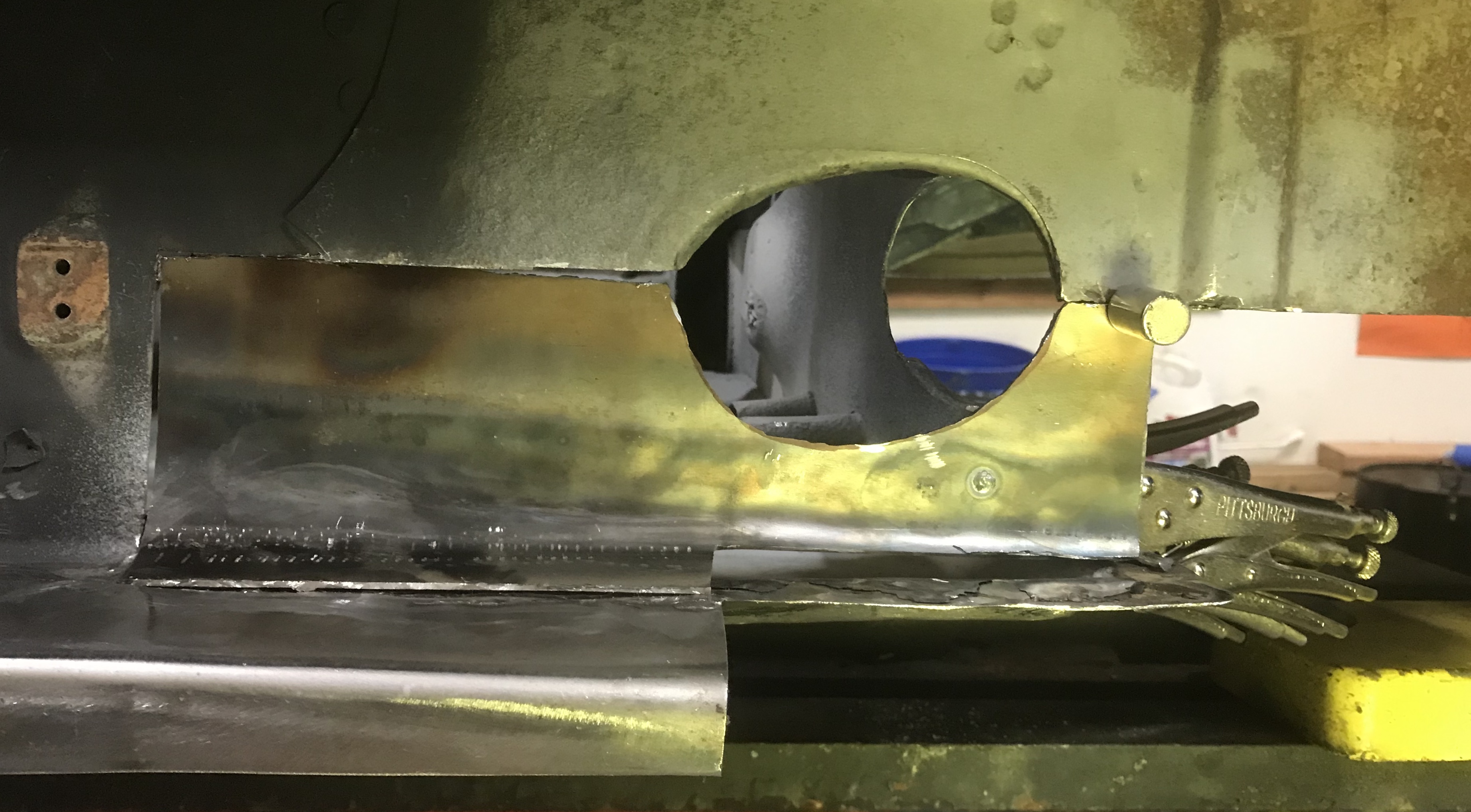

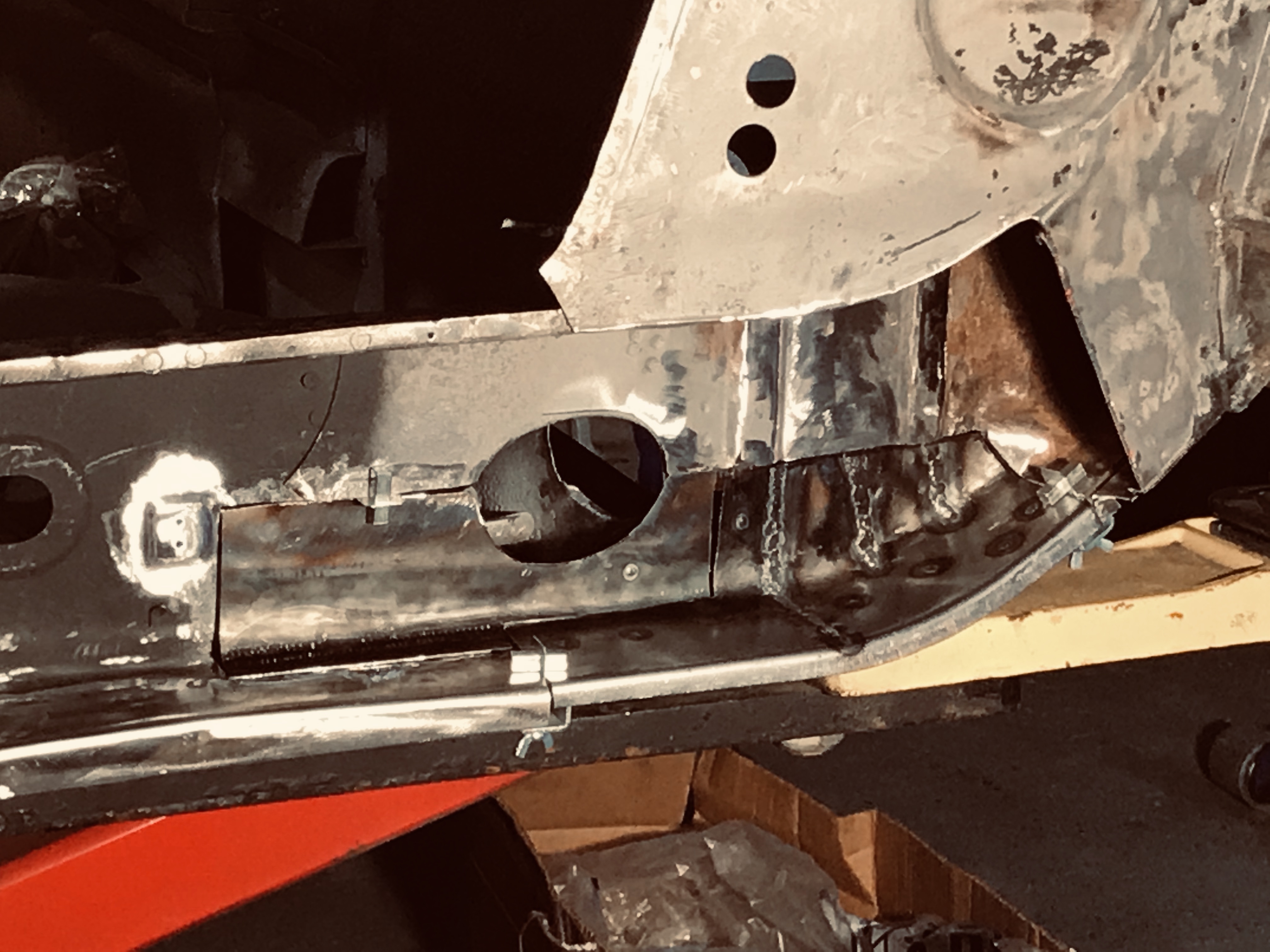

Cut complete and fitting.

Up next :Ready for tack welding of the metal to the long. Stay tuned.

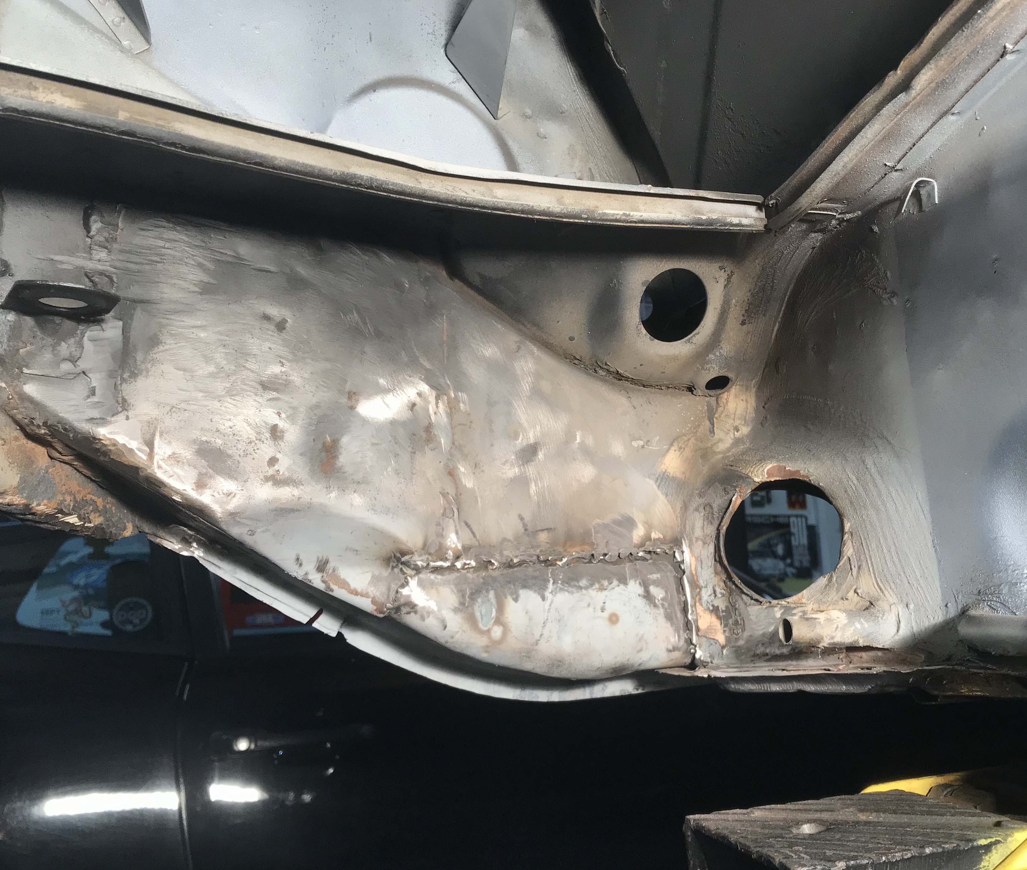

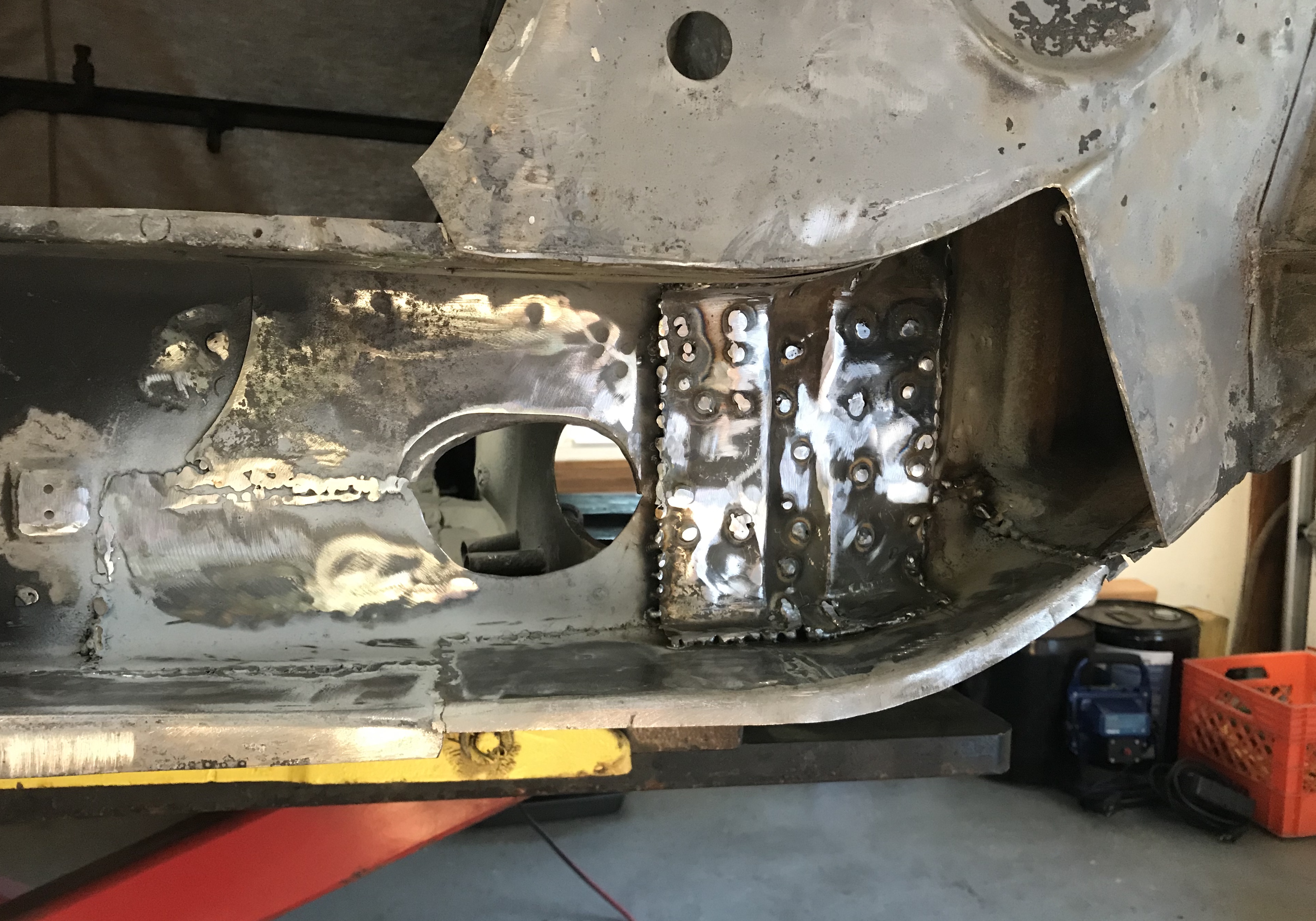

Covid be damned! So while my PACU is being converted to an ICU unfortunately, I have some time to be at home and work on 14.
Welded in the new metal that was previously test fitted.
Dion
post Apr 5 2020, 08:42 AM
Post #609
RN
Posts: 2,935
Member No.: 2,766

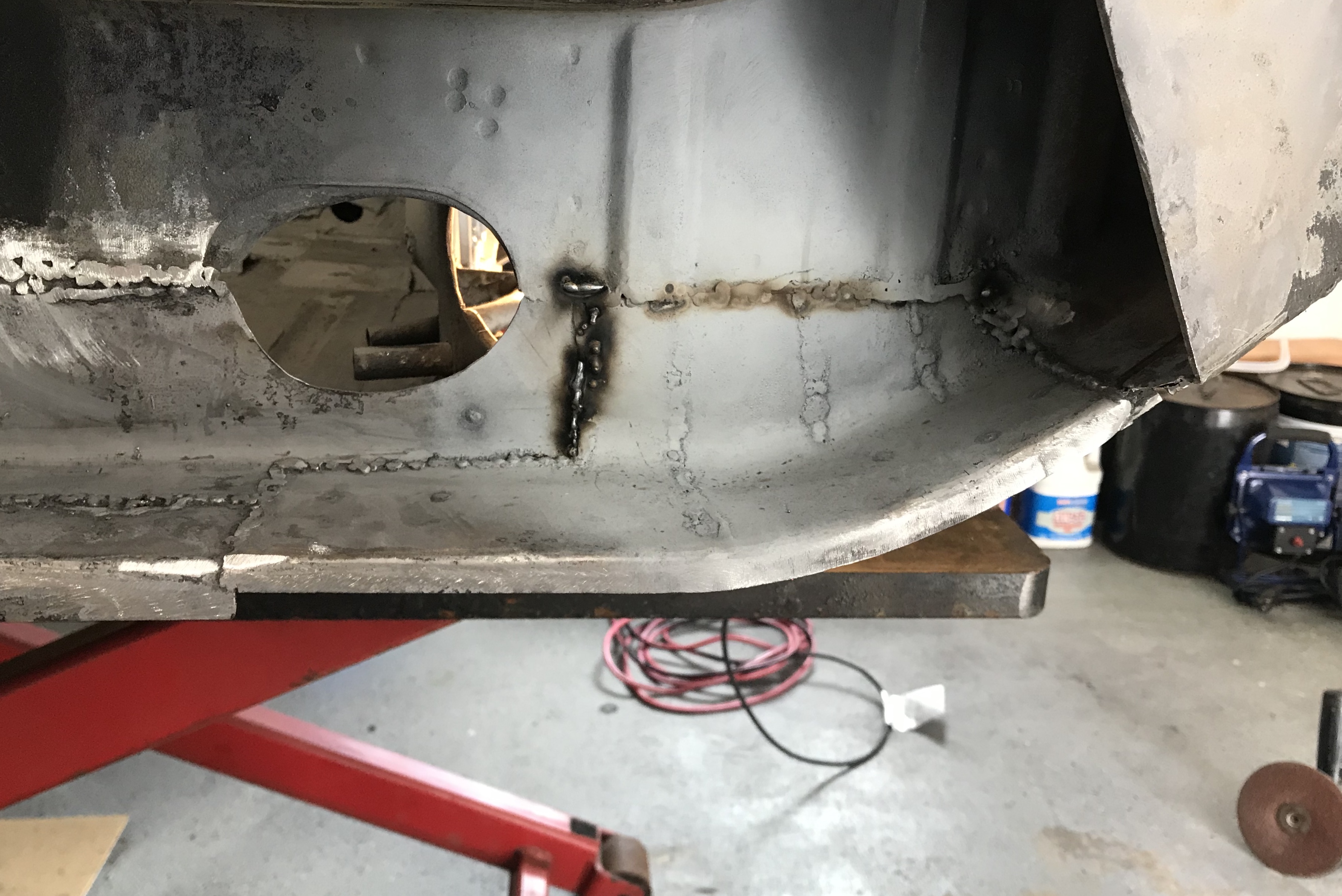

Weld

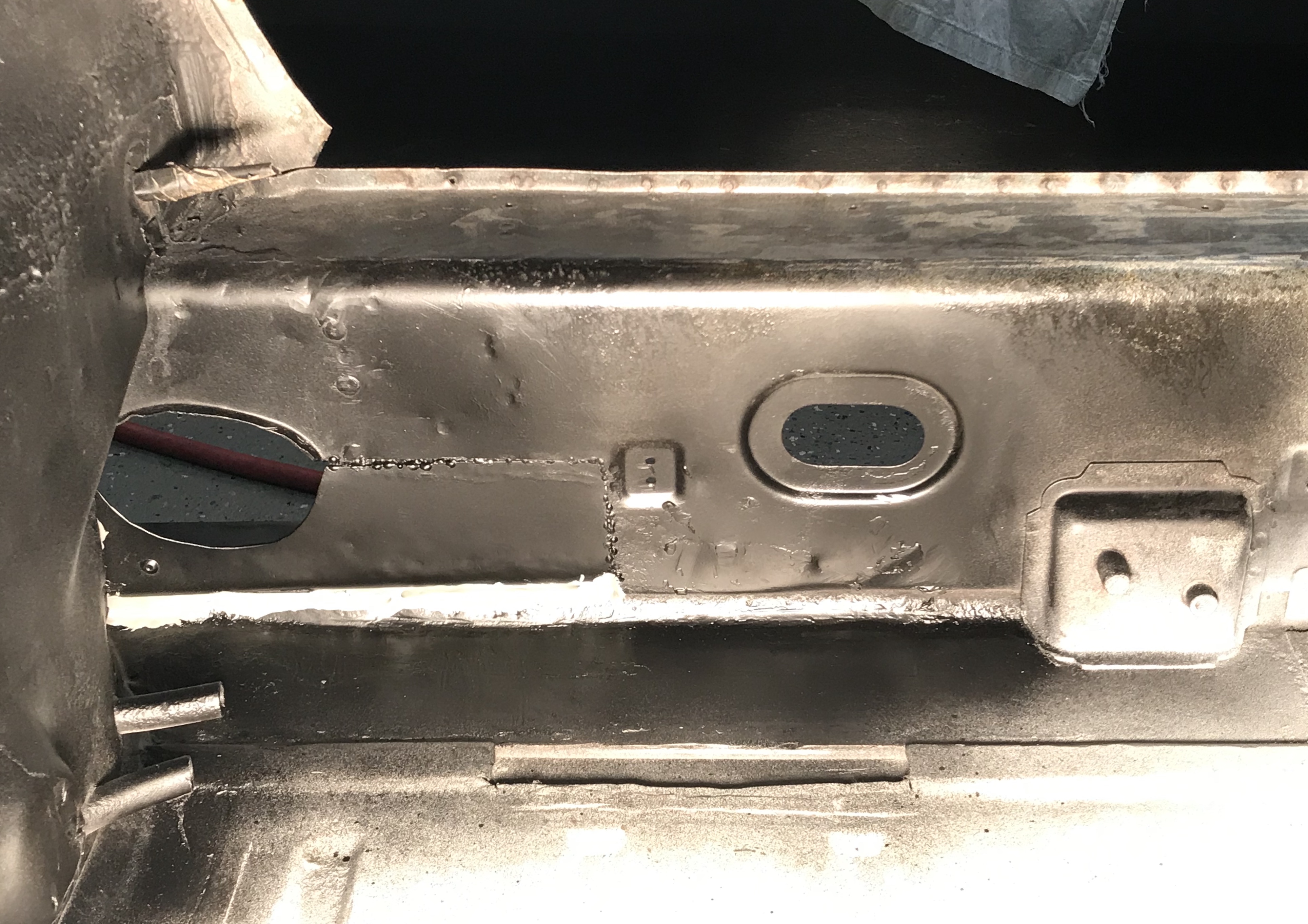

Weld and acid etched
Dion
post Apr 5 2020, 08:48 AM
Post #611
RN
Posts: 2,935
Member No.: 2,766

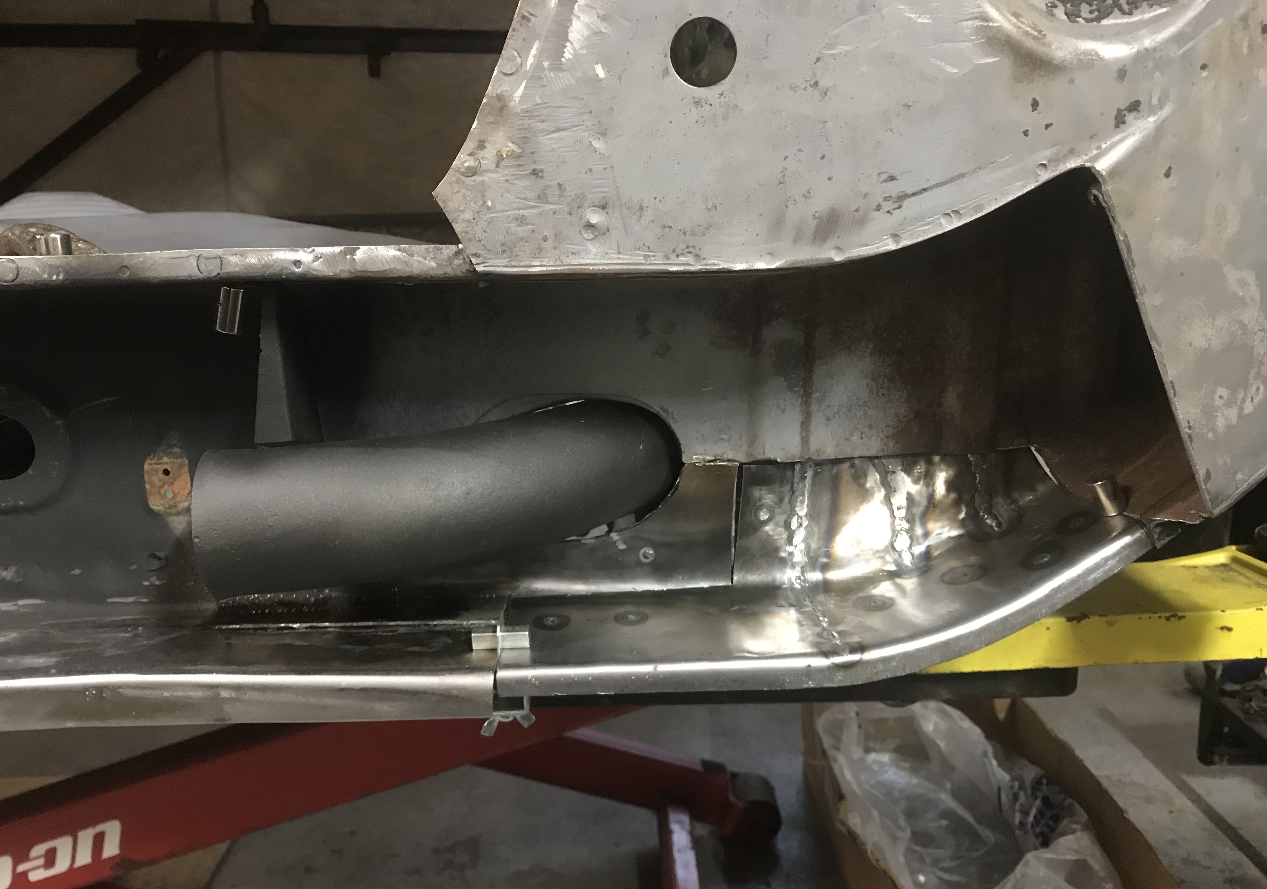

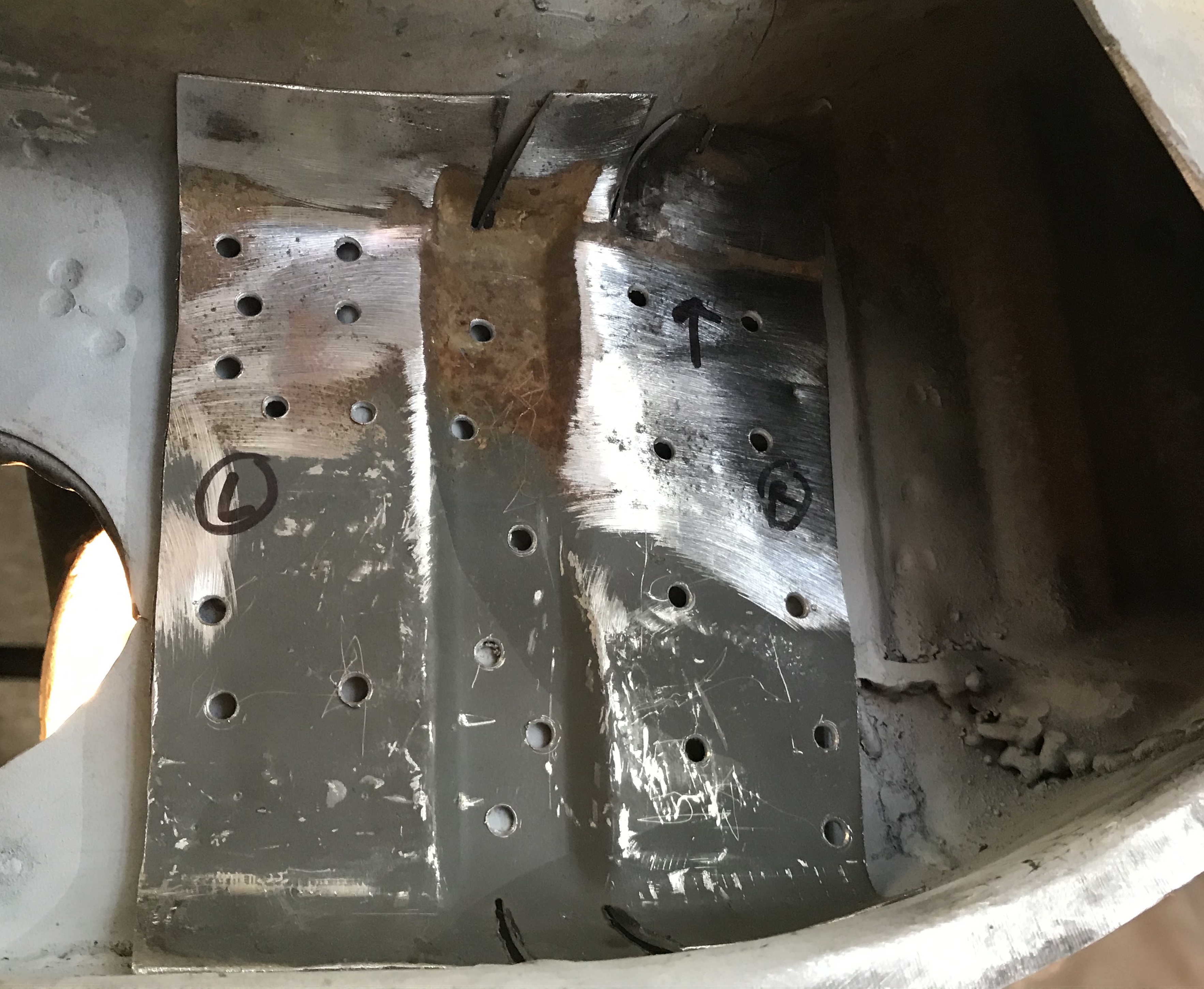

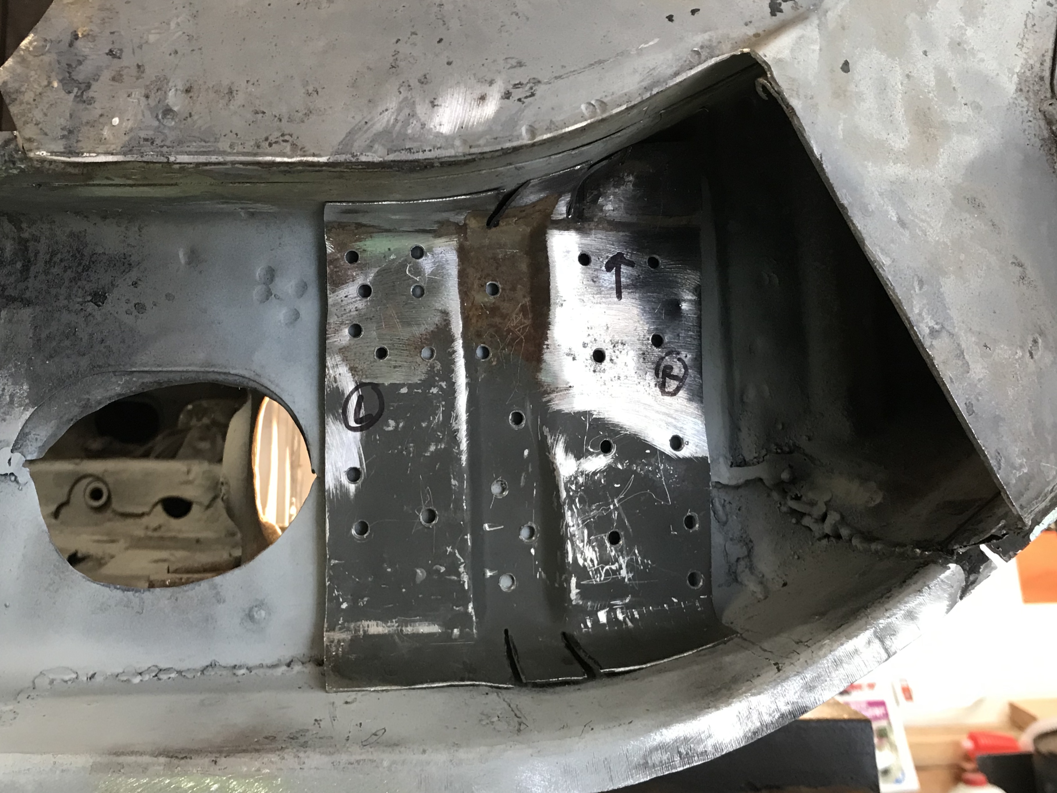

Formed a metal plate for the “sleeve” on this area for re-enforcement.
Dion
post Apr 5 2020, 08:49 AM
Post #612
RN
Posts: 2,935
Member No.: 2,766
Plug and seam welded

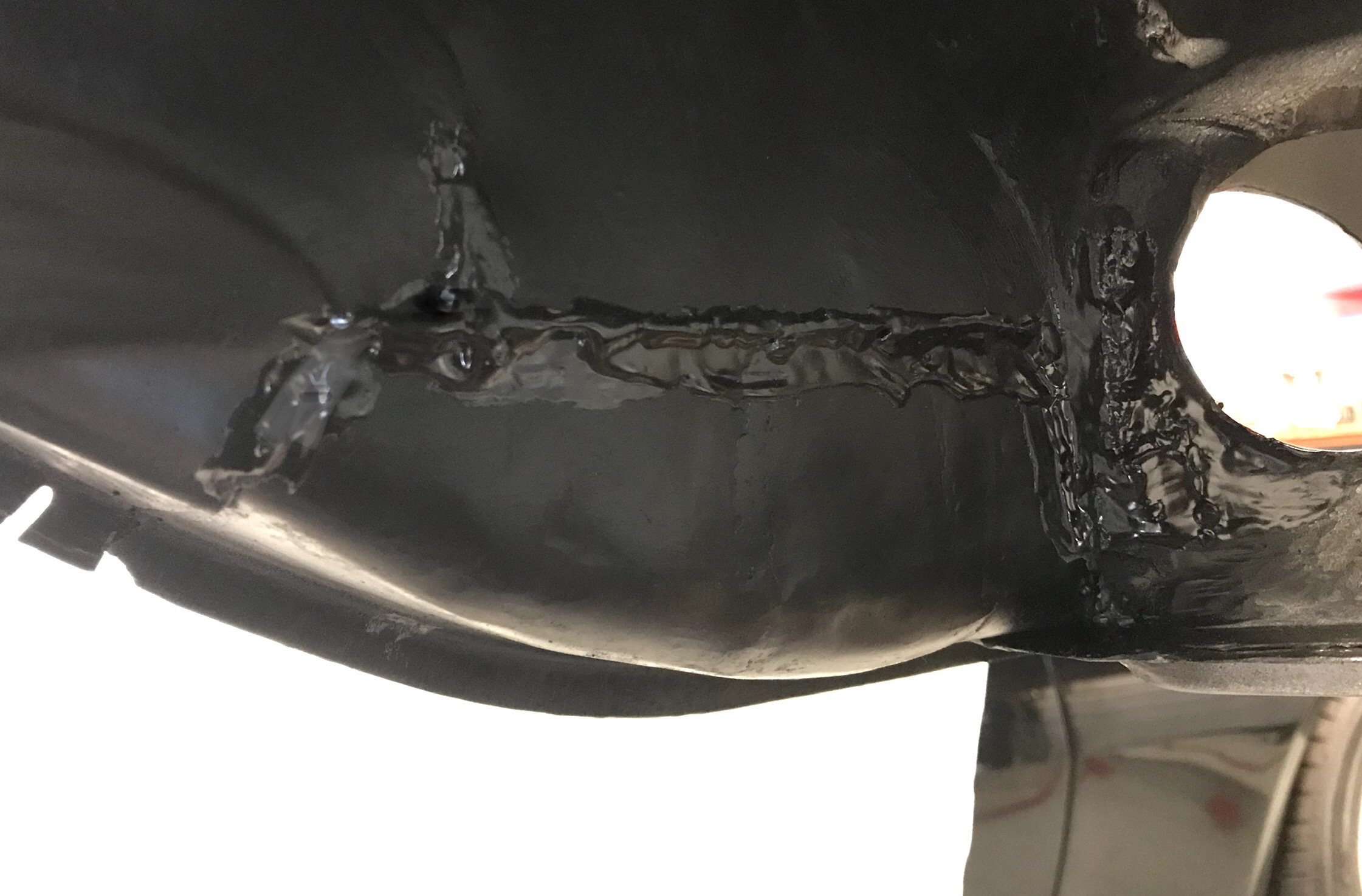

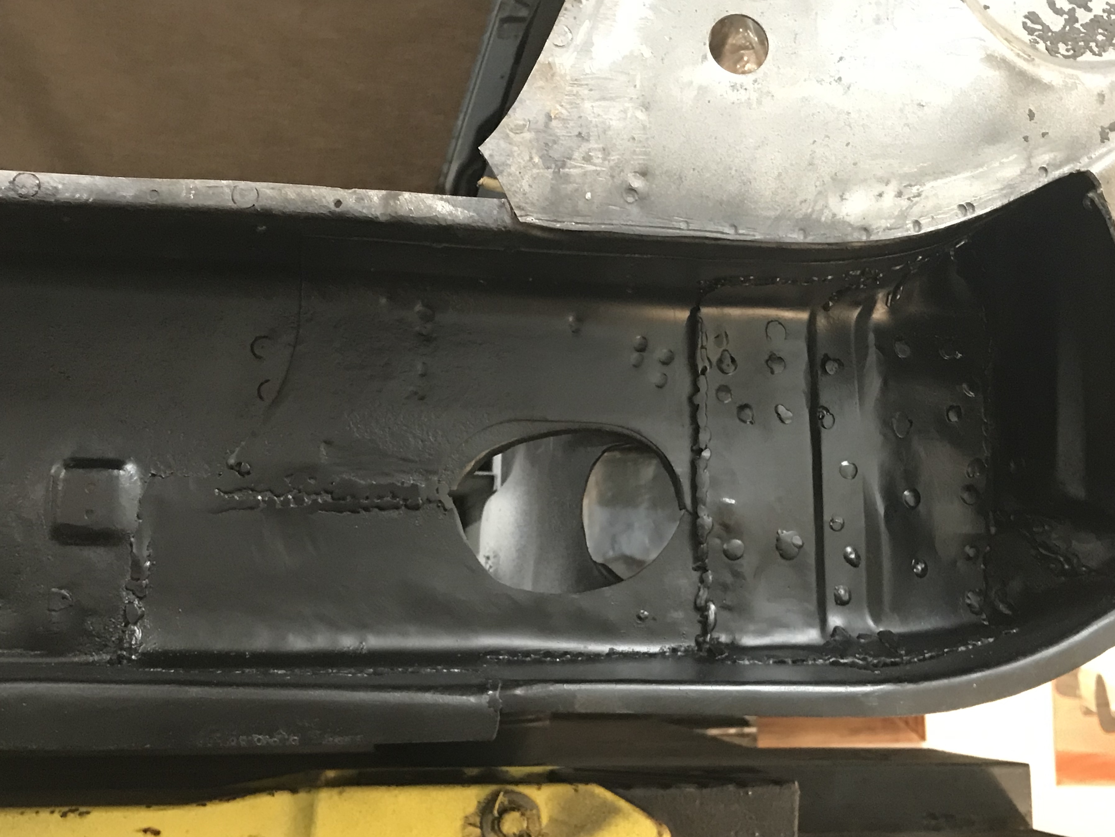

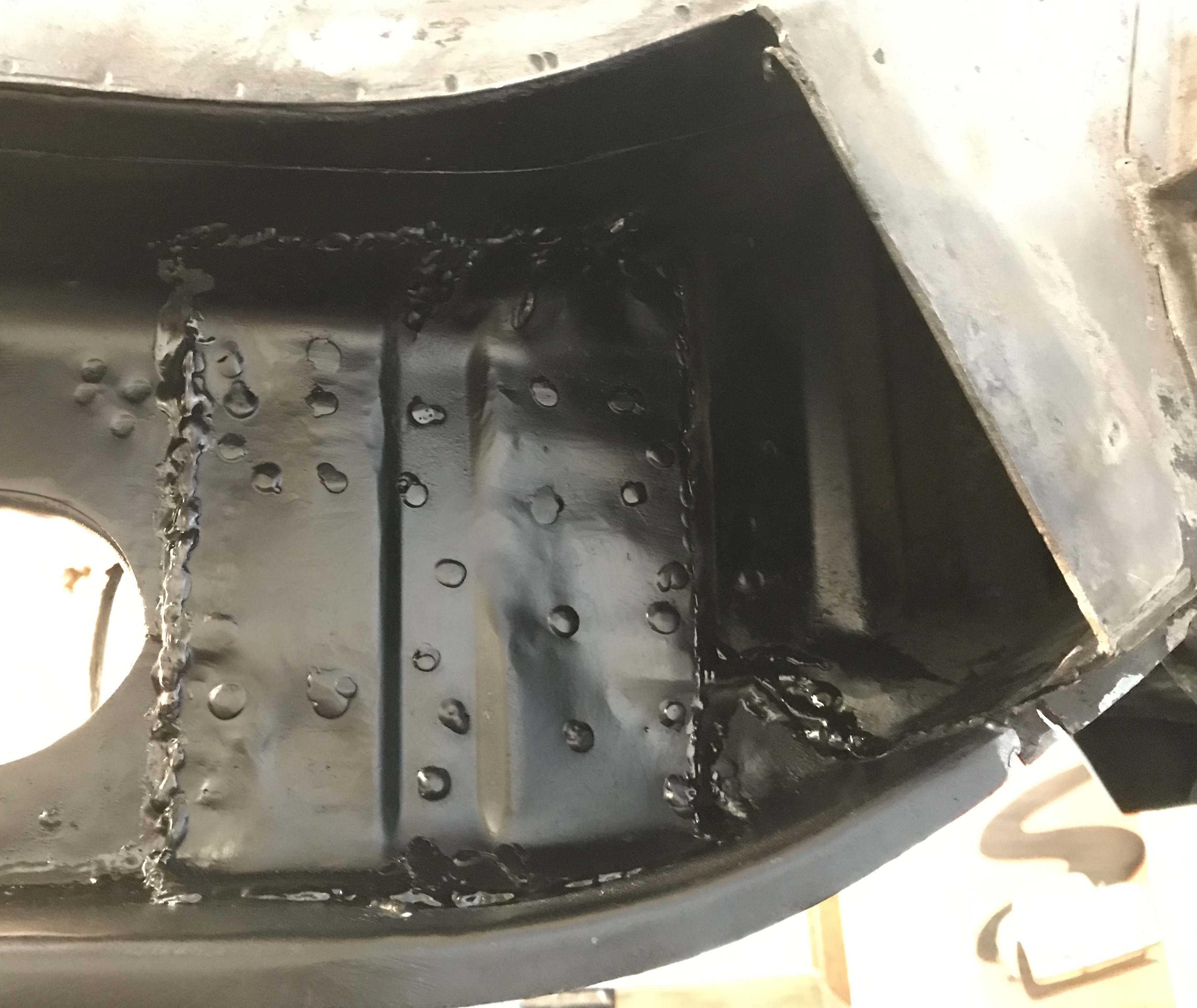

Etch prime & seam sealed.
Dion
post Apr 5 2020, 08:53 AM
Post #614
RN
Posts: 2,935
Member No.: 2,766
Etched prime & seam sealed engine side. No water allowed EVER! (IMG:style_emoticons/default/biggrin.gif)
Dion
post Apr 5 2020, 08:55 AM
Post #615
RN
Posts: 2,935
Member No.: 2,766
Interior portion. Still need to add seatbelt re-enforcer plate and bolt.
Also have “jack donut” to add as well. All in due time.

Love it! (IMG:style_emoticons/default/smilie_pokal.gif) (IMG:style_emoticons/default/welder.gif) Did you spray that with something before the last pic? Why does it look so clean? Nice work!
Dion
post Apr 5 2020, 10:11 AM
Post #618
RN
Posts: 2,935
Member No.: 2,766
QUOTE(bbrock @ Apr 5 2020, 08:02 AM) *
Thanks mate! Prolly just the glare from the halogen work lite. It’s just Eastwood’s black
etch primer.
