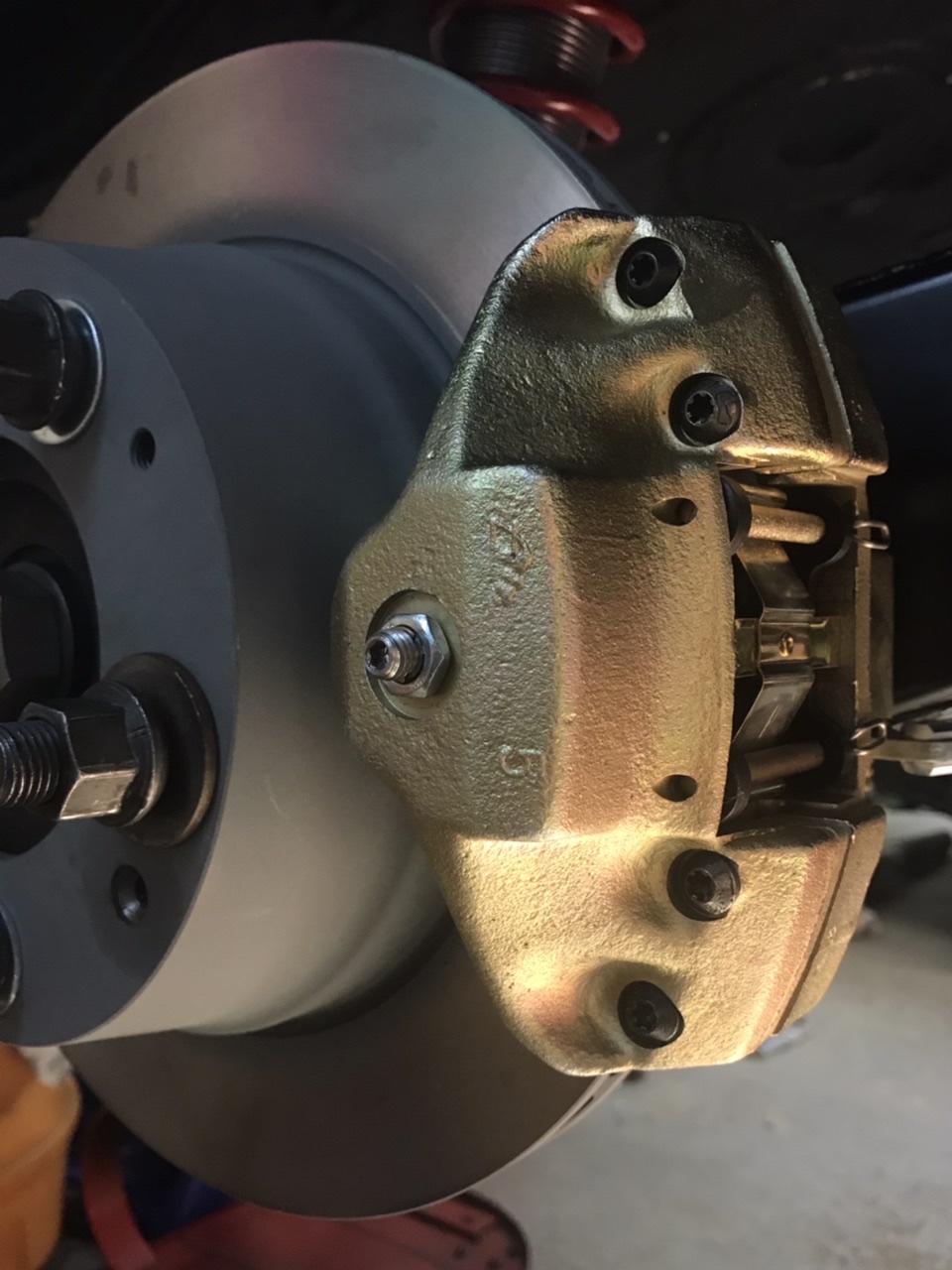

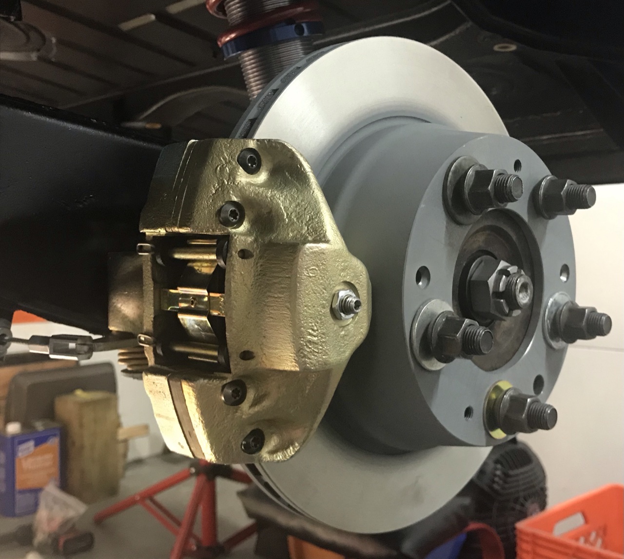

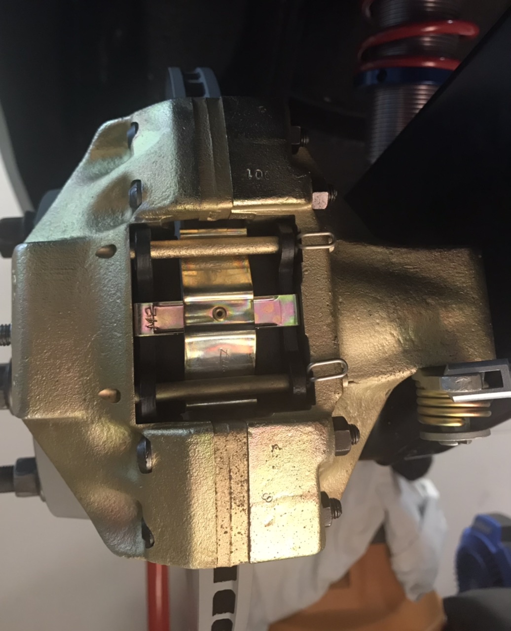

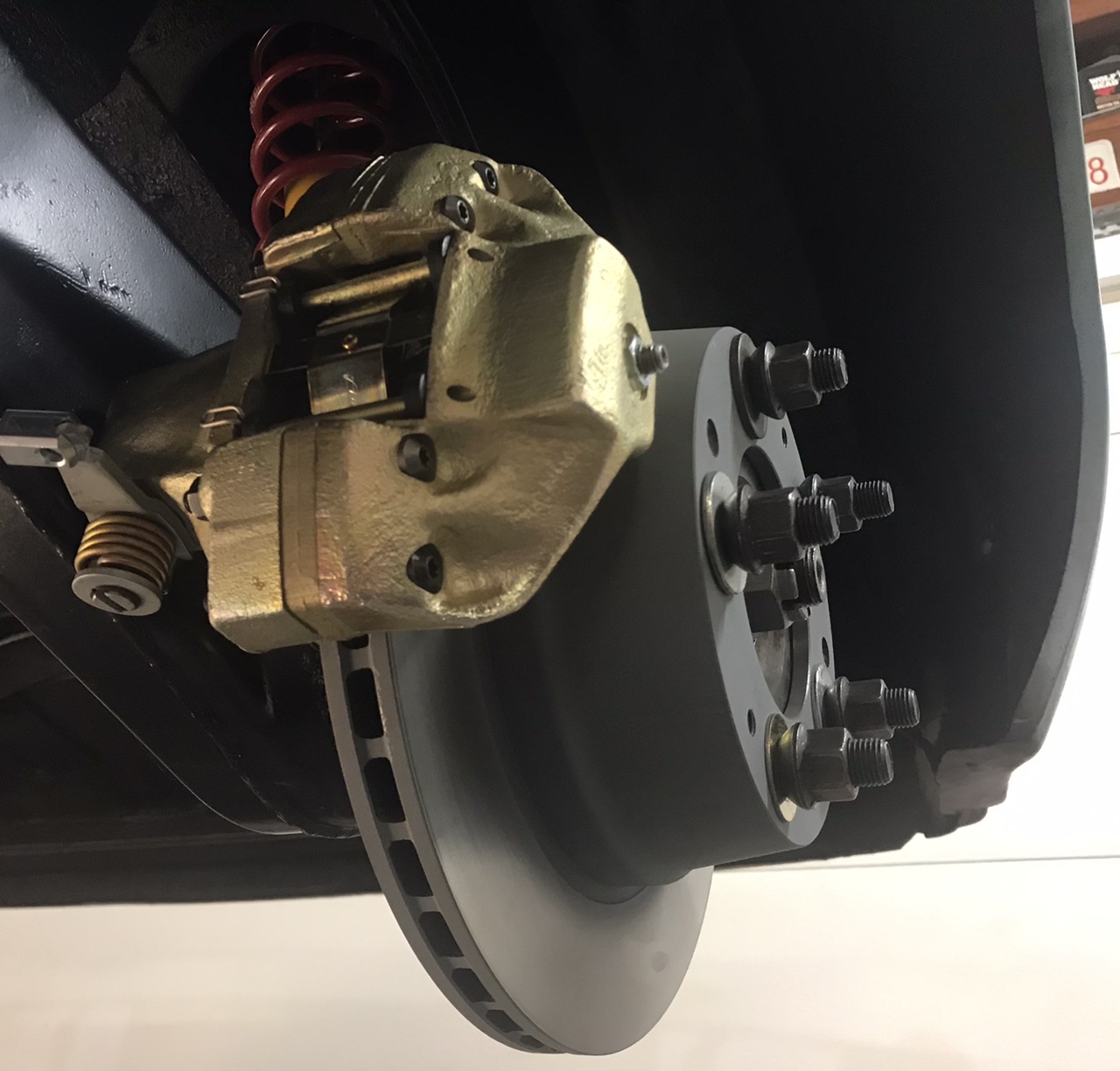

As I was losing my mind, because when I first fitted my rear rotors and rotated them,
they wobbled like the Flintstones jalopy! I was like what the hell! I screwed up the bearing install. My sanity was restored when i contacted Dave who asked “did you torque
the rotor all the way down” .....Ummm no. So after feeling like a Jack-ass. I did. I also went and purchased my first dial indicator. What a cool device! I checked both sides run-out.
Sent a vid to Dave to make sure I was doing this correctly. All checked out. I was within spec. Whew! Thanks @914Dave Always learning.
So then I was able to mount the rear (PMB restored (IMG:style_emoticons/default/biggrin.gif) ) GT calipers. Owe Mark ( @mepstein ) a debt of gratitude for allowing me to purchase these from him.
Love that fresh factory appearance.
Need to order the soft lines and get some fluid, then... I’m sure the fun will begin.

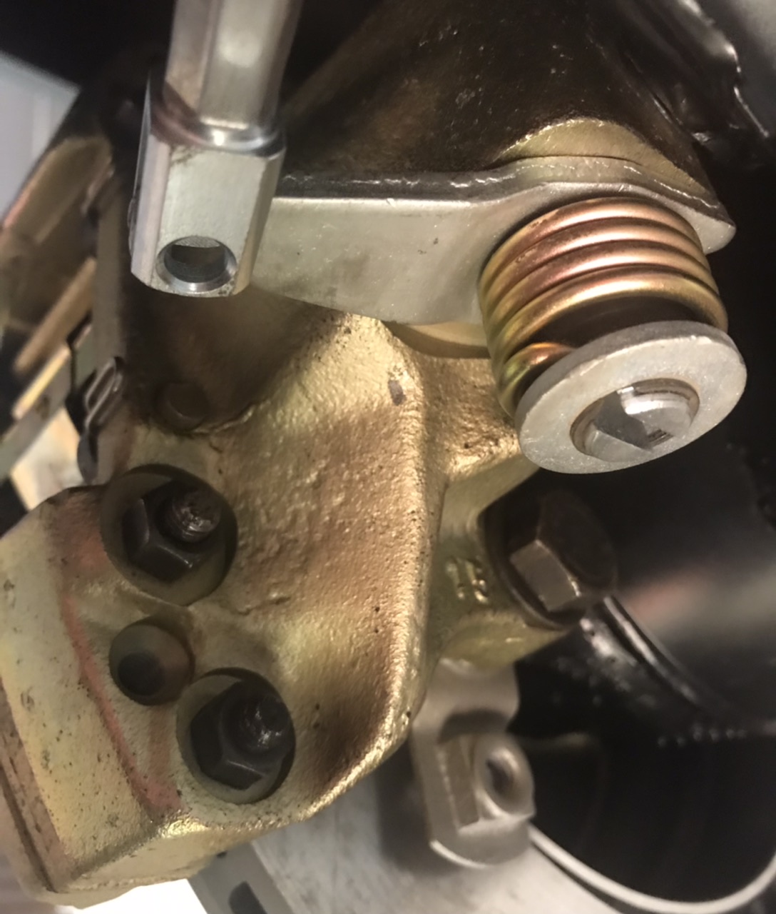

Also need to source the E-brake pins. My previous setup was a nut and bolt.
Anyone have a source? My searches keep showing NLA.
Cheers all.

Dion - I’m pretty sure PMB keeps the pins in stock.

There are little caps that go on the outside (wheel side) adjusters too.
I'm not sure where you get them, just mentioning.

QUOTE(Larmo63 @ Oct 29 2020, 07:22 PM) *
@Larmo63 thanks my friend. I was able to get them from PMB.

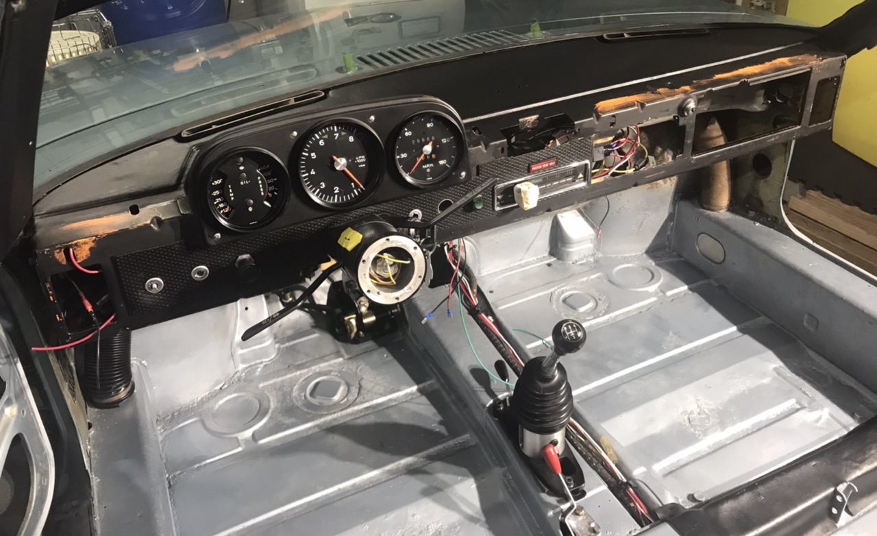

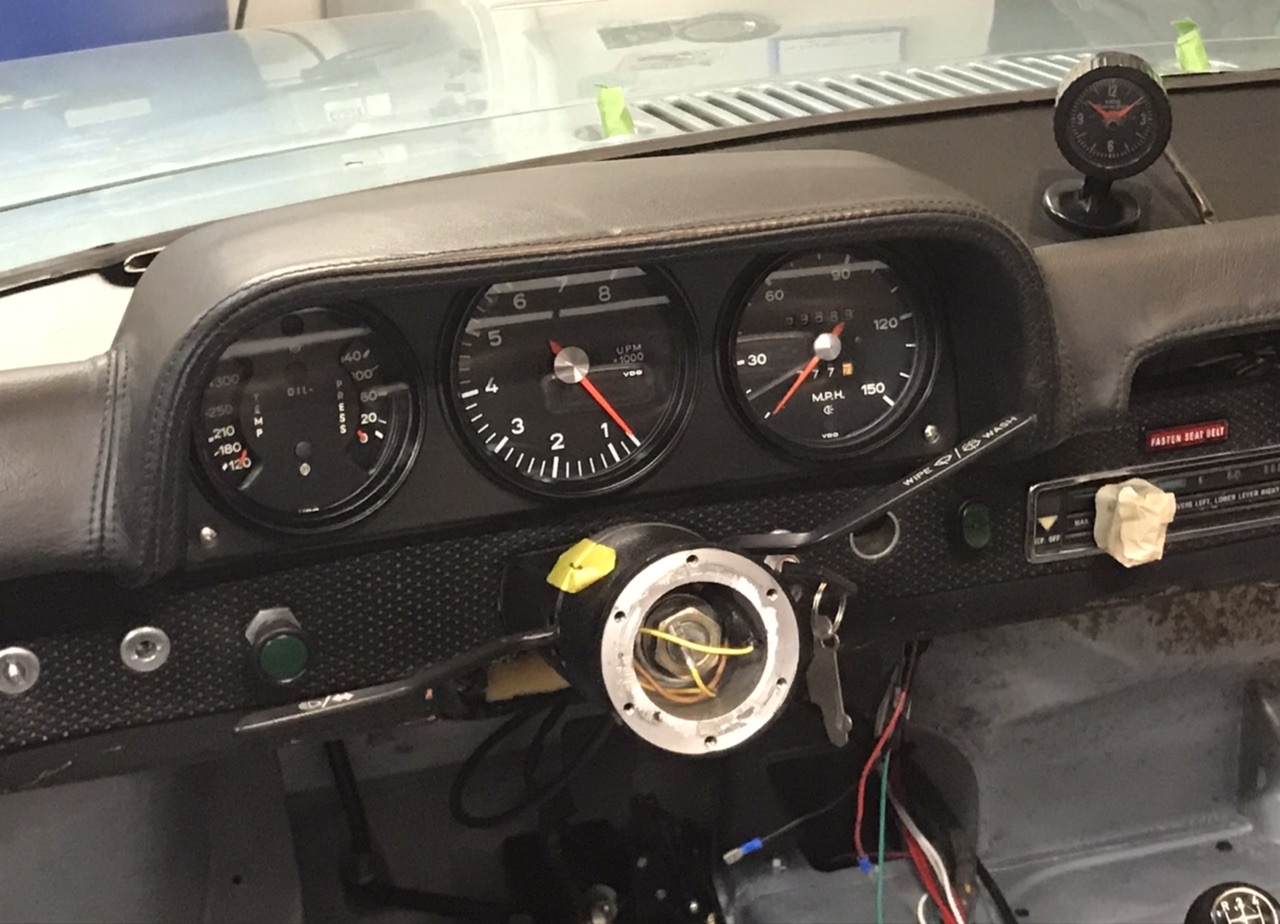

Next up was the gauges and their corresponding wiring. Why is wiring so stressful?
I really hope they all function as they should!! The most challenging was the damn little
trip odometer cable. Don’t know why but is was a bugger to get it to lay proper, so it wouldn’t bind on the dash bulkhead.
Looks like my car received a tangerine colour dash before the black paint went on.

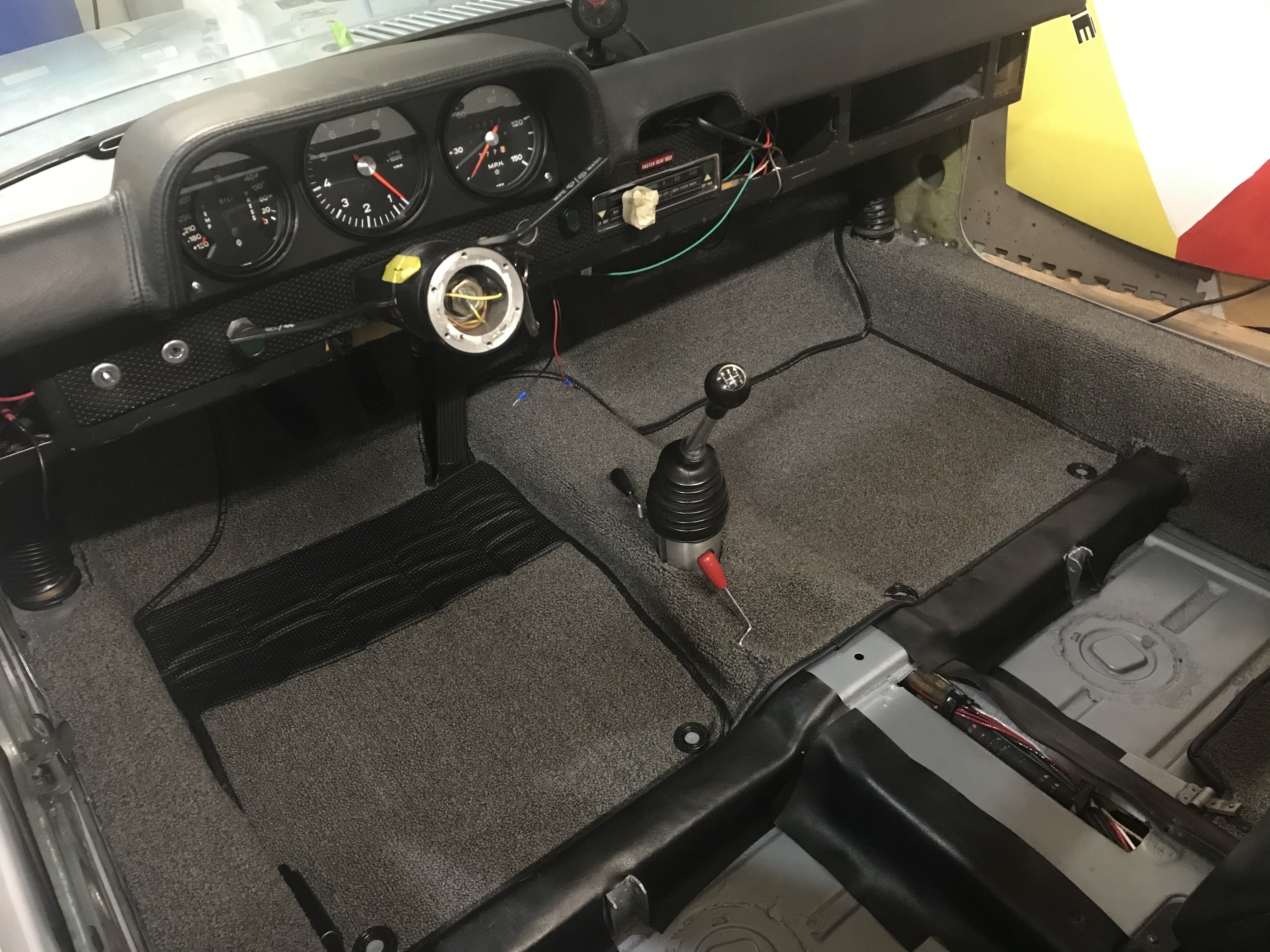

Some German loop carpeting courtesy 914rubber. Charcoal colour.

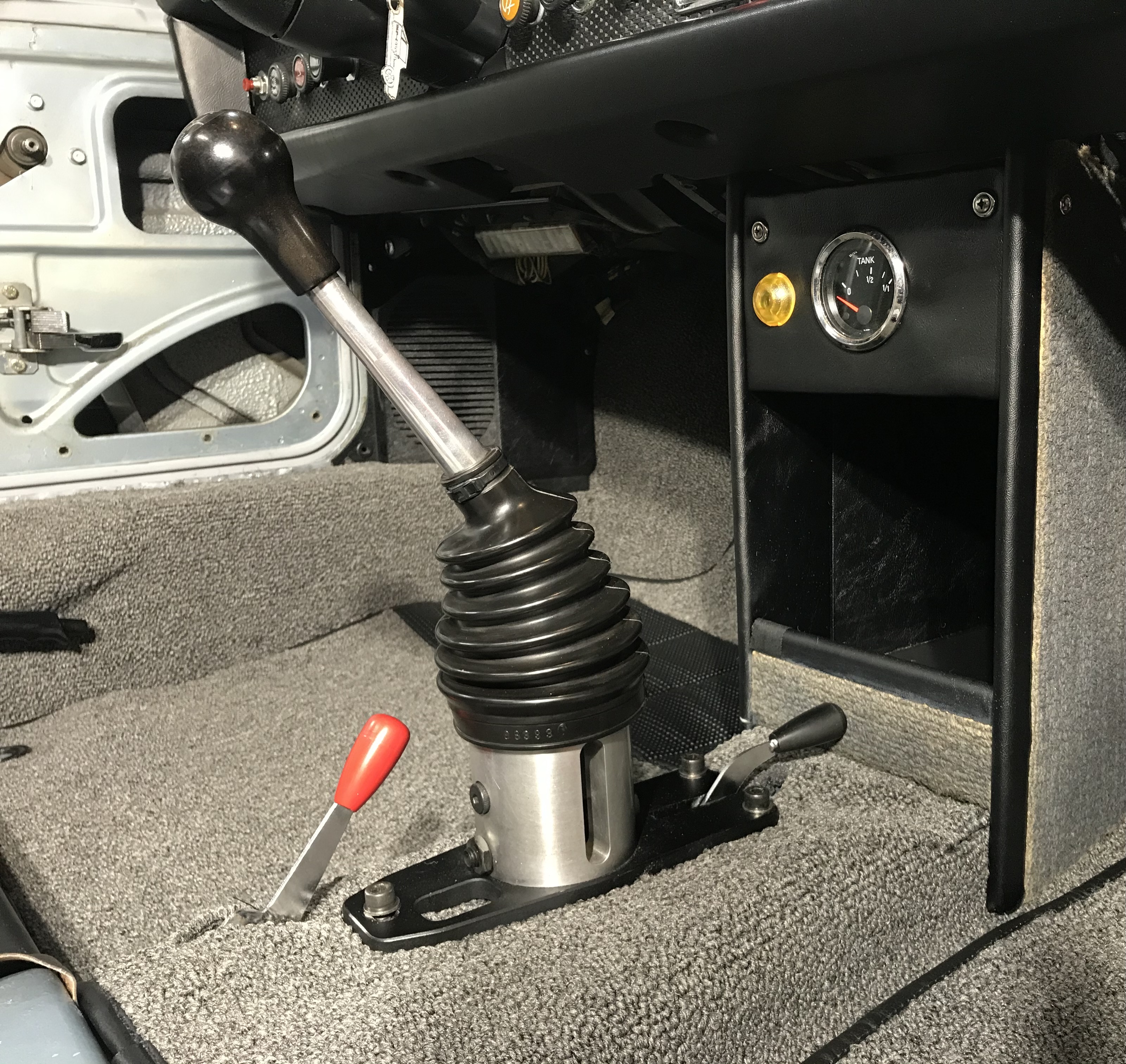

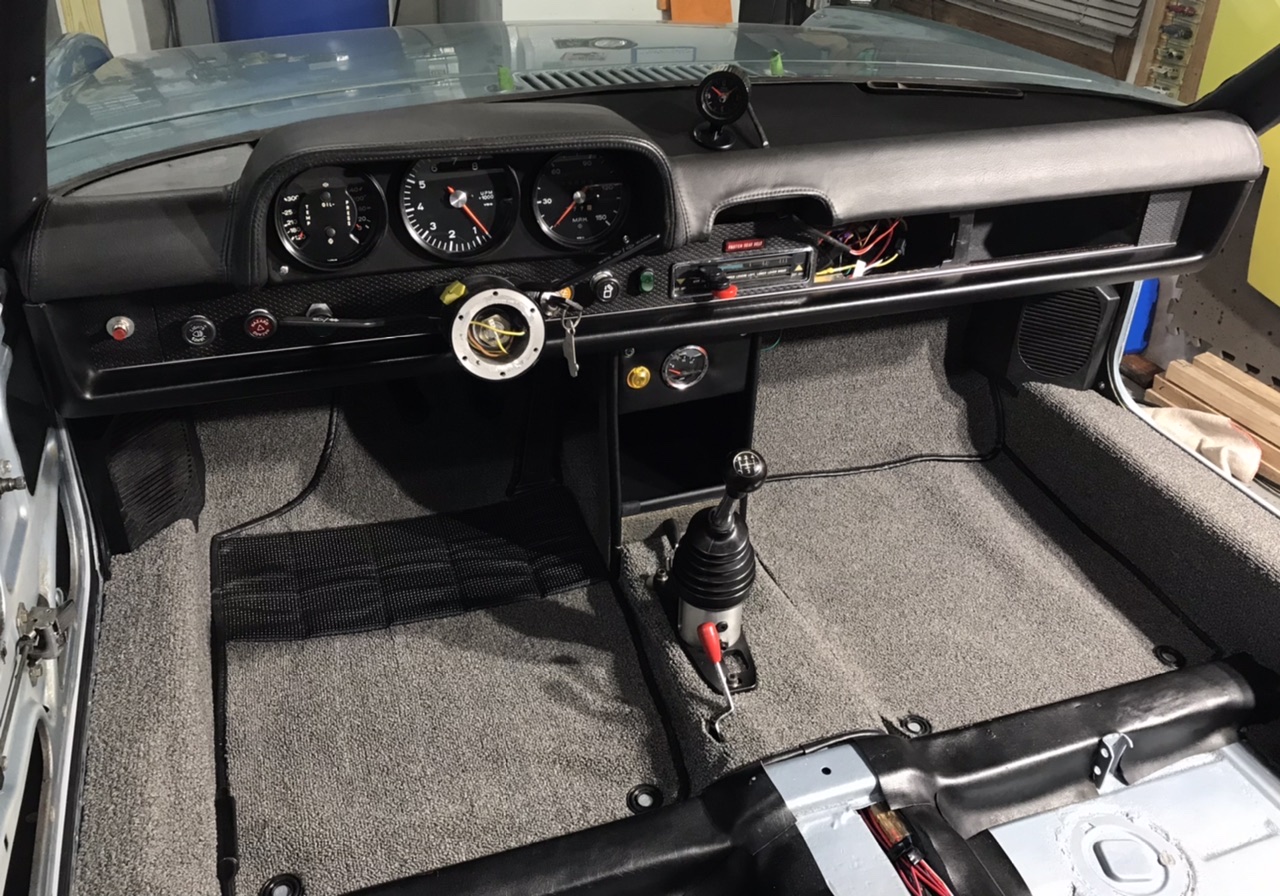

Changed the interior a wee bit. Decided to mount the shifter above the carpet... more mechanical look to it. Added the center storage box with my fuel gauge and low fuel lamp.

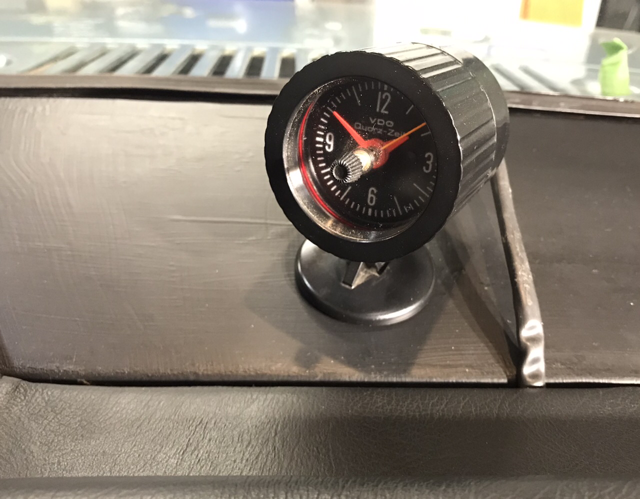

And to wrap up December work, the 1970’s version of Sport Chrono (IMG:style_emoticons/default/biggrin.gif)
Merry Christmas all, be safe and well!

I was loving it until you got to the clock on the dash.

QUOTE(mepstein @ Dec 21 2020, 06:11 PM) *
Heheheheh. Aww c’mon Mark! A little 70’s kitsch. Easily removed. 3M tape. If I’m honest not totally sold on it. (IMG:style_emoticons/default/biggrin.gif) It’s a cool period piece though.

Dion - WOW!! Your car is looking great! LOVE the interior. Dash = very nice. (IMG:style_emoticons/default/wub.gif)
And I like the shifter above the carpet.
