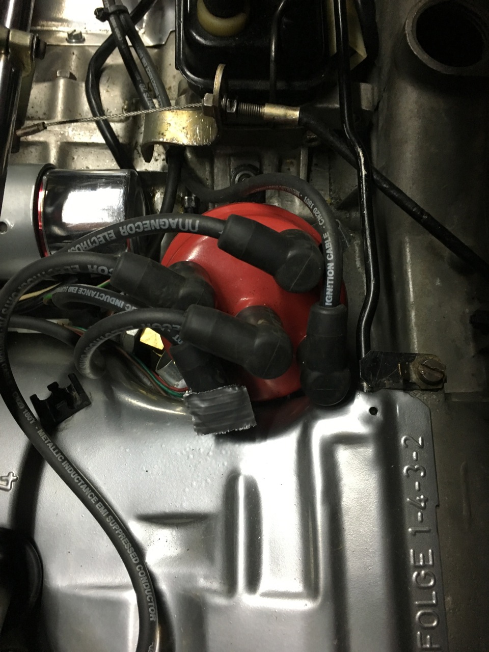

Trying to get #4 to stop popping from the carb. I have checked the timing, dist drive gear, intake for leaks, swapped plug wire, replaced spark plug, adjusted and balanced carbs, plugged and unpluged the vacuum port on that carb barrel. ( I leave these plugged and have no use for them) And done a valve adjustment.

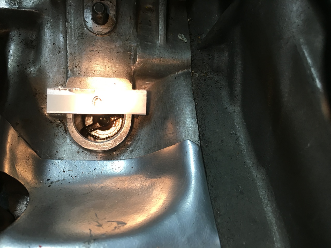

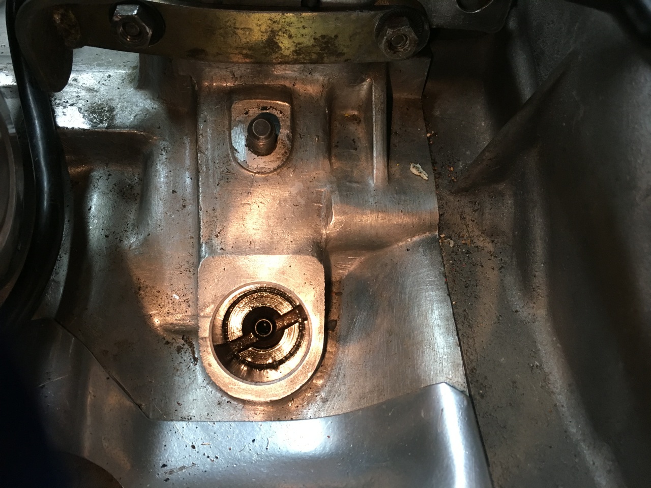

Heres what Im wondering. My drive gear looks a bit off from the pictures here and in the book. But if I lift and drop, right or left its way off. The location of #1 on the cap is seen in the picture below. The engine starts right up, and runs well. Yet the popping from # 4 is killing me., If i adjust the timing it seems that I can retard it to mostly exhaust backfire.
The #4 plug hole is a pit short in depth, at least it looks that way, but the plug is seating and appears to be no leakage. I think it was slightly miss threaded in the past.
I am concerned that somehow I am missing the correct distributor alignment with the gear, or the gear is off, or I'm clocked wrong. Or the spark plug hole is not sealing.
I have put about 100 miles on the engine, with it running like this. Seems a little rough, while cruising along at 70 almost like a intermittent miss whit that cab popping.
What could be the cause of this? Any ideas of what now? Could the items Im addressing be the cause? I am going to drive this car to Okteenerfest.
Mallory unilite installed.
(silver tape marks #1)

You have the drive 180 off but that won't cause issue if the order is also 180 off (backwards). Drive being off a bit won't cause your popping issue.

I don't see how I have the distributor drive off I have the lower section to the outside of the vehicle?
