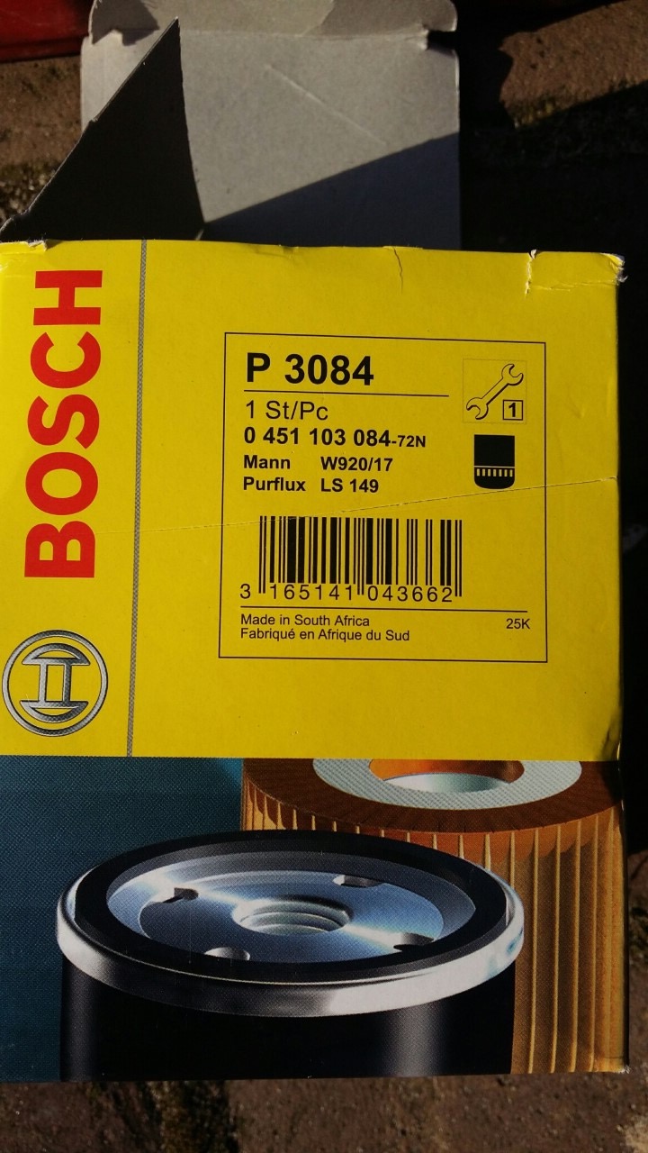

Hi all. I started working on my 914 and first thing was an oilchange and a new filter. Got all the parts new, and started working. How hard is an oilchange right?
All went fine untill I removed the old oilfilter...i thought a wrong one was there since it was another type then should be there, it was smaller in diameter.

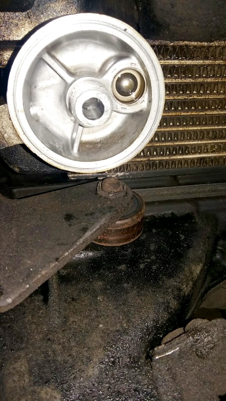

However... The new filter does not fit. It is too wide since it hits another part, a supportthing that hold a wheel that presses on the belt.
See pics.
The new bosch filter is hitting this supportbracket.
This is the new filter i think is ok

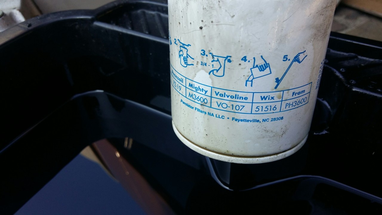

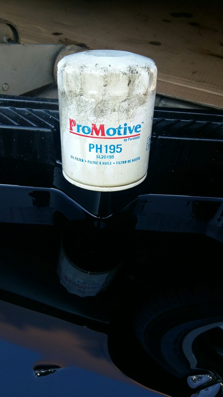

This filter came off. It is smaller in diameter and clears the supportbracket

Is that little wheel a belt tensioner for an AC system? Never seen before.

Yes...it is a tensioner for the ac belt, so it seems.
And that bosch filter is too wide. The filter that was on it does fit, but I checked the crossreference site for that filter and the needed filters do not seem to be the same.
http://www.oilfilter-crossreference.com/co...PROMOTIVE/PH195
The filter that rax914 is mentioning is compatible with what came off....is that Ok for a 914 ?

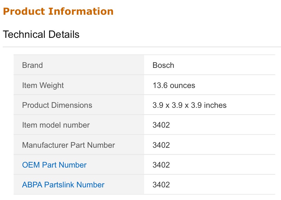

I have a '72 1.7 and the Bosch 3402 fits well, but I don't have air conditioning. Here are the product specs for the 3402:

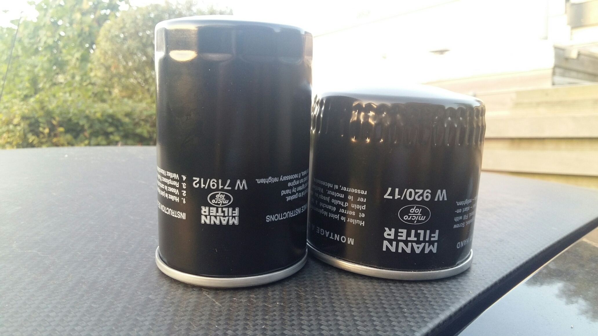

Ok...since a PH195 was not available in NL, I bought a MANN filter, which is compatible. It has a 'better' diameter for me, but is about an inch longer than teh PH195 that came off the engine.
I fits nice and does not stick out, is nicely tucked away even though it is a bit longer
as you can see the one recommended is shorter and has a bigger diameter, the other MANN filter is longer and has a smaller diameter.
A small job, but one down from the list ! Thanks for the tips and advice !
