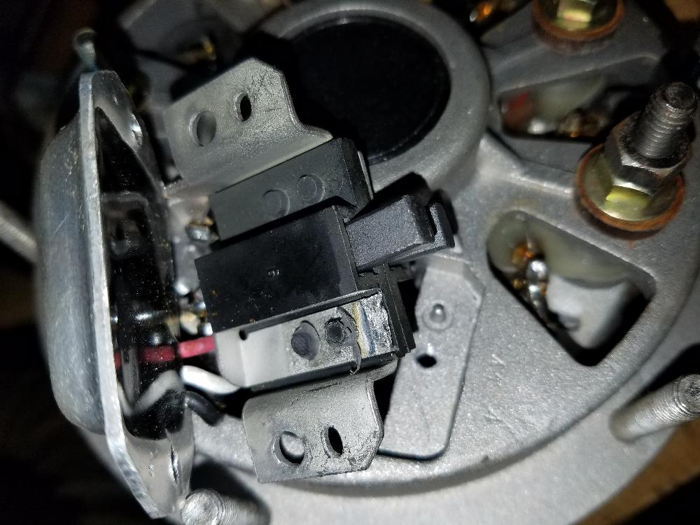

ClayPerrine   The early 911 alternators were externally regulate...   Sep 12 2016, 07:47 PM
mskala   If you're really going to get another one, I g...   Sep 12 2016, 07:50 PM
GeorgeRud   Though the internally regulated alternators may be...   Sep 12 2016, 07:52 PM
Mark Henry   Many of the guys over on the bird say the external...   Sep 12 2016, 11:08 PM

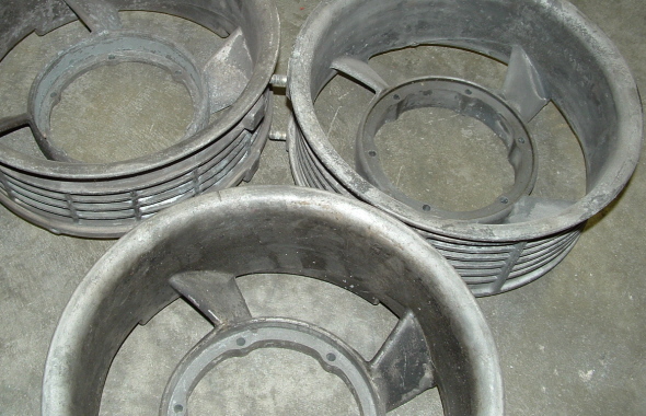

sixnotfour   if you have an early fan housing the internal reg....   Sep 13 2016, 02:35 AM
Mark Henry   if you have an early fan housing the internal reg...   Sep 13 2016, 07:19 AM
wndsrfr   if you have an early fan housing the internal re...   Sep 13 2016, 08:26 AM

Luke M   The 2.0 to early non internal reg 2.7 housings are...   Sep 13 2016, 09:56 AM

sixnotfour   not that I know of; here is some more details abo...   Sep 13 2016, 10:54 AM

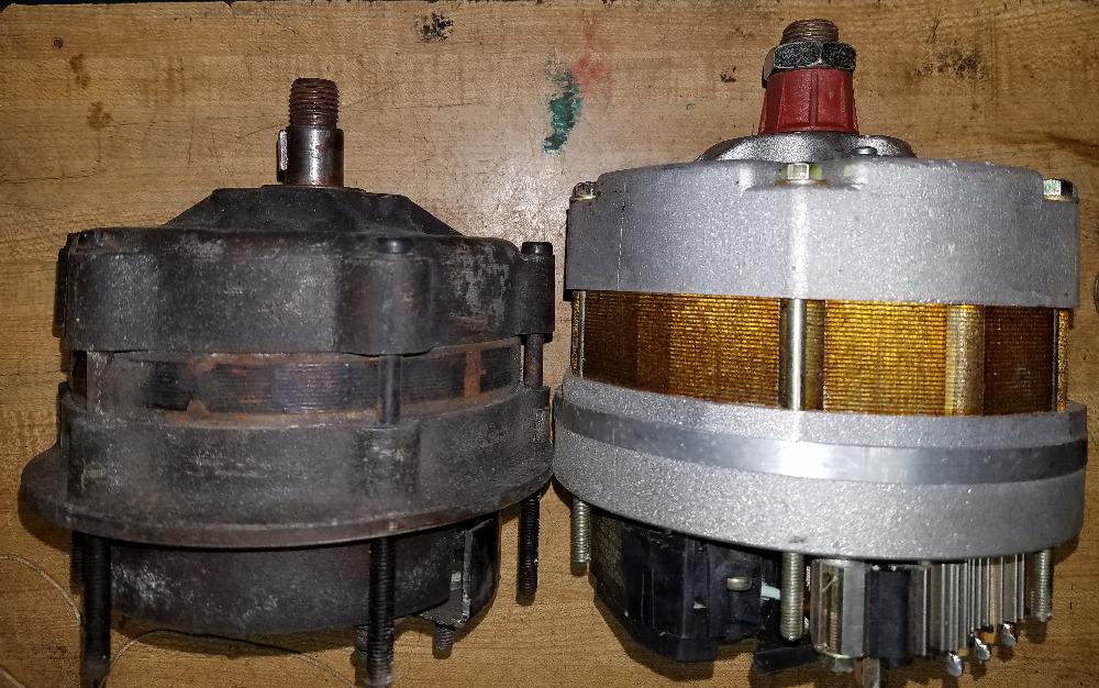

gms   To illustrate Jeff's point bosch 914/6 next to...   Sep 13 2016, 02:57 PM
gms   many years ago i found a source for internal regul...   Sep 13 2016, 03:05 PM
