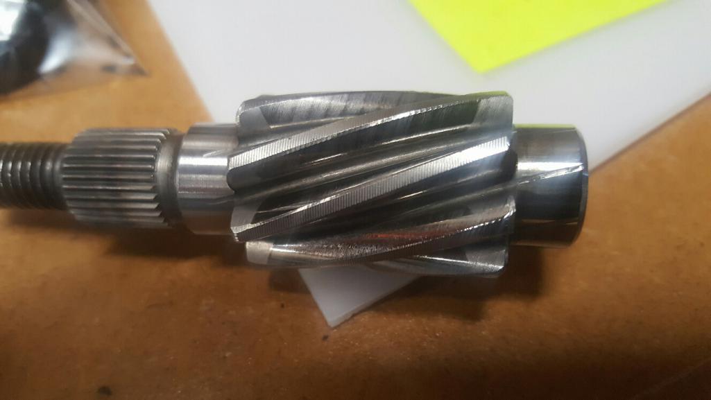

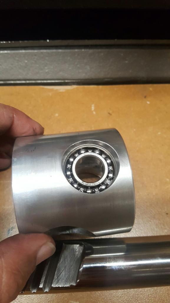

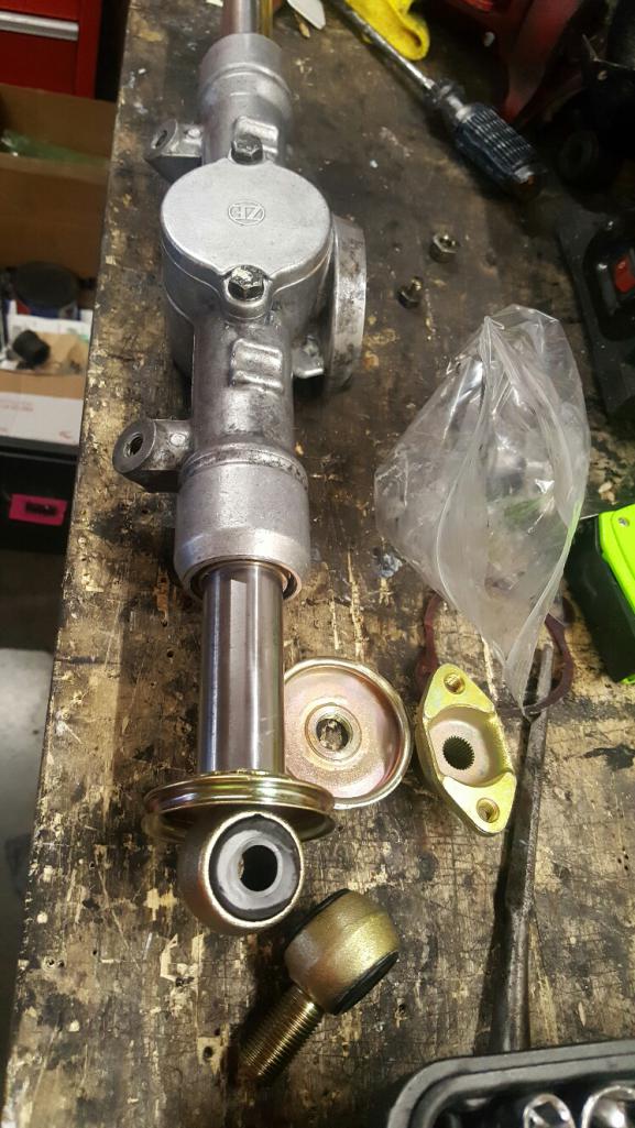

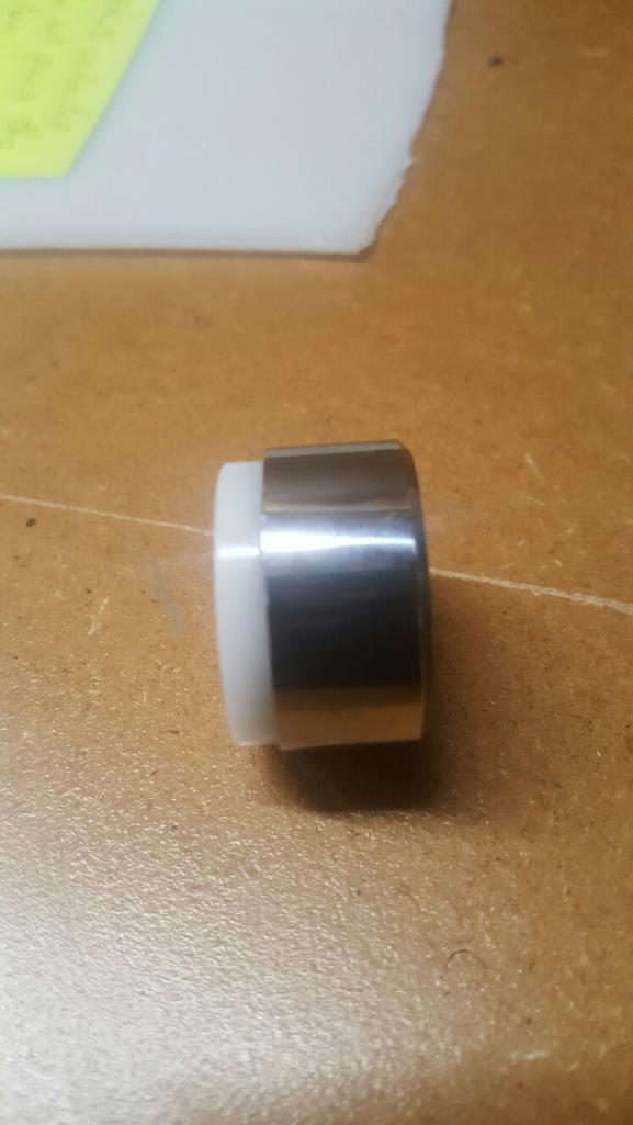

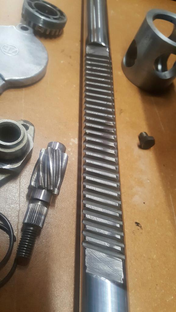

Been a little busy actually working on an oddball 911 version. We have some that are stripped down and are starting to build these and can do an exchange basis or rebuild yours is you want. Exchange we are about 2 weeks out from being able to open up the service and ship (we are starting to build up a few).
If you want yours rebuilt it will take a little longer to turn around. We are looking at a $300 core (why so much? we want them back).
With a serviceable core we can do these at $220+ shipping. A little more than 1st planned, but cleaning these up takes a little more time. We then buff the internals to look for any pitting or damage.
Here's some pics from the one I'm just about finished with.
Would have been more impressive if we had more before pics
Attached Image Attached Image Attached Image Attached Image Attached Image Attached Image Attached Image Attached Image

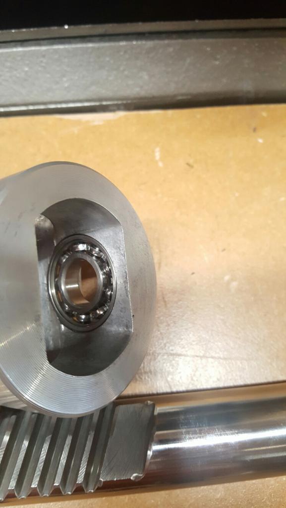

Mikey914
post Jul 19 2017, 01:25 AM
Post #28
The rubber man
Posts: 12,784
Joined: 27-December 04
From: Hillsboro, OR
Member No.: 3,348

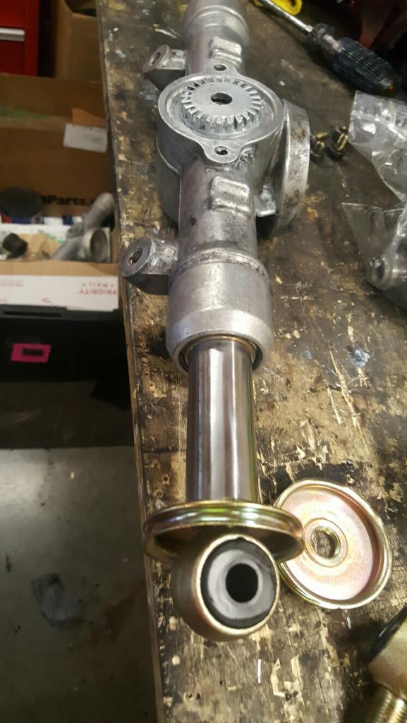

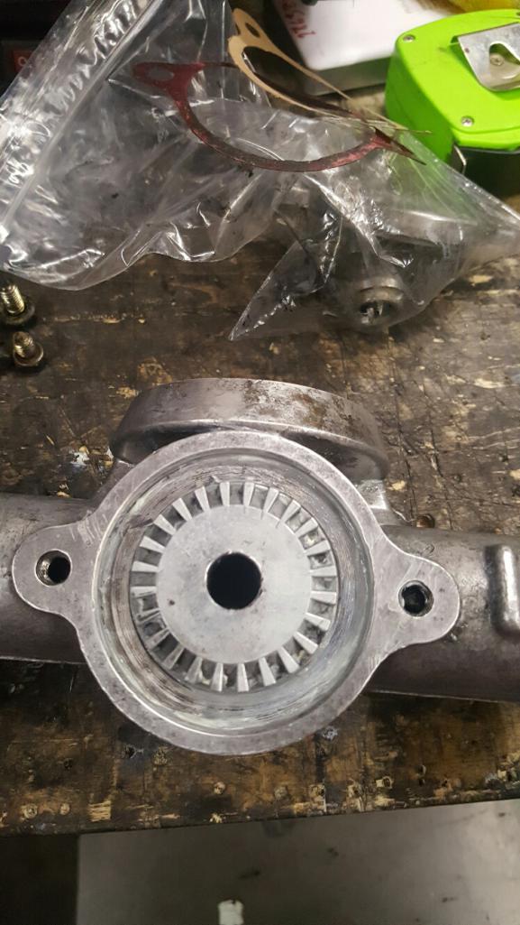

A few more

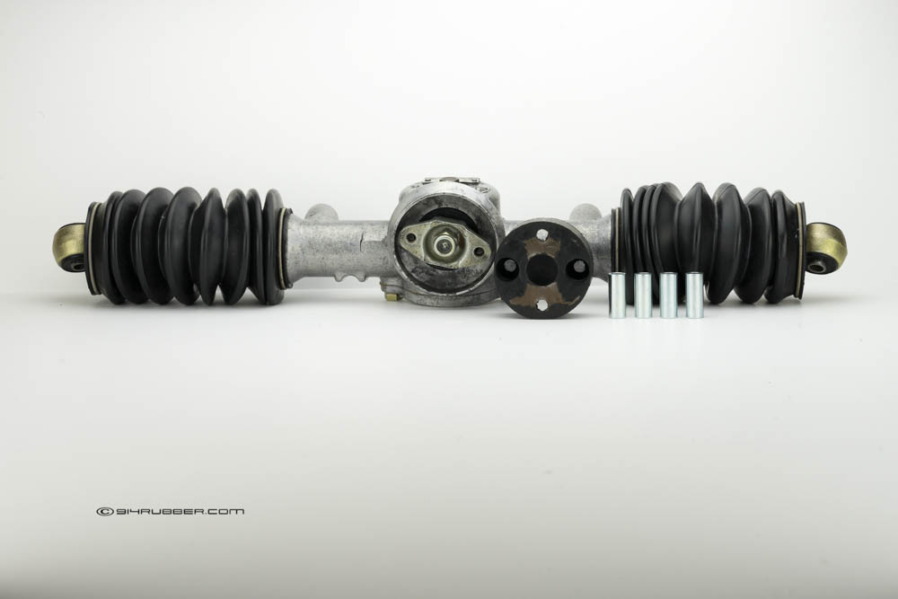

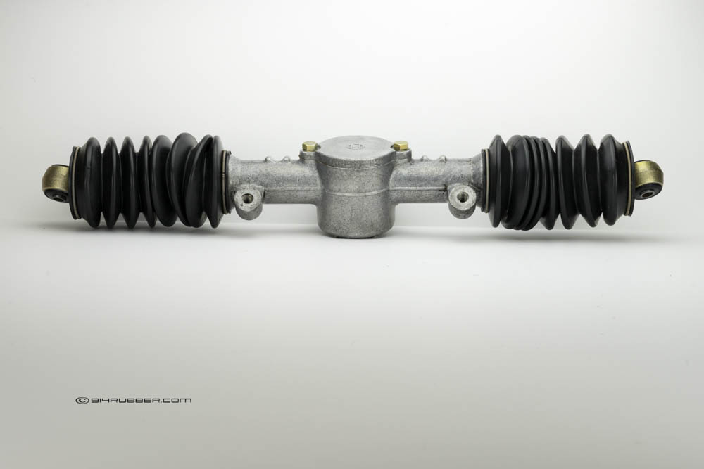

Finally complete, then found out he wanted turbo tie rods.
No big deal.
We did make the new rubber bushings for the eyes on the end. As well as the new bellows and internals. As well as the puck we had made and the sleeves hardware and even the special washer. These item are not part of the rebuild but can be included easily.
Turned out pretty good. Spent the day putting together the protocol for the rebuild. We will also be setting up a higher core charge to encourage returns, but can include a prepaid label to make returns easy. The service will depend on getting cores back. One hear or there ok, but we need to keep these moving in bulk. we have 5 that we are tearing down now and 3 that we are working on.
