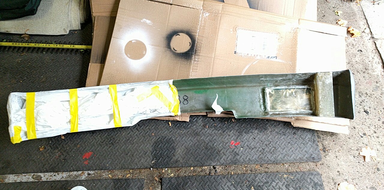

Hoping someone can shed some light, long story short the car was purchased minus bumper.
I just purchased a GT -Racing front GT bumper. Looking at it I only see two solid brackets.. I am not with the car right now and was curious if the two brackets simply
mate up with the holes in the chassis for mounting?
Seems odd that the bumper would only mount at two points each below the head light area? Doesn't seem very strong?

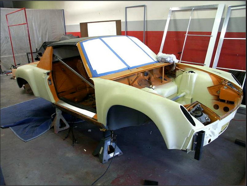

I'm guessing it mounts where the two black jig posts are mounted in this picture?

QUOTE(Fubawu @ Sep 23 2016, 10:18 AM) *
Correct

You should put a brace across the top where the firewall was. Connecting the two shock/strut mount areas together.

You can see in the photo he has the GT gussets already in place for the cross bar.
Nicely done, by the way!

On my FG bumper, I can reach the bolts through the foglamp holes.
On THAT bumper it looks like the brackets are closed on that side so you couldnt reach the bolt heads through that hole.
