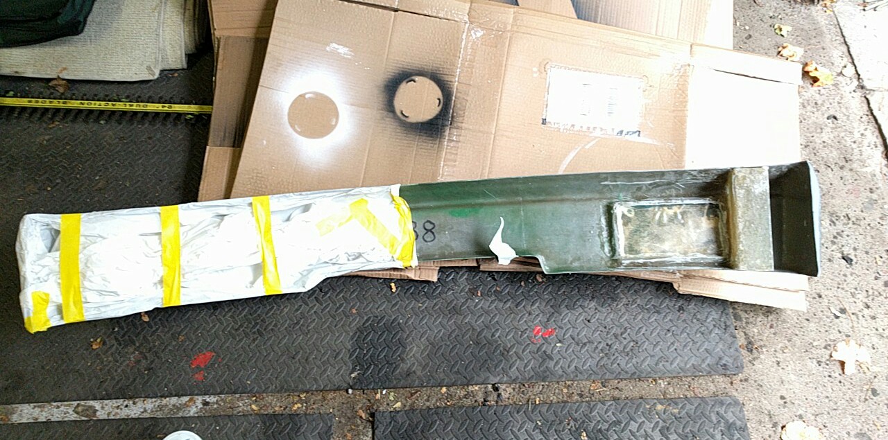

I just purchased a GT -Racing front GT bumper. Looking at it I only see two solid brackets.. I am not with the car right now and was curious if the two brackets simply
mate up with the holes in the chassis for mounting?
Seems odd that the bumper would only mount at two points each below the head light area? Doesn't seem very strong?

Here is the short version. Bolt the brackets to the body in the correct mounting points. Mix up some bonds and smear it on the end of the brackets. Put bumper in the correct location. Use blue tape to hold in place. Let dry. You can add more glass over bumper/bracket if you'd like more strength at the joint.

That's it - 2 bolts in each side.
FYI 73-74 also have additional support behind the bumper tits.

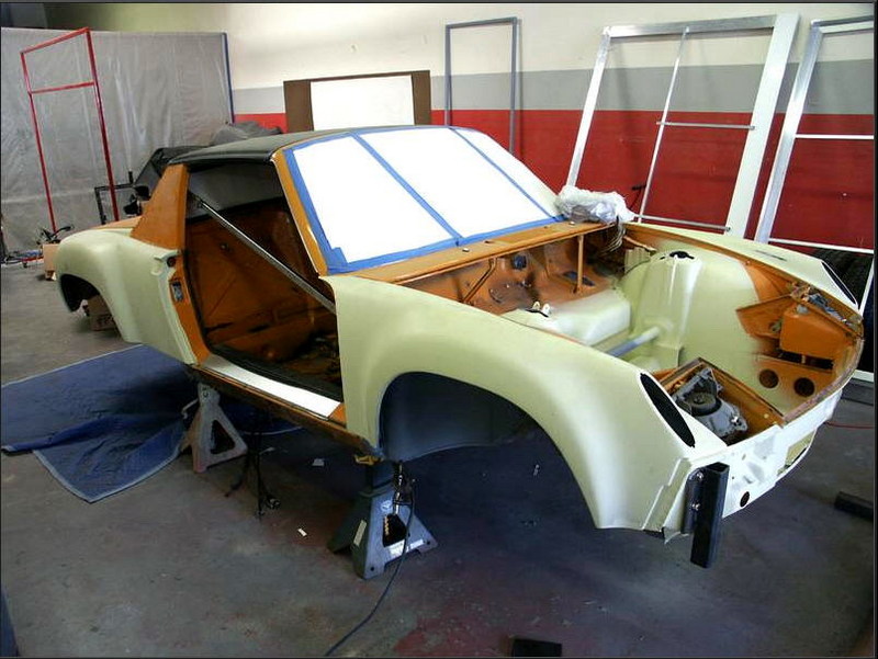

I'm guessing it mounts where the two black jig posts are mounted in this picture?

Once you align and decide where to drill the holes, you'll need to come up with some way to put speed nuts or other fasteners on the bumper unless some are already glassed in place. I had the Getty Dsign front bumper on my car, but it came with aluminum brackets that were drilled and used j nuts to capture the bolts.
As you've seen, they are quite light and flimsy. I eventually modified a steel bumper by cutting and welding an opening for the cooler opening as I wanted a bit more protection on my car.

QUOTE(Fubawu @ Sep 23 2016, 10:18 AM)
Click to view attachmentCorrect

its a profile not really a bumper..og for the GT racing class,,,
