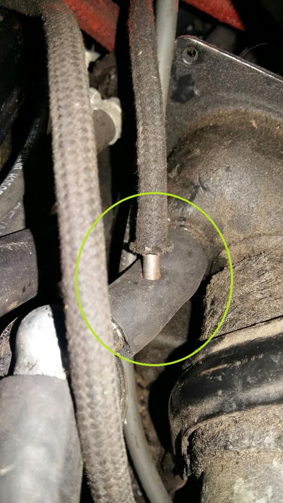

Hi all, working on the vacuumhoses check to see what needs to be replaced.
Most are not real Vacuumhose to start with, so I should replace them anyway.
I have a question about a part in the vacuumhoses spaghetti
It is a 1.7 1973

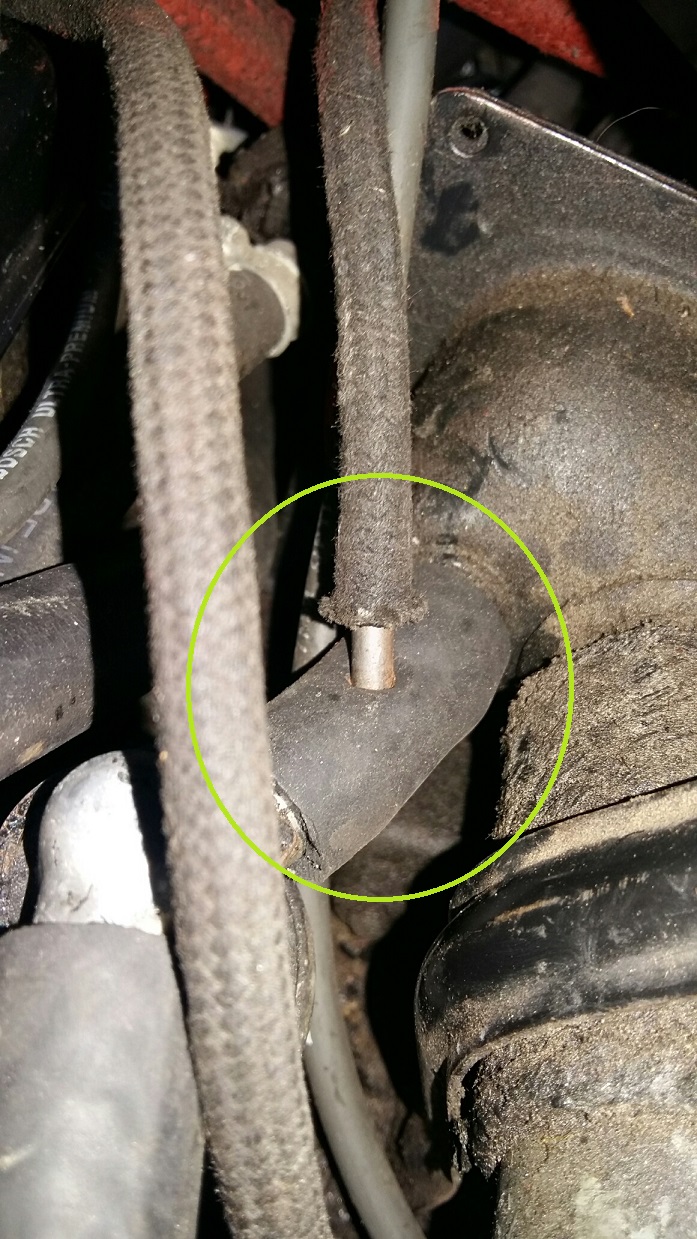

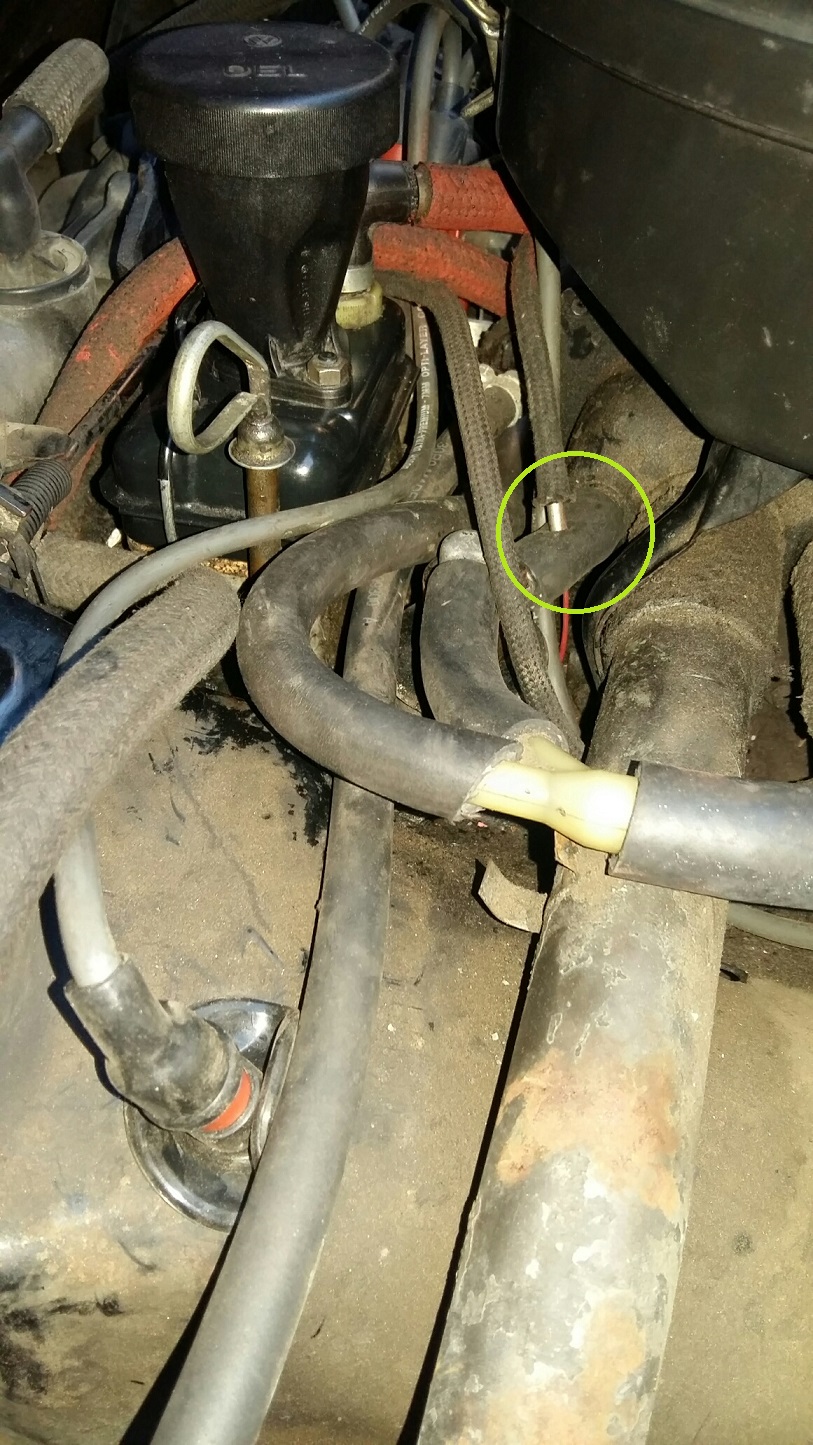

Question is about the marked splitter:
to give you an idea where it is located:
This part looks homemade to me and I am not sure if it should be there.
If I check on
http://www.pelicanparts.com/914/technical_...4_17FI_diag.htm
I do not see any hose split in two or three......
Question : what should be there ?
Thanks for your help.

I don't see a 73 1.7 on Bowlsby's tech notebook. Here is the same drawing as your link. You should print it and start following the hoses. It is tuff to tell by your picture, but does the hose go to the vacuum can on the disty?
Take the air filter off so you can see a bit better.

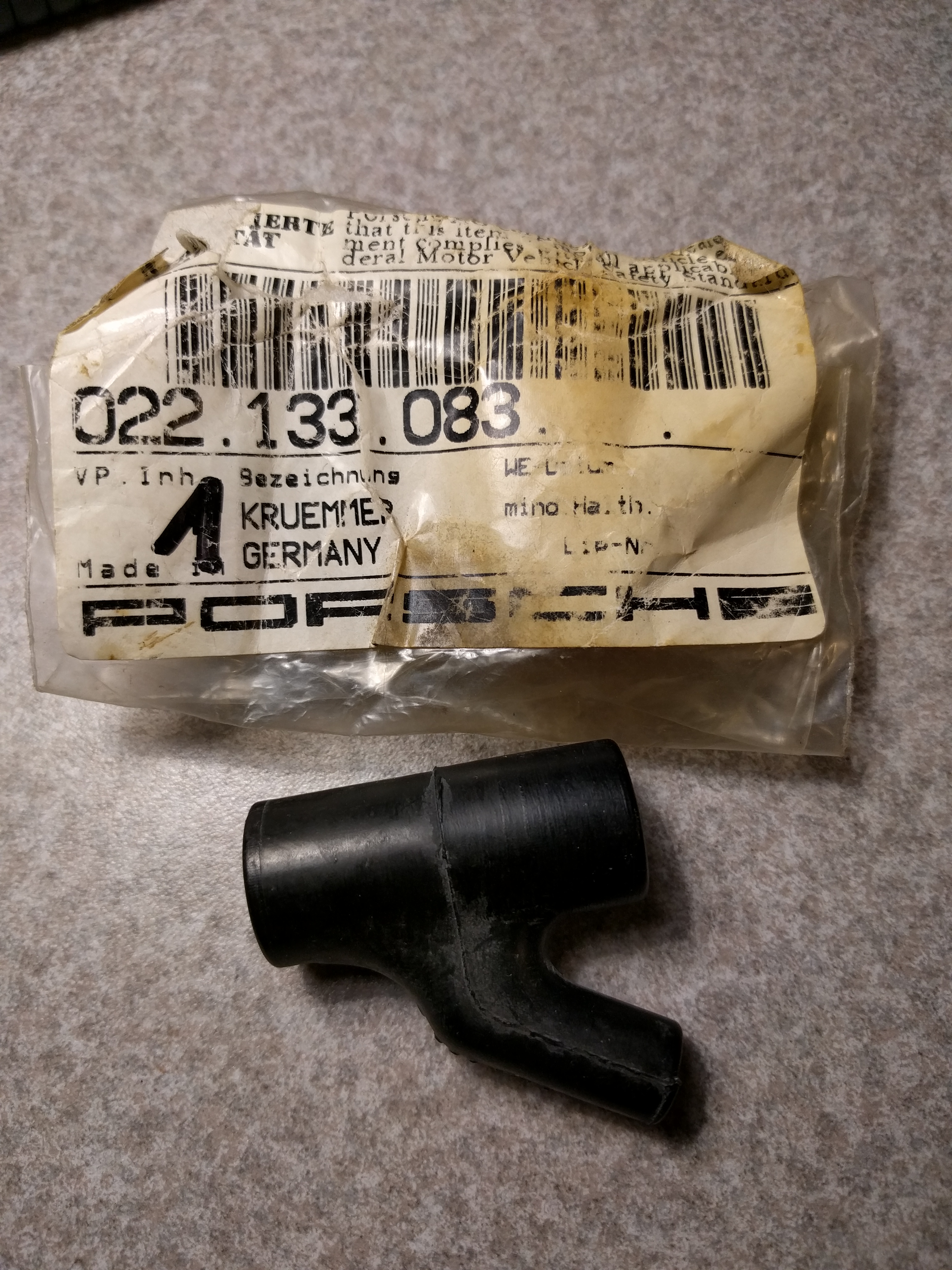

yes that is homemade...you need this 022.133.083 vacuum elbow
I have this NOS one $27 shipped us48

My car is just like that. Spent a while looking for that part, but never had any luck. I'm currently rocking the "home made" version as well. I've never been clear when or why this was done, as it doesn't seem to match other 1973 vacuum routing I've seen.
My car is a bit of a bastard with a non-original engine, so I can't comment on the originality.

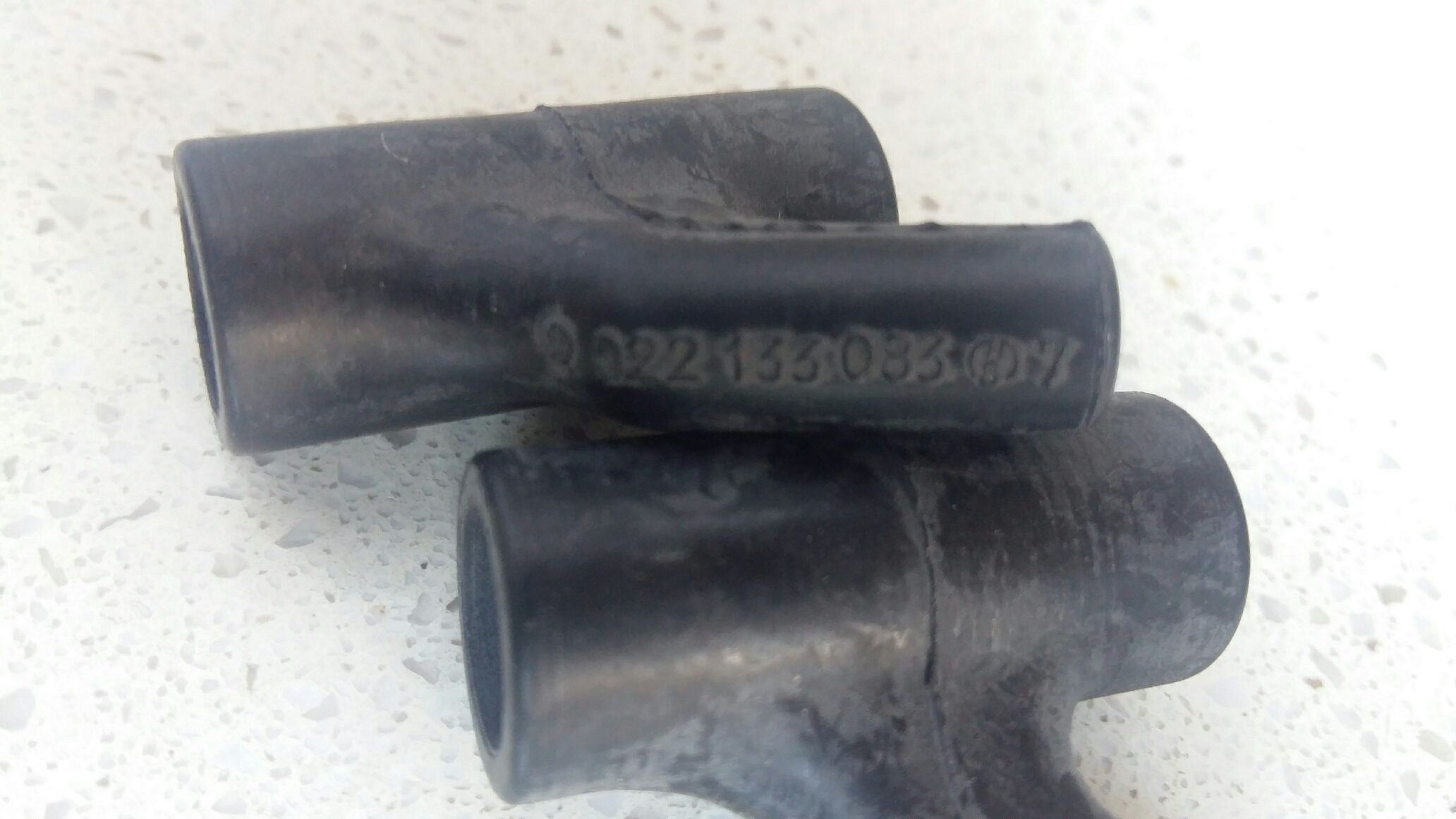

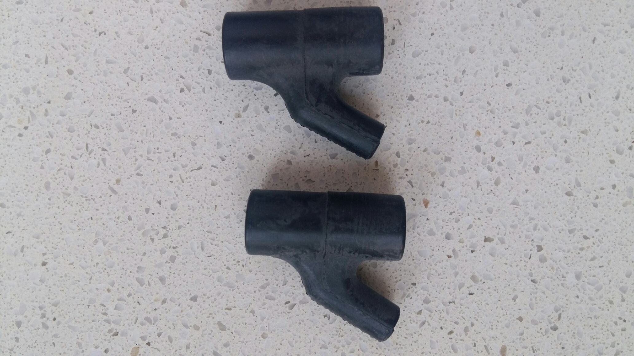

Note that 022133083D is NOT what you want. Wrong size. I see several people are advertising they have the 022133083, but I don't believe they have stock. I tried to order one from Bus Depot last year, and it sat on back order for 6 months before I cancelled the order. I may tweak them again to see if they found a source.

I can confirm that 022133083D is incorrect -- I have two of them down in the garage, with no idea what to actually do with them since they won't work.
I've been asking Mark at 914Rubber to make some for a while, but it's fallen kinda low on his priority list.

Ok, some parts arrived including the elbow that we spoke about in this topic.
unpack
It looks like the correct one !
So...I will replace the homemade part by the original elbow again.
