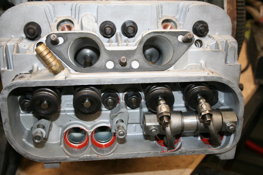

High temp RTV. Works great. Just be careful to clean it up good. FAT Perfromance uses it and if it's good enough for FAT, etc. etc.

Clean the bores where the O-rings go thoroughly. Make sure they are smooth, with no casting lines or anything else to snag on.
I do not recommend any sealant that hardens. Like RTV. The tubes are supposed to slide in and out of the head; the wire retainers push them in toward the center of the engine but the outer end has to be able to slide in the bore. RTV as shown in Elliot's pic will eventually fail. I'm frankly surprised that it hasn't failed already...

QUOTE(Dave_Darling @ Sep 30 2016, 11:08 PM) *
--DD
I hasn't failed in 13 years. I'll keep waiting. (IMG:style_emoticons/default/av-943.gif)

i used the victor reinz seals that came in the engine gasket kit. three of the four tubes leaked like sieves. a smear of hylomar on the seals and reassembled, no more leaks. hylomar and permatex red anoerobic sealers dont harden. good enough for rolls royce, good enough for me. i have used viton o rings on '60's era triumph push rod seals, they are not magic and leak just like stock. i am unaware of "the right seals" or where to get them. every type 4 engine i have taken apart, had significant oil leakage around the pushrod tubes. so far about 3000 miles on mine, no leaks. is there any empirical reasons against using sealant aside from personal preference?
