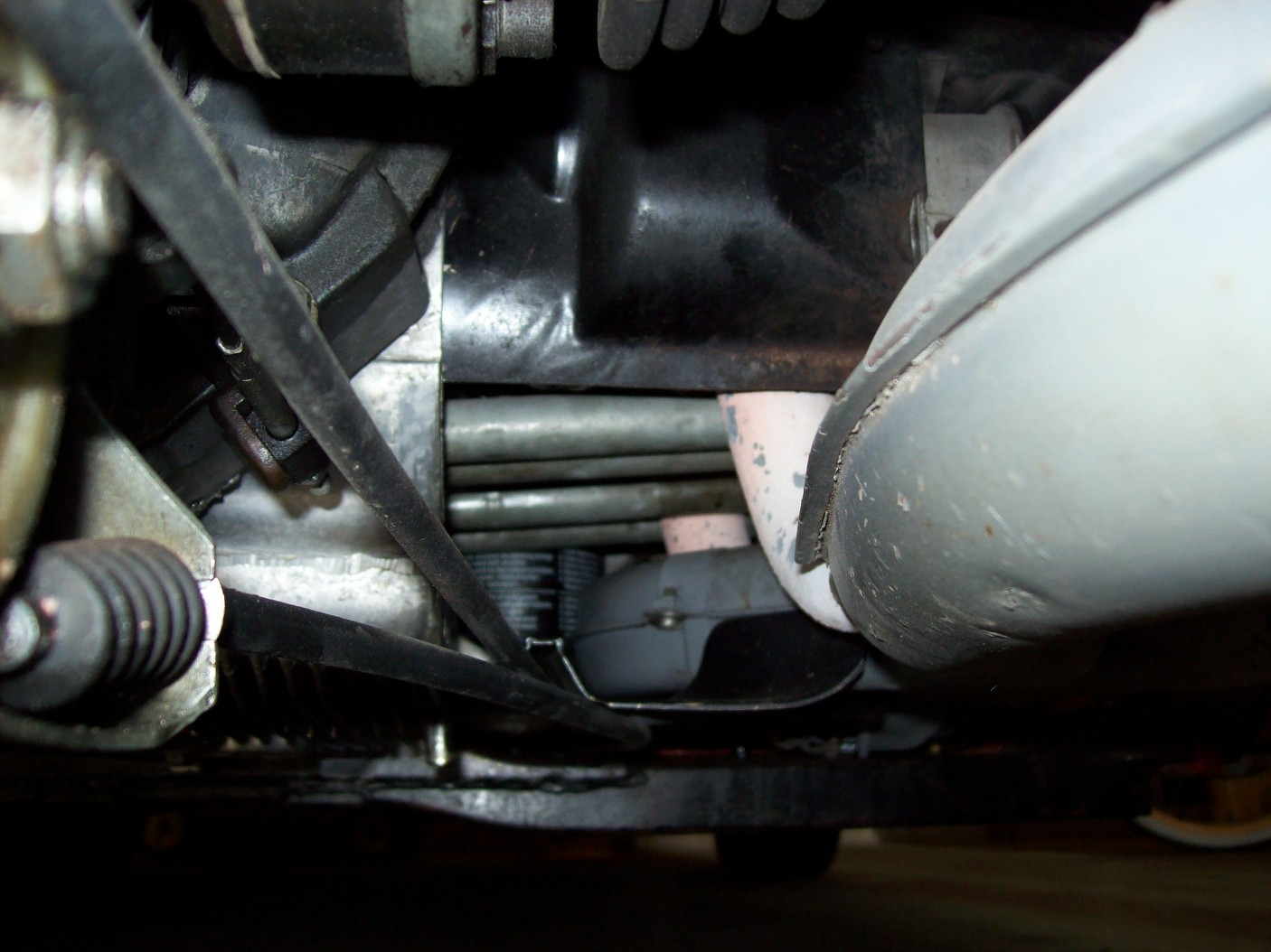

Do you see any oil leaks from these push rod tubes? Not a matter of luck, just proper service
