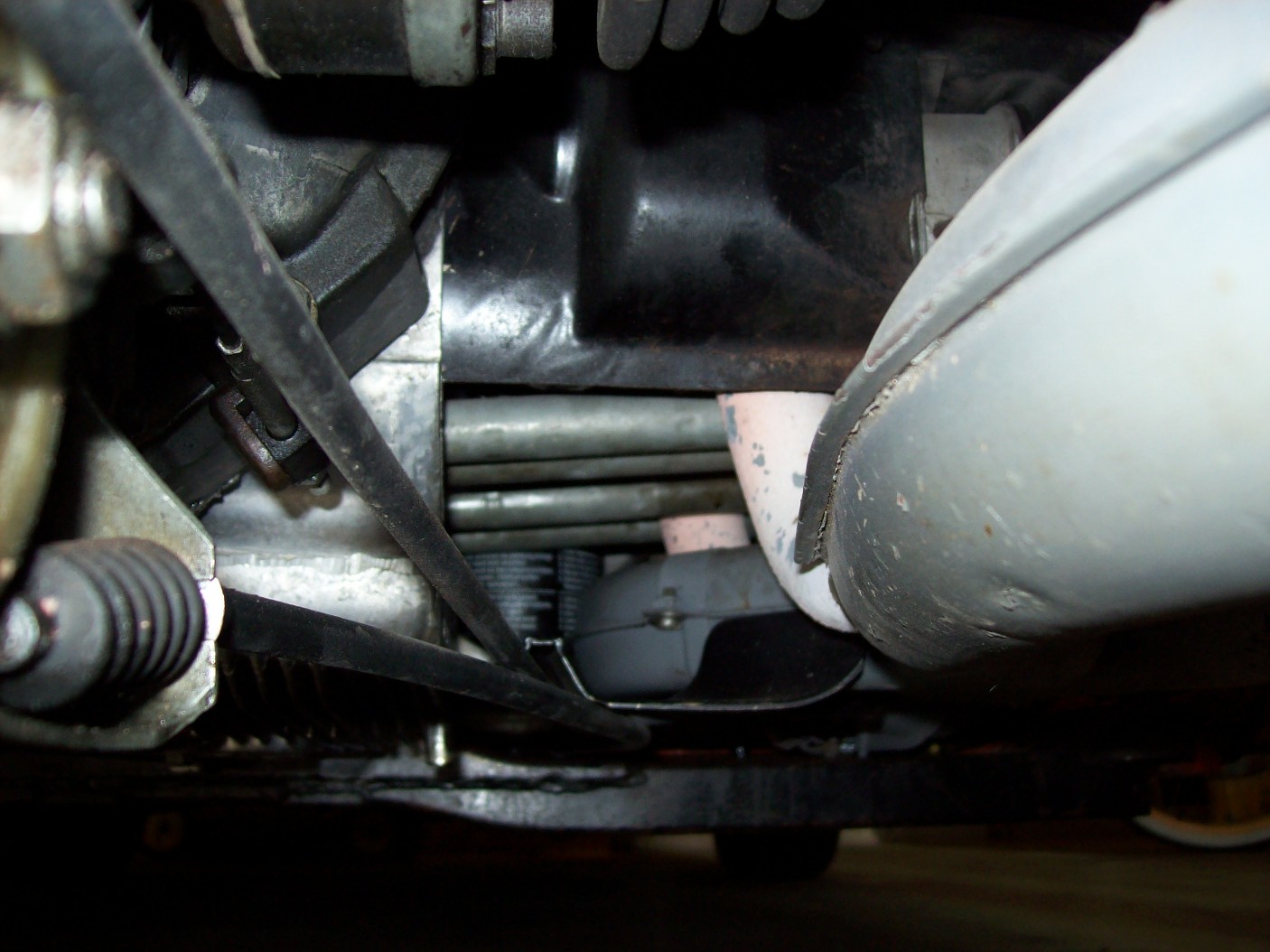

Porschetub, there is often very useful info on 914World, but there is also often misinformation and differing opinion. I won't be bulleyed into agreeing with you. In this case, I do disagree with those who say we should use RTV or other sealant on push rod tube seals. In my 40+ years of experience with 914's (beginning at a Porsche dealership where I worked and where I bought my 914 in 1976), I have learned a bit about our cars. I do not need to research your favorite shops and their methods, since I do all the maintenence and repair on my car myself, and drive it most every day. Back at ya, Porschetub- YOU should listen to those of us with true experience with these cars, and have a little more respect!
Do you see any oil leaks from these push rod tubes? Not a matter of luck, just proper service (IMG:style_emoticons/default/beer.gif)
