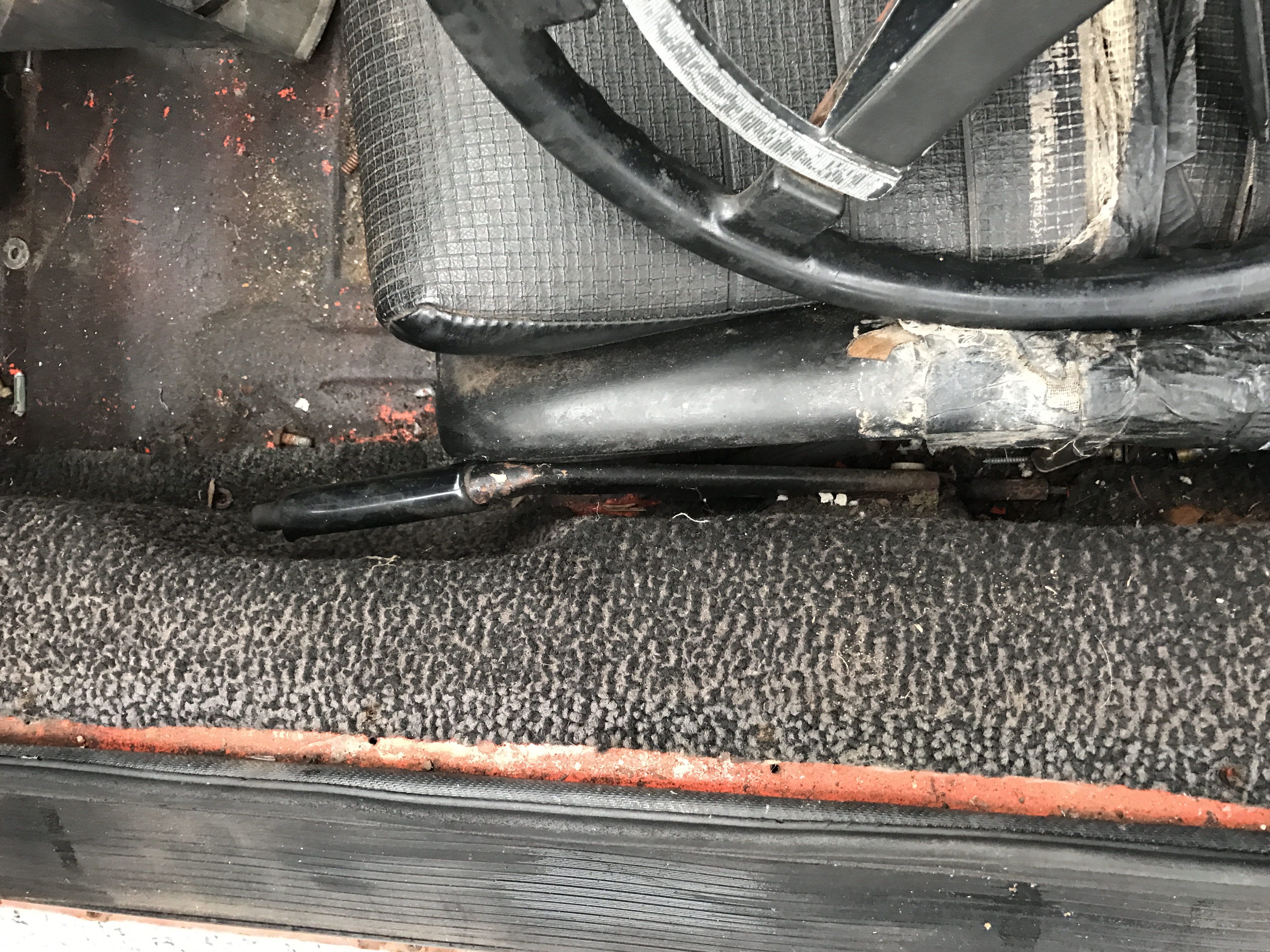

The handbrake lever should be between the driver's seat and the left longitudinal. You would have to climb over it to get in the driver's seat.
Do you have a picture of the "small white lever"?

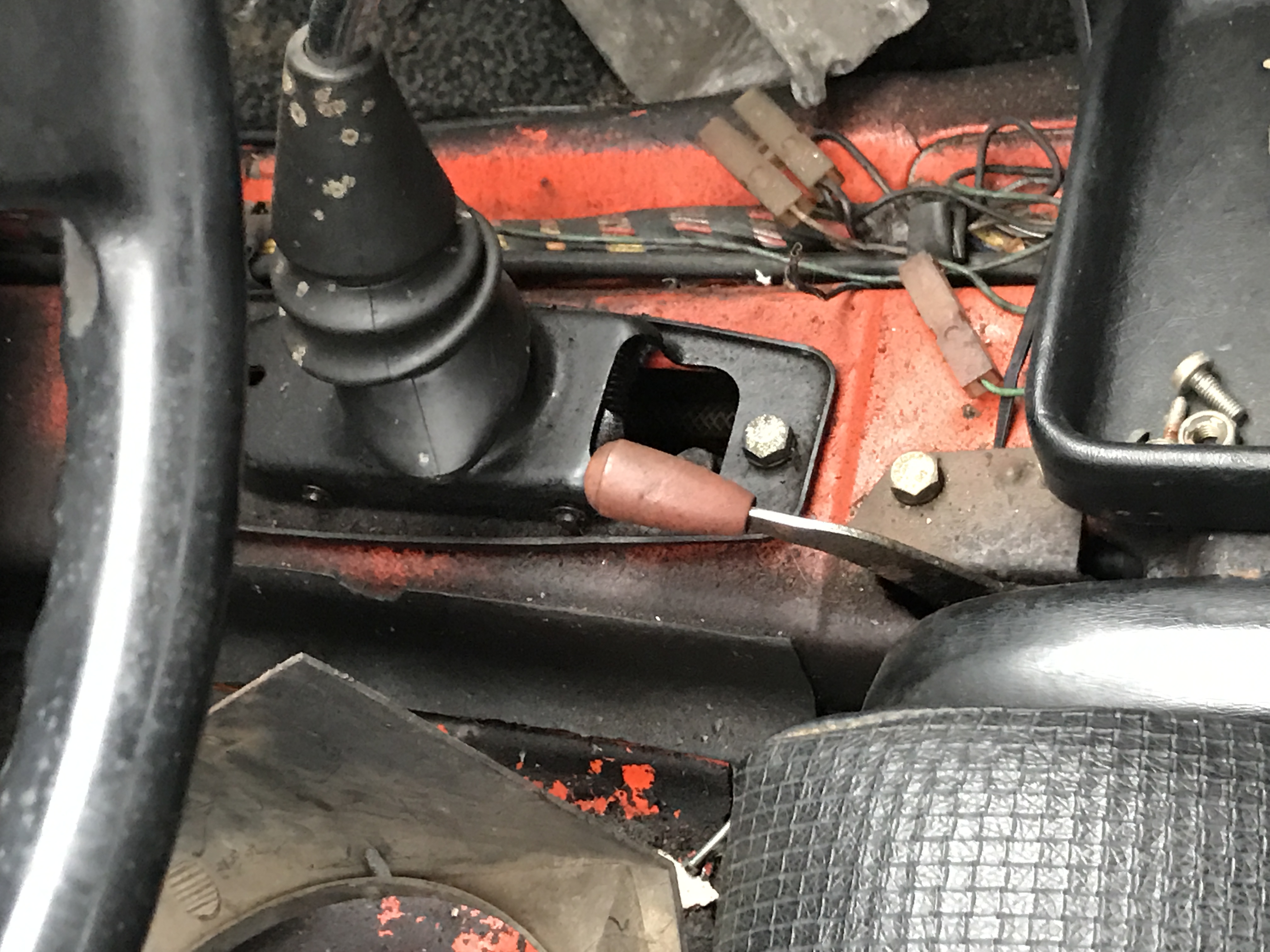

Ncchany
post Oct 1 2016, 01:22 PM
Posts: 36
Joined: 1-October 16
From: New york
Member No.: 20,456
What do you guys think of this? I need help with the shifter issue thats important to me.

The ebrake is rock solid and wont go up. Where can i order get the shifter bushings?

cwpeden
post Oct 1 2016, 03:52 PM
Great White North, huh?
Posts: 916
Joined: 20-August 06
From: Victoria BC
Member No.: 6,693
QUOTE(Ncchany @ Oct 1 2016, 02:24 PM) *
QUOTE(Ncchany @ Oct 1 2016, 03:23 PM) *
QUOTE(McMark @ Oct 1 2016, 03:16 PM) *
Yup, replace all the shifter bushings. All of them. Even the ones that look good.
That's the heater lever, opens the flapper boxes and turns on aux fan.
