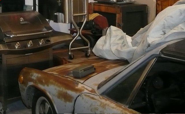

What do you guys think of this? I need help with the shifter issue thats important to me.

cwpeden
QUOTE(Ncchany @ Oct 1 2016, 02:24 PM) *
QUOTE(Ncchany @ Oct 1 2016, 03:23 PM) *
The ebrake is rock solid and wont go up. Where can i order get the shifter bushings?
QUOTE(McMark @ Oct 1 2016, 03:16 PM) *
Yup, replace all the shifter bushings. All of them. Even the ones that look good.
That's the heater lever, opens the flapper boxes and turns on aux fan.

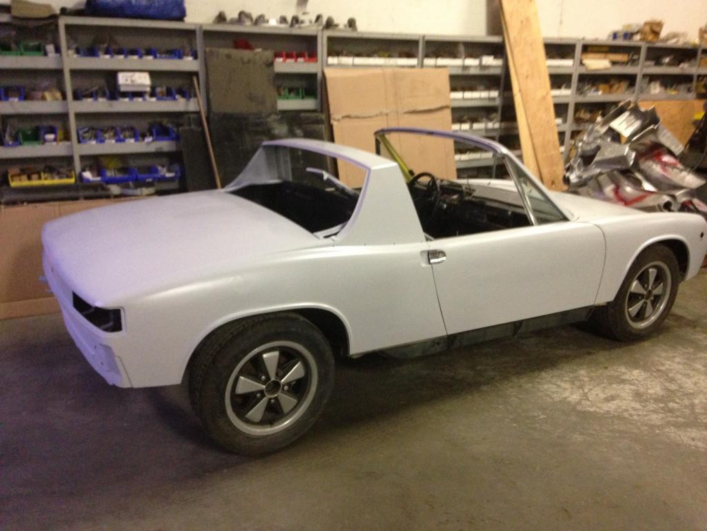

euro911
That sure brings back some memories.
IPB Image
As you can see, it's workable with lots of elbow grease though cool_shades.gif
IPB Image
IPB Image
IPB Image

I sold the car back in 2013 and the new owner had the remaining body prep work done.
IPB Image

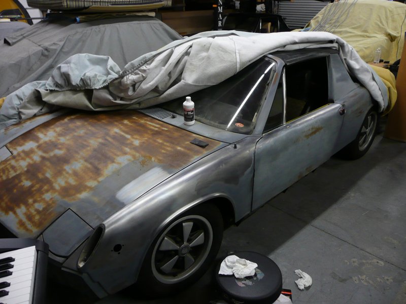

rhodyguy
If the pass side front is an indication of mark's first choice, you are going to have your work cut out for you. Pictures.......
