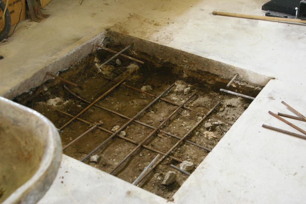

mlindner   JustinP71, just cut a hole in the cement.......Eas...   Oct 29 2016, 05:39 AM

mlindner   Just another shot, 914 on wood dolly on top of woo...   Oct 29 2016, 05:55 AM
mlindner   Harpo, I did have a friend to help....but the proc...   Oct 29 2016, 07:00 AM
mlindner   Found a few pics, let see if I can post them all. ...   Oct 29 2016, 07:41 AM

mlindner   The old cement floor was only 3 1/2 inches thick w...   Oct 29 2016, 12:54 PM

mlindner   Hi David, no, no need for that. The base for the l...   Oct 29 2016, 04:33 PM

mlindner   Justinp71, back to your question. Looked over the ...   Oct 30 2016, 09:04 AM
