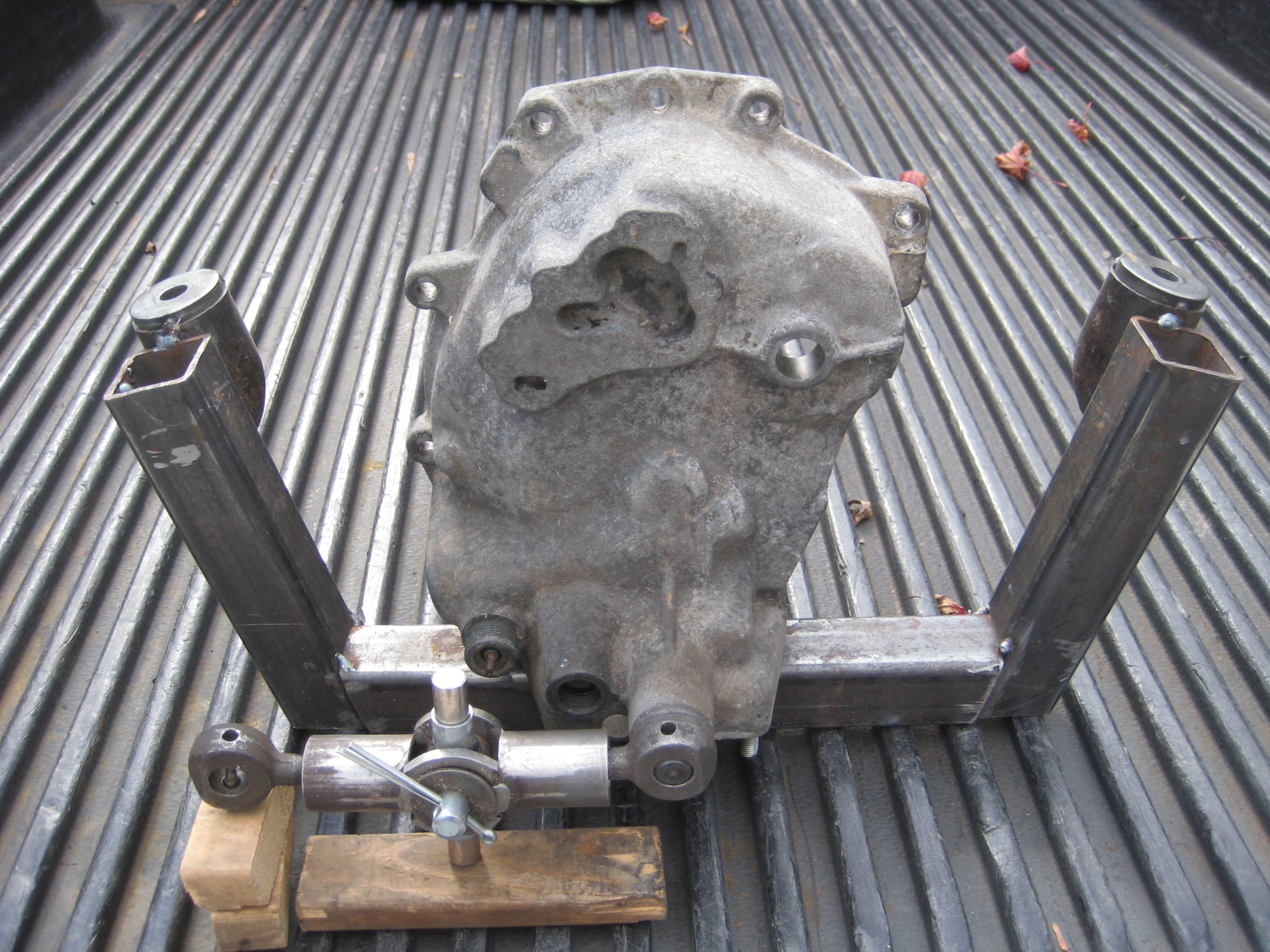

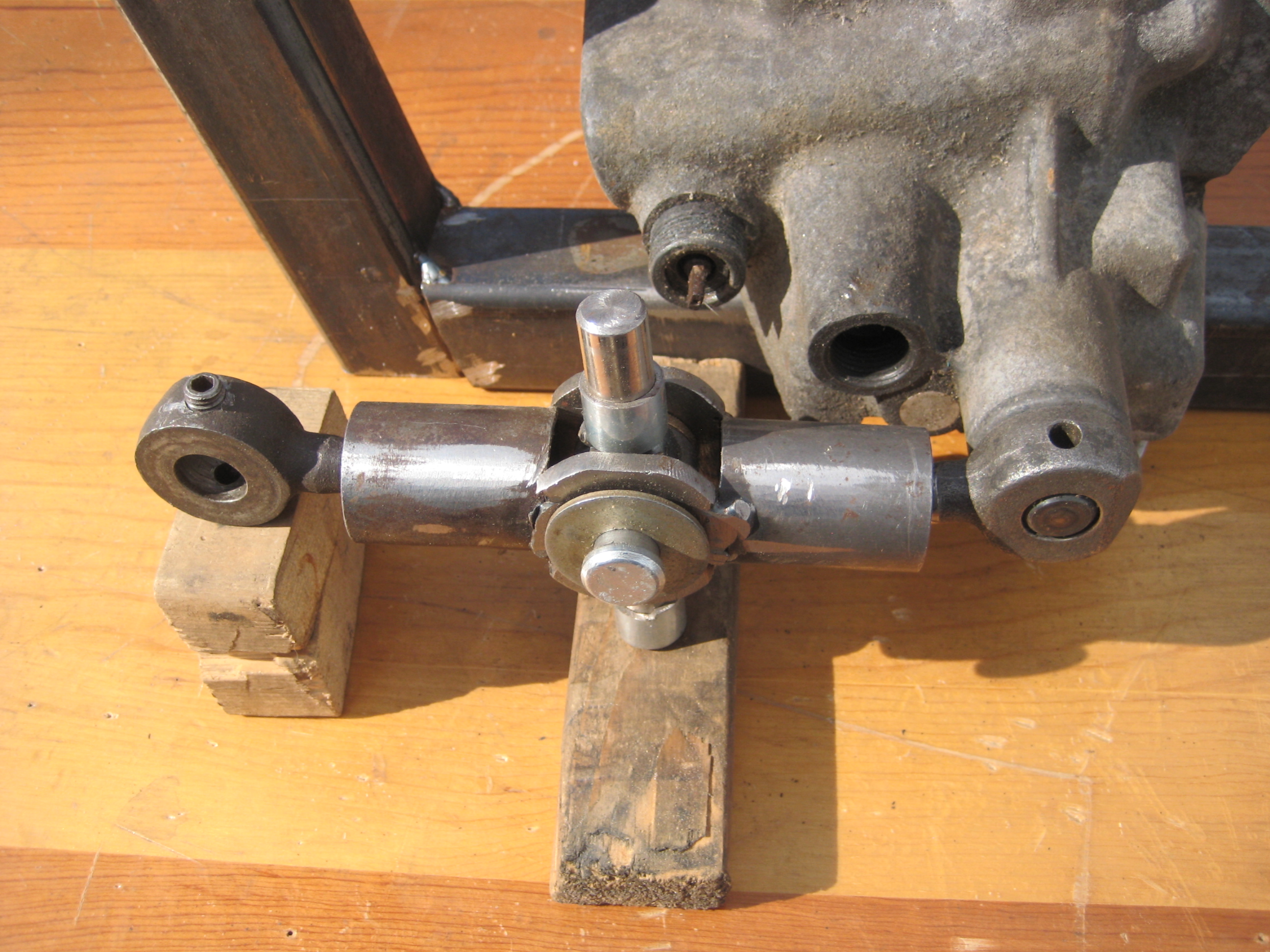

Attached are pictures of a hangar and an idea for linkage that I fabricated to install a 915 in a 914 chassis.
I've since switched to the kit that Martin Bott makes that duplicates 916 parts.

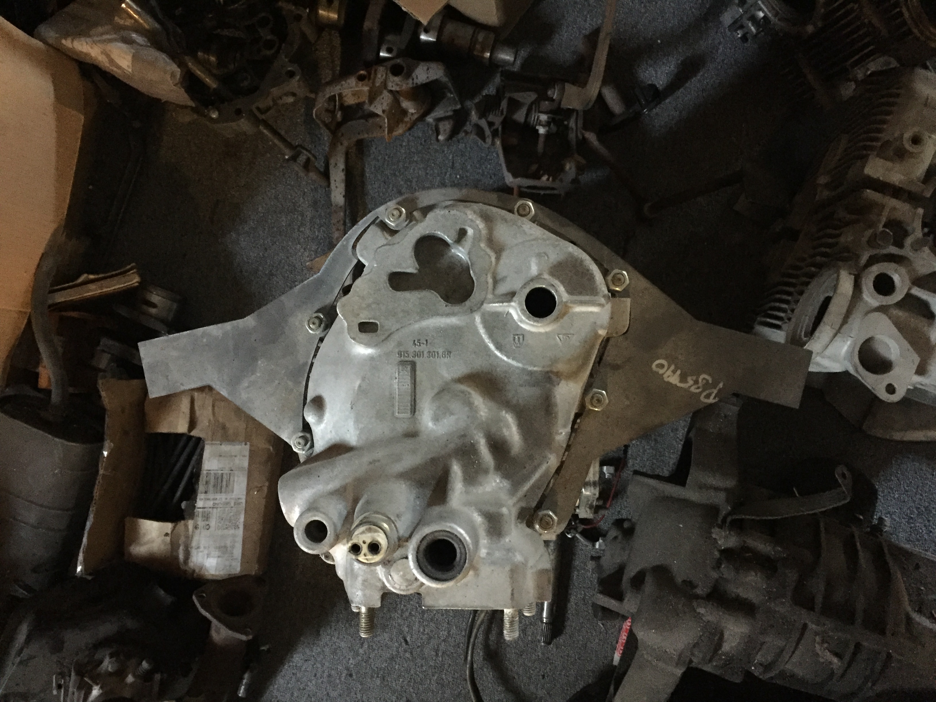

I am looking at going to the machine shop to have the adapter plate made sometime this month. Lots of pictures to follow....
