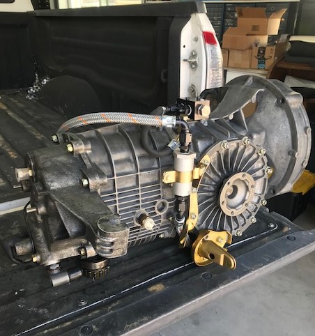

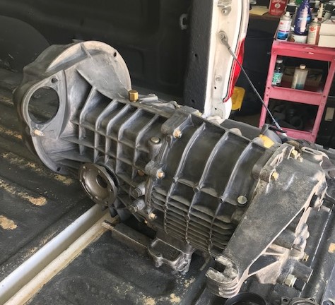

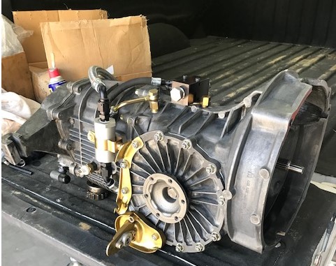

Good timing on this topic figured I'd share my 915-916 saga.
Picked up my completed trans Saturday after a 3+ year odyssey collecting parts and more importantly finding an experienced builder.
915 Mechanical speedo box, 7:31 Quiafe LSD, oil cooling and spray bar system, and Bott conversion kit, updated bearing saddle.

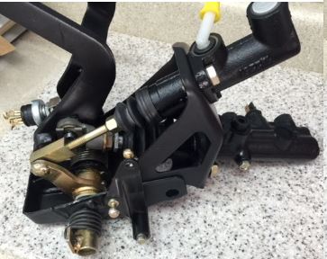

I'm going to a hydraulic clutch, with modified 1972 only 915/901 style shifter.
Here is my hydraulic pedal cluster using only factory Porsche parts including G50 pedal box as a basis
This is not an inexpensive endeavor to say the least but very close to the factory 916 set-up plus some performance / reliabilty updates.

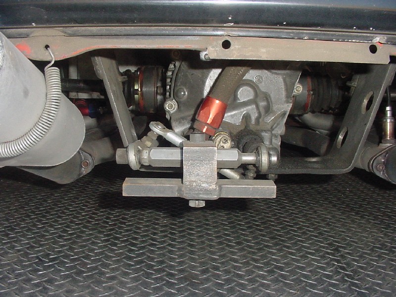

An alternative that I saw many years ago was from some folks from the Phoenix area used to have an external shift linkage to shift a 915. I have some pictures of such a car.
