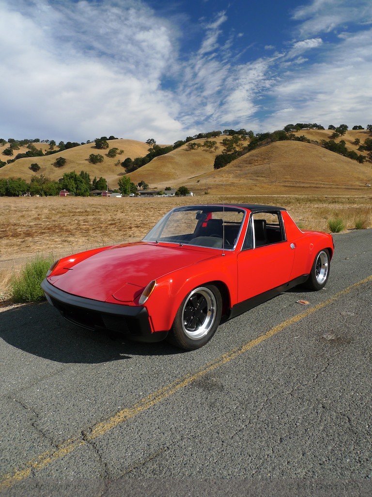

Yes, they fit. Here are 7s and 9s on a friends car. You may want/need spacers. Tire availability is OK in 16". Check Tire Rack.

QUOTE(tygaboy @ Nov 6 2016, 06:33 AM) *

Are those steel flare or fg
Steel. Pretty sure he used RD flares.
