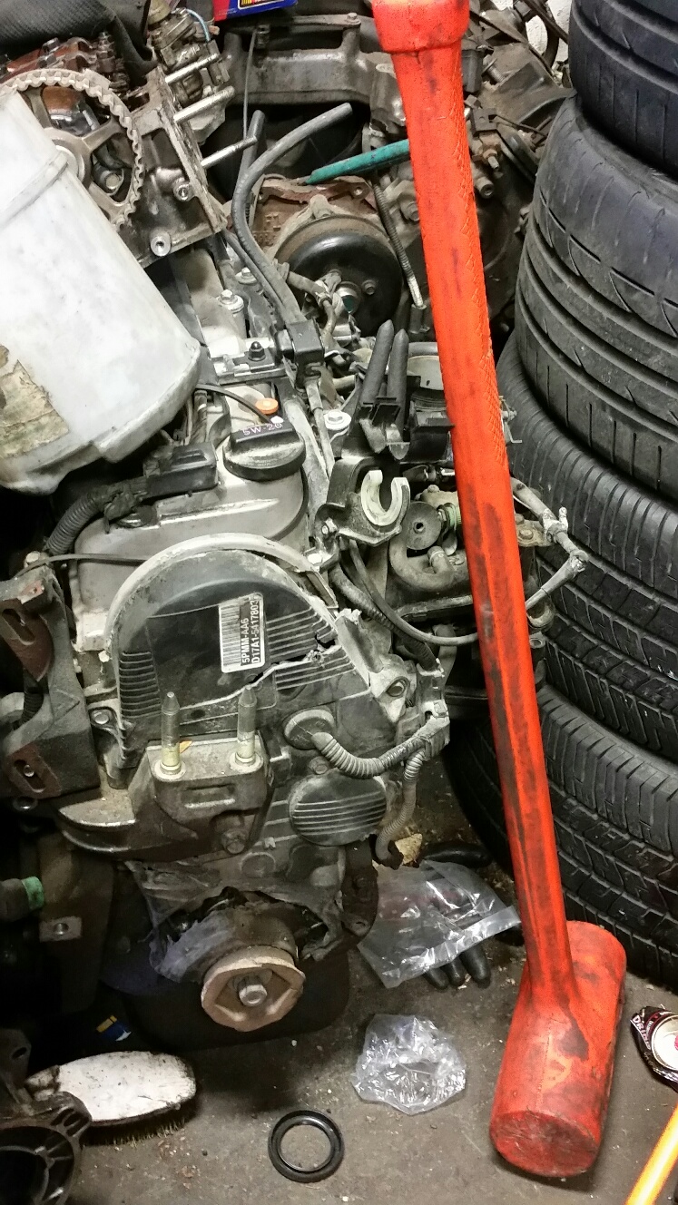

Hmm? How big a bat you got Mike?
You're going to have to source a BFH to make those rears tuck.

mgp4591
Dec 2 2016, 02:39 AM
QUOTE(Cracker @ Nov 8 2016, 06:25 AM)
T
QUOTE(mgp4591 @ Nov 6 2016, 05:47 PM)
I went a bit overboard... 235/45-17 in front, 275/40-17 in the rear. Yeah, I'm gonna try to make those fit.
Click to view attachmentLike THIS Tony??
Cracker
Dec 2 2016, 07:54 AM
Yep...that qualifies Mike.
Tony
