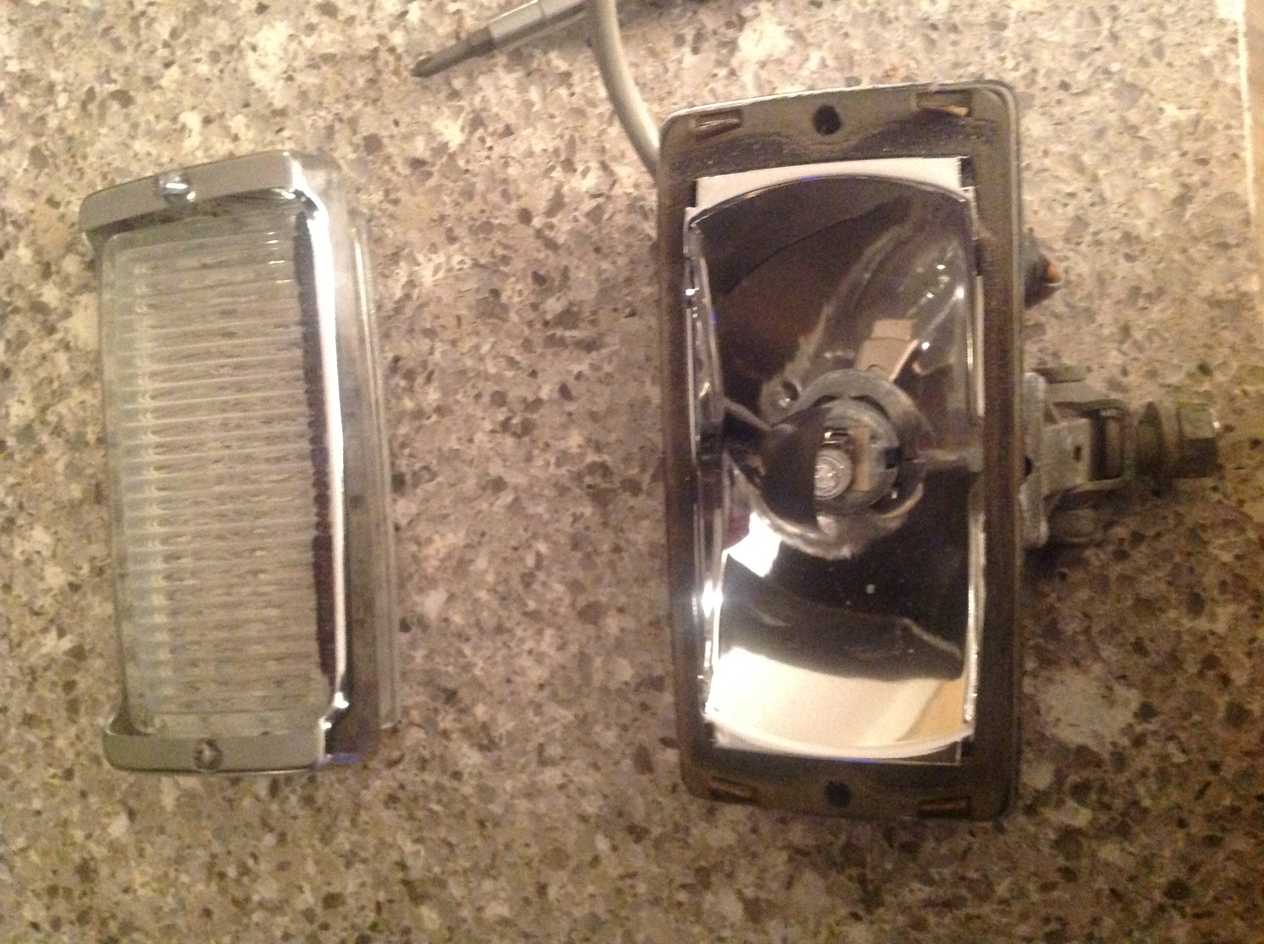

Does the glass on the stock foglight come off from the reflector? I was thinking of making an LED board to fit inside the cavity and use the original glass.

Jerry I am in. Yes the fog light lens comes off the factory lights. This is one of the last exterior lights I need for my car. Wait....did you already make the warts? If not, I still need them. If you made them, I likely have them. This is what happens when a build spreads out over years. I have forgotten some of the parts I have already bought. (IMG:style_emoticons/default/beerchug.gif)

I think the reflective dish makes the part. A flat board would not be that effective as it would not be focused.

Is this the 75-76 fog light? The early round one is the one I was thinking of. If I did these I would investigate using surface mount LEDs like Cree's XBD series.

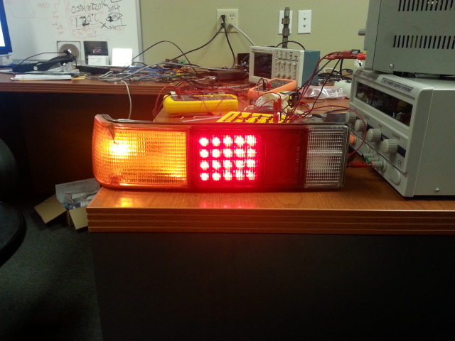

LEDs From Amazon
I used the XBDs on the first working 914 LED brake board which are in my car now. Here's a couple of pics from the first time I powered them. They were dangerously bright and I ended up cutting down the current from 300ma to 45ma for each LED.
