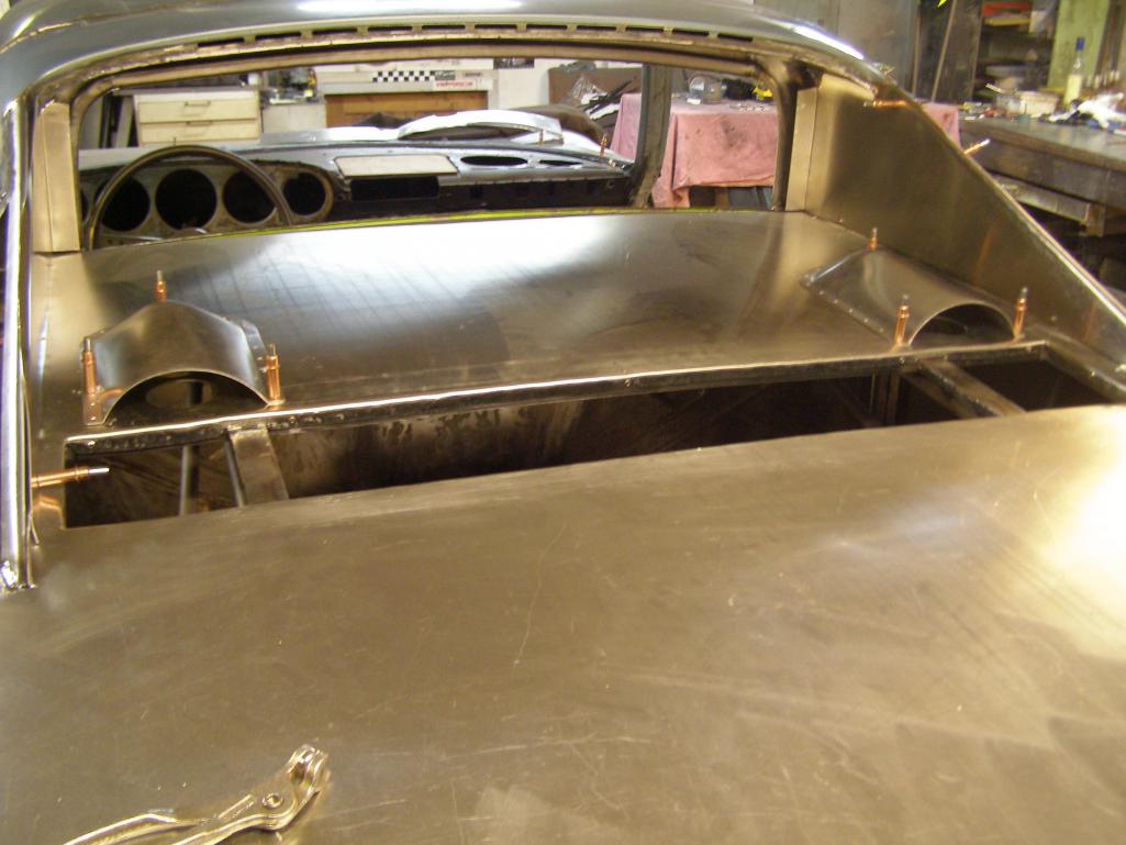

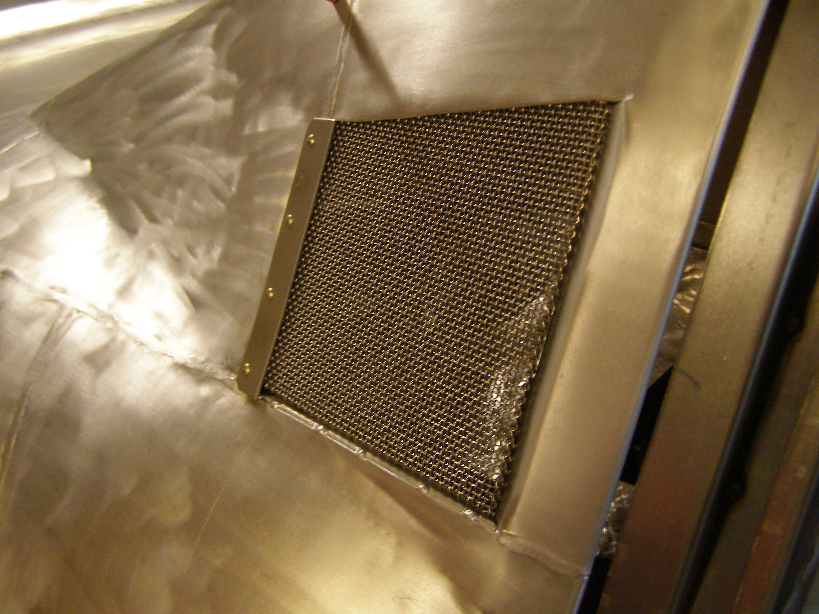

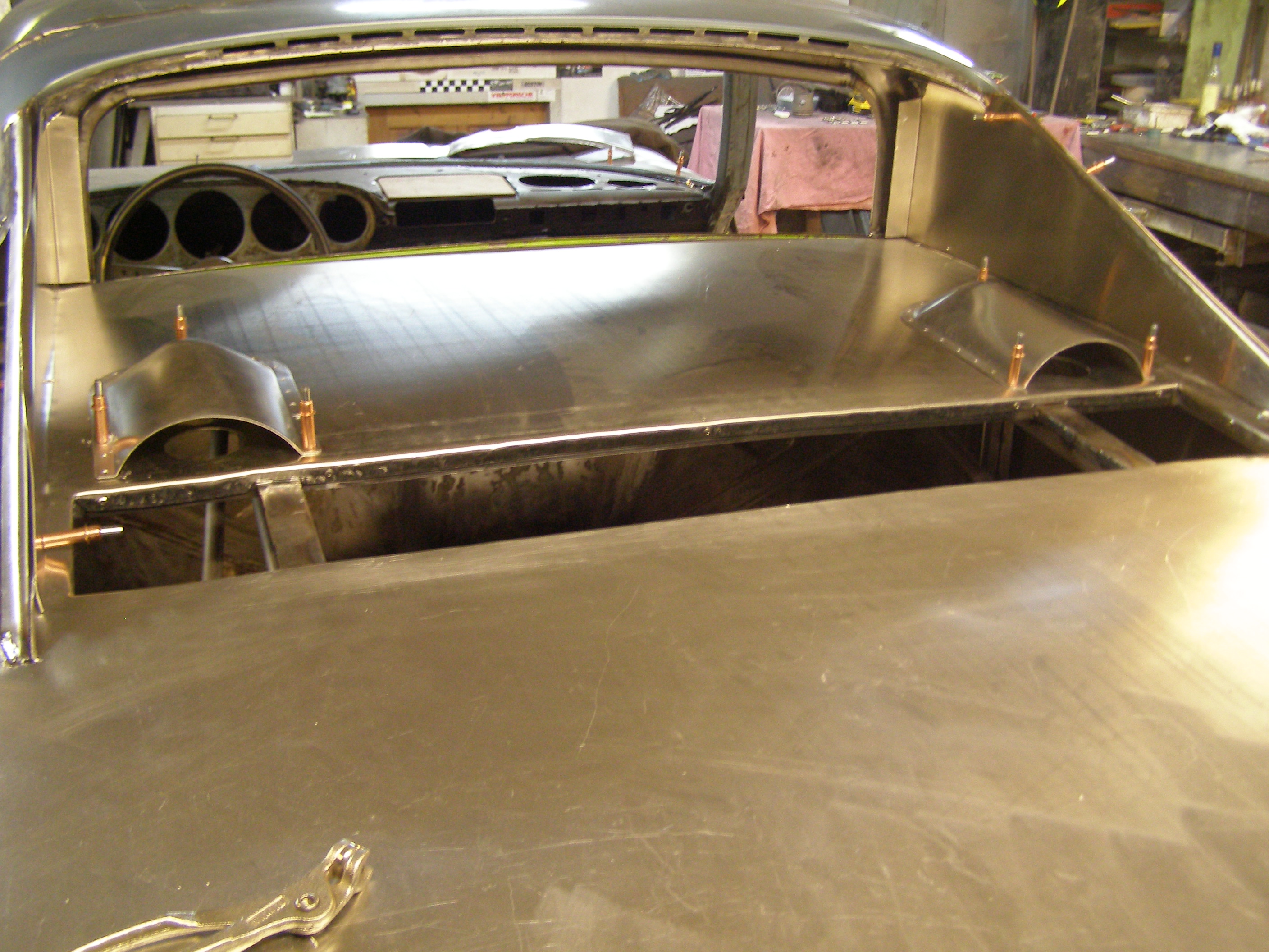

Punked,or not.I made wire screens for the air intakes today and some other small stuff.They are removable from the inside.Working on moving the air scoops closer to the body.They are midsize between the early and late models,in my opinion.The 914 chassis is perfect for a build like this and keeps it Porsche ??Makes it simpler to get license plates on it if I want to drive it...

Did the cars originally have a screen in there? I wouldn't know. What purpose do the scoops serve? I used a screen almost exactly like that in front of my oil cooler in the front of my track car. It was so extremely restrictive that my oil temps were way too hot. Like 250*F! I would have to get off the track. I removed the screen and the temp dropped 40*F my next runs. I ended up making another screen with material that had 1/2" openings that has done it job extremely well without causing any noticeable restrictions.
fordb132
post Jan 7 2017, 10:05 AM
Post #149
Posts: 65
Joined: 23-January 16
From: Norway
Member No.: 19,591
You are right,Krieger.I have seen one pic of the inside of the original 904 hood, and it was a hole with a 3-4" diameter.

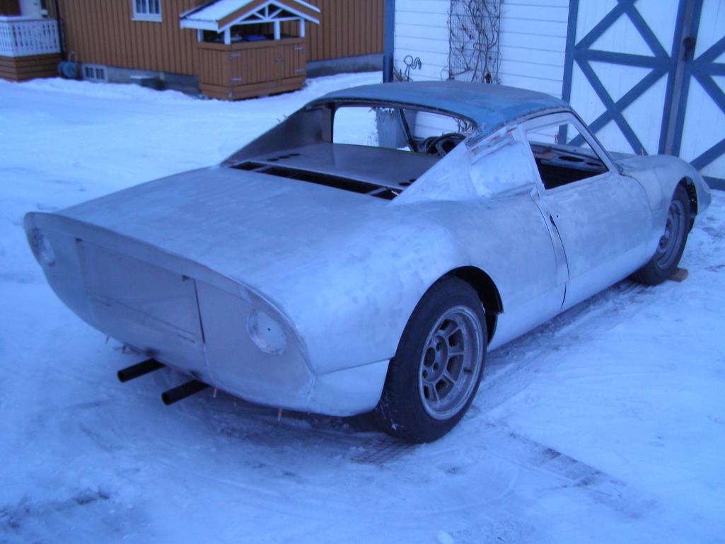

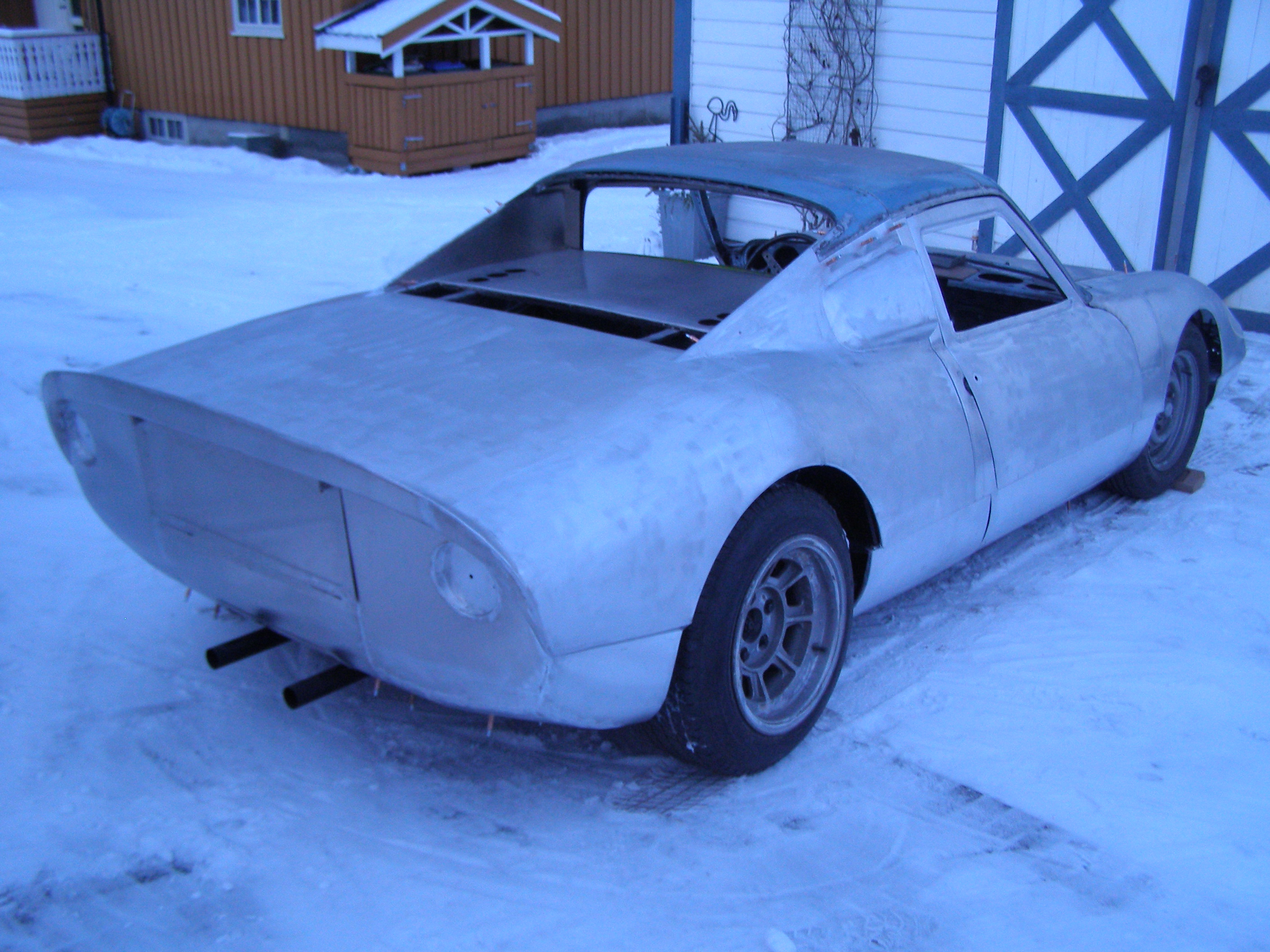

This engine is going to be driven in a cold climate and gets air through the grille,airscoops on top and sides.Should be enough...I'm running a oil temp instrument to be sure. No race tracks here BTW.Attached Image

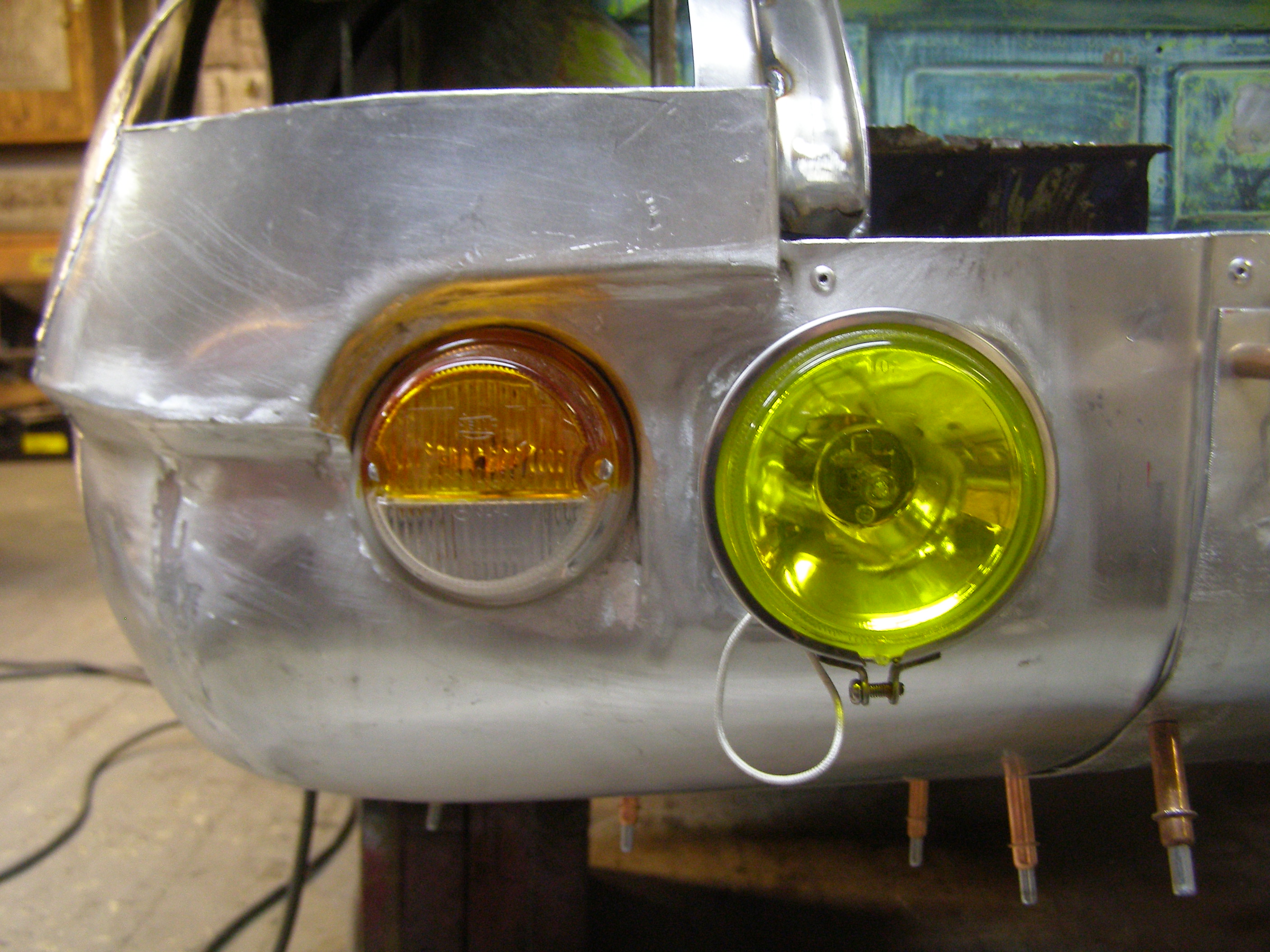

Did some job on the nose. I'm looking for a 914 trunk light....the Samba people won't send out of USA....anyone have a spare??

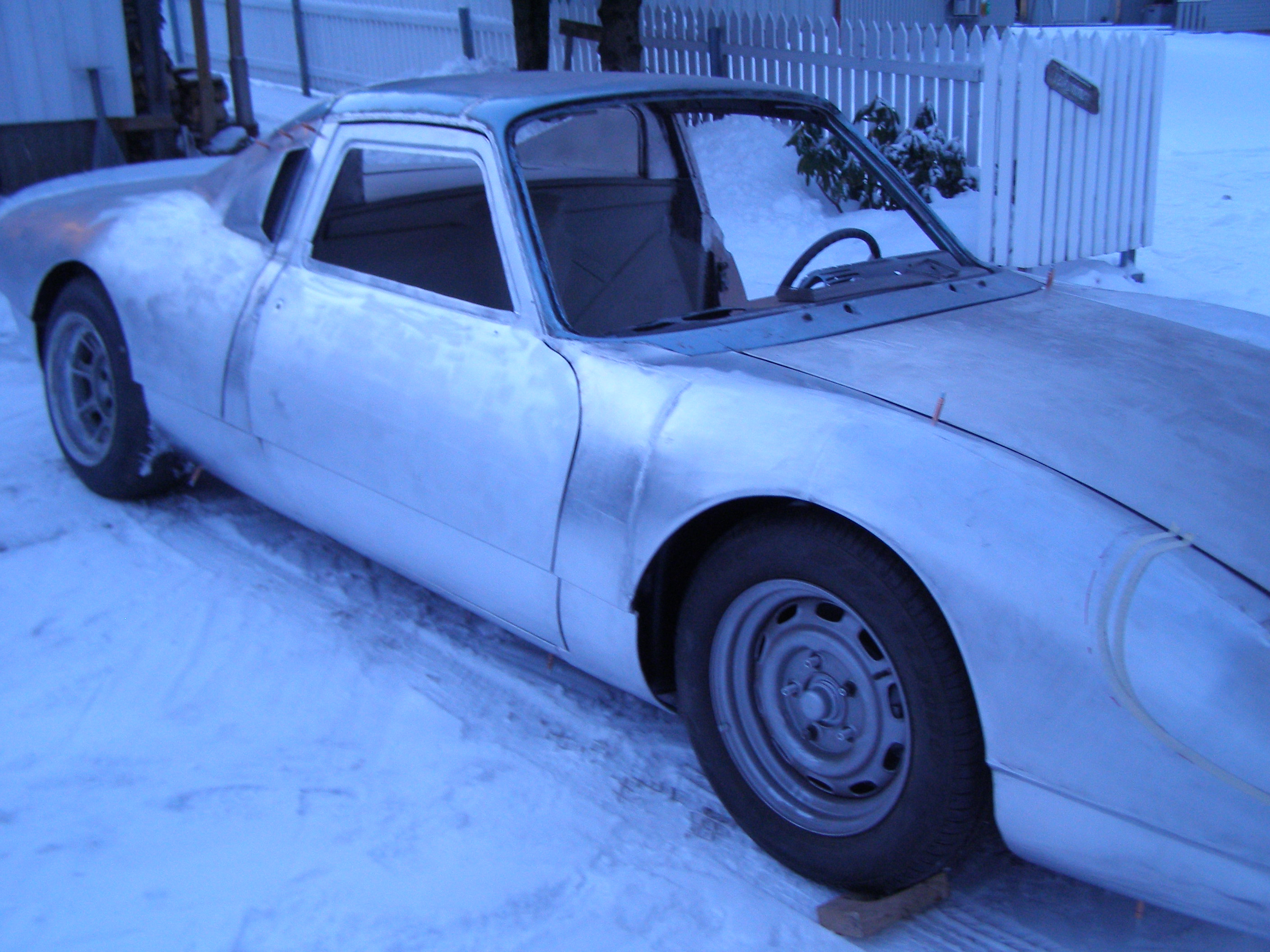

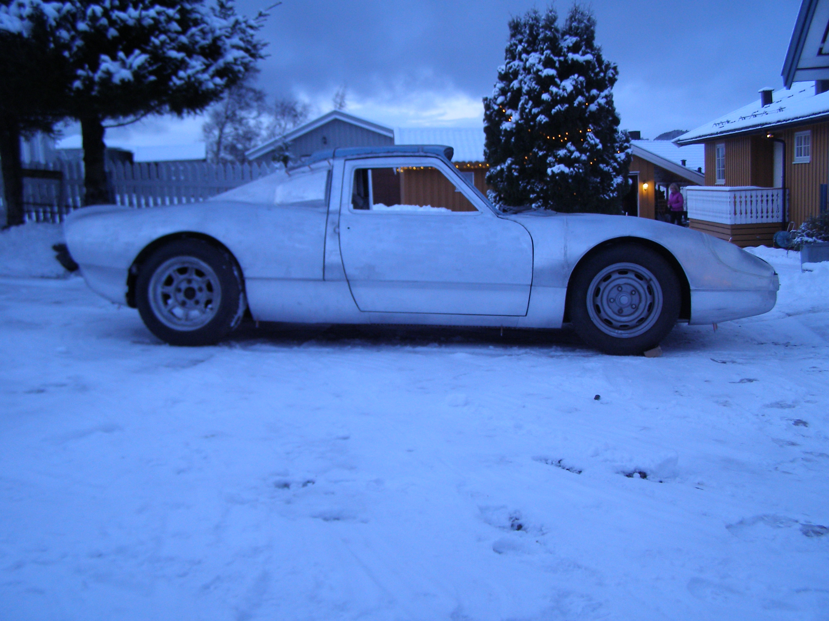

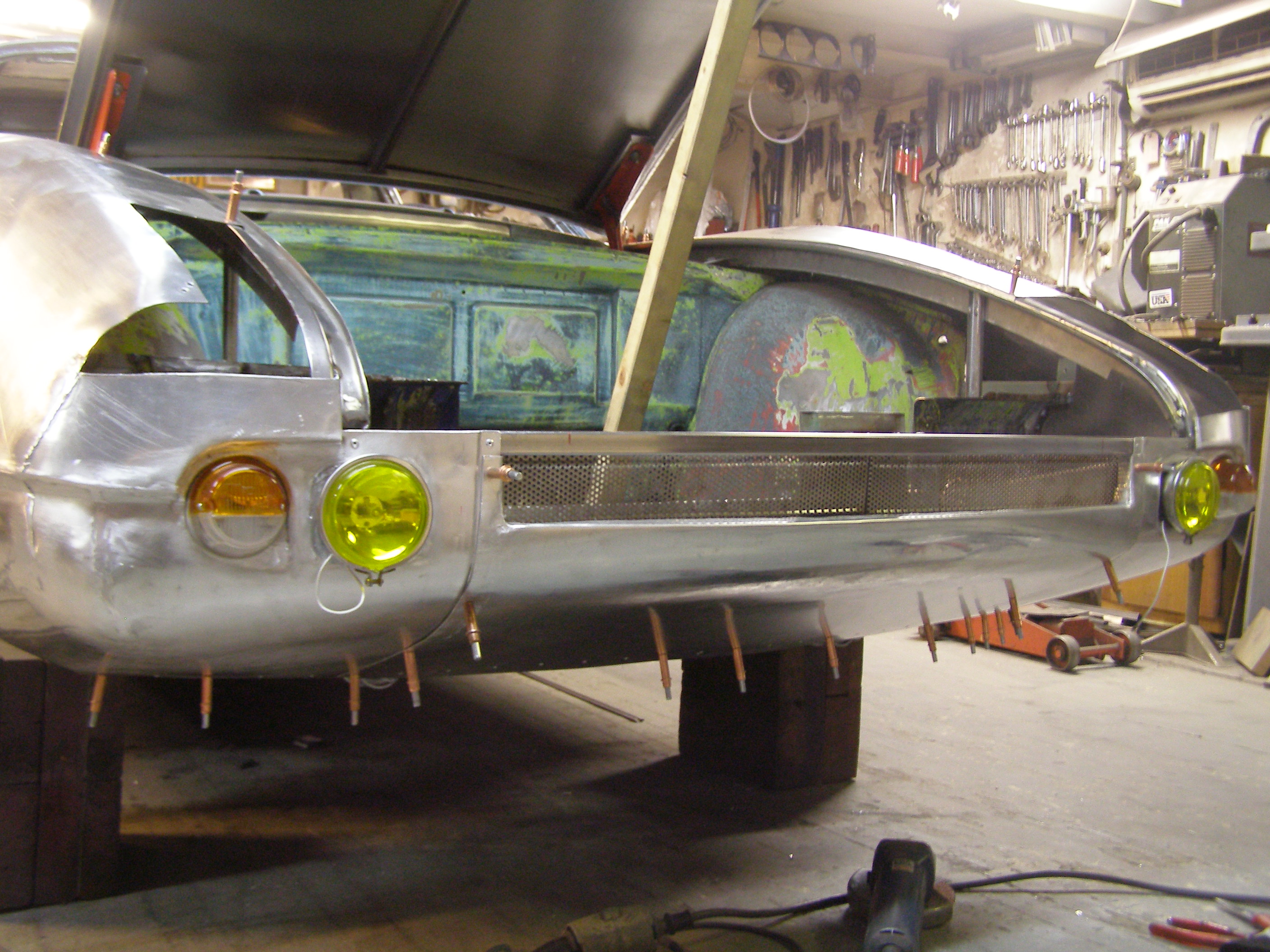

Attached Image Attached ImageAttached Image

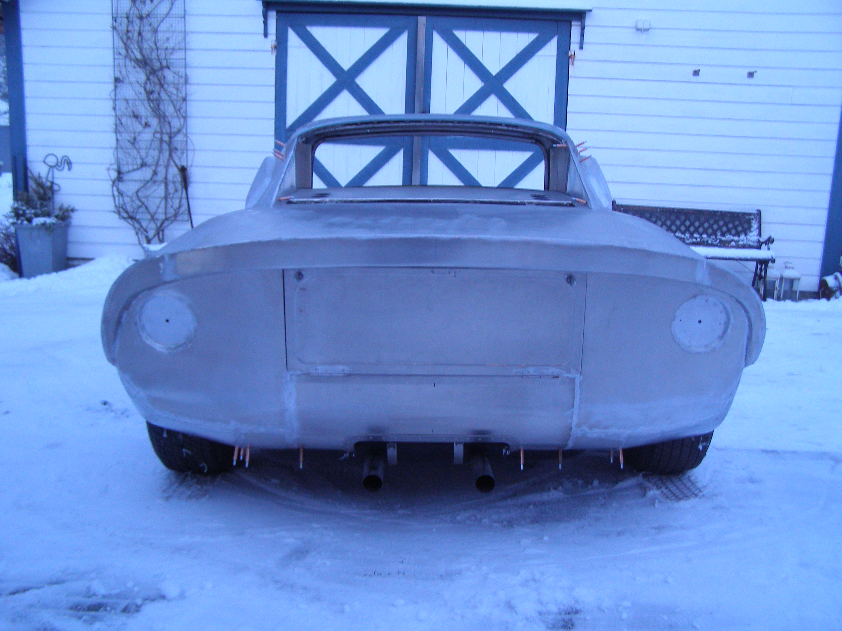

Had a great Calvados hangover today,so I skinned the other door and pushed El Cheapo outside so I could sweep over the workshop floor.The woman living next door said it was looking fine.So then its approved around here,at least.
